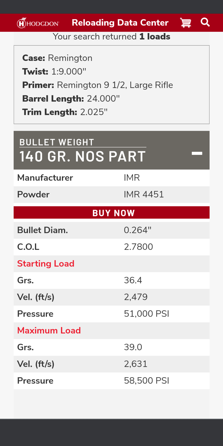

I formed some brass using Winchester 308Win brass to try out with my new rifle that has a 23" barrel.
The attached day from Hodgdon says 39.0gr is max so I stopped at 38.0gr in testing. There were no pressure signs but the 140gr Hornady BTHP was going really slow at 2375fps.
I'm looking. Now and see people using 41.5gr+ with this powder and a 140gr bullet so I'm confused.
I always thought Hodgdon data was MAX when they said Max as it sure is for 308Win and Varget but have they backed off now?
Should I just skip up to 39.0gr and work my way up to 41gr+?
It shot really well with 38.0gr but 2375fps is just really slow.

Which 140 bullet are you using?
140 Partition is long for weight with more bearing surface, shorter ogive radius so deeper in case also. Bullet weight is only part of the equation.
Reactions: Yote Klr
It's a Hornady 140gr BTHP so yeah it very well could just be the fact their data uses that Nosler bullet for the 140gr data.
Looking at the 142gr SMK that very well could be it considering their Starting and Maximum loads are 2.5gr *higher* than with the Nosler.
There's no confusion. You're using a Hornady 140 thin jacketed bullet and using loading data for a Nosler 140 Partition. Two very different bullets.
*EDIT* I see you found data for the 142 Sierra. That data will be closer to your Hornady bullet than the Nosler Partition.
