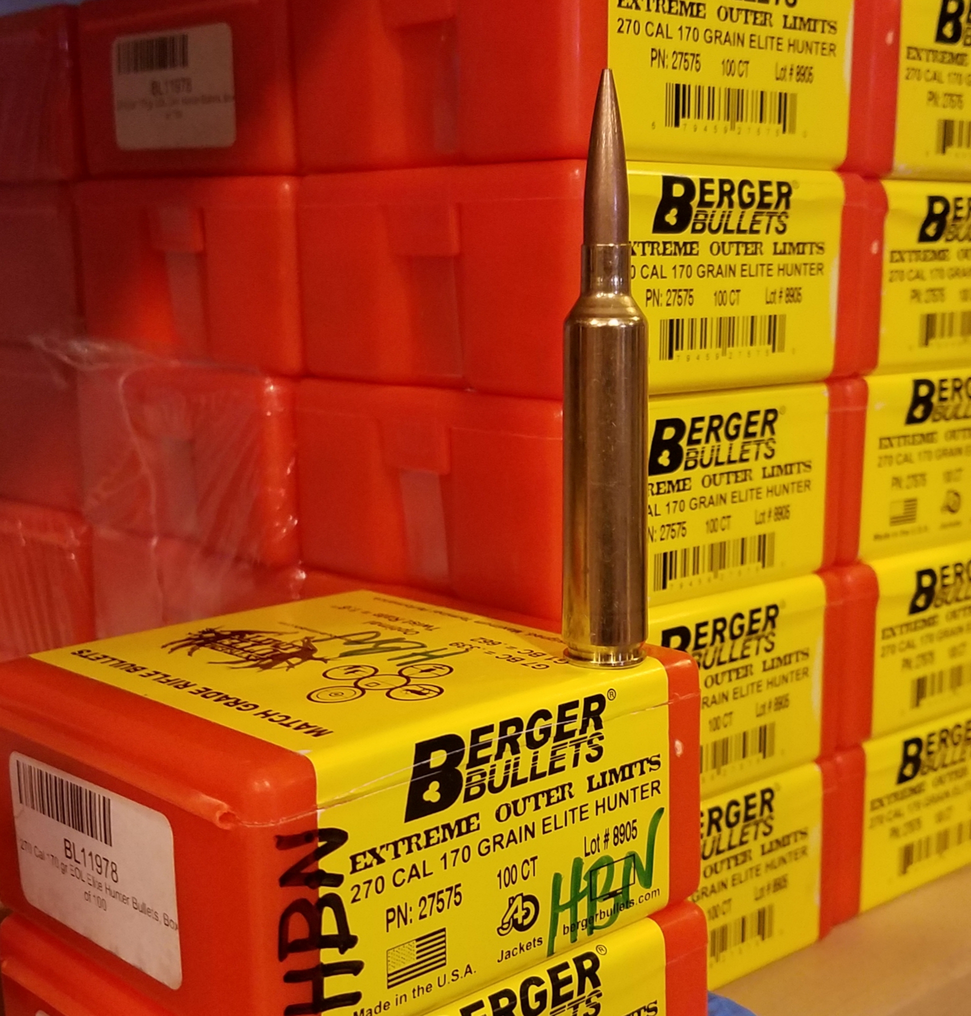

Does anyone have any experience or info with this cartridge?
I bought a bunch of boxes from Bullets.com when they closed. My plan was to build a 270wby 8 twist for these... and I did. However the barrel DID NOT like these bullets, it did love 150 ABLR and 7828 at 3350 .
My next devious maniacal plan is to build a 27 Nosler.
I think 26 or 28 Nosler bushing dies will work but have considered custom dies.
Any info is appropriate. Thanks.

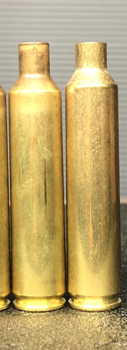

I have been running a 27 nosler for a few years,26/28 dies won’t work.RCBS makes 27 nosler dies that are readily available.
Had better luck sizing 26 nosler brand brass than I did necking down 28 nosler Bertram brass.
170 Berger eol@3200 with RL33
When sizing the body of 26N cases did much of the body and shoulder get pushed into the neck area?
Seems like neck turning is a mandatory procedure making 27N brass... I usually skim turn most lots of brass anyway.
Were there donut issues after a few firings?

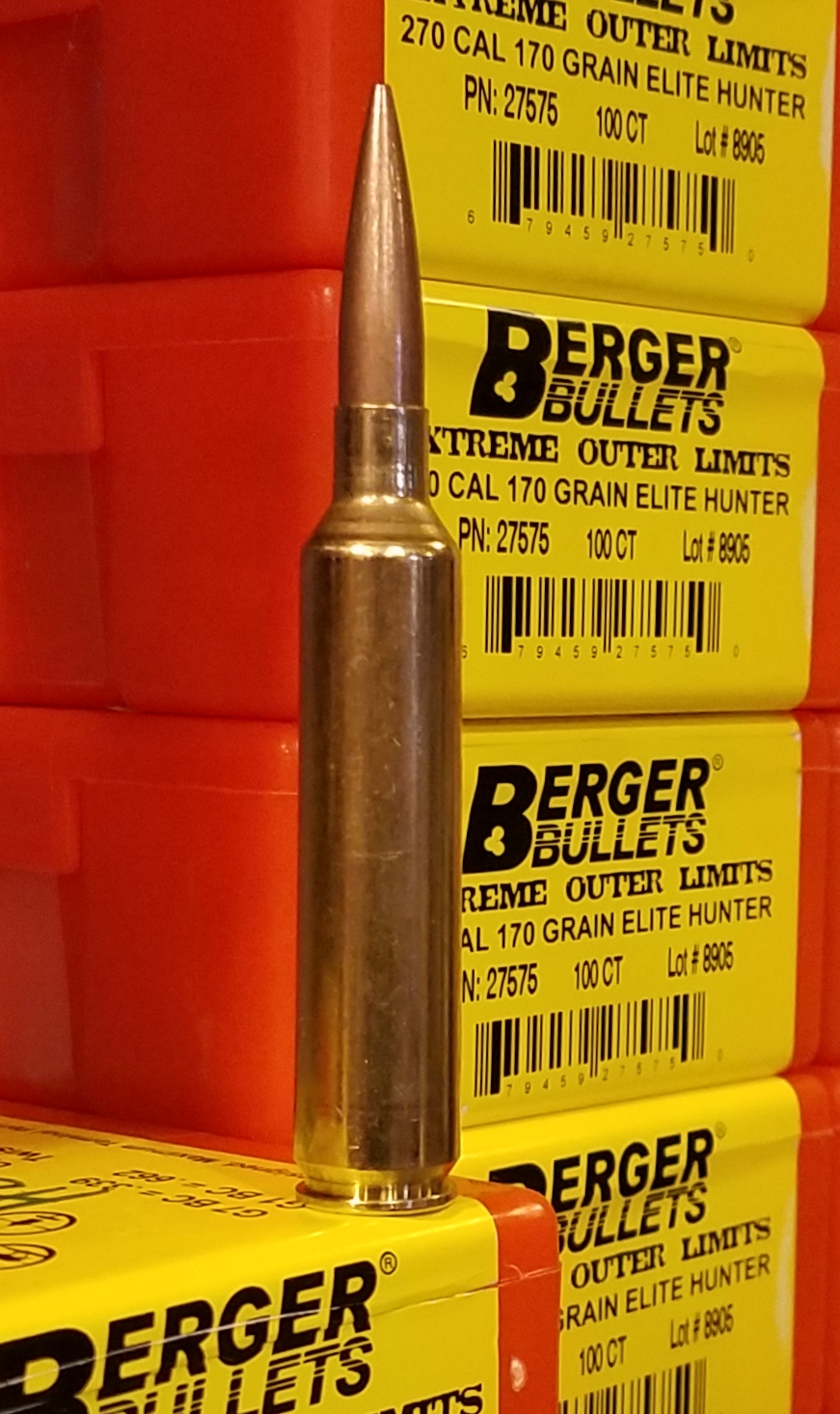

Another thing I will mention is the saami spec 27 nosler reamer has a very short freebore,I recommend having it throated a touch longer if you decide on the 165-170 class bullets.
No kidding! Just ordered my barrel, I asked the smith what his reamer freebore is? .000" !!!!
Getting dies in tomorrow. I'm going to send in a 170 Berger seated with the boat tail at the neck/shoulder junction so he can throat it correctly.
I ordered Norma 26 Nosler brass. Im a little bit hesitant because I always size down and then neck turn so I hope I made the right choice. But if I know RCBS dies they over size the neck so by necking up it might make neck tension better from the thinner necks.
Reactions: M338
Looking at SAAMI, it is a 1.5° lead which will put 'some' bearing surface ahead of the neck but not much.
I sized some new Norma 26N and they sized well. Neck tension is almost perfect
