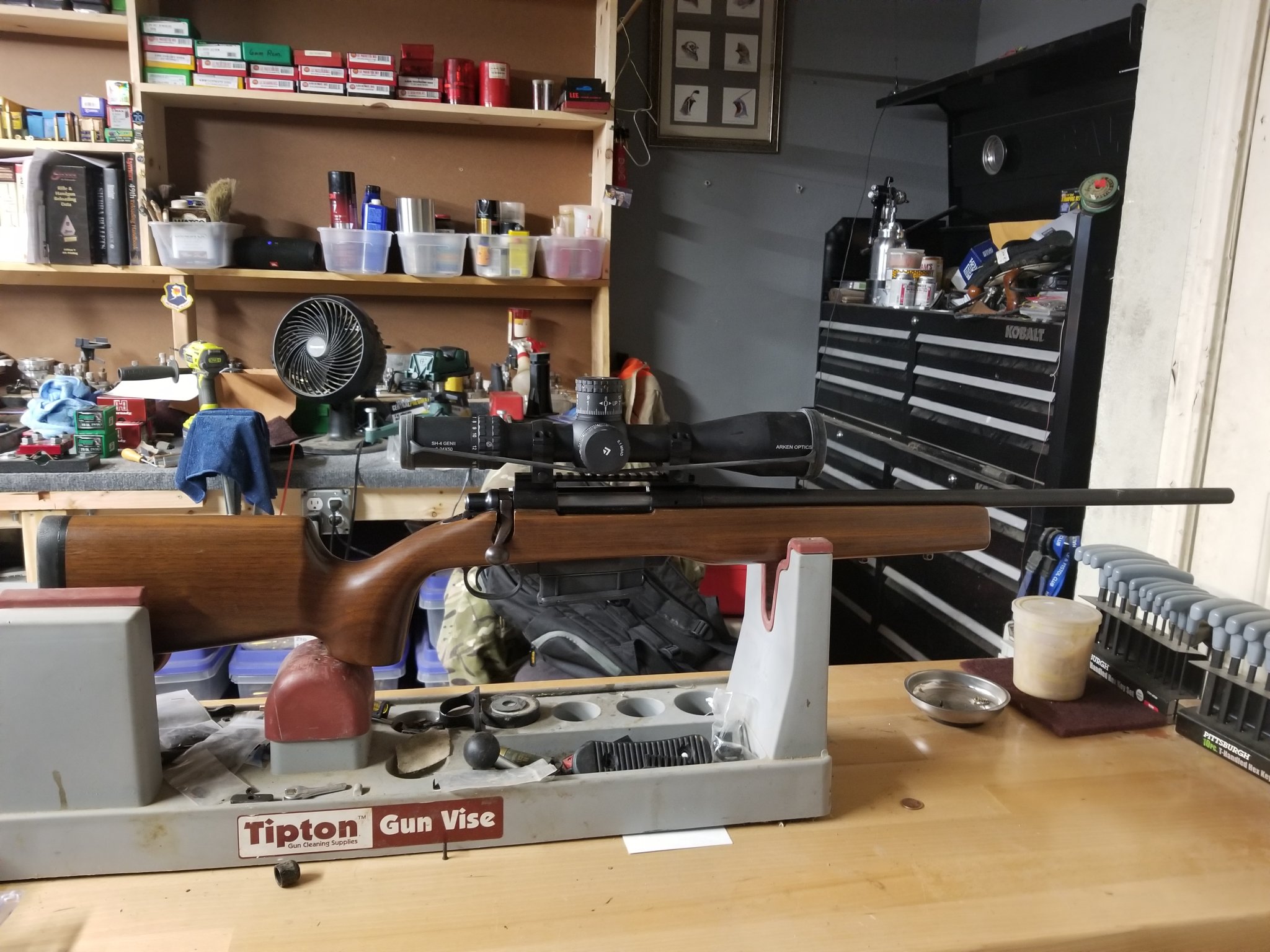

I put together a 270 Winchester with 1-7 twist Remage on a Bighorn Origin action. It seems to like the 170 Berger and 165 LRAB. No idea on long range performance, but I think it'd be a good performer.

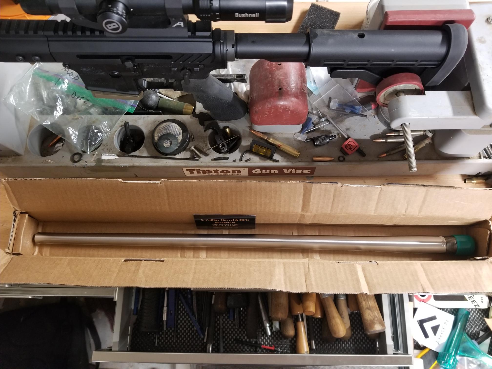

I am in the process of building a 270 Win specifically for testing it for long range capability.
Using a Sprtsman 78 donor action an older Stockys walnut target stock. I have a x-Caliber 9 twist barrel ordered. Should be in after Christmas.
Currently shooting 150 SSTs with Win. StaBall. Like you I have a large stock of Hybrid I will be testing also.

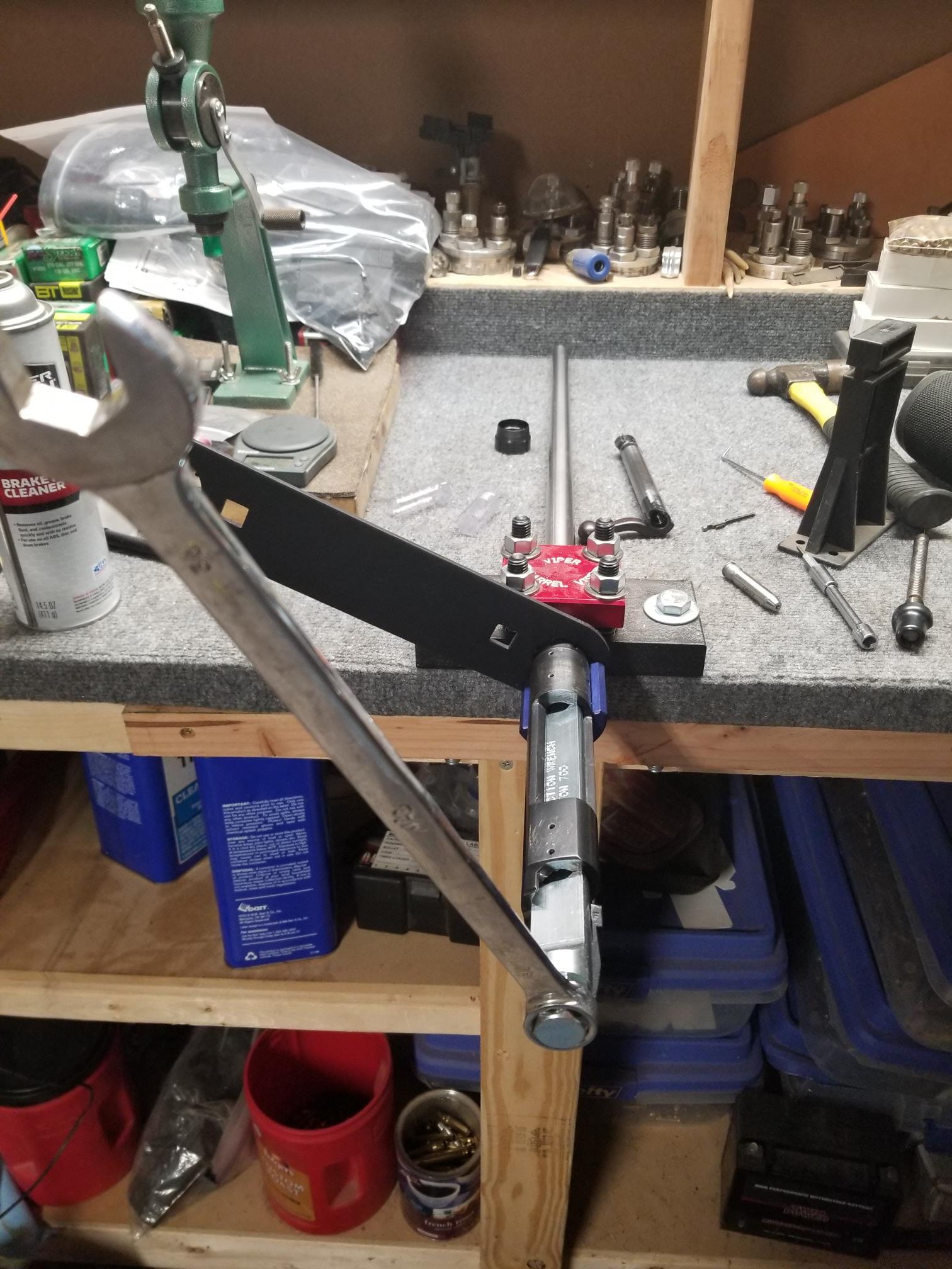

I had to order a new nut..after I purchased the spline wrench everyone sells the nuts with regular flats and I like the splined ones better ..Have a new spline nut coming from EA Brown.

This re-barrel has given me some fits. As I was attempting to tighten the barrel nut the recoil lug wanted to move on me as I got it tight.
So I invested in a Davidson action wrench and a tool to locate the lug that bolts on using the front action screw hole.
Much better now... Gauges fit and function perfectly. Now on to bedding the stock !

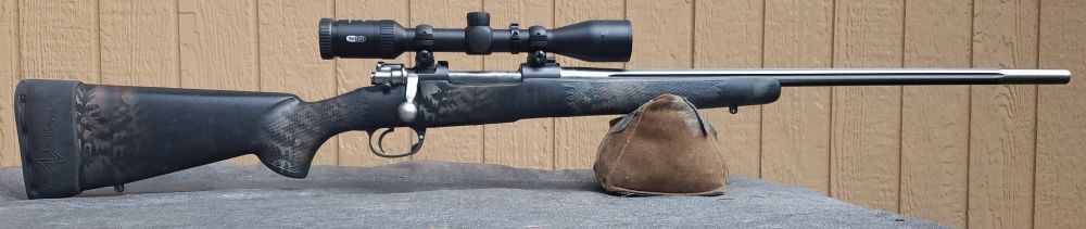

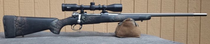

I just finished a two week 270 project to use up parts lying around. I did not have to buy anything.
$54 = Turkish Mauser 1938/1941 K Kale type 2001-02-17
$0 = take off Bell and Carlson stock
$125 = un fired take off 270 Criterion barrel stainless fluted with 18 tpi threads
$5 = acetylene bending bolt handle with Brownells bending blocks
$75 = ebay auction Parker Hale hinged Aluminum bottom metal.
$50 = Bold Optima Mauser trigger with safety
$20 = LimbSaver AirTech Slip-On Recoil Pad, small
$35 = Weaver S45 and S46 scope bases Amazon
$2 = 6-48 scope base screws
$1 = Devcon steel putty bedding under scope bases
$6 = Optics Riflescope Scope Bubble Amazon
$1= 1" of Walnut butt extension for length of pull
$1 = Aluminum 0.1" diameter rivets to assemble bottom metal

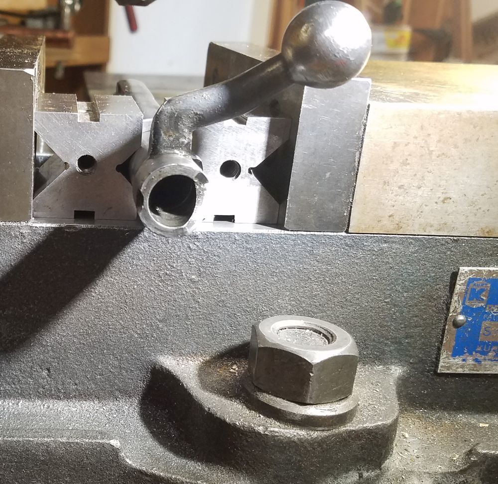

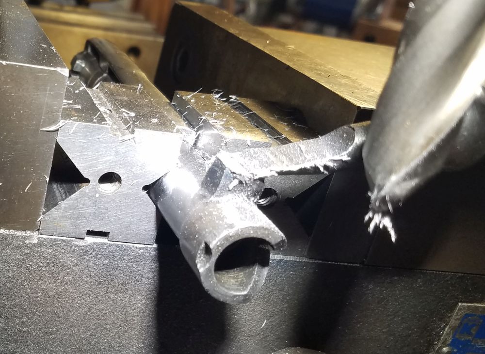

I weighs 8 pounds with scope.
Work done by me:
1) bend bolt handle, one man with torch, one man with sledge hammer, ....done 2002
2) drill and tap receiver with 4 holes for 6-48 screws to attach Weaver bases. ....done 2002
3) cut off existing barrel threaded tenon and cut new shoulder and small ring Mauser threads on barrel breech. .....done 2022
4) finish ream and headspace 270 chamber deeper.
5) Make tapered sleeve of 1.5" round Aluminum stock for internally tapered bushing to hold barrel in barrel vise
6) modify S45 rear scope base to clear receiver charging hump and to clear bolt handle movement
7) Mill and file bolt handle to clear scope objective
8) Devcon steel putty epoxy scope bases with modified AR riser as fixture
9) Verify scope base mounting with scope with reticle centered is close to Leupold Zero Point modified for flashlight illumination
10) Modify bottom metal for 0.050" deeper seating of magazine catch spring
11) Assemble and rivet together bottom metal hinge and magazine catch and peen Aluminum rivets
12) make front action screw spacer washer 0.030" thick, 0.255 ID, 0.373" OD, for action bedding with bottom metal not touching receiver
13) make the rear pillar on the lathe by boring out 3/8" steel tubing 0.255 ID, 1.127" length so the magazine does not touch the receiver
14) Inlet stock for barrel with 3/4" gunline inletting tool
15) Inlet stock for receiver, bottom metal,
16) Verify bottom metal with pillar and washer tightly assembled on stock and barrel installed all have clearance before bedding
17) rough outside or rear pillar so epoxy will grip.
18) 5 minute epoxy bed receiver bottom, recoil lug, rear pillar, and bottom metal
19) clearance stock and bottom metal for Bold trigger clearance
20) Bend trigger safety to clear bolt sleeve during in and out
21) fit 1" Walnut butt extension for more length of pull and to give the slip on recoil pad something to grip.

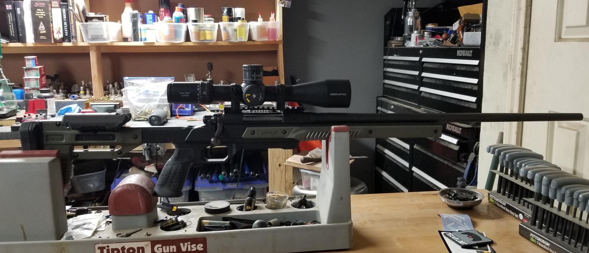

Way back last year, when Black Friday sales were going on, I decided to buy an Oryx chassis. Mostly because I could save a bunch of dough and I was just not in love with the wood stock.
The drawback to the sale was I had to wait for MDT to catch up on their production. So 4 months later (Today) the Oryx finally shows up. I coated the barreled action in SOCOM Black and got all of it put back together.
I was also lucky enough to get my hands on some Nosler 150 Gr. 277 ABLR's (G1 of just under .600) which according to my load data should launch at about 2900 FPS. I think that's gonna be fun to see how far I can lob them.
Now gotta locate an AICS Long action mag...Hand feeding until then.
High Brass, do you have any shooting Data yet? I am dying to know what bullets you are running, powder type and velocity. Can you let me know what distance you used for zero and how many minutes you came up at 1,000 yds?
I have just started proving out loads with the 150 ABLRs@100 Yds.
I had an issue with the scope running out of windage and still being off an inch @ 100 yds.
The Arken scope seems to not have much adjustment left & right?
I may wind up swapping in some Primary Arms glass.
Its on my list and I will keep you posted!

I finally gave up on trying to get the Arken to work for me on this rifle.
I happen to be a dealer for Blackhound Optics and just got in the latest 3-18x50.
I did a laser sight in and already know it will work just fine. Since it is a 30mm tube. I was able to use a DNZ 20 MOA mount. Say what you want about mounts, but the DNZ stuff just works every time without issues.
I should be able to get some range time tomorrow. I will use the Magnetospeed to get data on my 145 ELDs and the 150 ABLRs.
If you are following I apologize...Too many guns ...too many projects...
Reactions: Frankr and P&Y
Day at the range was a good learning day.
I am learning that I may not be very fond of the ergos on the Oryx chassis.
I also learned that Hybrid 100v may not be the best powder for .270 Win.
I got really good groups with my Sierra 130 gr sp. Got some partial good groups with 145 ELDXs
good so -so groups with Nosler 140 BTs
my load for the 150 ABLRS(50.8Gr) was clocking 3200+FPS and I was getting cratered primers with ejector swipe. Had really snappy recoil that was not pleasant. Shots were vey randomly scattered on the target... Not what I wanted at all.
The ELDXs actually shot pretty good...Except for 1 flyer. just a hair over 3000 Fps. The Nosler 140s were shooting pretty good but also had a couple of flyers. The surprise was the 130 Gr. Sierra SPs. Also at 3000 Fps nice little bughole.
I think a slower powder will help some of these issues so ...Back to the bench. I have some Win 6.5 StaBal that may work well, but I know it will cost me some velocity. I have some MagPro that I may try as well..
