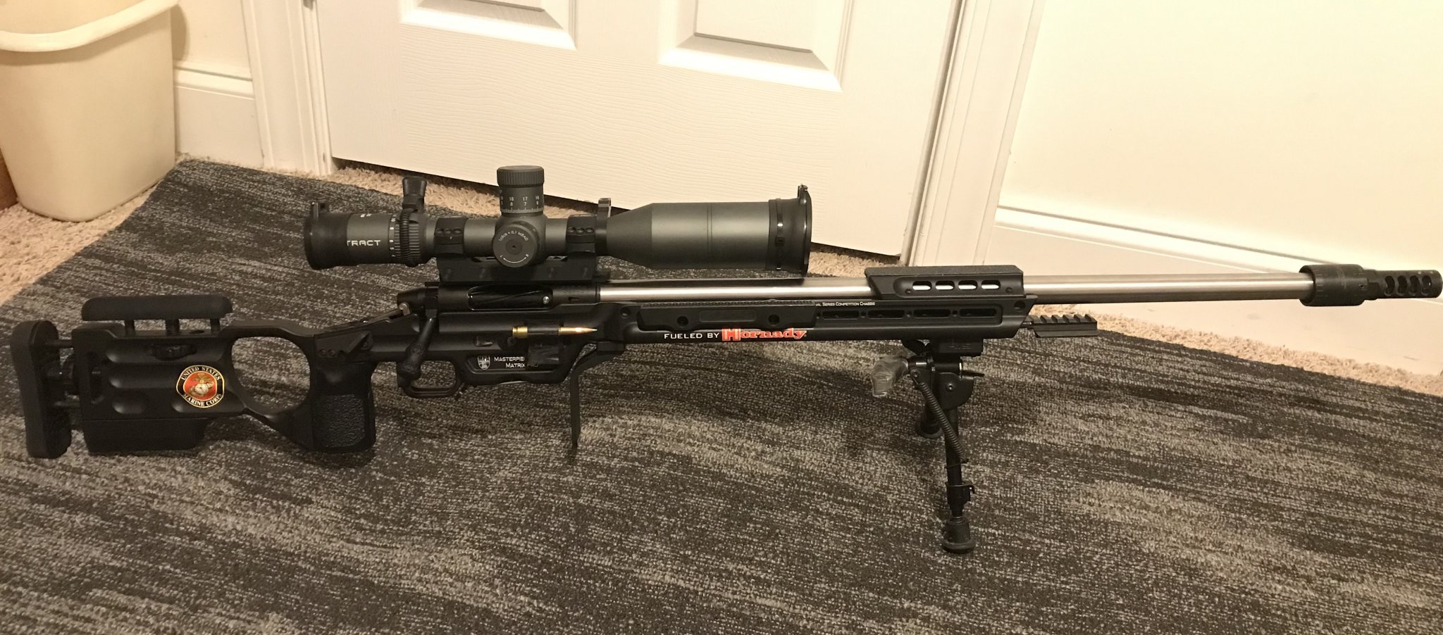

28" is an excellent length for the Creedmoor. I am loading the 153 ATips in it now at 2680fps for matches. Below is my 28" M24 contour 8 twist Bartlein on my Origin action.

Man! This thing looks sick. How do you like that glass and do you find it compares to anything else, glass wise?
Thanks. That's the Tract Toric 4-25x50 and I really like it. Glass isn't as good as my Zeiss S3 but the glass close and is plenty good enough for matches. The reticle is also excellent for holds. I got it for LE/Mil pricing and it's an excellent buy at that price and still a very good buy at the normal price.

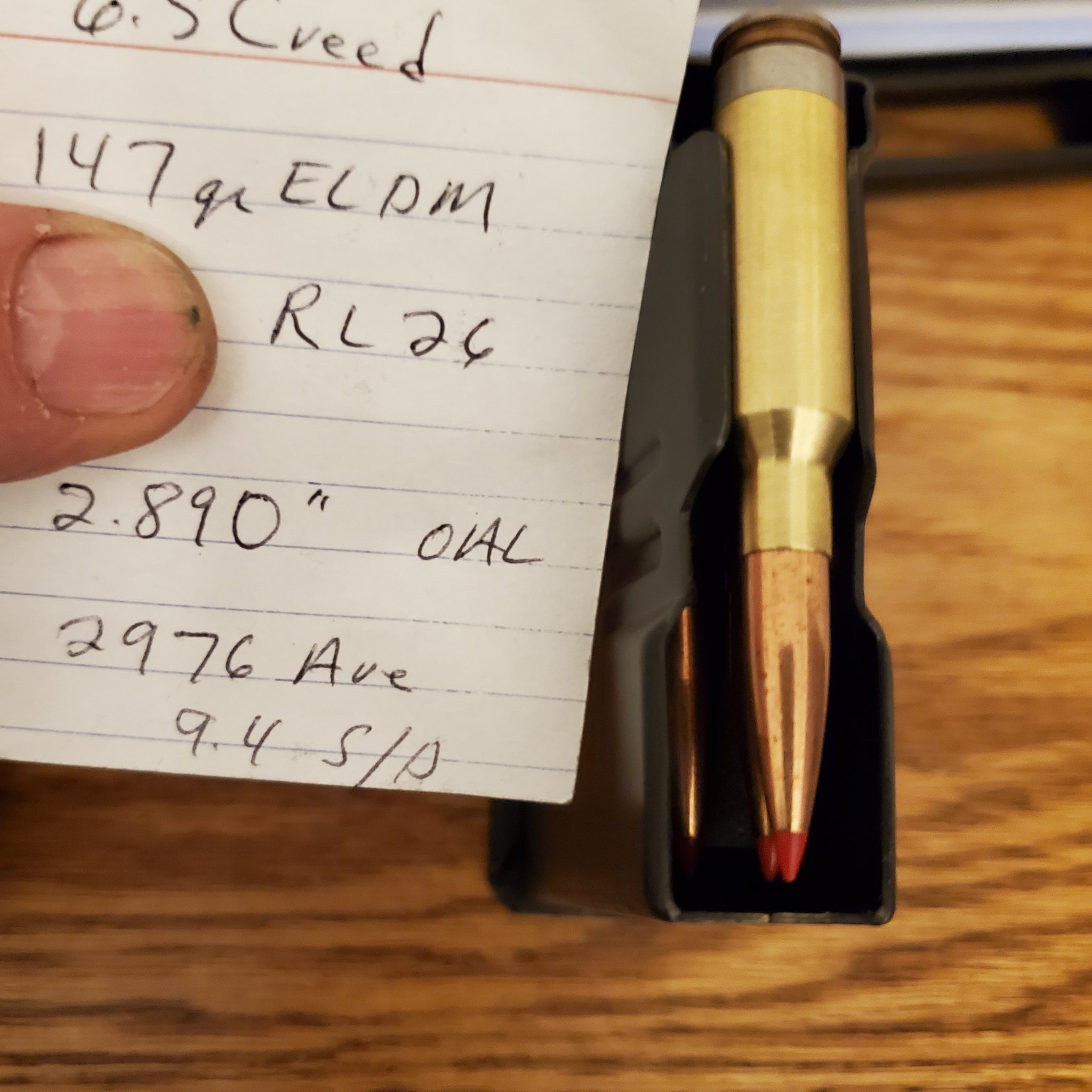

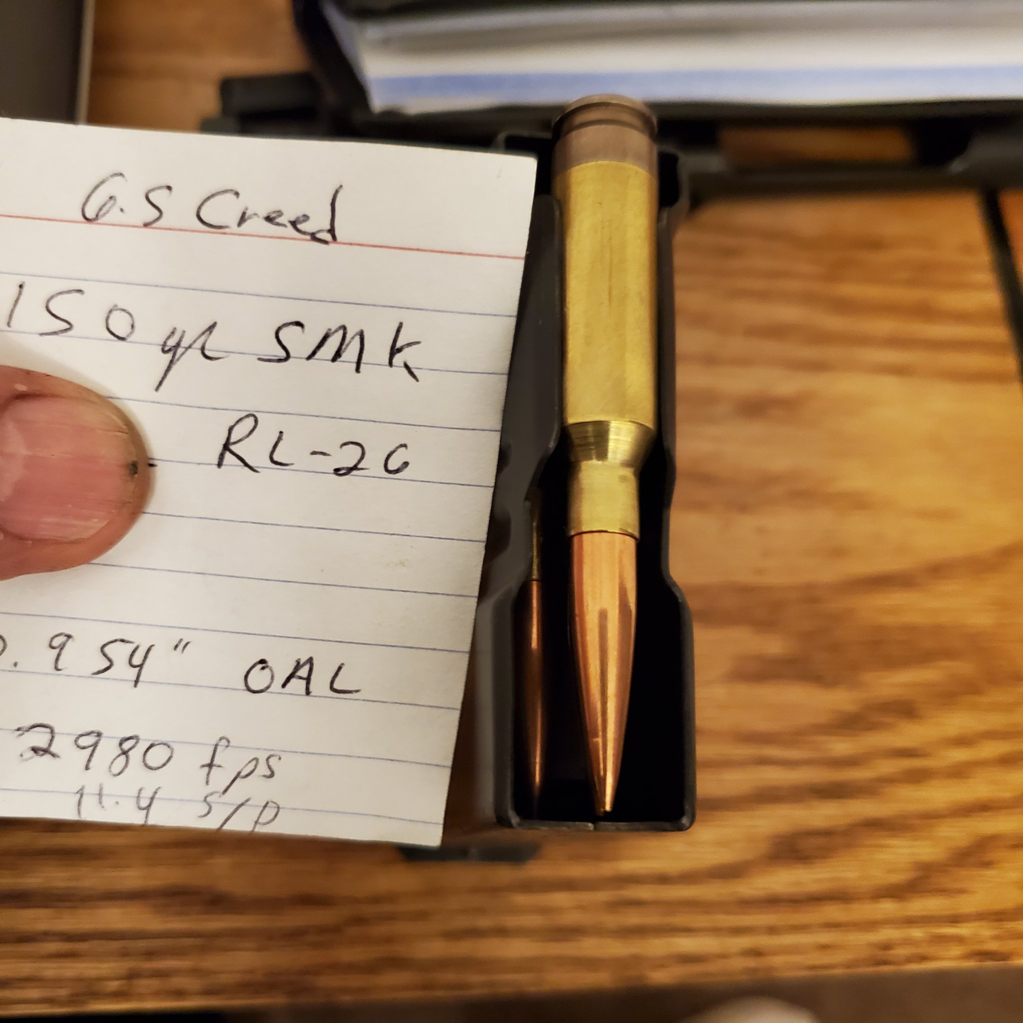

Here is the load data...minus the powder charge of RL 26.
They are loaded to 2.954" from center feed MDT metal mag. The average velocity is 2980 fps from the hybrid cases in a 24" 6n5 CM, this is an accuracy load
Here is the 147 ELDM info with hybrid cases top velocity is around 3033, but accuracy was at 2976.

I still use brass cases, but not with these high pressure loads....but these are the ones I'm currently shooting. COAL is the same just a bit less powder.
