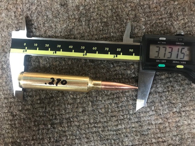

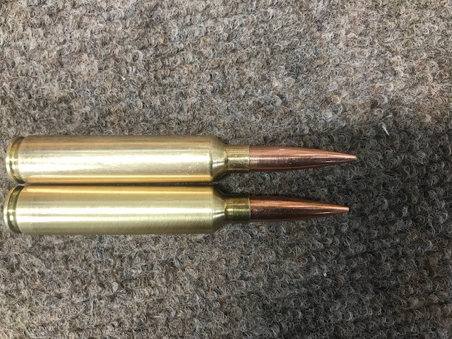

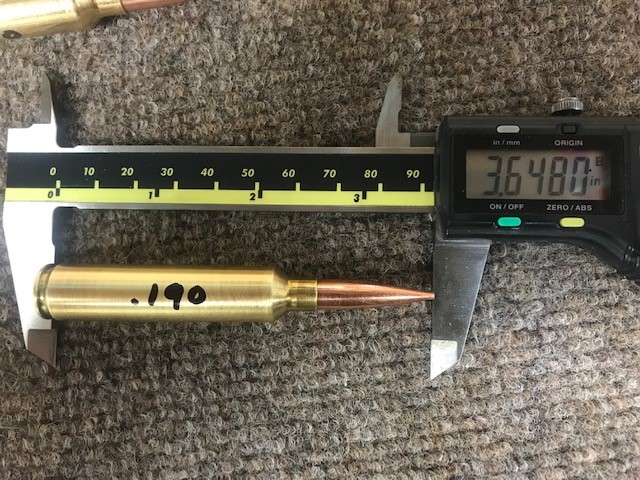

I was reading the comments above and although this isn't exactly what your asking for and i haven't finished chambering it yet so i cant comment on load but i thought i would share some length's as related to freebore.

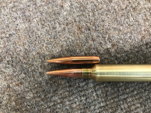

Below is a 28 Nosler case and two 195 Berger's. The one with the bullet seated is from a reamer with .190 freebore. So the bullet is seated @ the lands.
In this picture the top cartridge is from a reamer with .270 freebore and the bottom cartridge is .190 freebore.
Here is a COAL for the .270 feebore
Here is a COAL for the .190 freebore

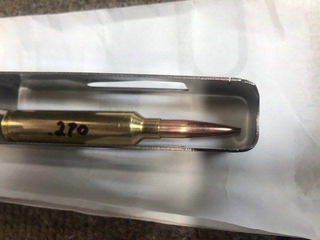

Here is a picture of the .270 freebore in a Wyatt's extended box magazine. The Wyatt's has an internal length of 3.850, so around .120 to chase the lands and still fit into the box magazine.
