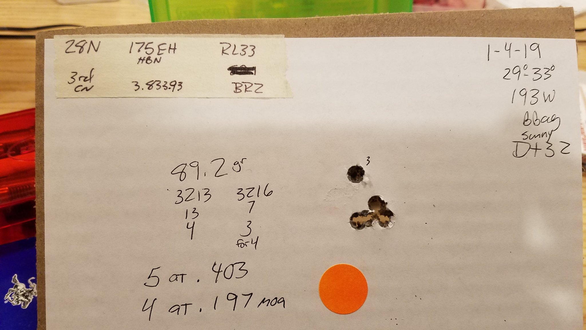

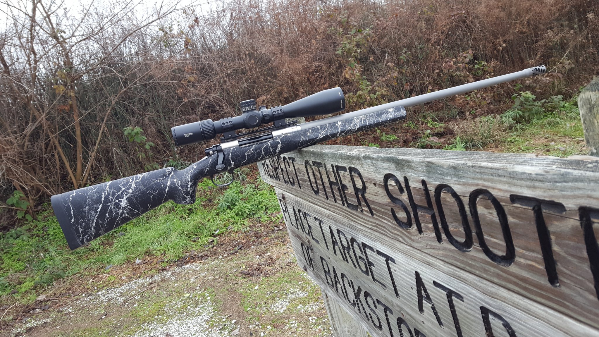

Converted my 7RM to 28 Nosler. 26" Remage mod. Although I never shot 195gr I've always shot 175gr Elite Hunters. No need for Wyatt's mag box just original magazine.
here is my 28N next to 300rum.
200yd group
Reactions: Merdoc and TACC
