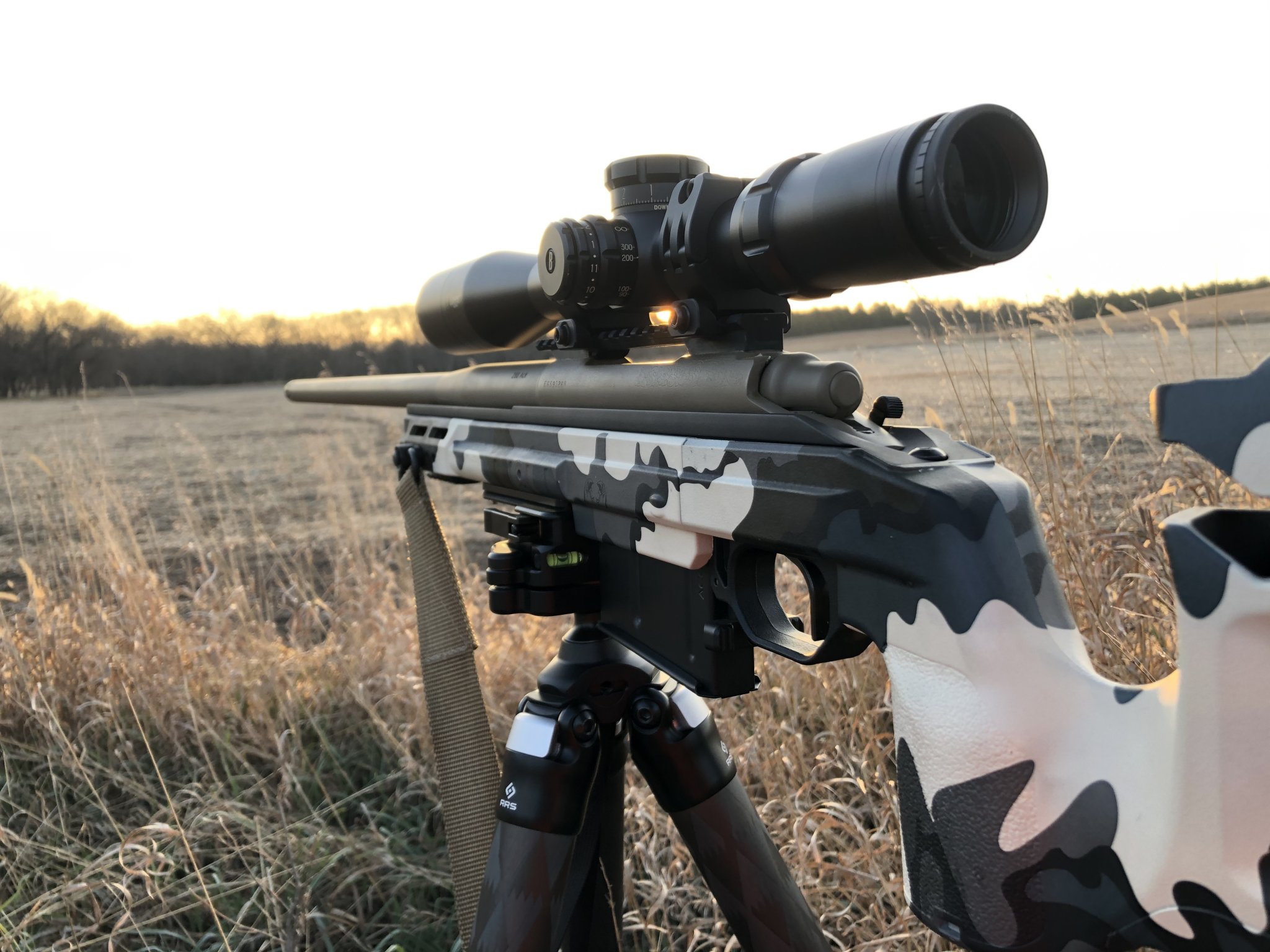

    Looking for some advice on a possible build. I have 6.5CM tactical/comp build and a lightweight 308 hunter already in the stable.
    Looking for a longer range western hunter / the occasional range gun for those longer distances. Mostly it would be more of a hunting set up...70/30% favoring hunting.
    I was fairly set on the 6.5 PRC and never really seriously considered any .28cal setup besides the 7RM. I’m finding that there is actually a bit of factory loaded 280ai rounds...not a ton but some nice nosler, Berger, Normandy stuff.
    What do you guys think? Any 280ai guys out there willing to chime in? I don’t really want to go to a magnum 30cal.
