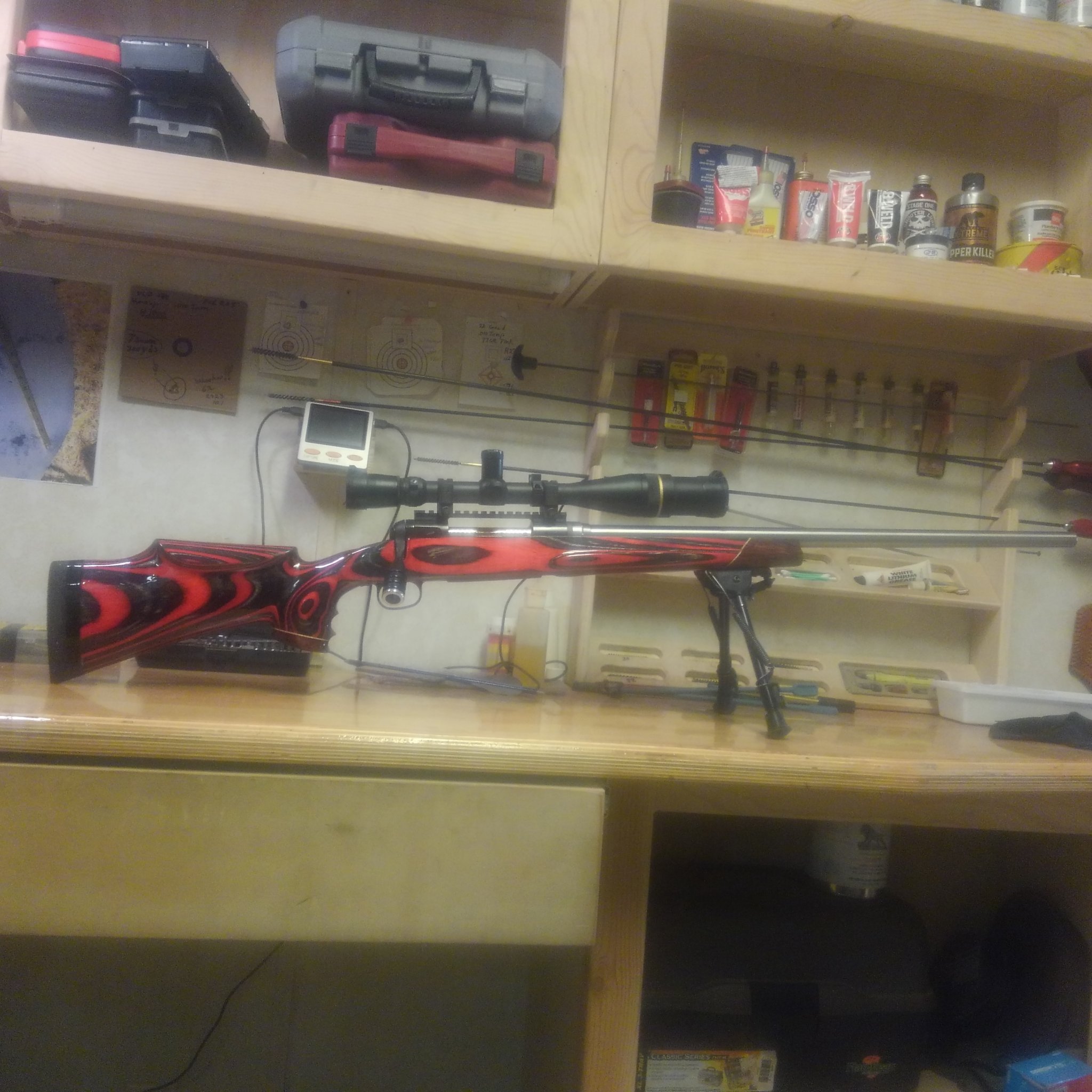

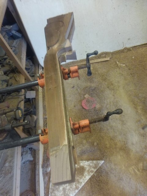

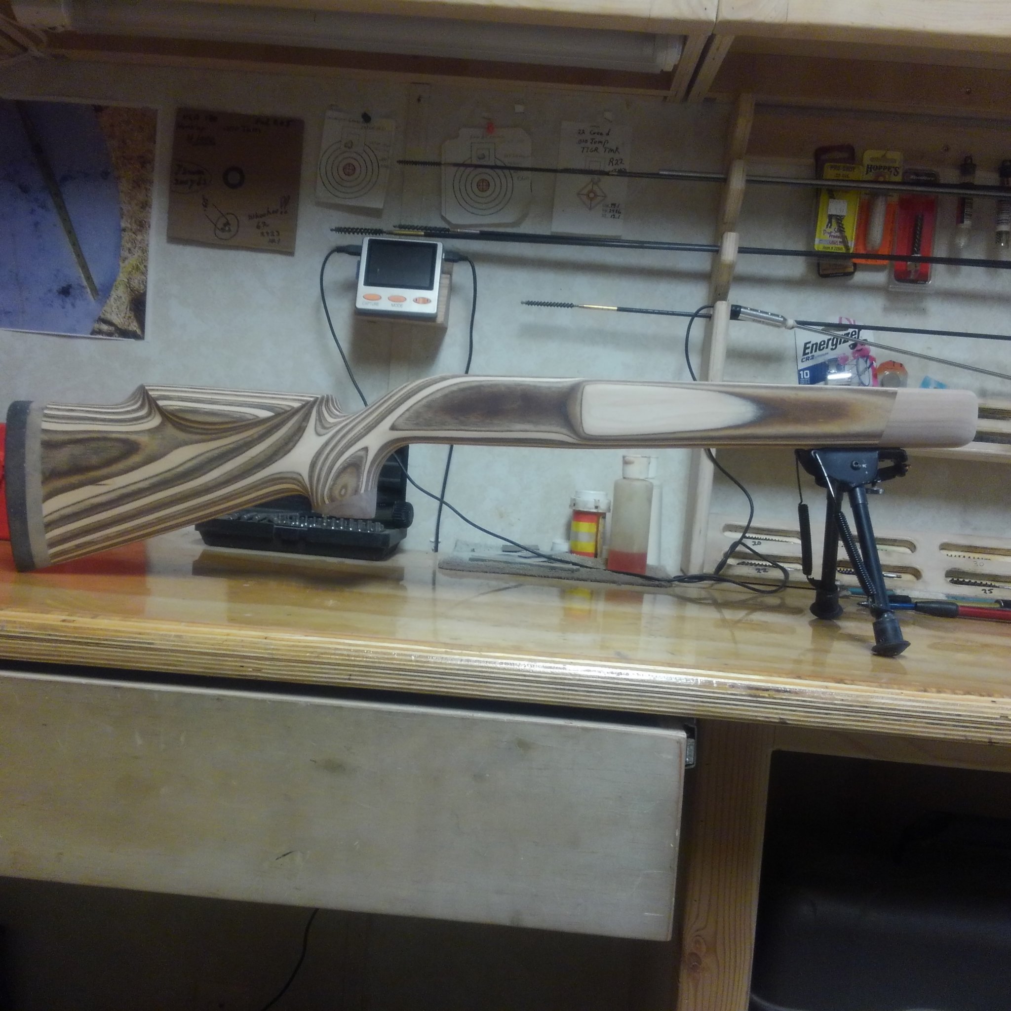

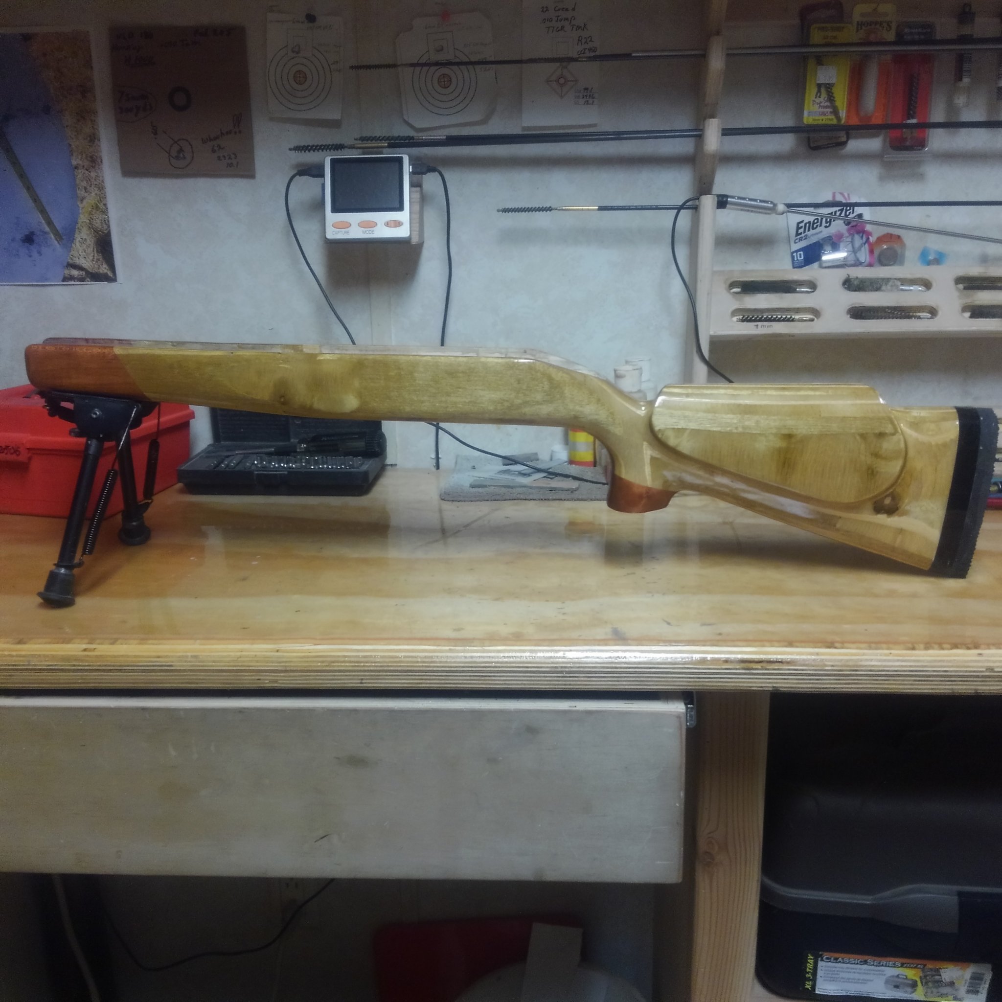

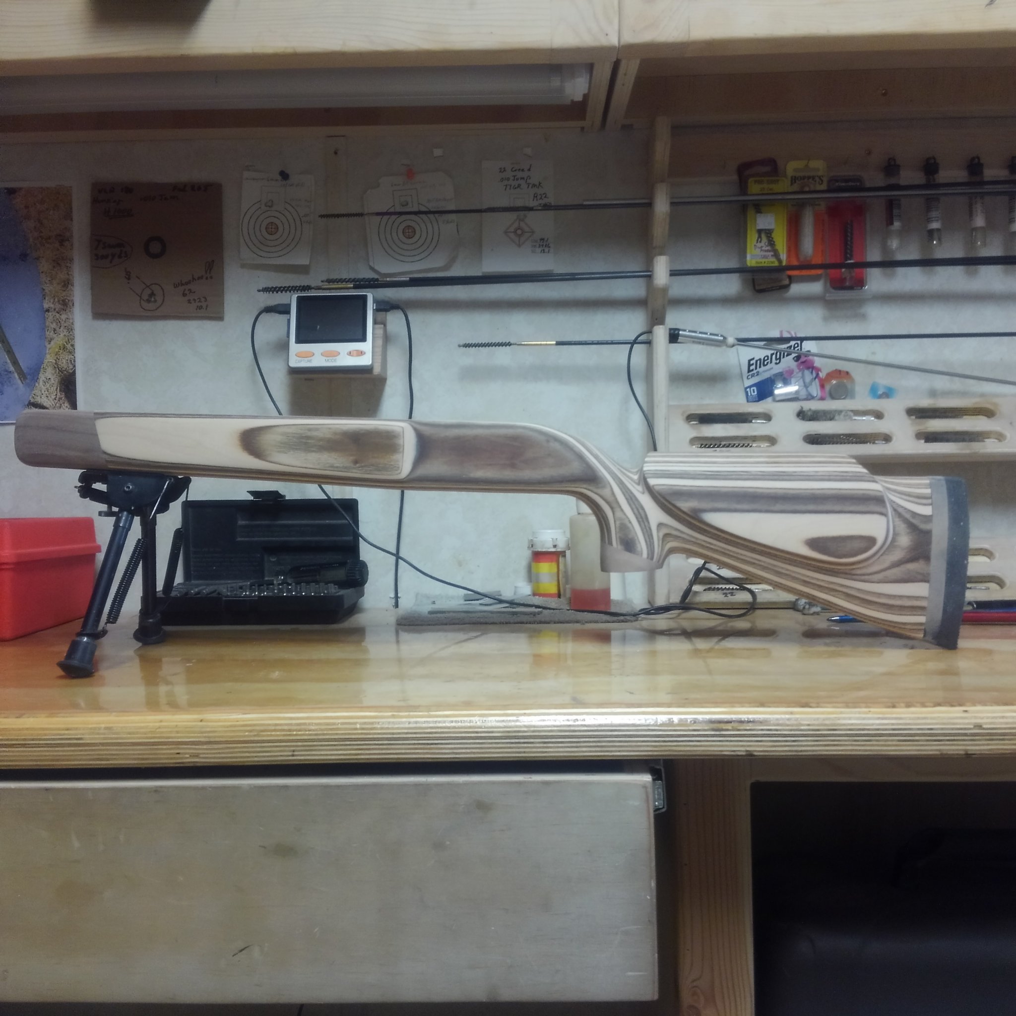

Jul 26, 2020
68
32

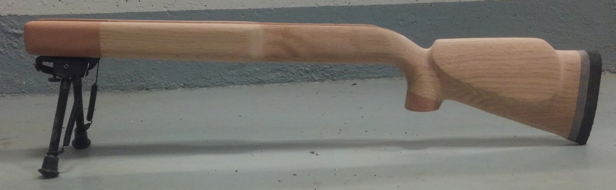

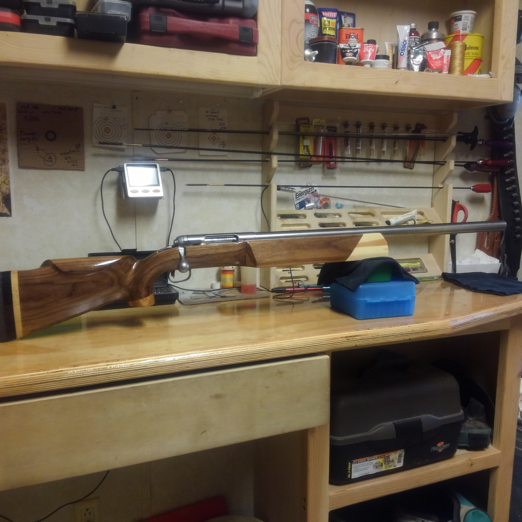

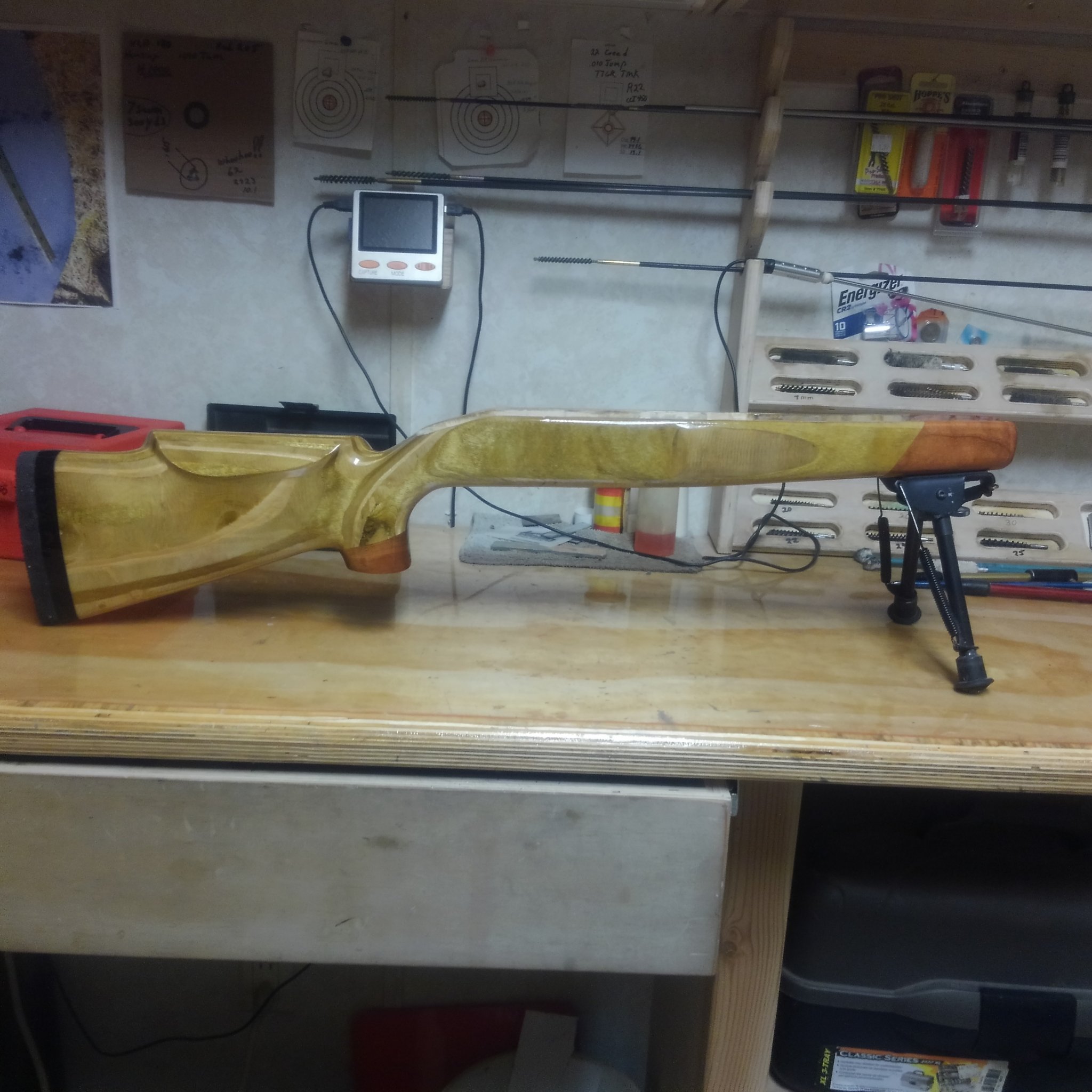

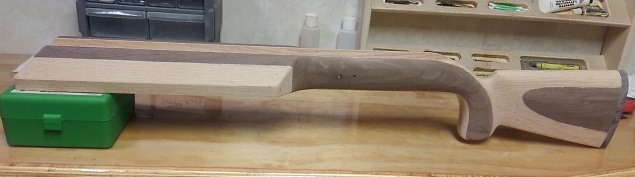

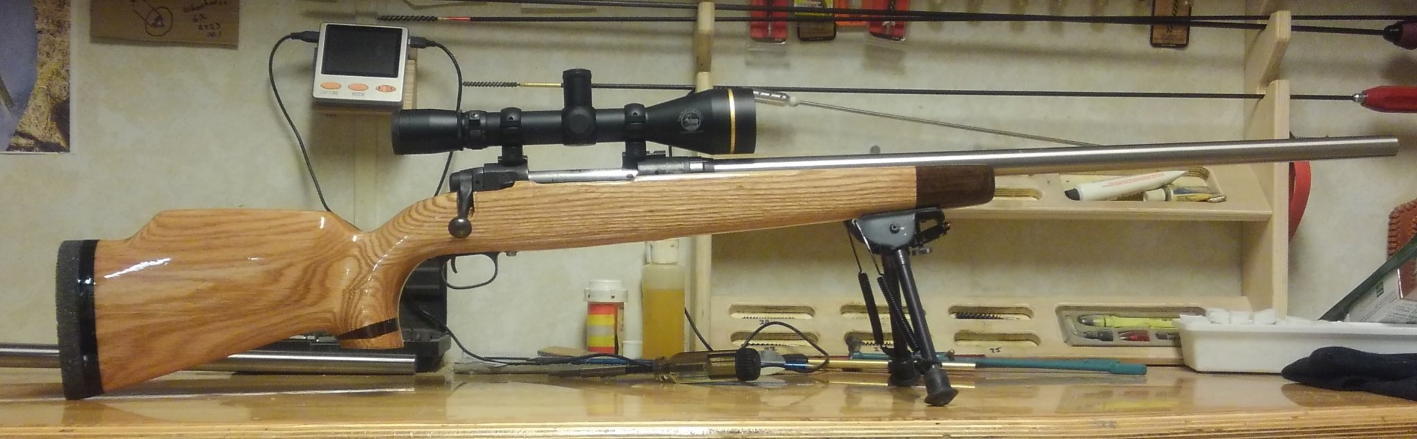

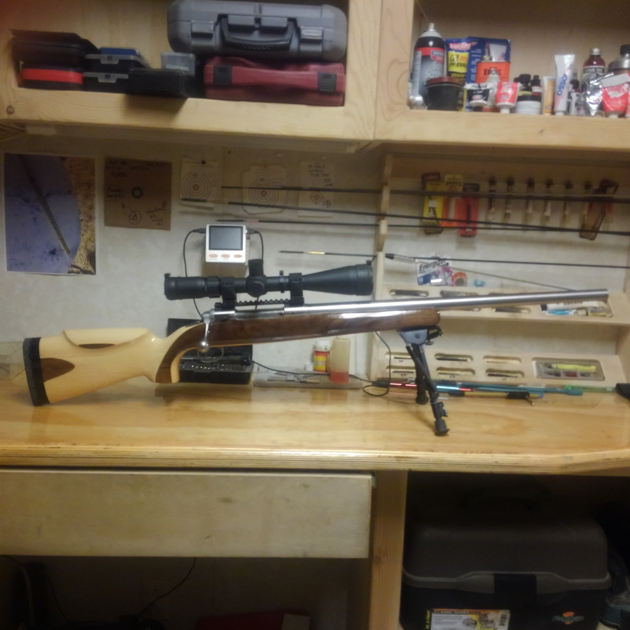

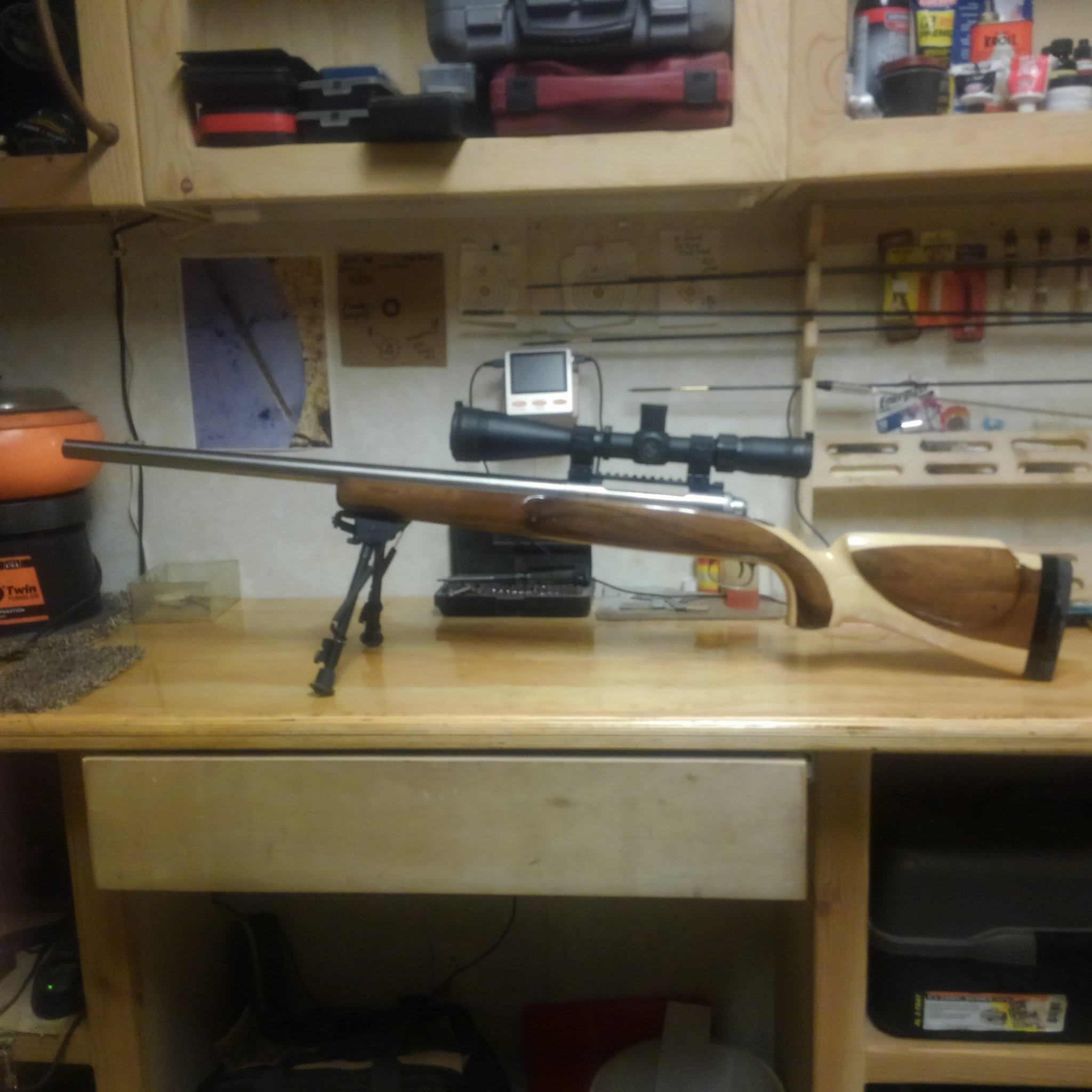

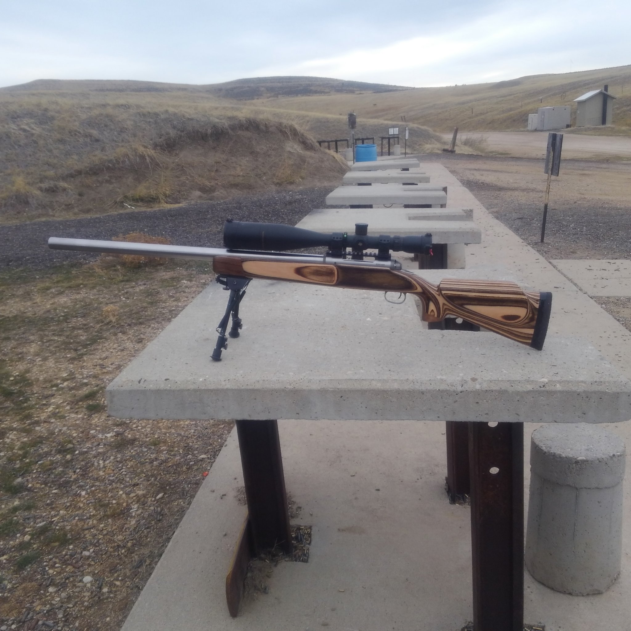

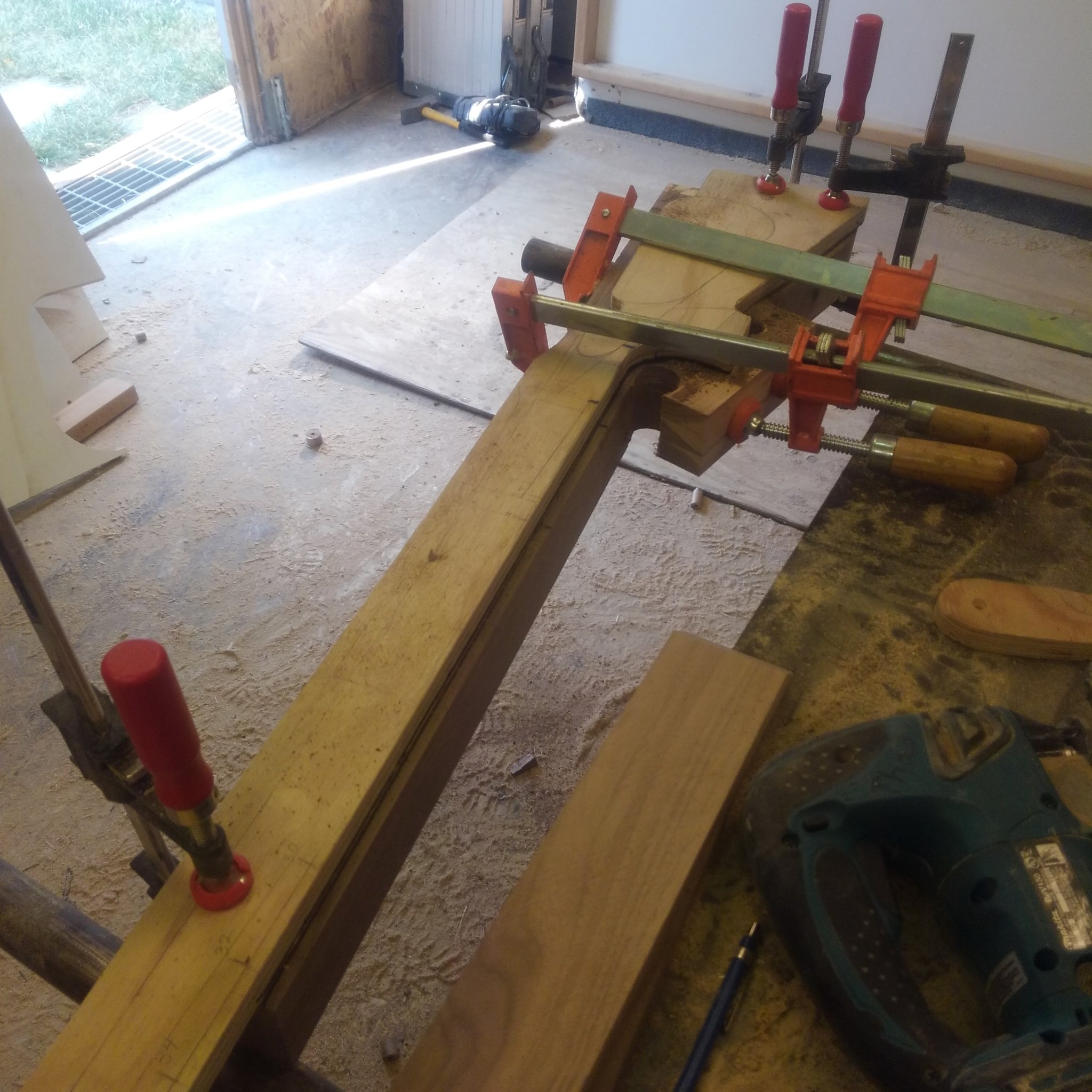

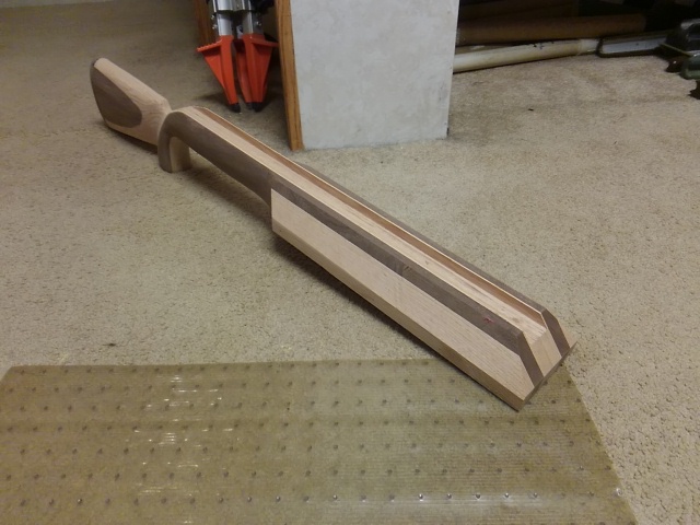

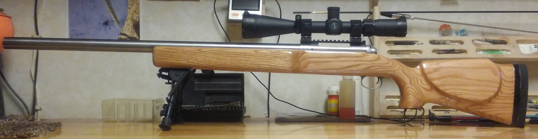

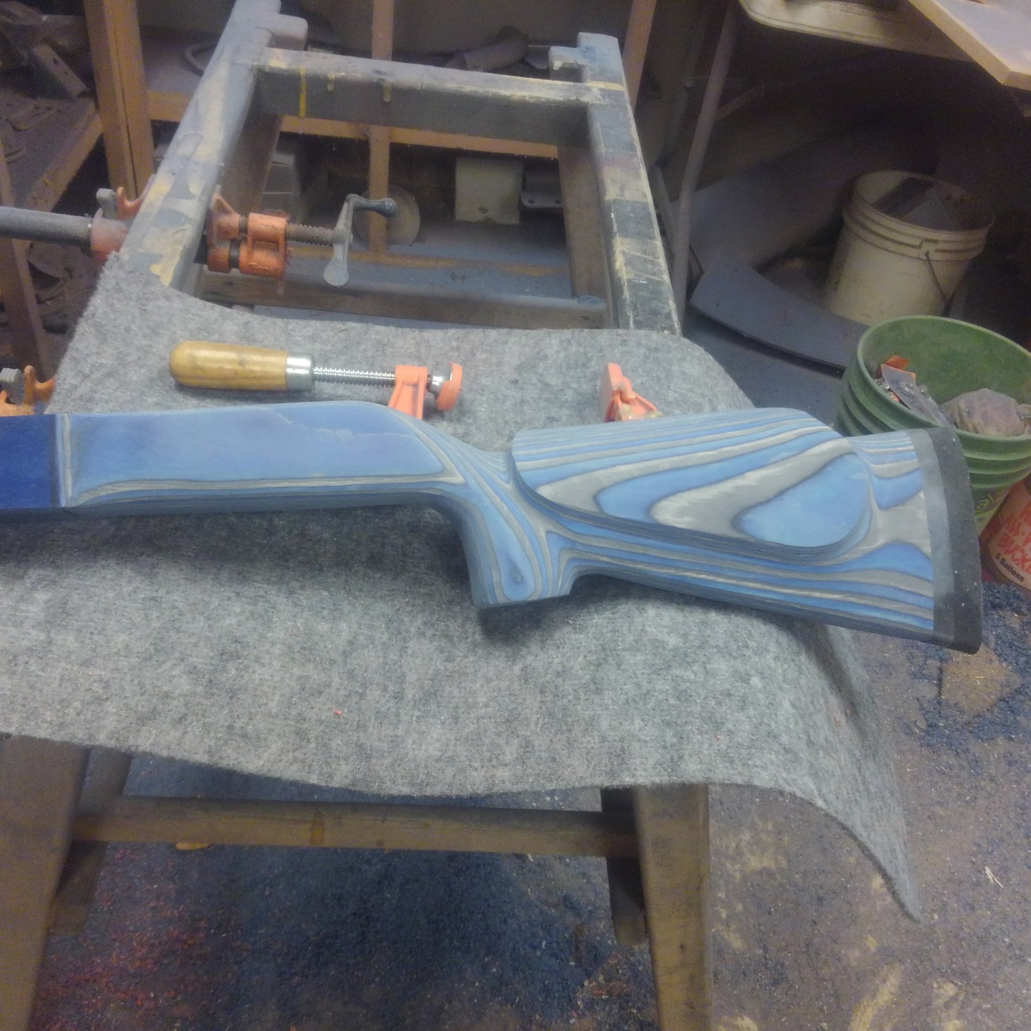

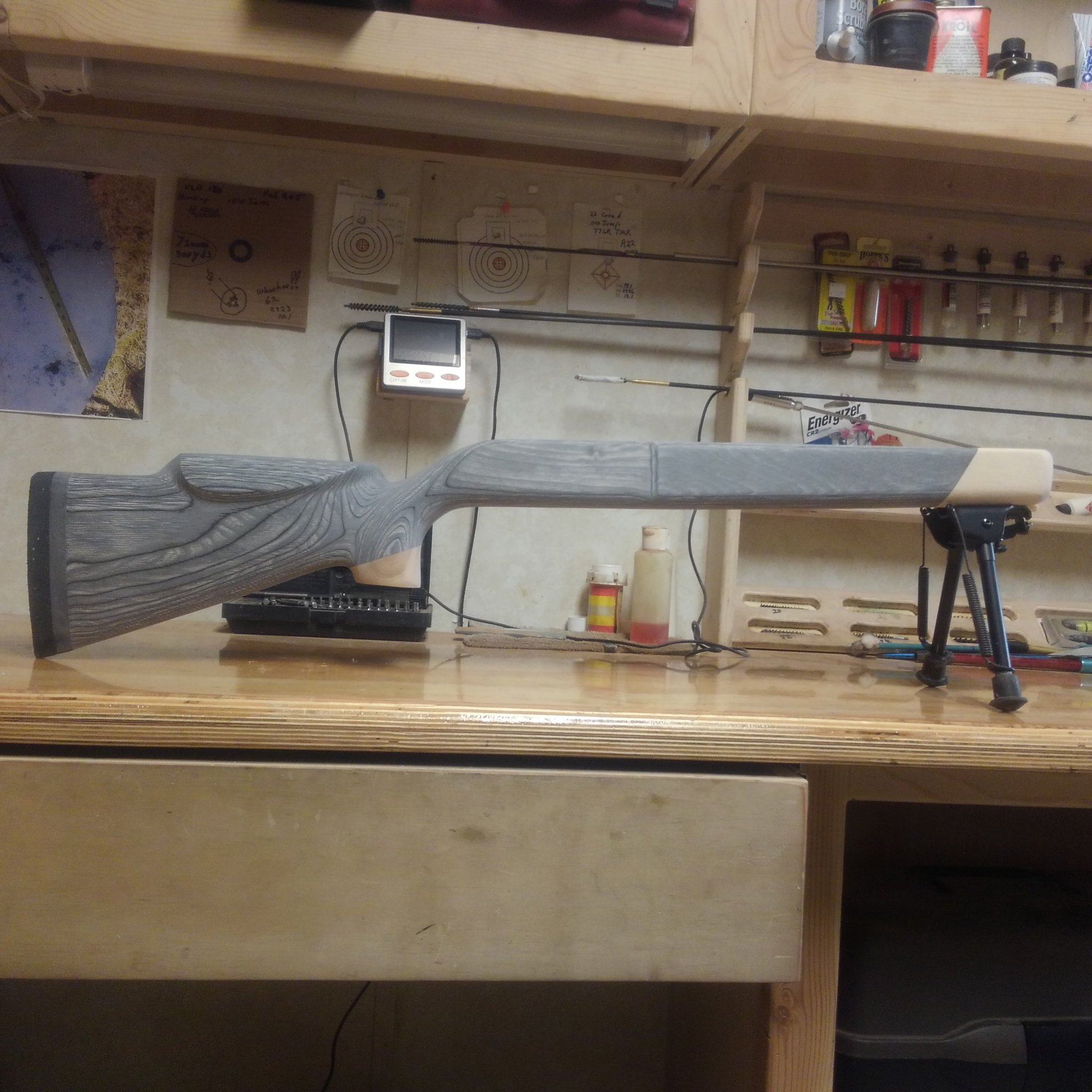

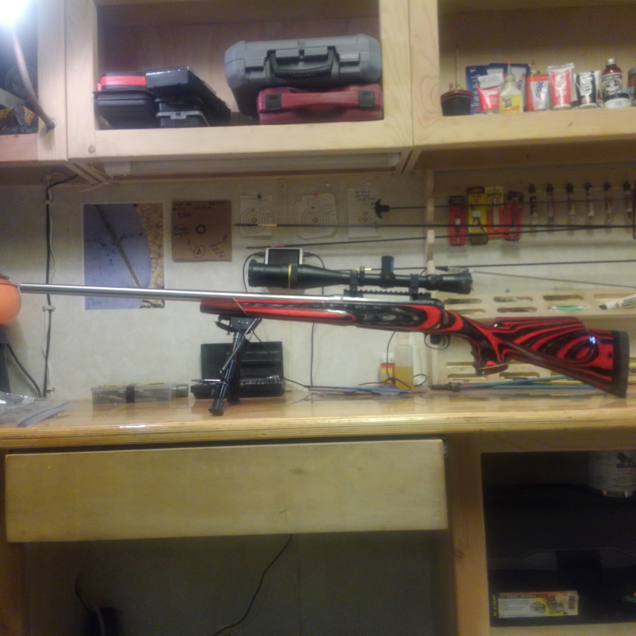

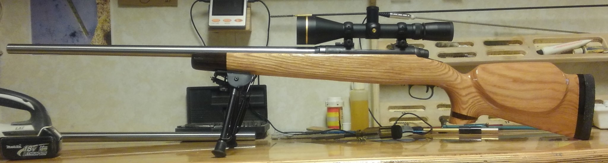

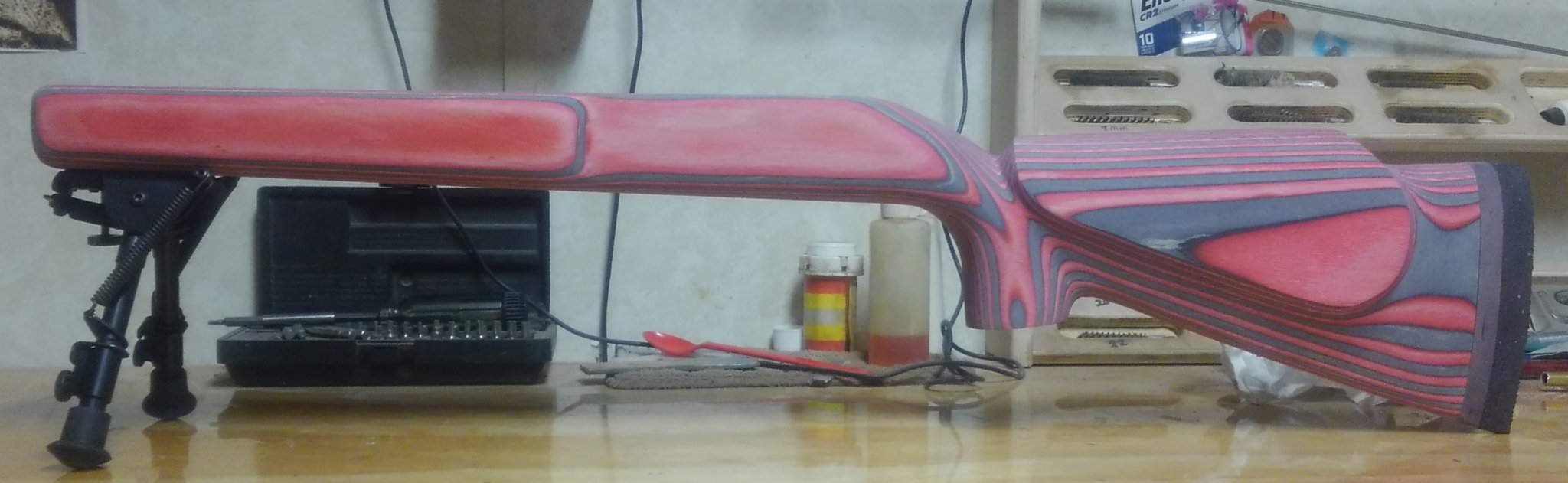

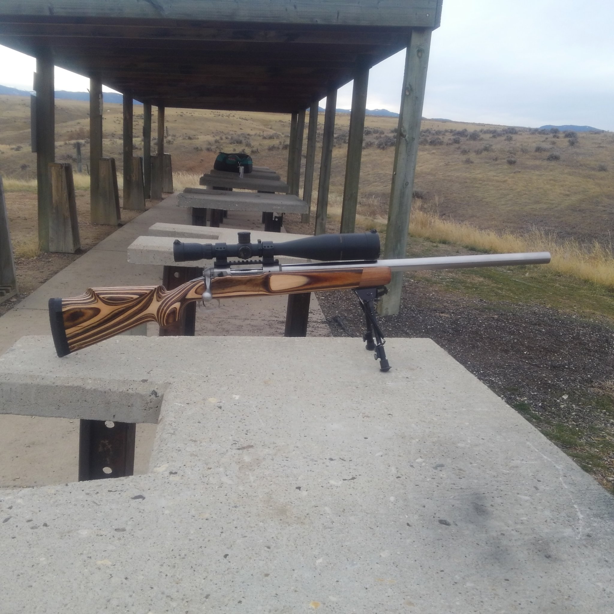

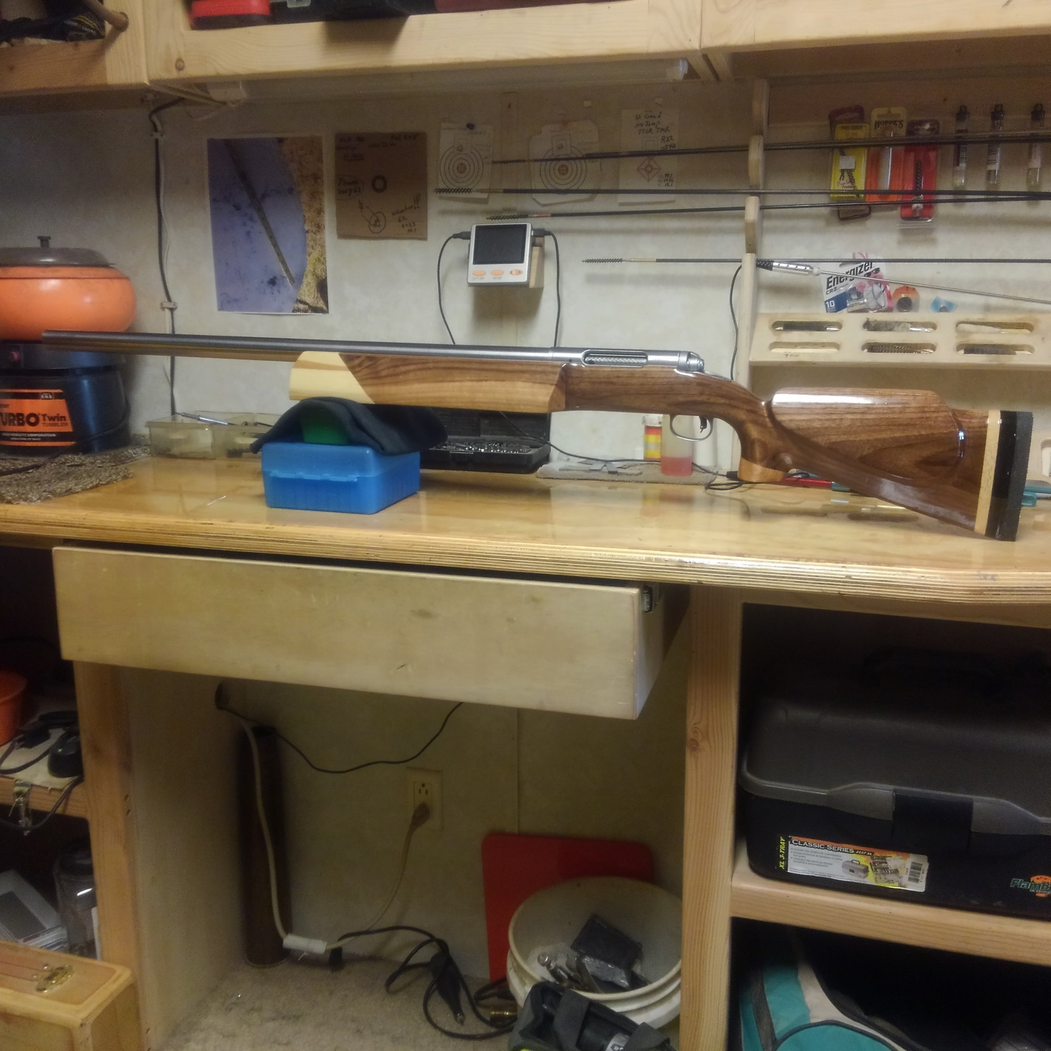

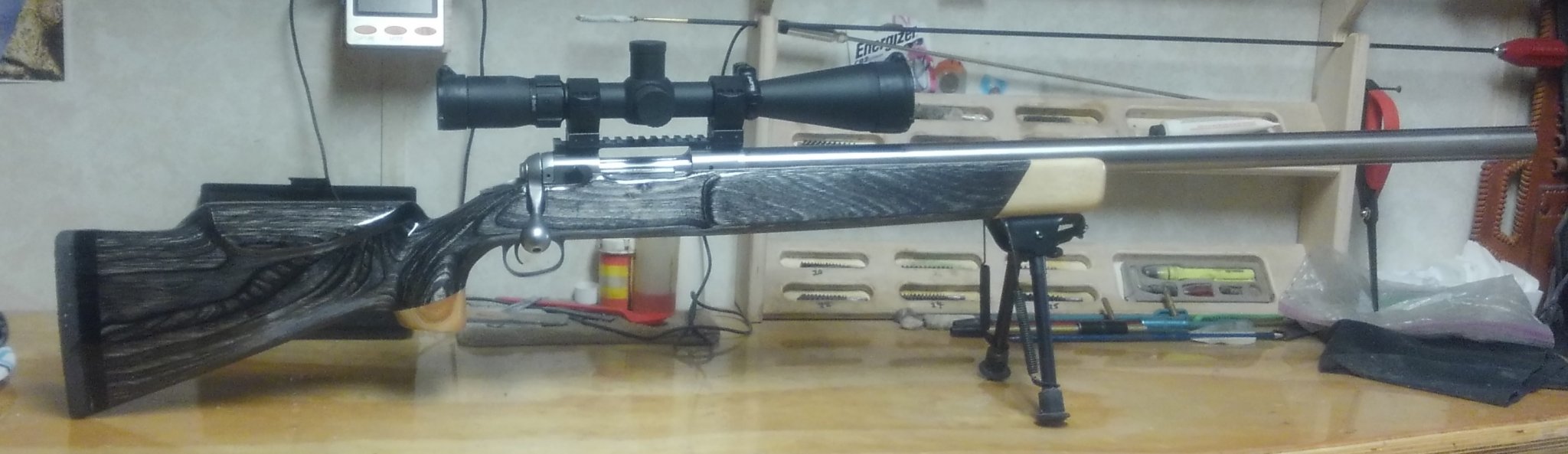

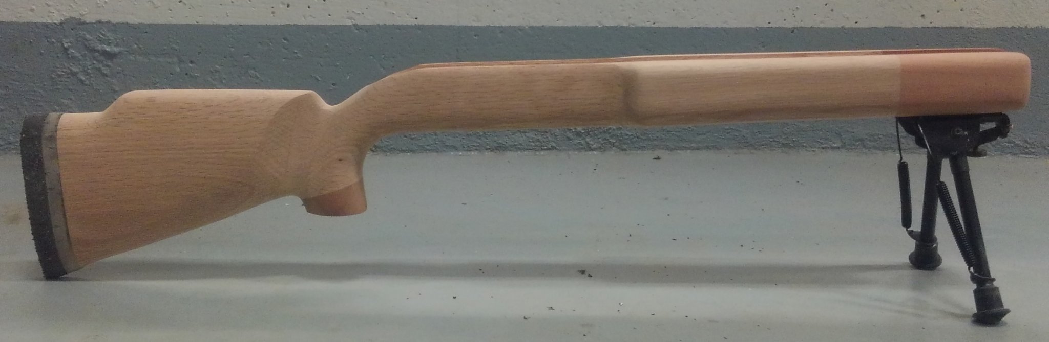

I know the chassis is all the new fad but just not for me, I prefer wood or Mcmillan stocks. Many of those really dont suit me either so out of necessity I started building my own.
It took several tries before I finally started getting the hang of it so usuall built with inexpensive woods until I finally ordered my first blank from Boyds stocks. Still not exactly what Im wanting but Ive got some ideas for future builds.
Anyhow, Would just like to show n tell a little.
Dont look too close, There are some mistakes here n there.

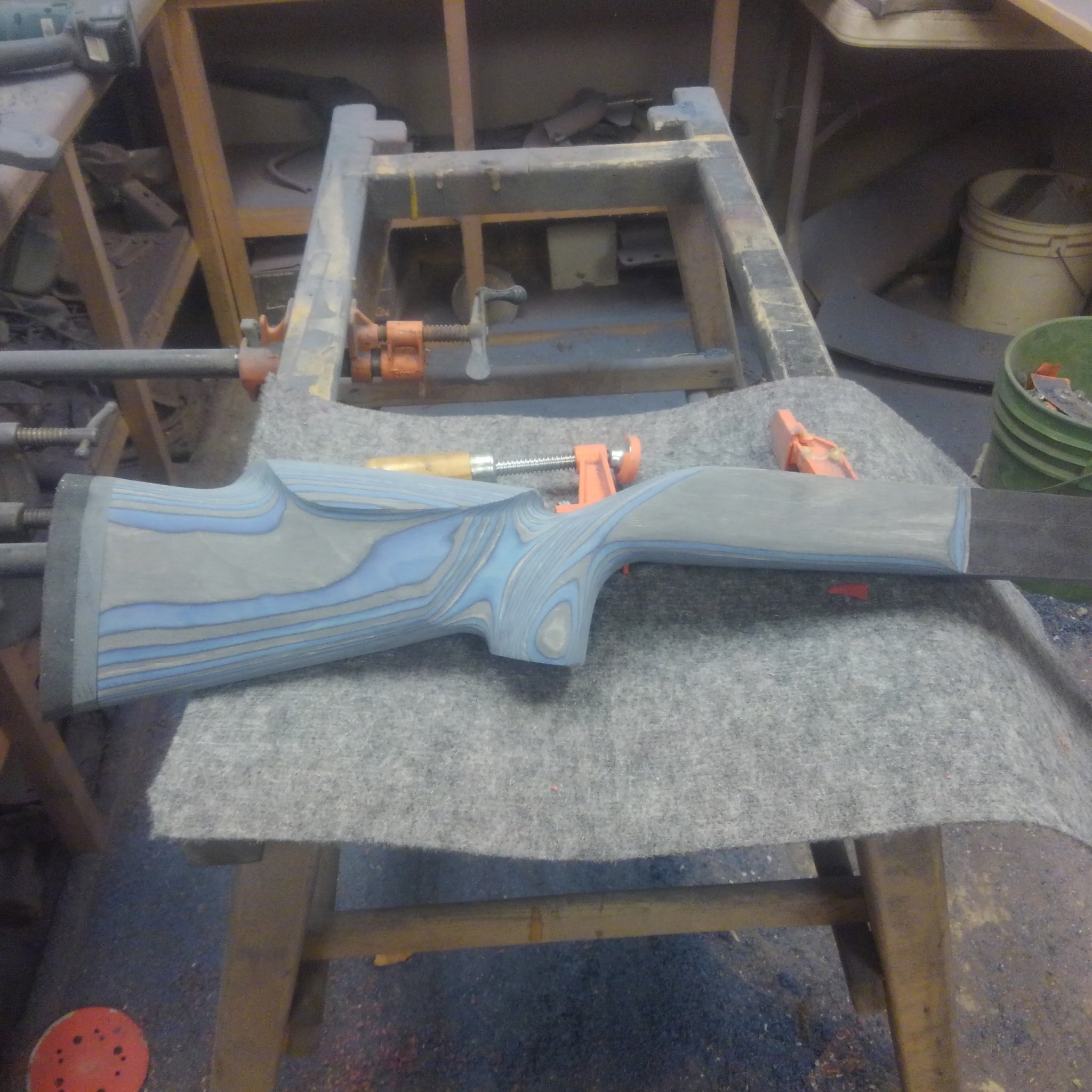

Thanks for the compliments, Im hoping things will get better as time goes on since Ive got 4 blanks ordered. I just cant believe that a person has to wait up to 6 months to get a nice stock when I can usually rough one out in a couple hours and be shooting it in a week using not much more than a router and angle grinder.
Is anyone else building stocks by hand that might be able to give me some tricks or secrets to help get my inletting done more proficiently? At present I rely a lot on bedding to fill my mistakes.
I bought a stock duplicator from Radarcarve about a decade ago...not the most rigid machine out there ( I did some mods to remedy this), but it's not five grand either like a Terrco.
If you're doing strictly one-off's a duplicator doesn't make sense (obviously).
But with one, you can rough out a blank made from whatever you got, quickly shape/fair to what you want with the help of Bondo. It's must faster getting to the end, if you know you can quickly work with Bondo to get there. Inletting? for the pattern stock- it's cut out rough and oversized, then an action is bedded into it. This gives the pattern stock precise inletting.
Once a pattern stock is made, I've used it to help cut another one- then do slight modifications to it (wider forend, different grip shape, etc.) to create a new pattern. Makes the process much faster.

I have this bookmarked , It looks like the same machine. I just cant justify the money for making a few stocks here and there. Would love to have one though.
Years ago I had Joel Russo send me a pattern that I altered with bondo and sent it back so he could duplicate it for me. Prices on his stocks have gone up considerably and still that 3-6 month wait period.
As for inletting, Ive been using a mill but even that sometimes gives me trouble trying to get everything measure out right, Ive been cutting a little large and still having to hand dermal to get the spots that rub or touch.
This is supposed to be a hobby out of necessity and at the present time Im not wanting to invest a lot of money into it. I dont build very many rifles annually.
Have you looked at Richards Microfit??
A LOT of different designs, much more than Boyd's.
They are unfinished, and the inletting is rough- but that's not a consideration with your skills.
Yes, I purchased a Wolverine stock from them, Turned out really nice, wish they offered it in a wider forearm though.
Roughed in another one this morning
It's a grey laminated blank from Boyd's and I put hickory caps on it. Should look really cool when I get a sealer on it. The grey should get a lot darker and the hickory should stay about the same color.
Next is aluminum pillars and the finish the in letting
It's 34" long but I have a barreled action with a 30" shillen barrel with a 1.22" contour with no taper.
Hope I don't mess up now,

They are getting easier every time I build another. I ordered two more blanks. A coyote laminate and a pepper laminate. Im thinking about cutting up the pepper laminate to use for the forend cap and grip cap. We'll see what happens
