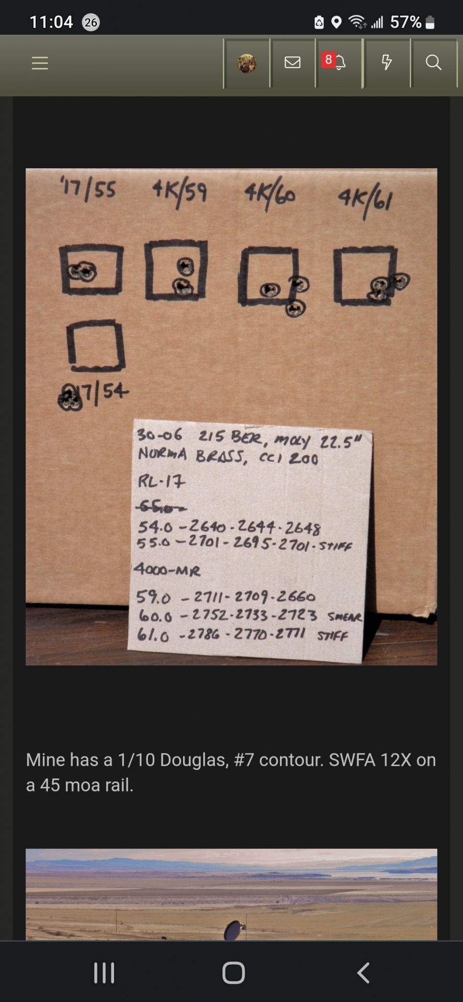

What I will be using because it is what I have. However, just have sporter barrel. Will just be taking my time between shots. Getting back in the game and want to make sure I still enjoy it before shooting my load.

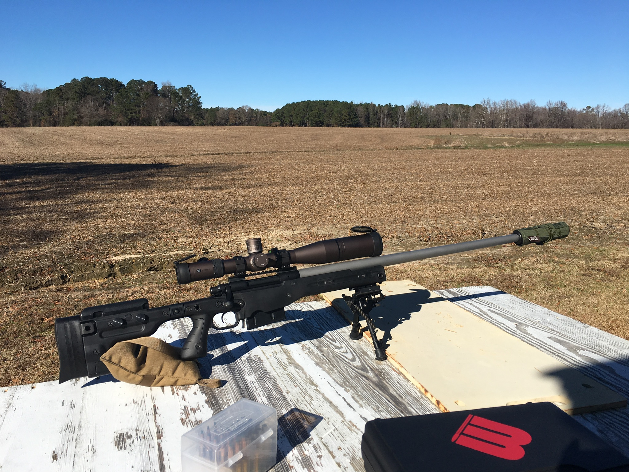

Worked over 700, Vortex HD LHT 3-15x50 G4i reticle, 28 inch Krieger, Serengeti chamber. 53.8-54 RL-17, FGMM 215M, 215 Berger Hybrids. LC 67 Match, fully prepped. Rifle work, chambering, etc. all done in the garage.
Last Saturday lighting the Magnetospeed hit indicator velcroed behind the E silhouette at 1200.
Load is very hot in the high 80 weather.

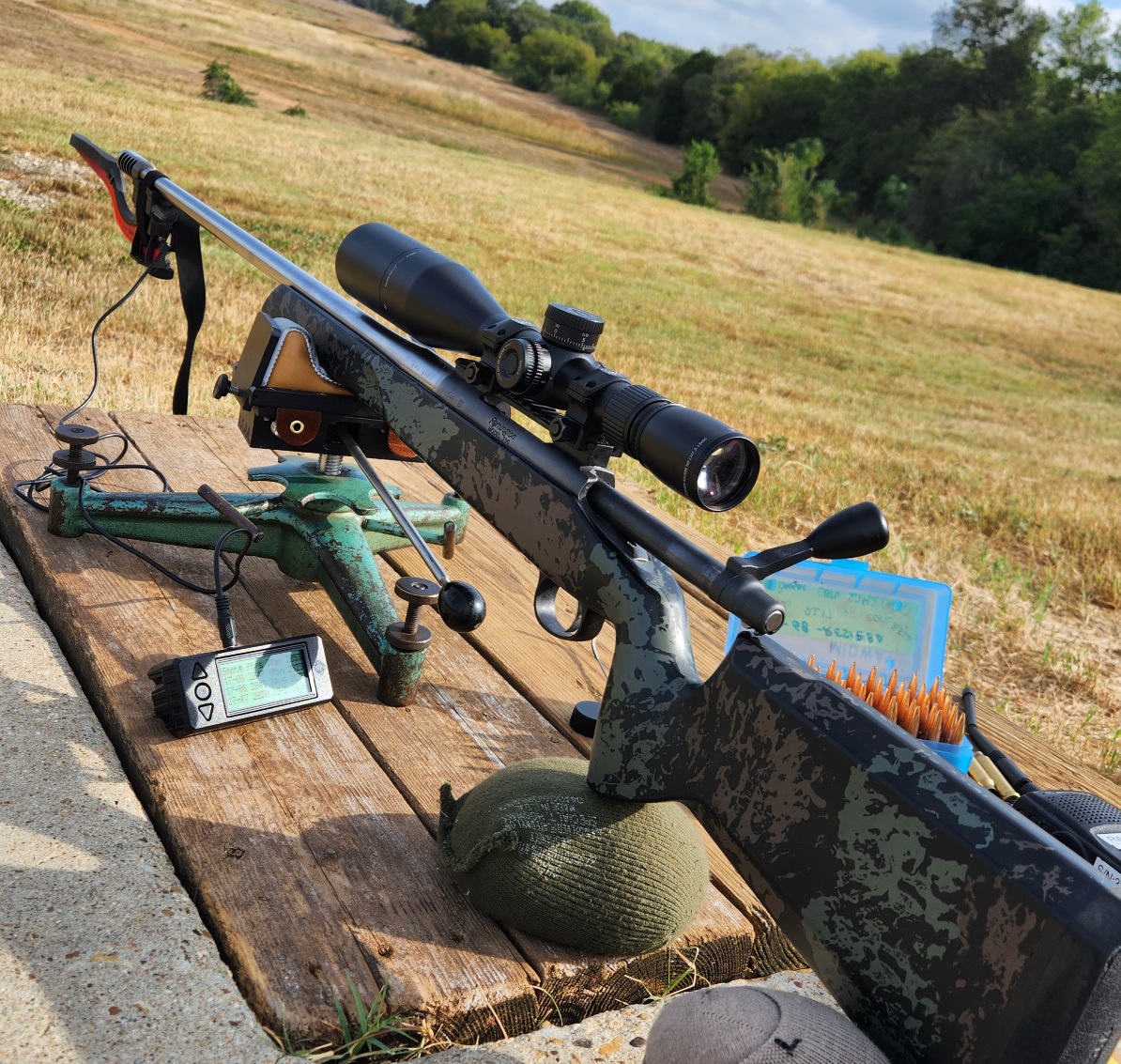

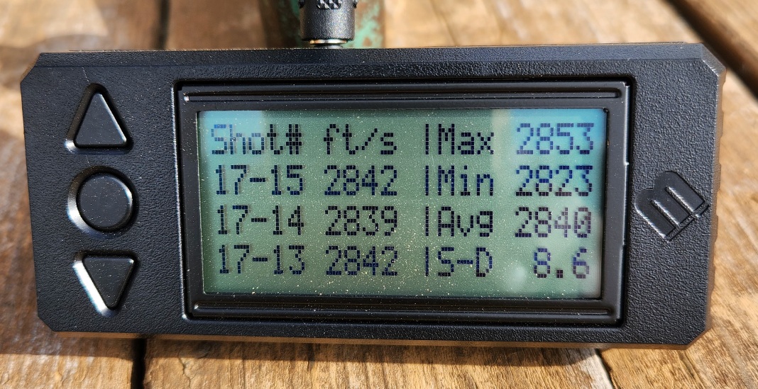

View attachment 7980892View attachment 7980893
That load seems very hot!
Reactions: jvette73

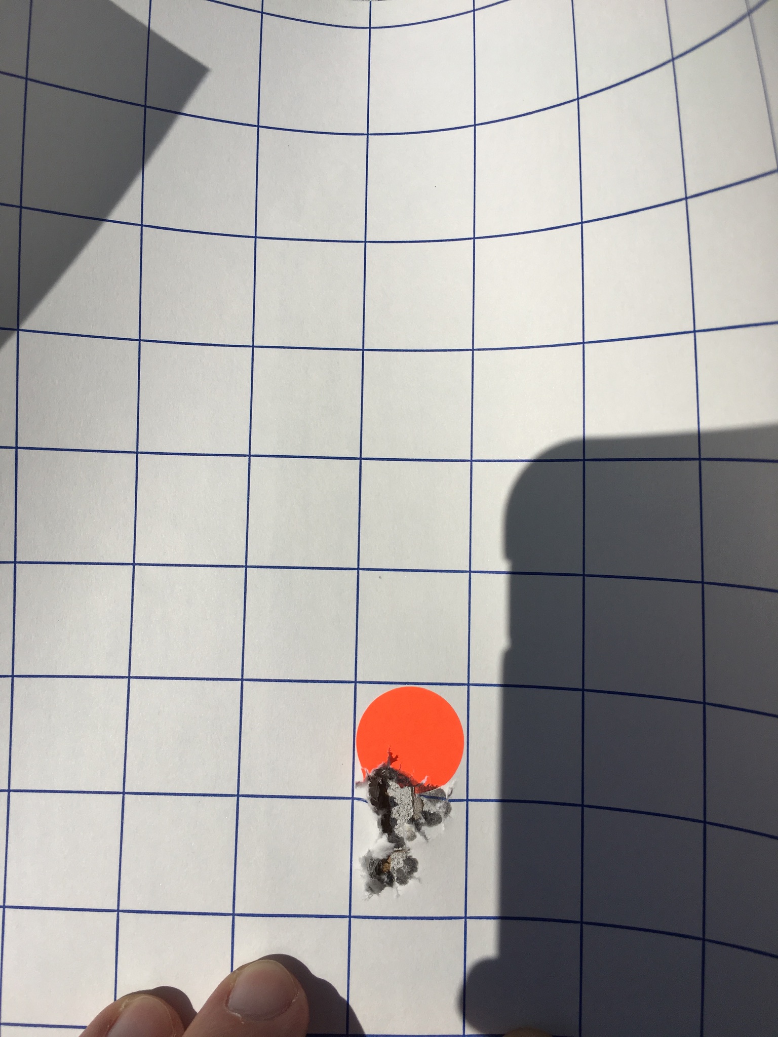

Here is my 30-06 and a 5 shot group it pit down the day I brought it home from a rebarrel and loads from my previous barrel. I think it had about 10-15 rounds down the barrel at this point. Rem 700 action, 28” Bartlein barrel with PT&G Serengeti “rev D” cut chamber and my TBAC U7 on the end.. it still hammers with around 1k down the bore now I’m shooting berger 200.20x’s, lapua brass, 59.0gr H4831sc and that puts me at a avg velocity of about 2760. I have pushed it to about 2820 with that same bullet but primer pocket life took a dump so I backed it down. I only shoot to 1,000 yards anyway so it’s plenty.
edit to add: thats a 1/2” dot I was shooting at.

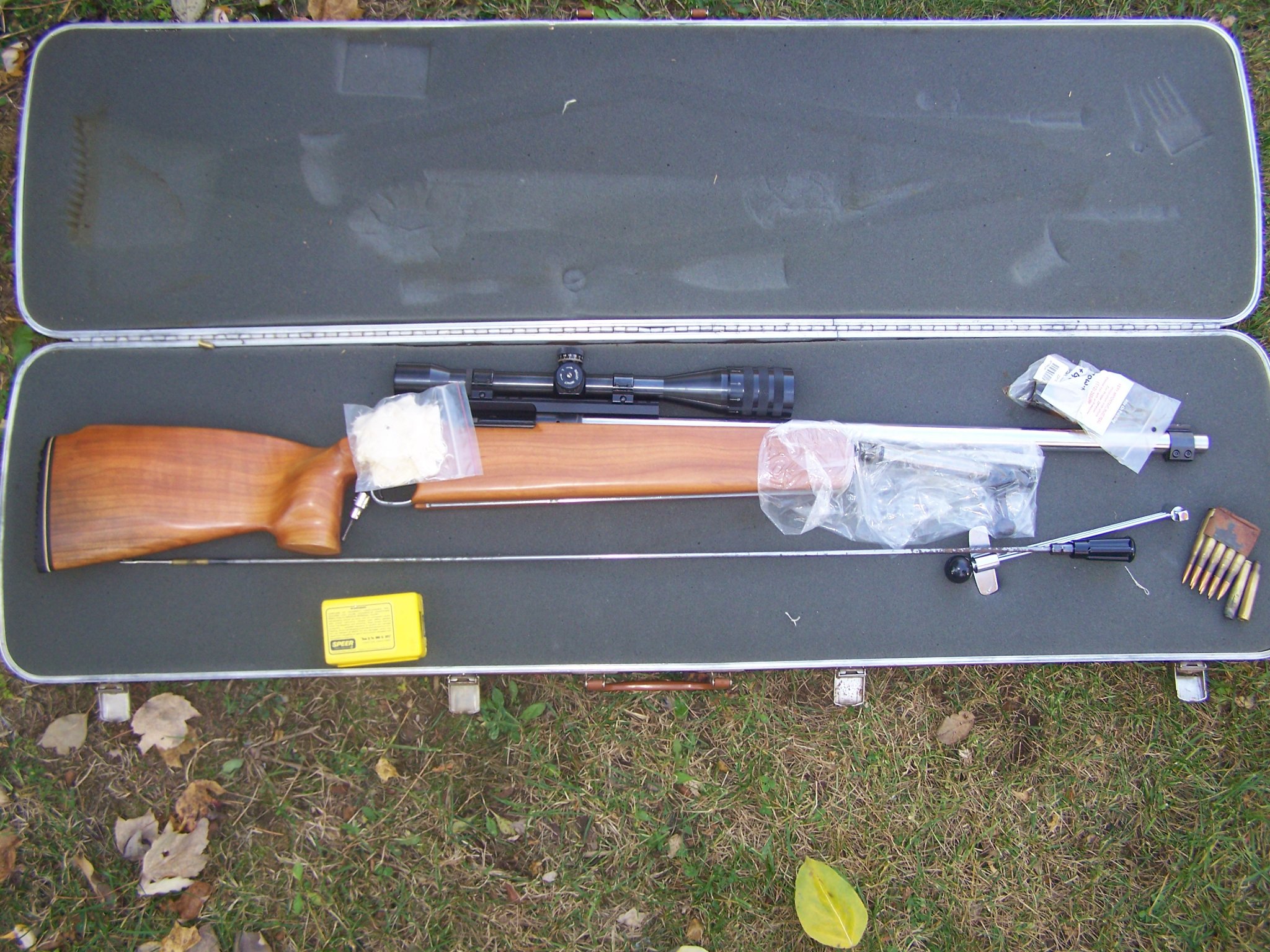

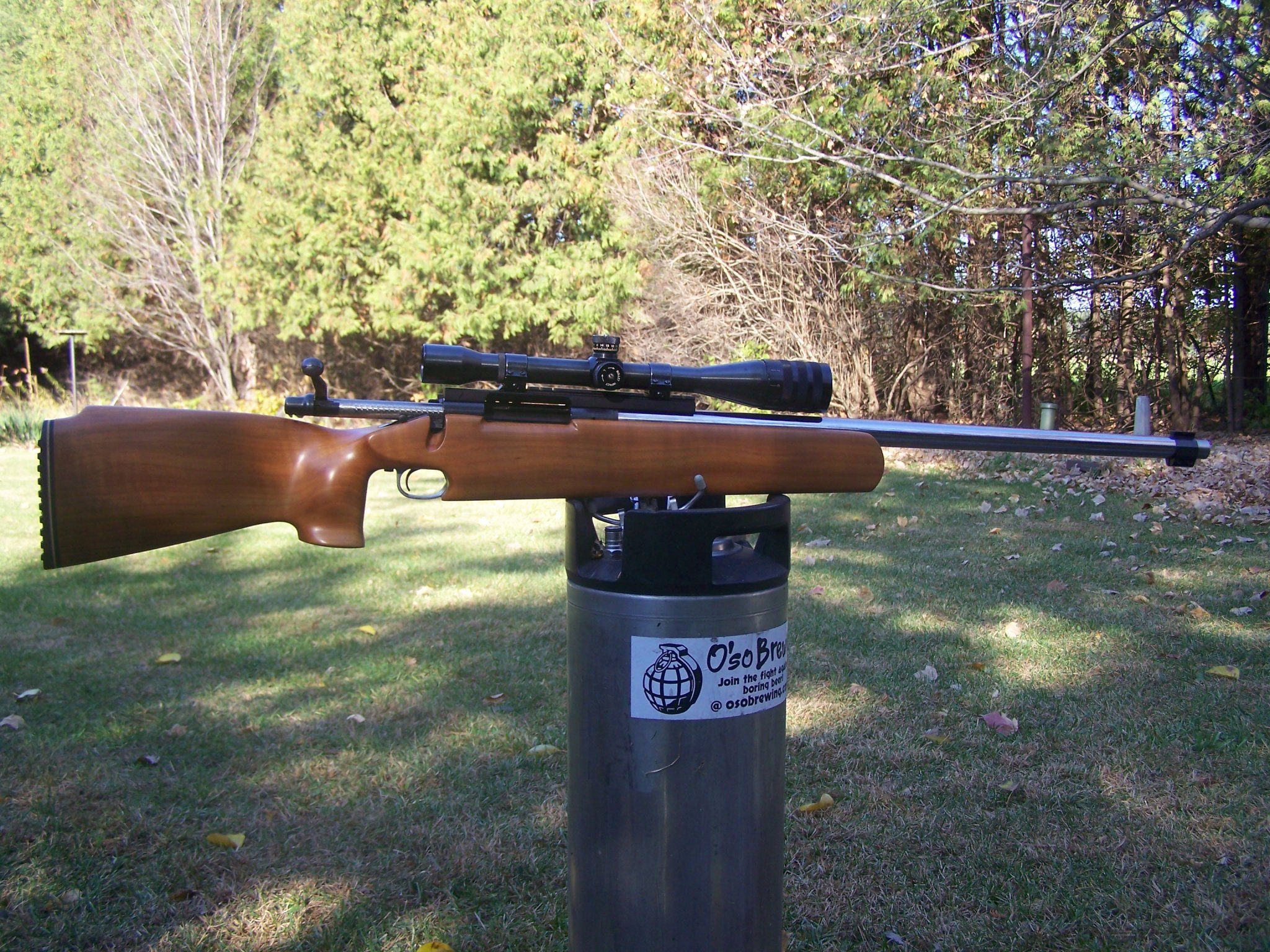

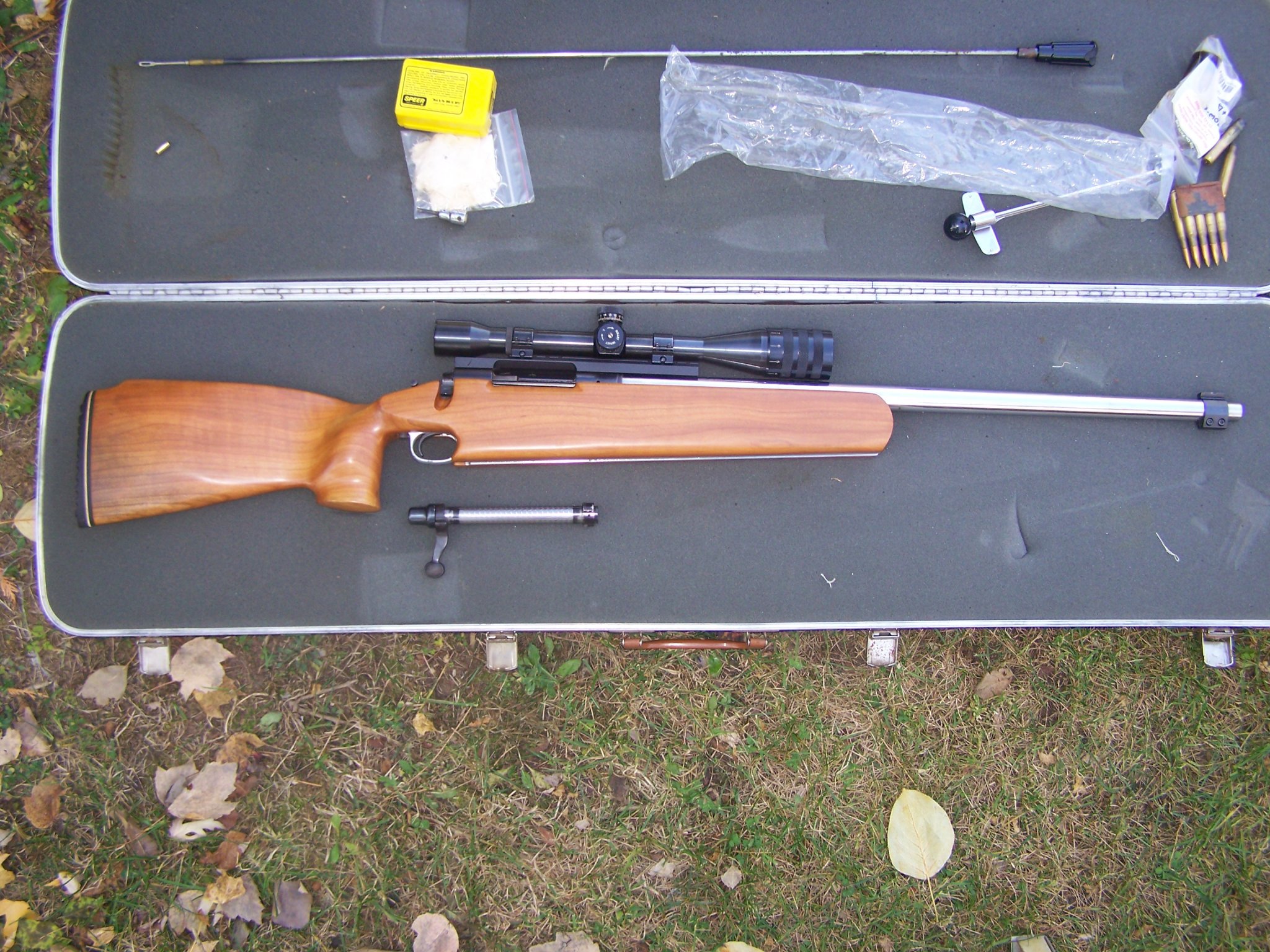

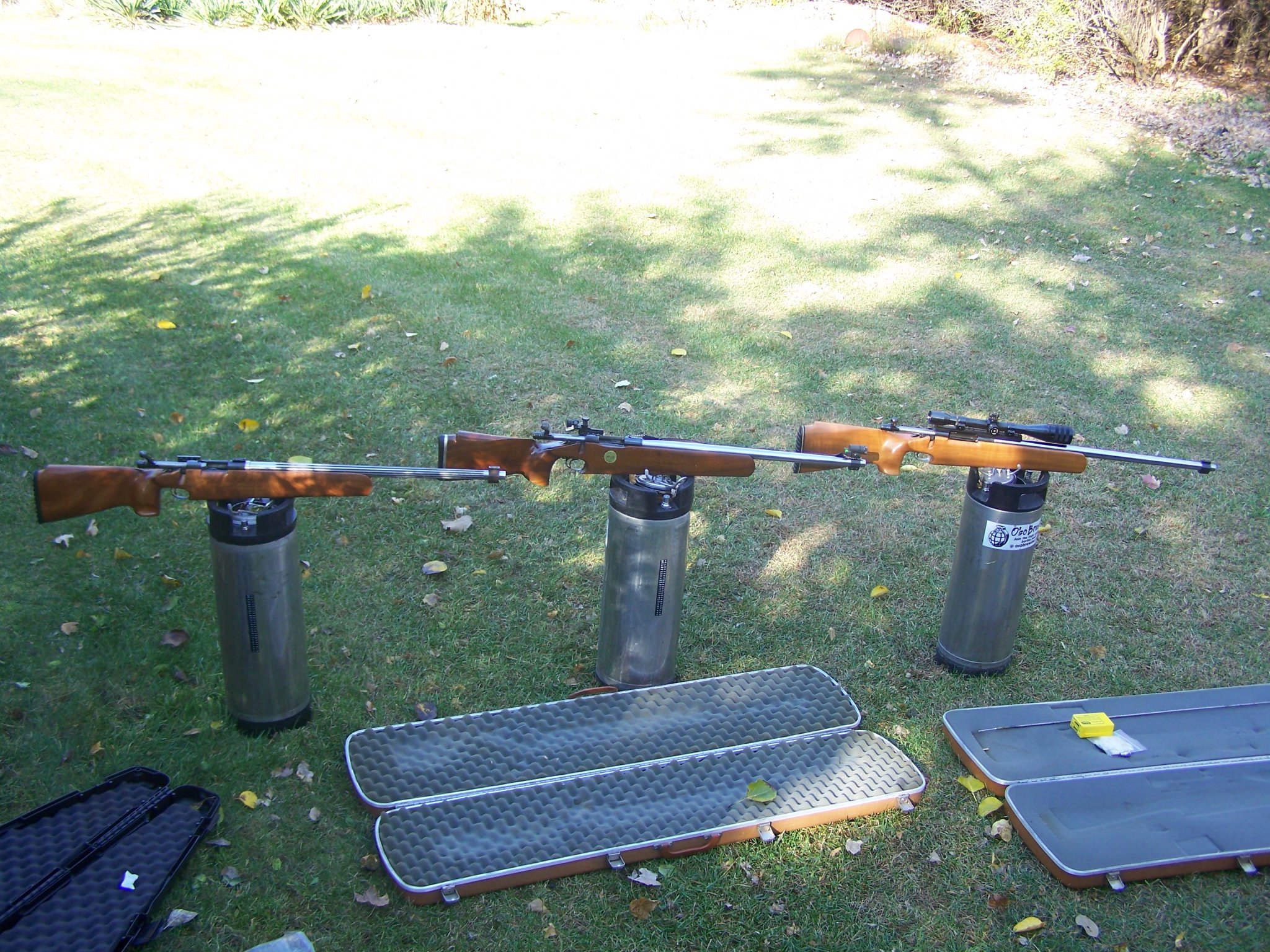

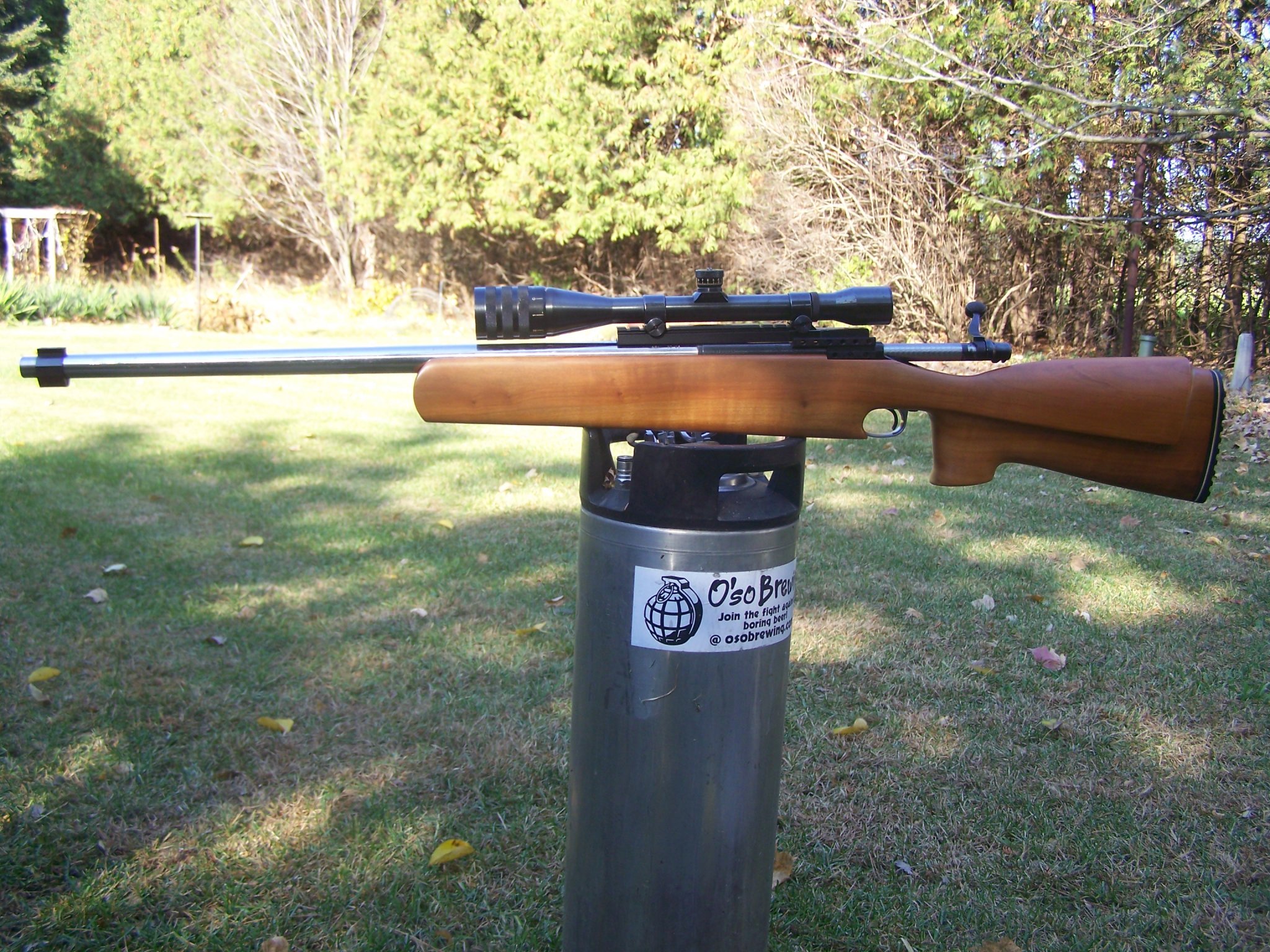

It was past dusk yesterday when I read your post so took some photos earlier today when the light was better.
First photo is the 06 in the case and second photo is all the accoutrements moved out of the way. The third photo is the 06 to the far right. The fourth and fifth photos are the two sides of the 06.
Yes it is old but just taking it out of the case and setting it up for the photos made me smile. Thanks for requesting.
