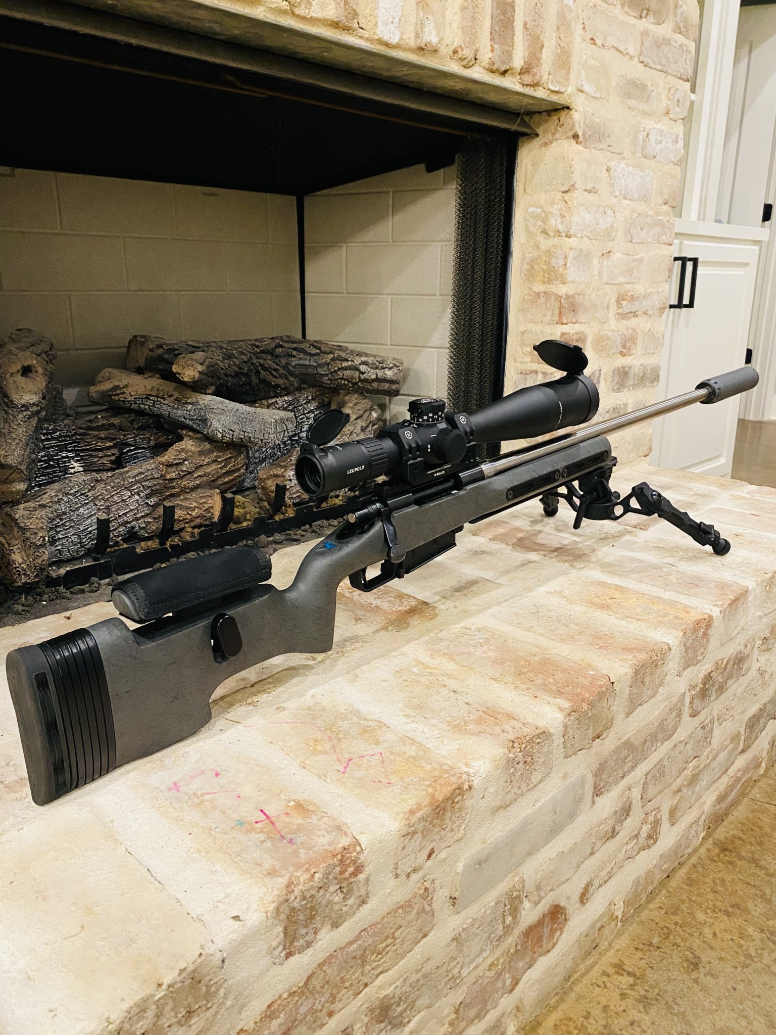

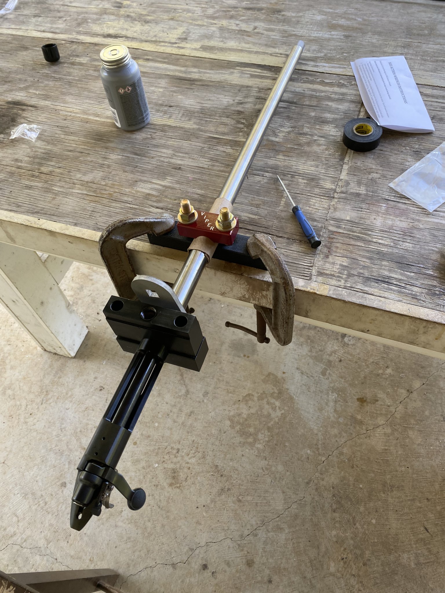

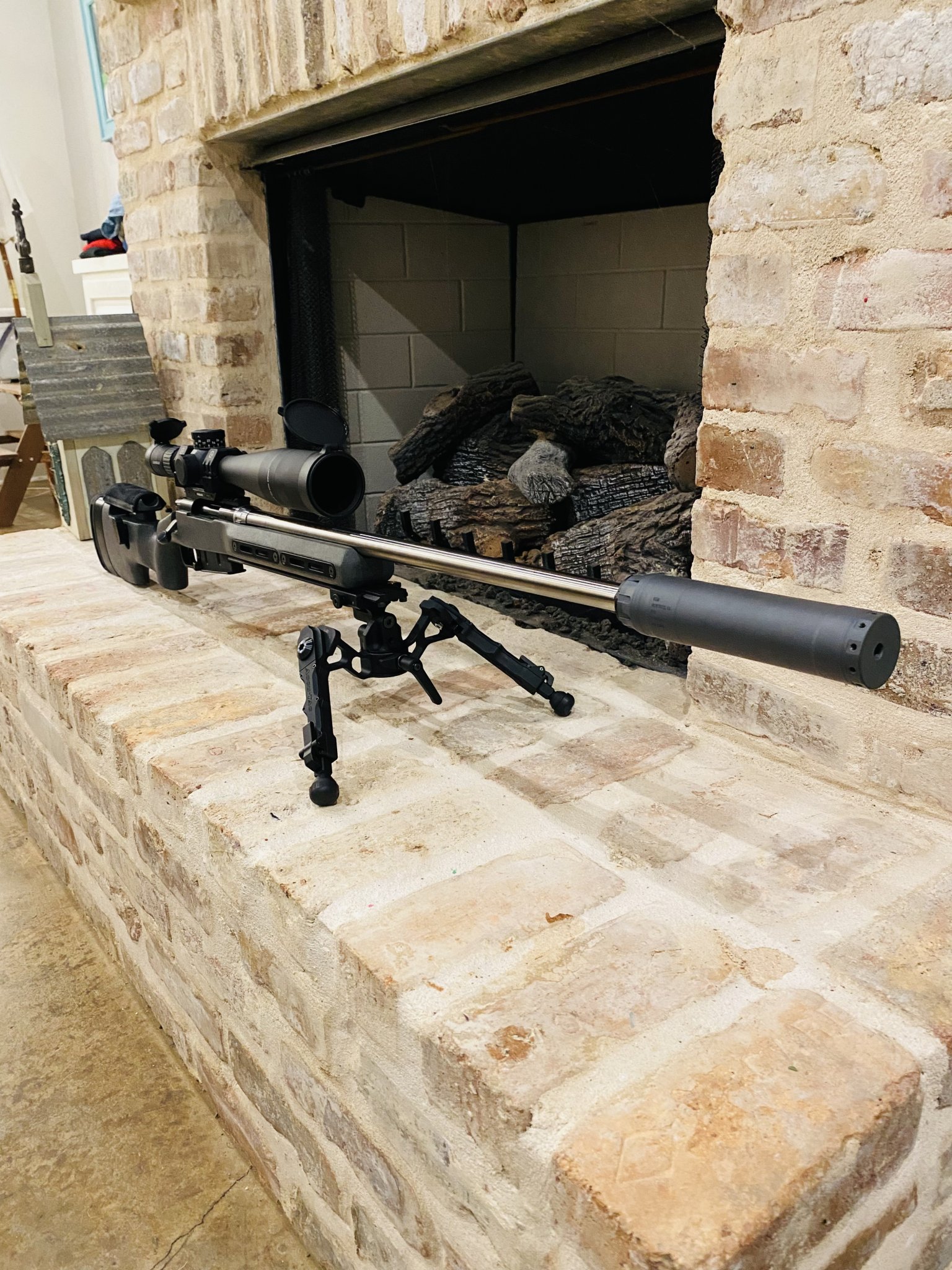

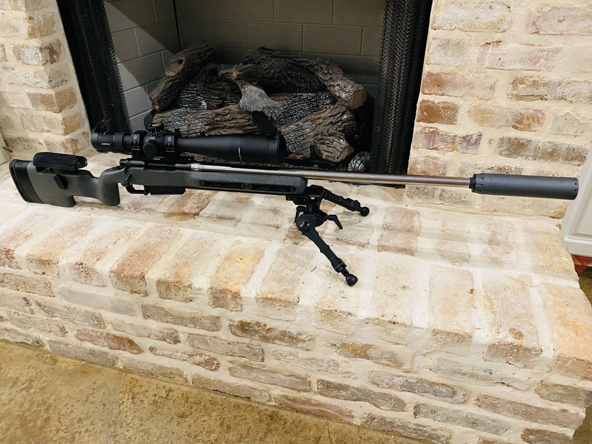

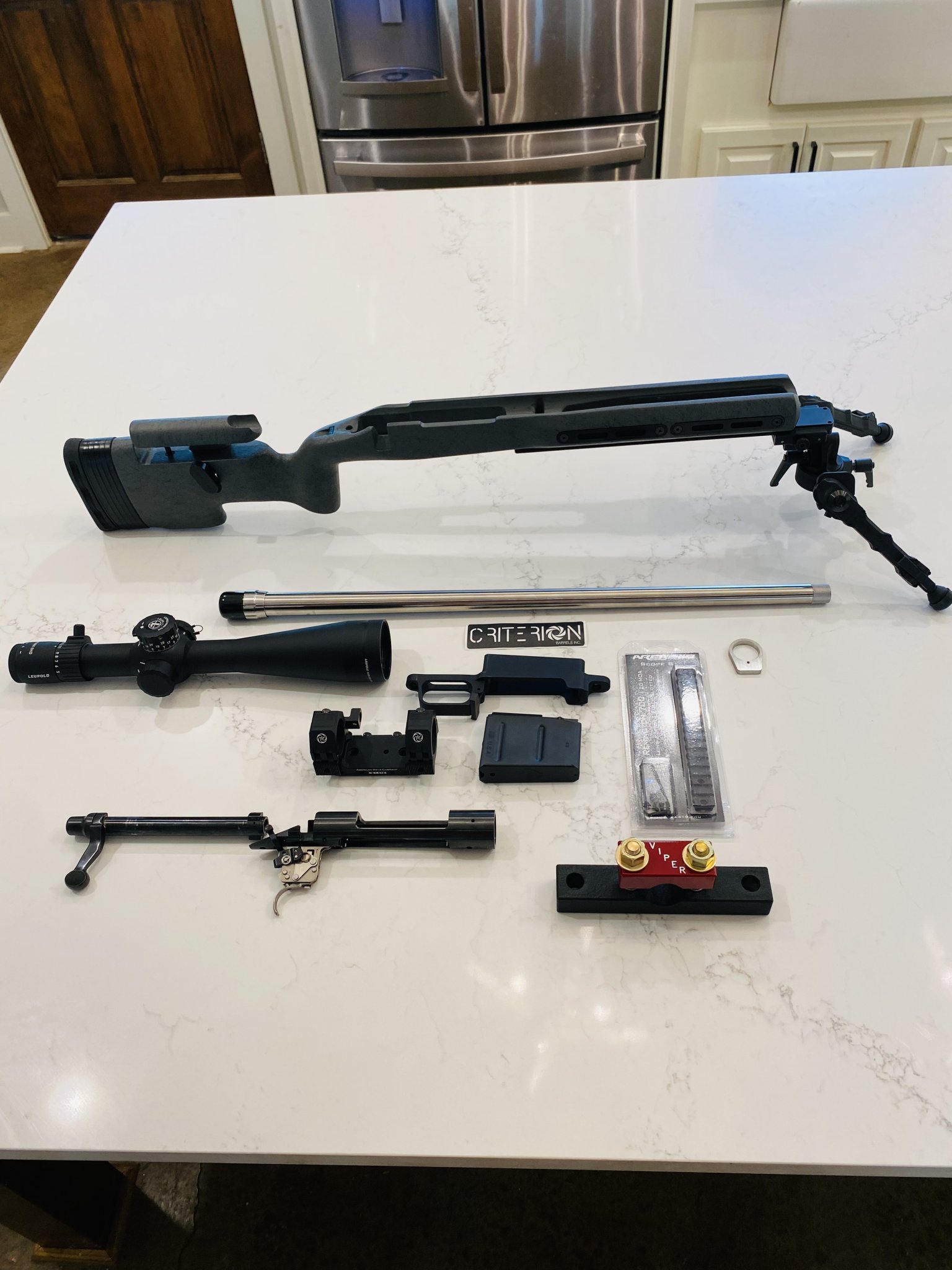

Finally got around to assembling my first bolt gun. Plan is to shoot out to 1000 yards for fun and maybe do some deer hunting from box stands or my back porch. Gun ended up a little heavier that I thought close to 20lbs.
Remmington 700 LA
NSS criterion barrel 1-10 twist
NSS recoil lug and barrel nut
Greyboe ridgeback stock
Bedded stock
Greyboe bottom metal
Accu-Tac bipod
Sawtooth arca rail
leupold mark 5 5-25x56 in mils
Area 419 20 moa base
ARC M-Brace one piece mount
Trigger Tech special 2 stage
Haven’t got the chance to shoot it yet but already looking at building another one. Next investment will be some reloading equipment and go down that rabbit hole.

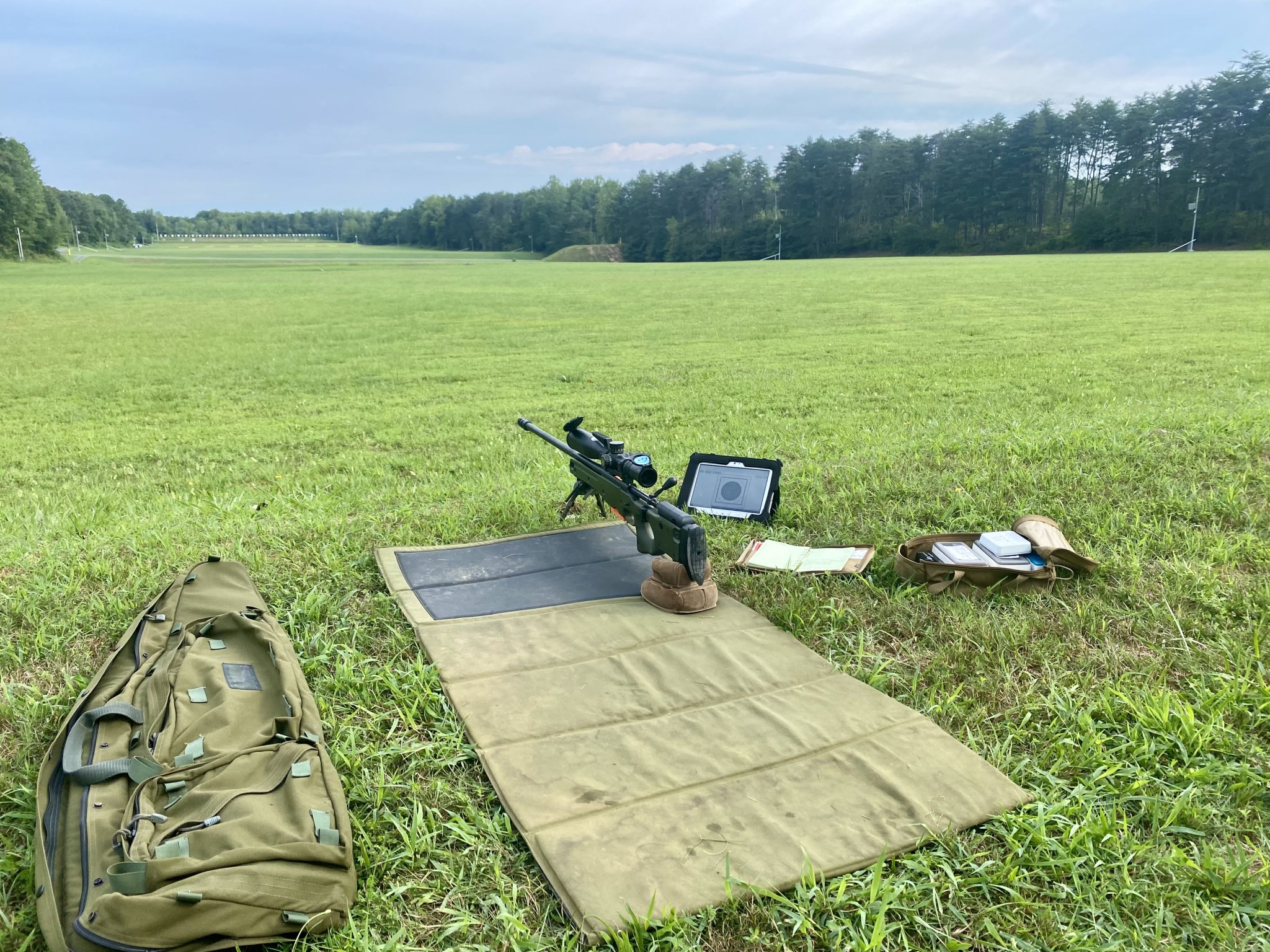

I’ve been running a 30-06 on Quantico’s Range 4 since 2008 or so, first with 208 AMAX, then 208 ELDM and lately Berger 208 Hybrid Target bullets that have all been sent down rage with a German Salazar Serengeti chamber/reamer.
I’m also on my third barrel for this R700 action. Current barrel is a Brux Heavy Varmint 10 twist, finished at 29 inches.
208 Bergers in current barrel run 2730FPS @ 325ASL 70F. The sweet spot for these particular bullets (for me anyway) is between 2710 and 2730 FPS. I’m using Fed 210Ms, Lapua brass and RL17.
In my previous Bartlien 23.5 in barrel I could run the 208 ELDMs at 2750FPS as well.

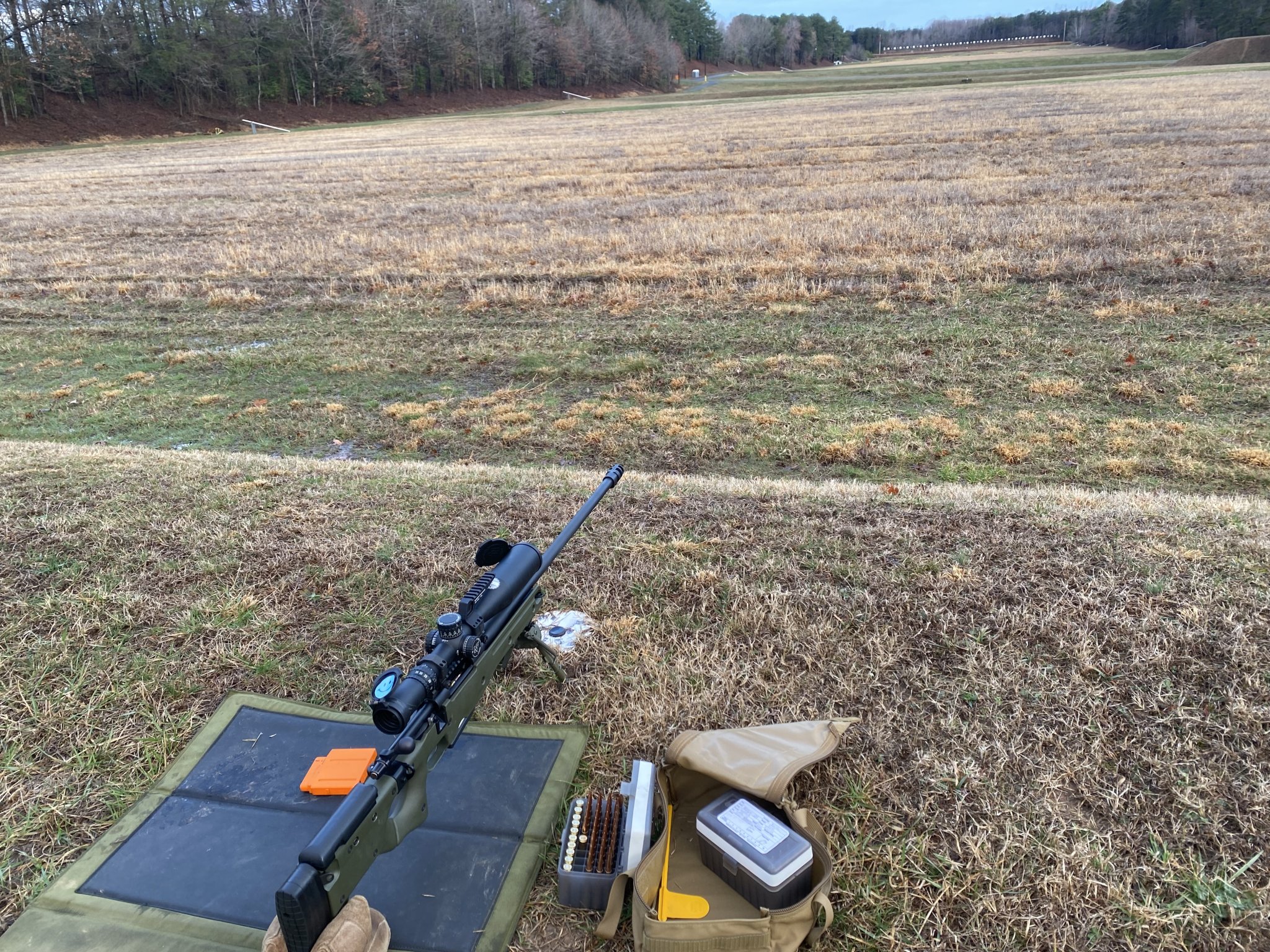

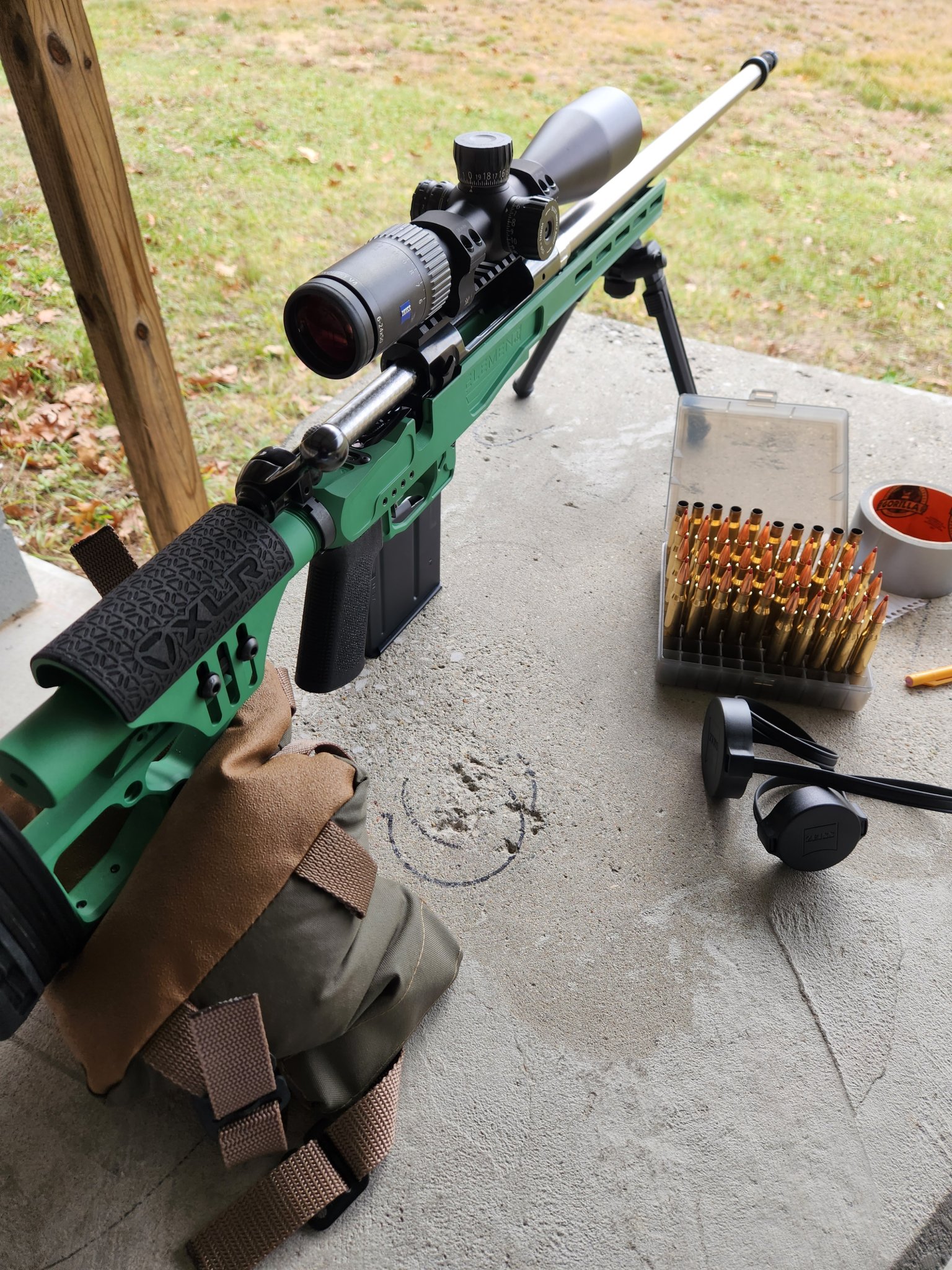

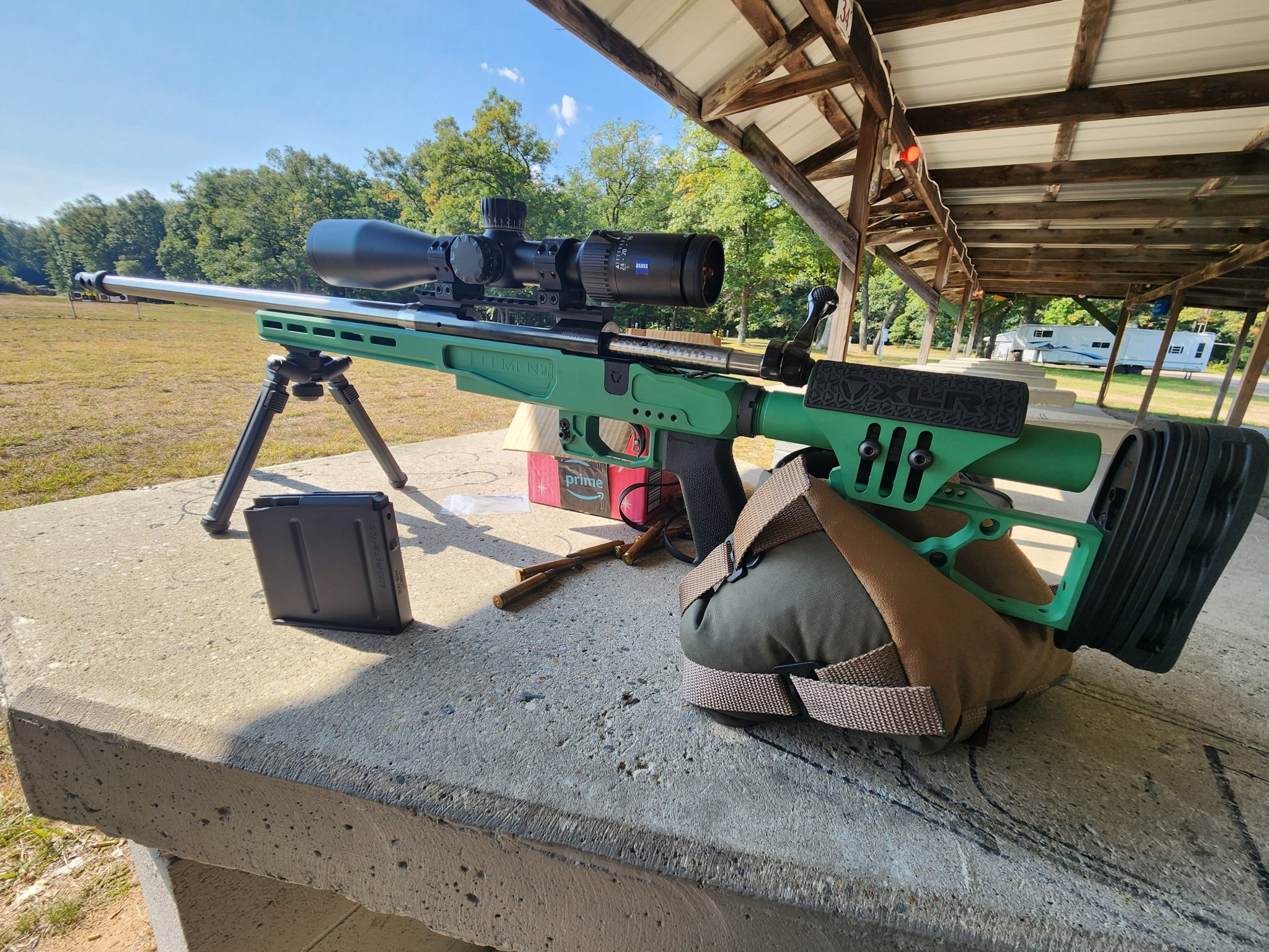

While back I made a threat about a precision 3006 build. I'm running hornady 155gr at 2800 fps and it's a blast to shoot. Took it to 1100 yards while back visiting west texas in August but the mirage was horrible. I'm really wanting to load up some 175s and give them a whirl next.

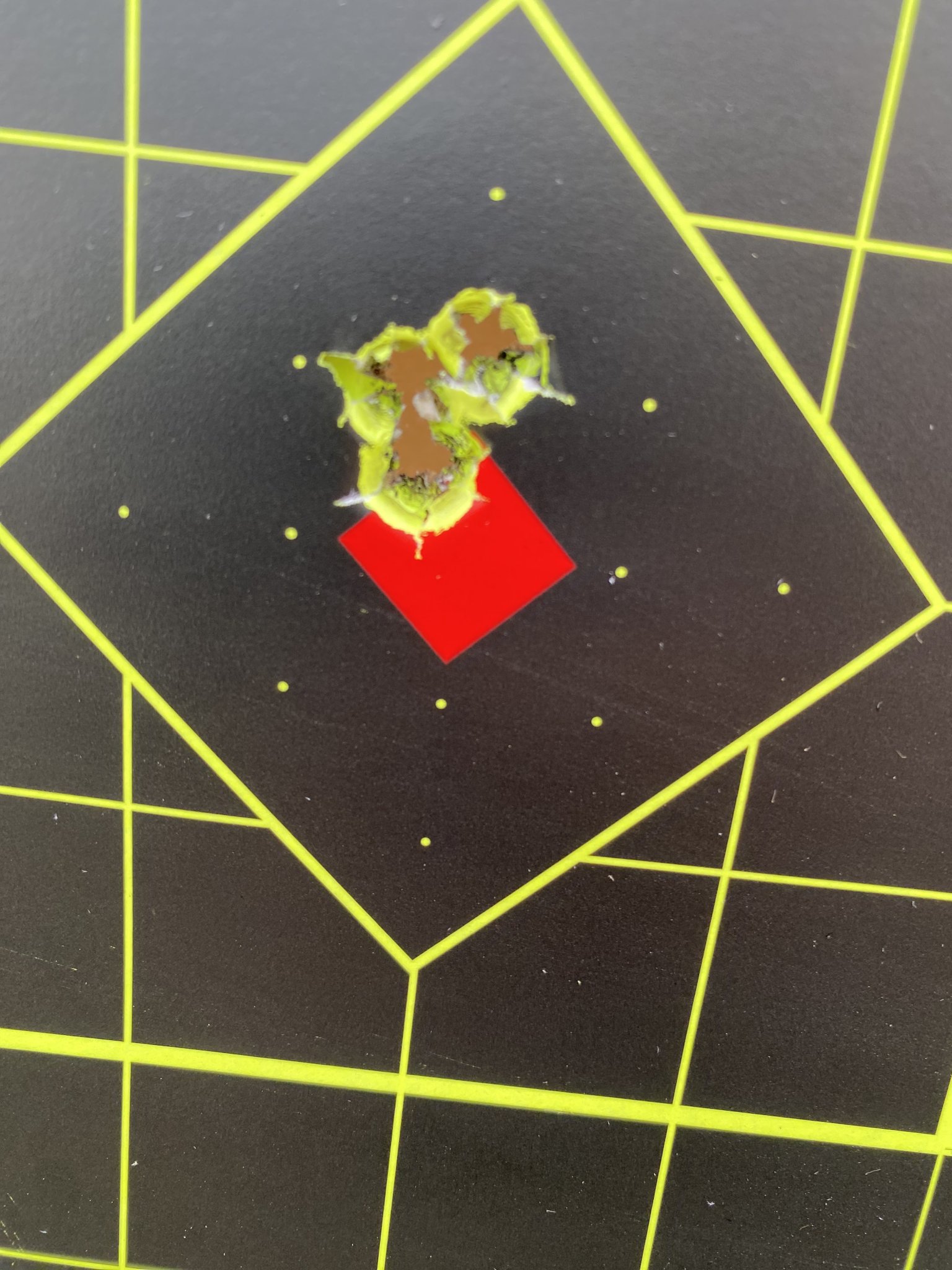

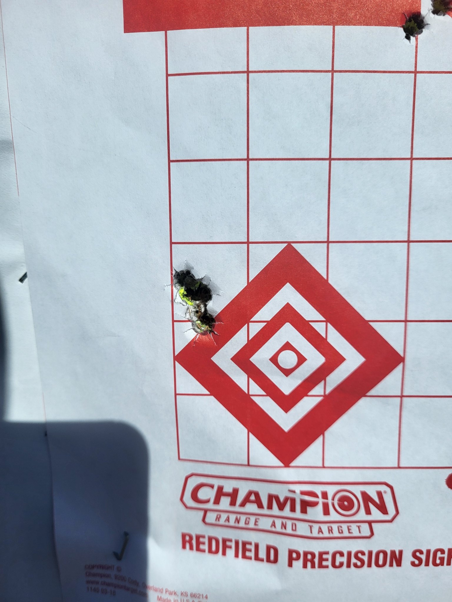

Finally got the chance to shoot it. It’s shooting 3/8” groups at 100 yards with factory Hornady 168 grain match. I’ve only shot 4 different types threw it and everything has been sub MOA. Cant wait to start hand loading and see what it will do.
Nice shooting. I been reloading for the 06 since 1989 my go to powder is or was IMR 4064 for sierra 165. Sub moa in my rifle. Problem is that powder is hard to find. Imr 4350 is supposed to be good as well. Both are extruded powders so do not meter well I recommend an electronic powder measure. I got a bunch of AA 2700 a while back and want to try that.
