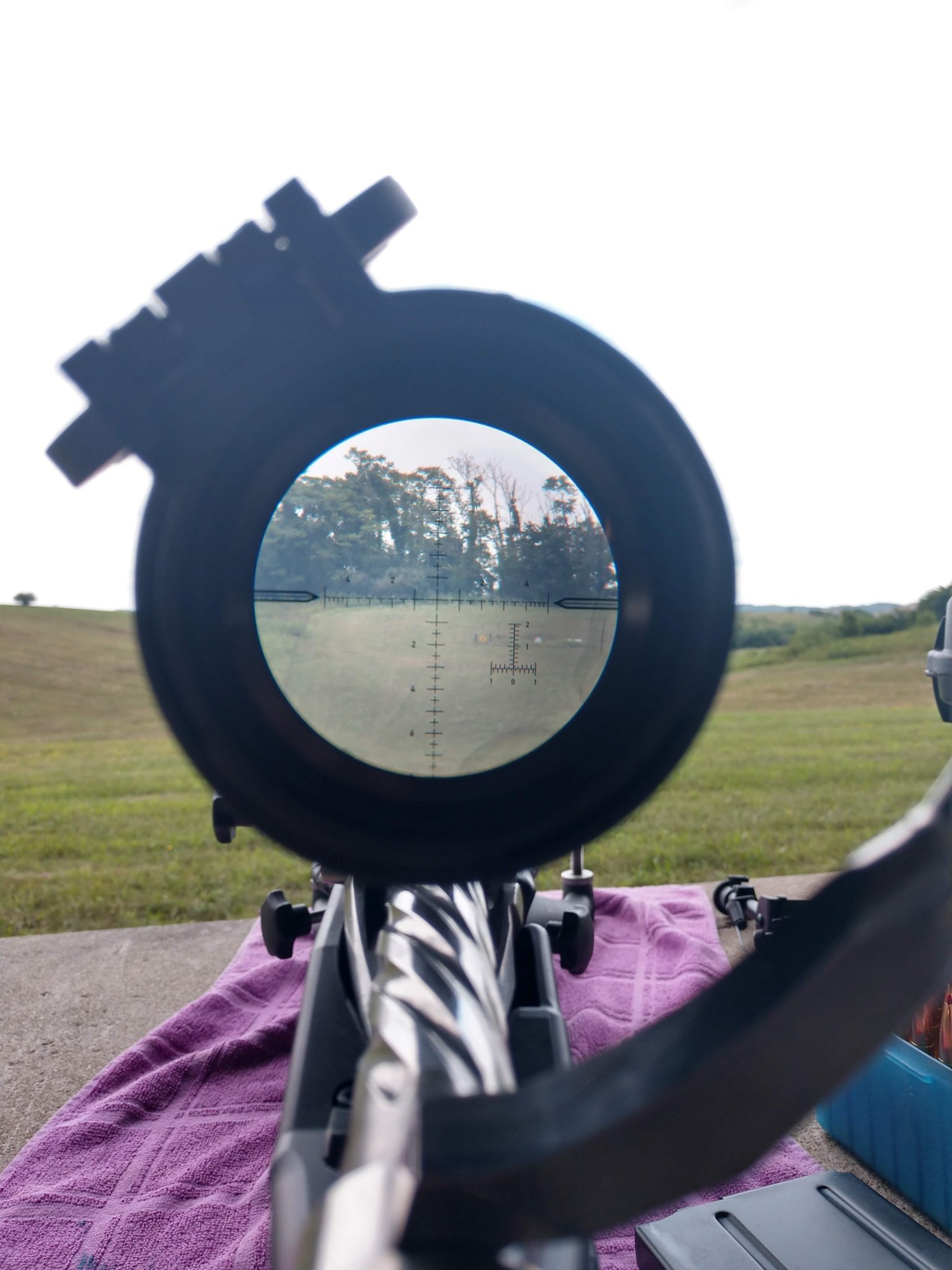

Not sure if you've tried to work up a 30-06 load using H4831sc and 208eld, but I was getting 2800 fps using that combo out of a 28" bbl. I was hitting targets at 1 mile and primer pockets weren't loosening up until after 10 loadings on winchester brass. 1 mile targets at thunder valley a couple years ago. He's upgraded his 1 mile area since this pic was taken.
Not sure if you've tried to work up a 30-06 load using H4831sc and 208eld, but I was getting 2800 fps using that combo out of a 28" bbl. I was hitting targets at 1 mile and primer pockets weren't loosening up until after 10 loadings on winchester brass. 1 mile targets at thunder valley a couple years ago. He's upgraded his 1 mile area since this pic was taken.View attachment 8192616
