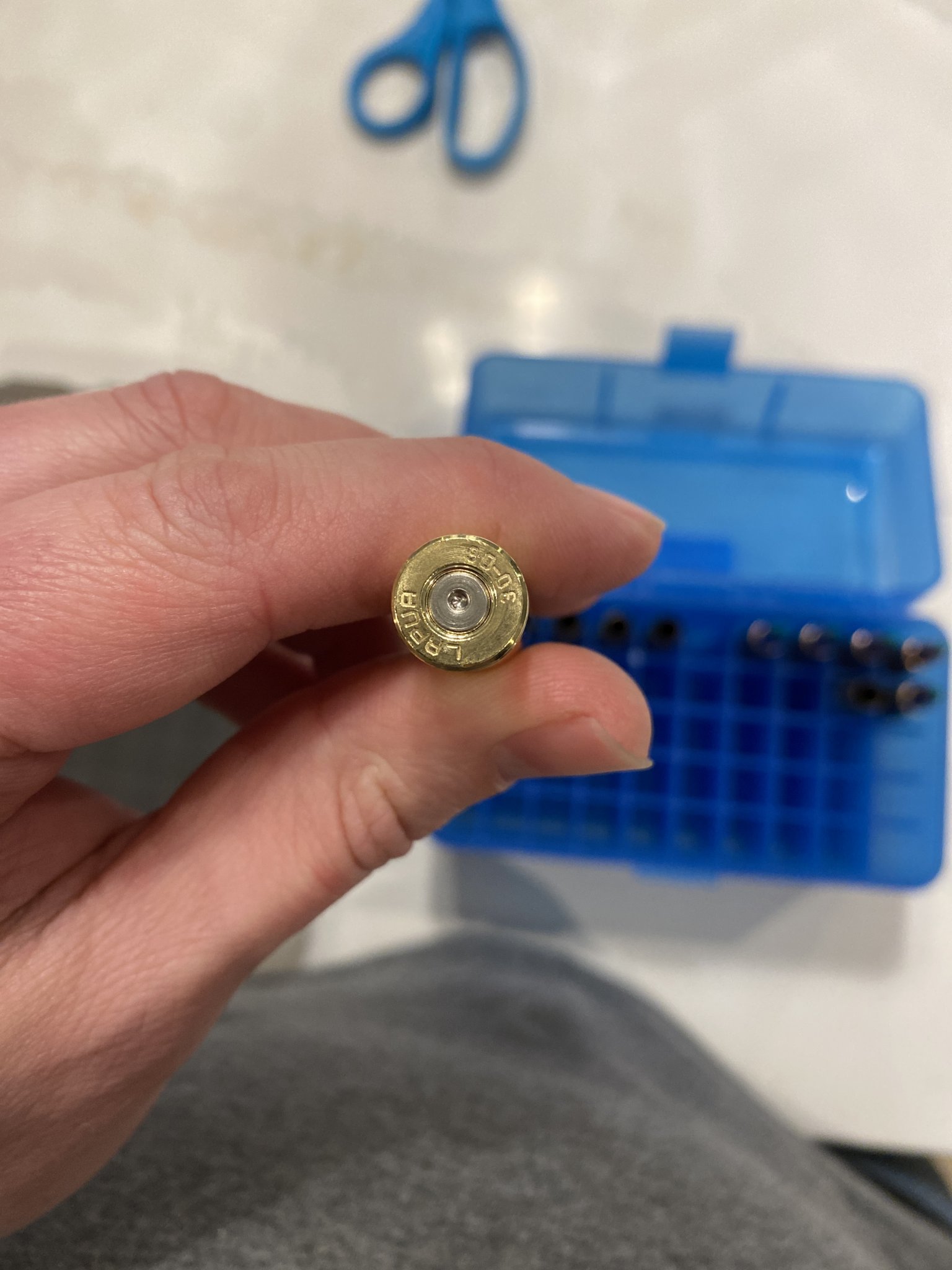

Range on this probably won't be past 300-350, but I want be confident to 500 yards if I had to. I did a test starting at 51.5 grains and went up to 56.5. I stopped at 54 because there was a mark which I thought was from the extractor and the velocity was also 2796 fps which was more than Nosler's max FPS. Here's a pic. The mark was right above and to the left of the 6. If it's nothing please let me know!

Its nothing.
Your primer will look a lot worse if you have ejector flow on Lapua brass.

Those cases look fine. H4350 is perfect for that rifle.

Interested to see what you come up as I have some Lapua brass ordered and was wondering about the difference in capacity. Your primers look good and I didn’t see any ejector marks or bolt swipe. I think you are ok with that particular load. I also use H4350 in mine and it likes to be right at max for best accuracy in my rifle. I also use 150’s and get great accuracy with good speed.
