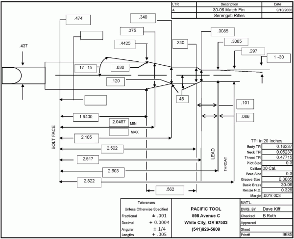

Looking for some suggestions on a reamer. Its a hunting rifle so I'm probably just gonna shoot factory ammo. No heavies. 150 to 178 gr bullets.
Would a Serengeti be a good one. I think it has less freebore than a match sami reamer.

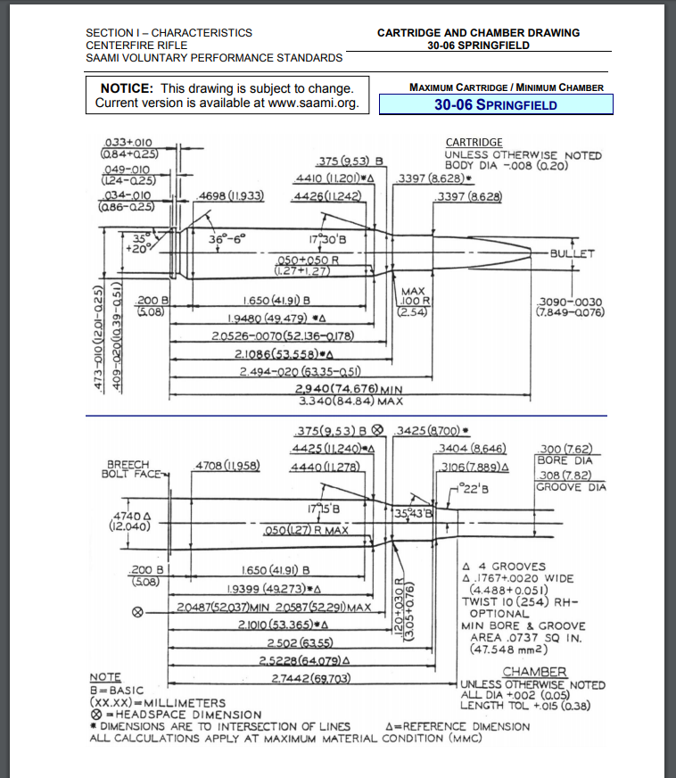

I don't know what a Match SAAMI reamer is but a standard SAAMI reamer will have less freebore than the Serengeti version.
If all you plan on shooting is mid weight bullets i would stick with a standardish reamer... i thought there was one floating around that was pretty much a standard 30-06 springfield reamer but it had an improved lead angle. I surely wouldn’t want a longer freebore unless your reloading. The longer freebore reamers with factory loaded ammo can cause some decrease in pressure resulting in lower velocity.
It seems like I checked with PT&G and it seems like they told me the SAMMI reamer had more freebore than the Serengeti reamer.

The saami really doesnt have any "freebore" its got 0 freebore with a straight transition like all the 30-06 based chamberings, 270 etc.
The serengeti has .101 freebore on this ptg print
I dont think you would really be able to go wrong with whatever you choose. But the “revised” reamers would give you better performance if you reloaded your ammo to take advantage of what the “revisions” have to offer.
