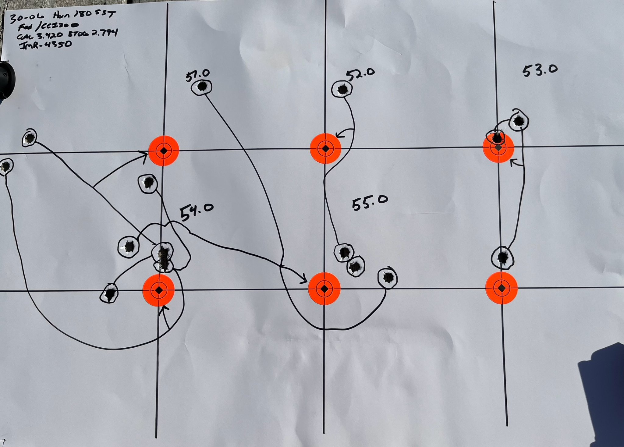

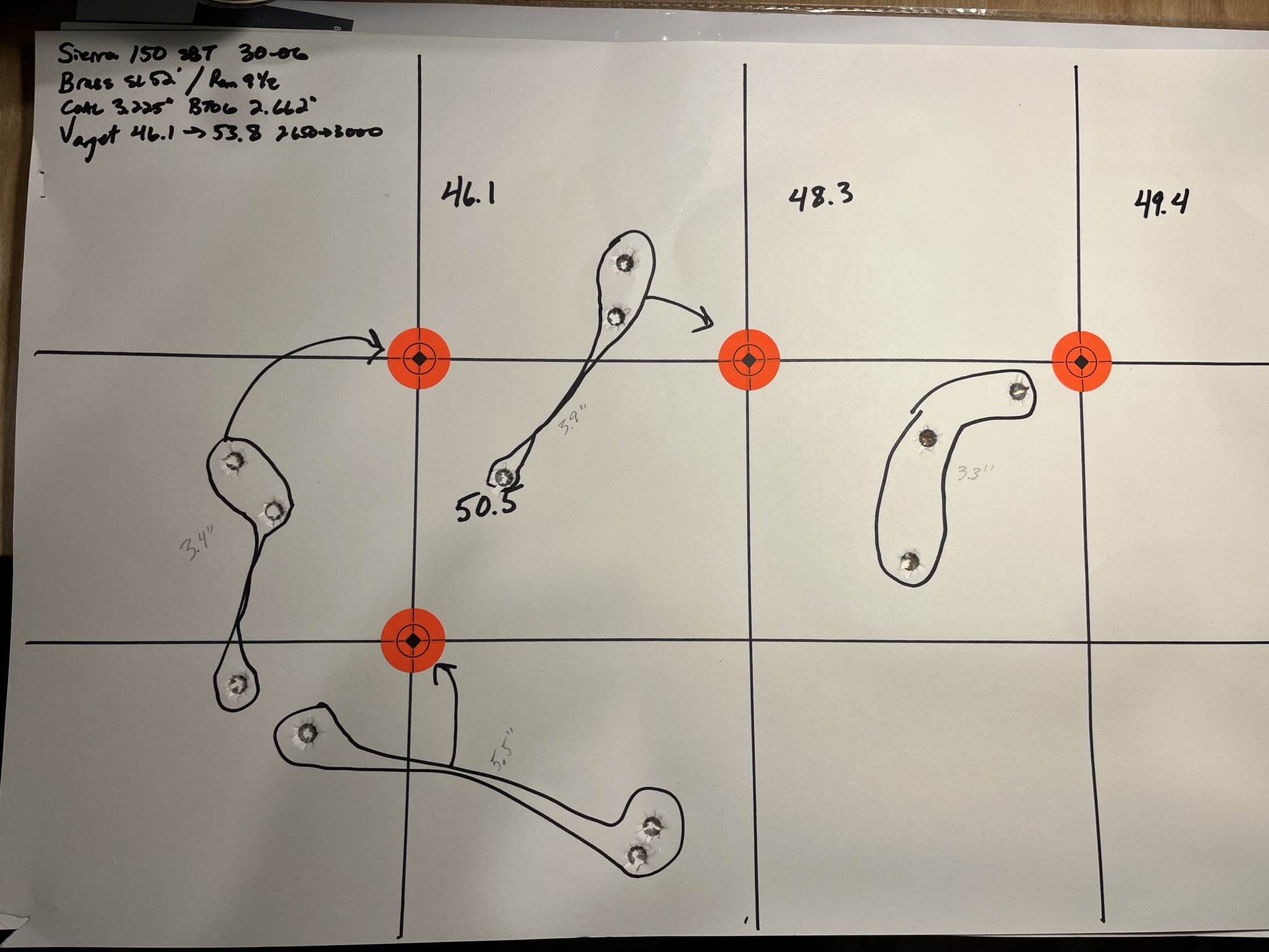

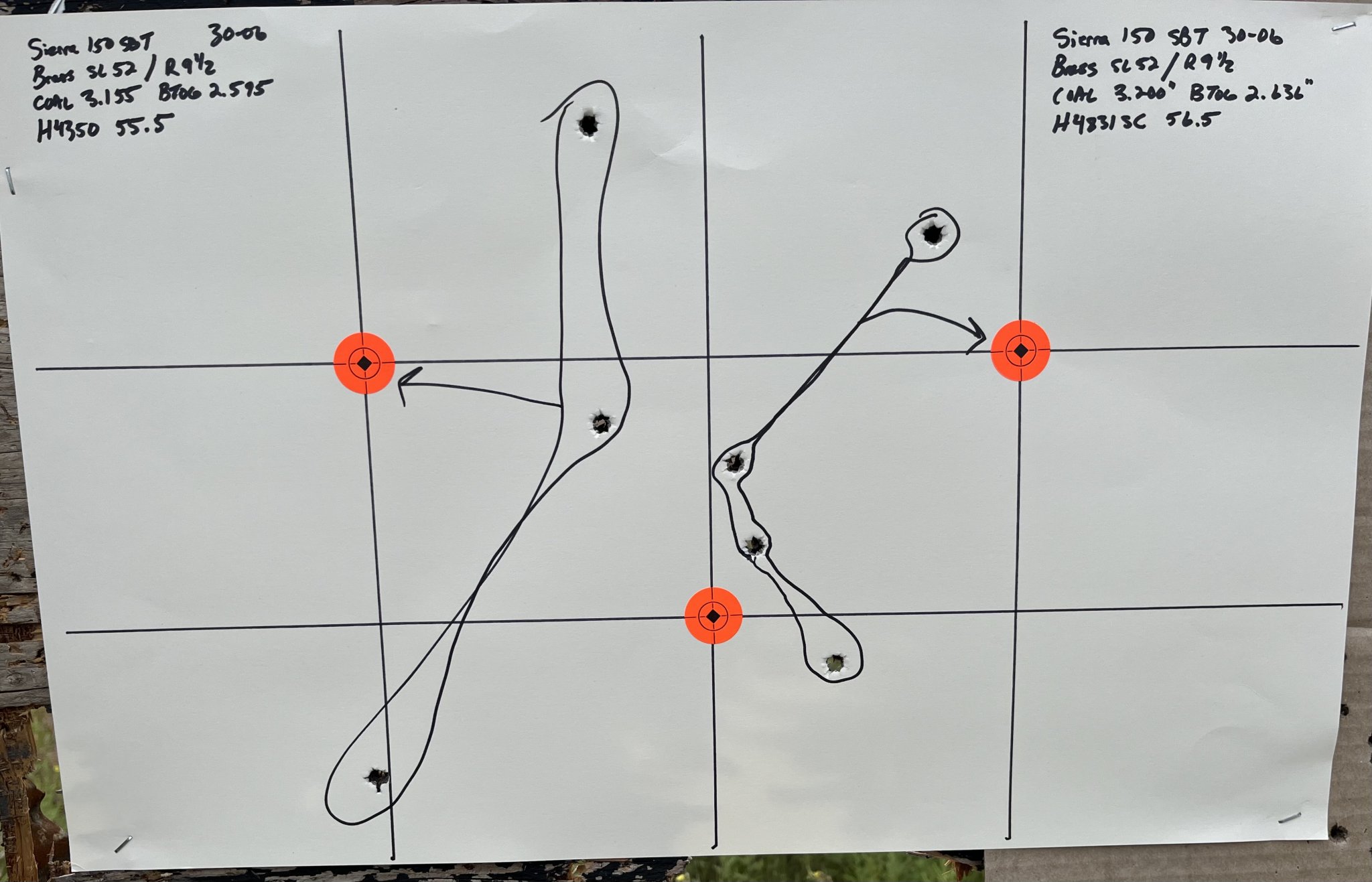

I think some of my problem is the lengthy freebore as you described. I can’t even get close to Jam. Jam with the 150 Gamekings would be a COAL of 3.460”. At this length the bullet isn’t even in the case. Sierra recommends COAL 3.225” for that bullet which is .235” of jump, and there’s not a lot of neck left holding the bullet. I think I need to find some bullets I can seat further out. I need to do some more testing to confirm if, but I’m seeing generalizations that the groups get drastically worse as I get further away from the lands.
Sierra 150 GameKings similar results. 3.5-5.5” groups with Varget. Tried a low power load with H4831sc and a moderate load with H4350 with the bullets seated a little deeper and they were even worse. SD’s are good all around, just awful groups.

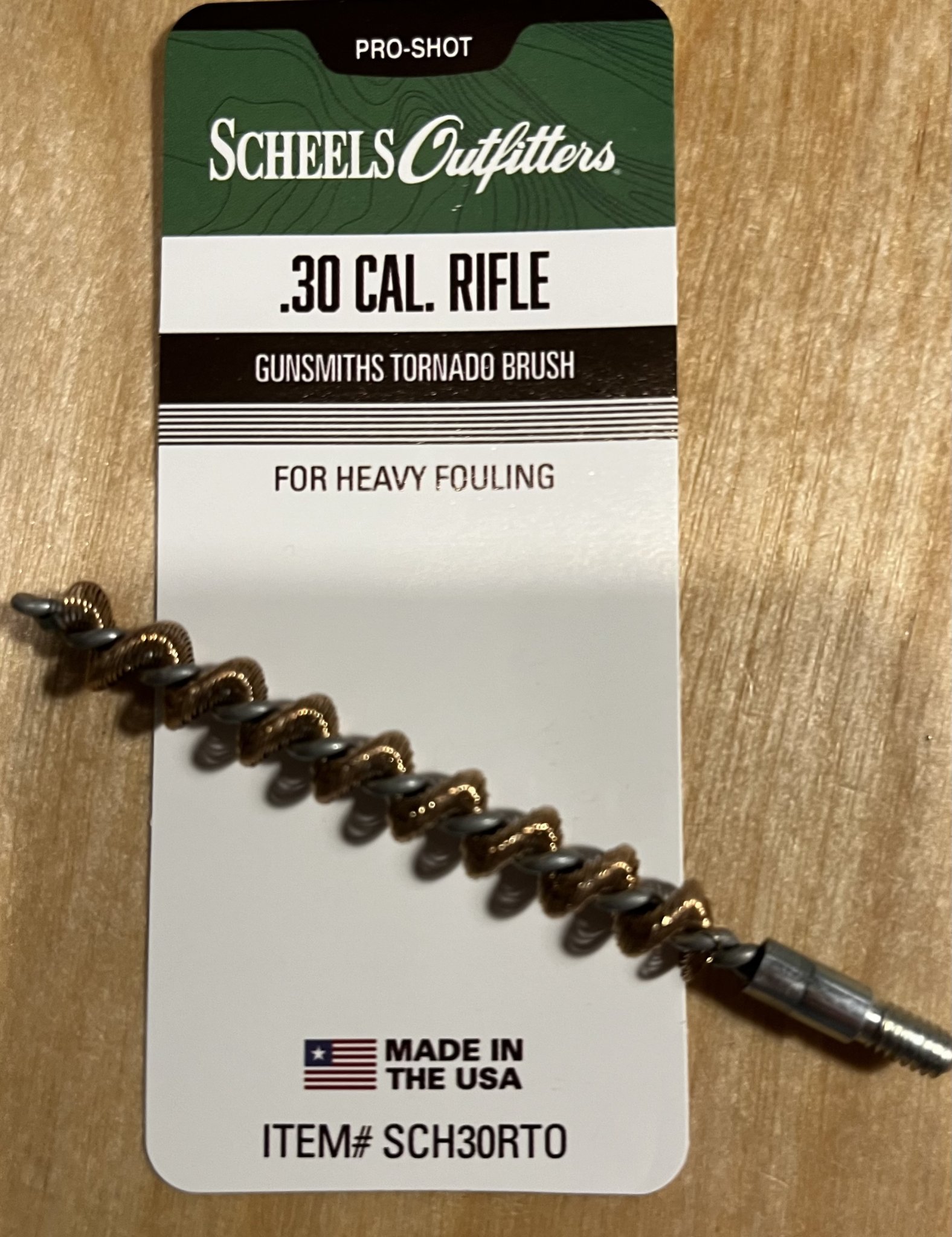

I cleaned it before I shot the 150 GK’s but I wasn’t really happy with how loose the brush was in the bore. I found a tornado brush yesterday and used that. I feel like that did a much better job. I think I’m going to get a bore scope too so I can see if it’s actually getting clean and if there’s any damage inside View attachment 8488095
IMO, based on experience, those bore brushes are crap because they don't get down in the grooves very well, especially in the corners right up next to the lands.
They'd likely be ok for Metford rifled barrels though.

Tried seating about .025” off of jam with 180 sst’s that I already had. Also ran some 150 FMJ’s for a control. Put my Vortex PST 6-24x50 on it and same results as before. Got my bore scope today so I will post those pics too.

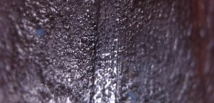

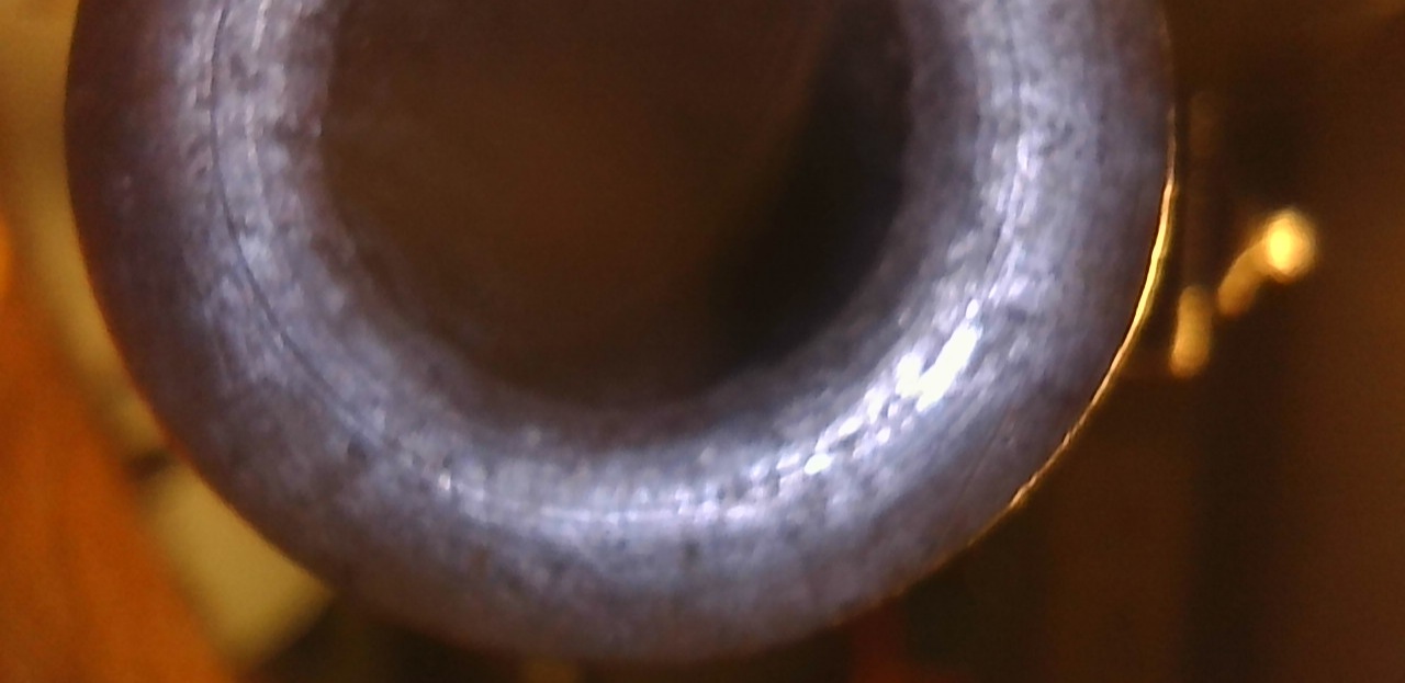

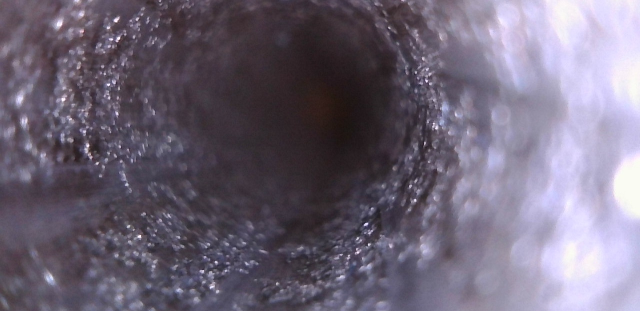

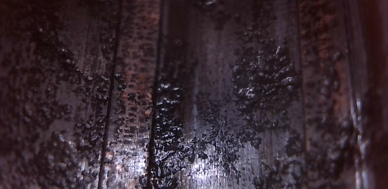

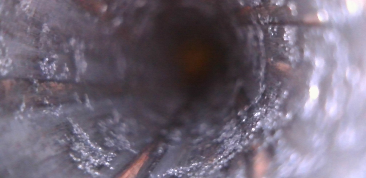

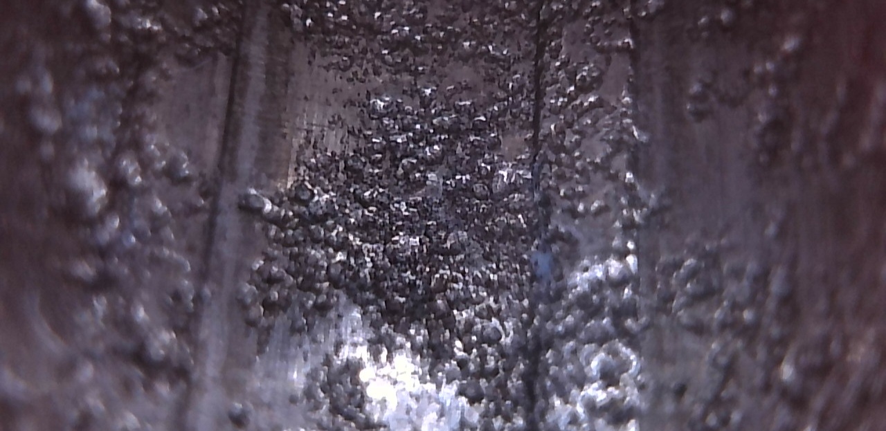

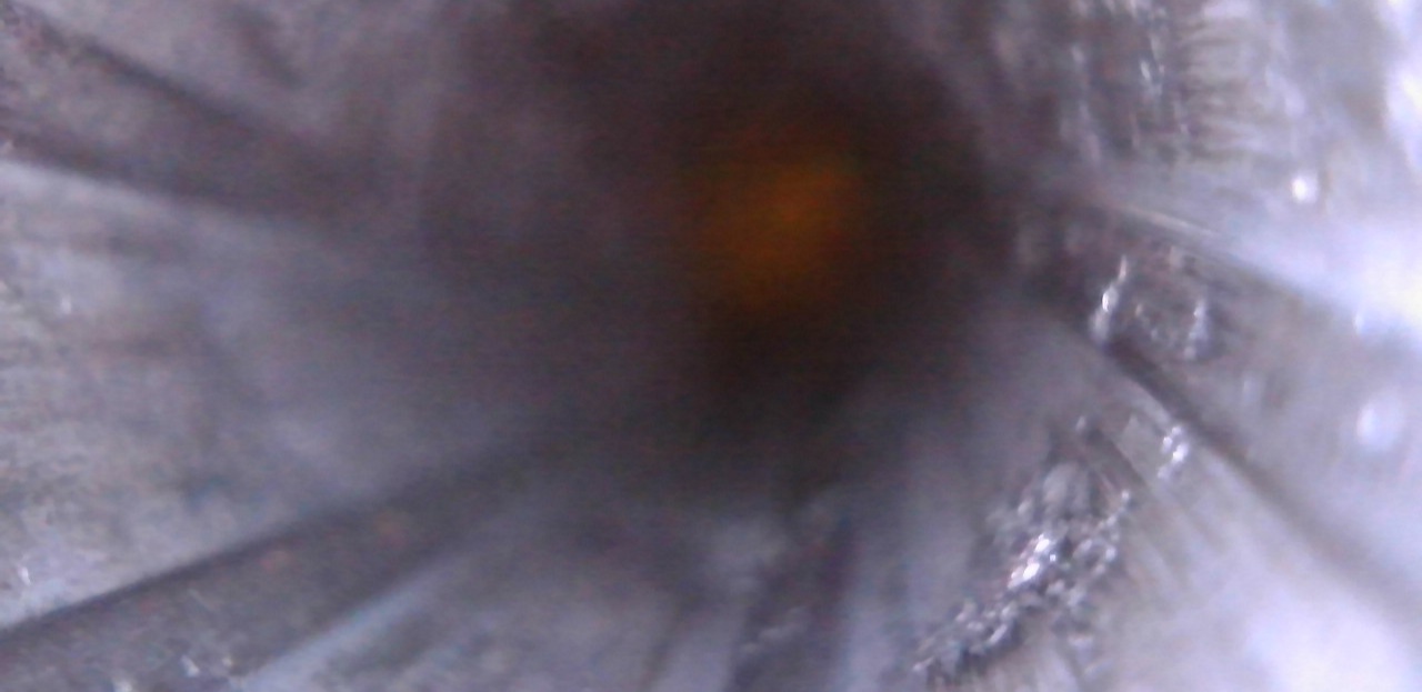

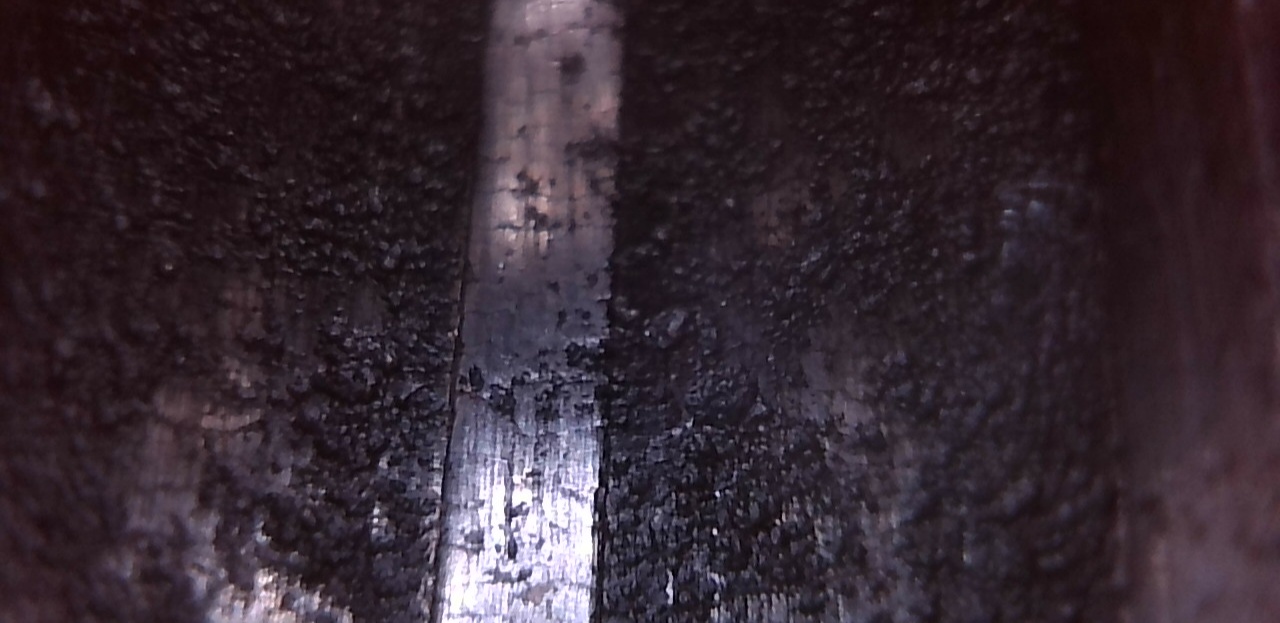

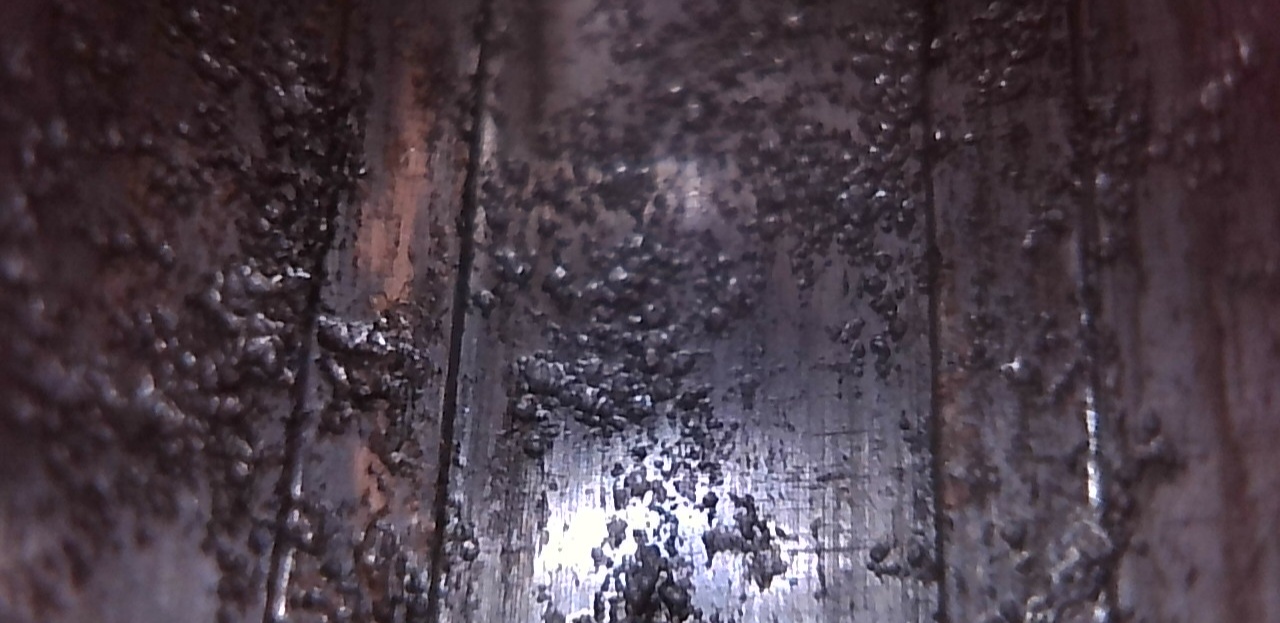

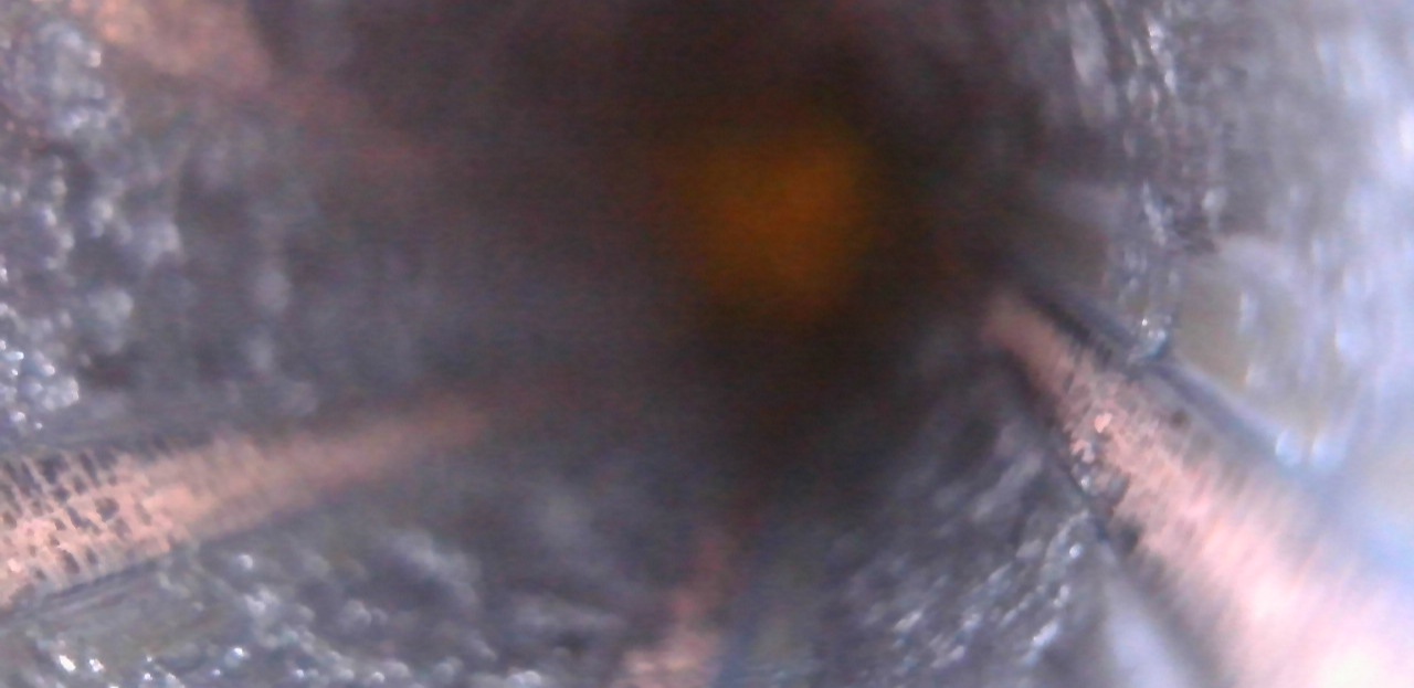

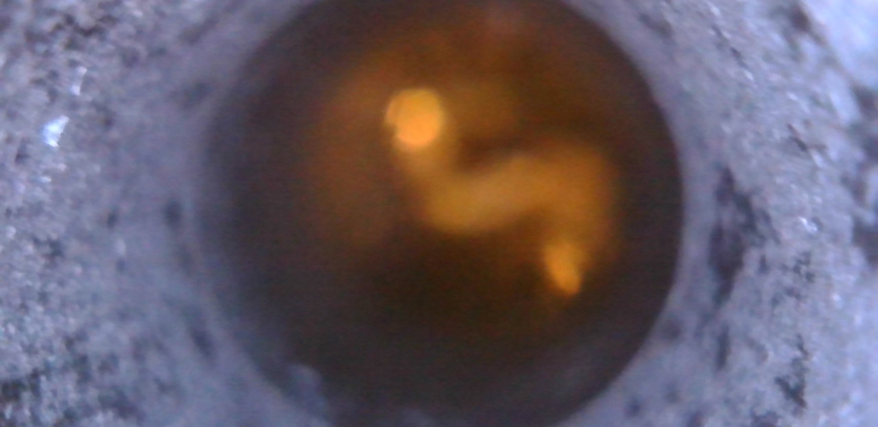

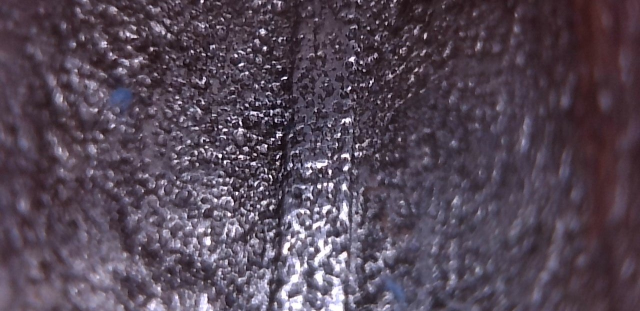

Good news is I now have a bore scope. Bad news is, I think we found the problem.

I’ll probably rebarrel it at some point. That leads mean down another rabbit hole though. It’s a thin pencil barrel on it. I would replace it with something a little thicker. So then I need to shave the stock down and probably re-bed it, or get a different stock. If I get a different stock I probably need to go with a 700 trigger. If I replace the trigger I need to file off the tang by the safety. I guess I need to decide if I want to build a rifle around a 721 action. Rebarreled in 25-06, 270, or 280AI might be fun.
Yeah, that'll do it. Maybe just a new 30-06 barrel in a remington varmint profile? Id just sand out the barrel channel re bed if necessary and be done. I'm not sure if the action needs to be modified for a 700 trigger. Could always have the original walker trigger tuned.
If rifle building isn't your jam, nothing wrong with a visit to your well qualified rifle smith.
They would be able to keep it just like it looks now, but with everything in the barrel and bolt, and trigger in new working order, and if you wanted it they could even make it prettier than it was when it was new.
Keeping all the old scratches and dents in the stock, all while ironing them out a little and refinishing isn't a bad way to keep it as it was without completely erasing it's history, (but make it a working rifle). YMMV
