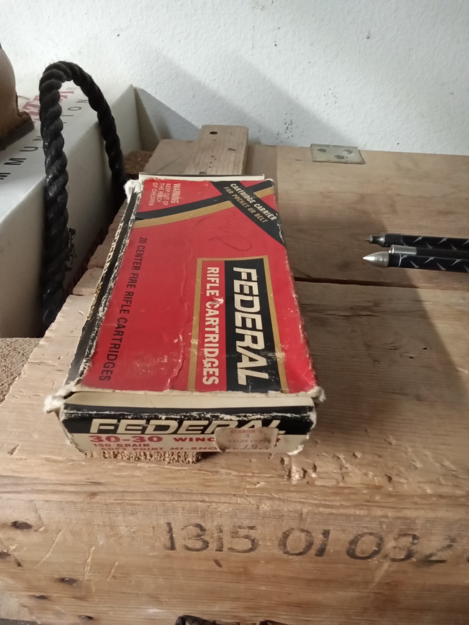

I had wondered the same regarding and old Winchester 30wcf I have.
Actually found a box of ammo I had forgotten I had.
Federal Hi-Shok 150gr Flat point with a price tag of $3.79 on it, even has a hand signature on the back of whoever did the QC of packaging. 😁
