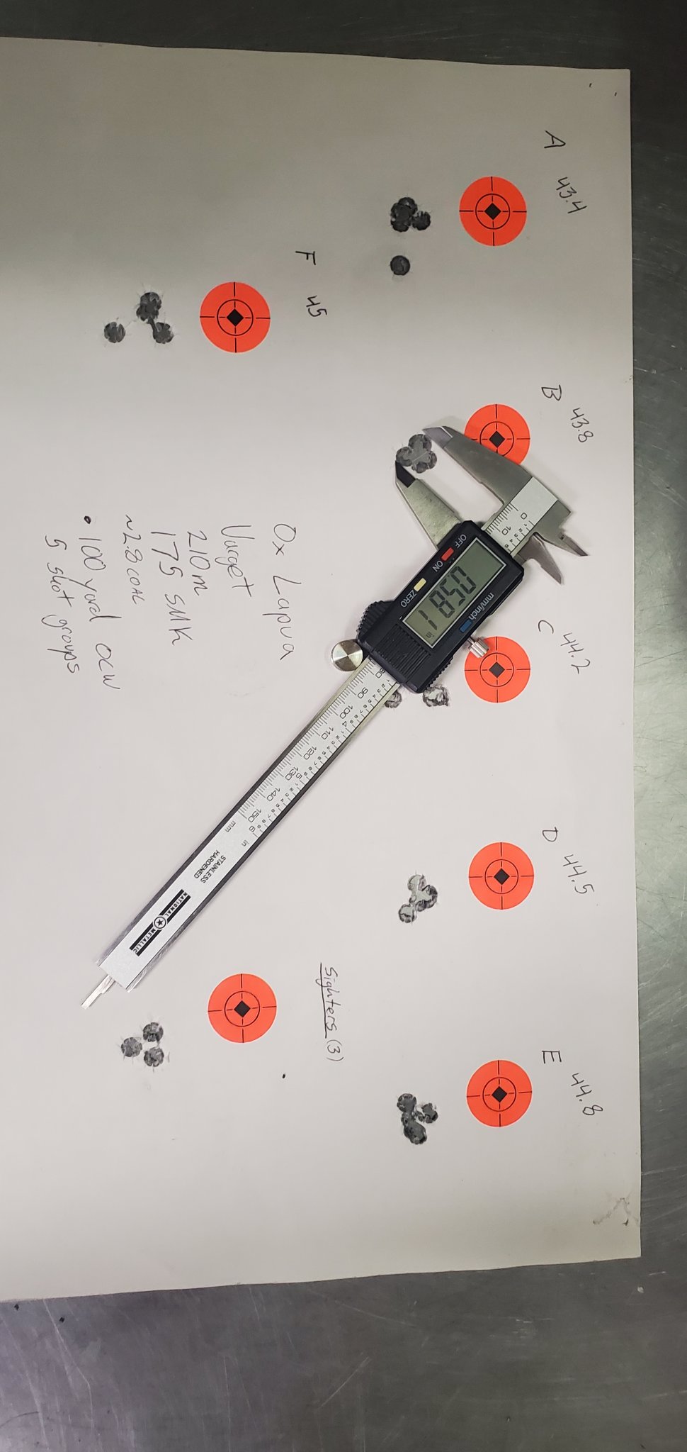

Take my internet advice with a grain of salt, but I was in your shoes a few years ago so I feel compelled to put in my 2c. It depends on what you want to do. For example if you want to shoot PRS tactical division theres a speed limit of 2800 fps for .308 and a weight limit of 178gr for projectiles. These rules, combined with current availability, my vote would be for 175 SMKs. You can actually find them in stock, and you can pick up a box of 500 and go to town. Hornady 178 ELDMs would be nice, but theyre hard to find. 175 TMKs, lapua scenars, berger otm tacticals are great too but theyre all hard to find last I checked. If you wanna shoot F class, then maybe pushing the lighter bullets faster is a better way to go. Im a 308 shooter too, I just completed my first build with a TL3 action, 26" Bartlein 11.25 twist. and an ARC Xylo chassis. Yesterday it crapped out a ~quarter inch center-to-center group on my first ocw test with 43.8 grains of varget over 175 smks and 0x lapua brass. The 308 is slow - flies like a mortar compared to 6mm - but man its forgiving to the reloader. If your rifle is squared away, its probably harder to get it to not shoot good. Get what you can that will allow you to compete in your chosen discipline, load and shoot a lot. (Side note - I shot my first prs match with berger 185 juggs and my 18" rem700. They were pushing around 2450 fps. I didnt know there was a weight limit, no one cared and probably wont with you either unless you win). Thats the beauty of the 308 and the 10k round barrel life.
To sum up my rant, PRS I think heavier is better because of the speed limit and because me sees guys who win PRS tac shooting the heavier pills like the 176 A-tips. If you're shooting F class, id take a look at what the pros are rocking and copy them.
And I also just thought, if you clean your rifle the way I was taught by my old man, or the way they generally in the military, stop right now and go watch Mr. Galli's vid on cleaning a precision rifle. I get nauseous when I think about how many times I rammed a crooked steel GI issue 6 piece cleaning rod down the muzzle of all of my guns as a younger fellow. Maybe you didn't need that advice, but maybe it will help some other 308 guy who reads this. Good luck!
