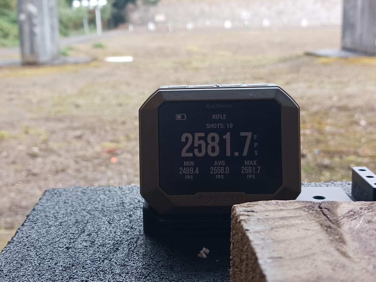

Being on a somewhat budget we built it off a Savage 110 action and a 9tw 24" Bartlein in a Bravo, with the intention of sticking only with strictly supers, once again...suppressors are also a no go.

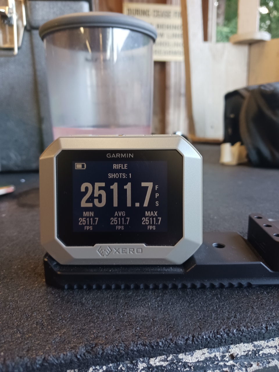

Only tested one charge weight, powder and bullet as a a quick "break in" and to get optic somewhat zeroed for actual load development.
18.8 gr H110 with a 110 vmax @ 2.1 yielded an avg of 2460 fps, I am suspecting he could reach 2600 fps towards the top of charge ladder. The 24" barrel is producing much higher speeds vs the test lengths used in the load manuals as suspected. Will report back as move up into the 125gr and possibly 150 gr.

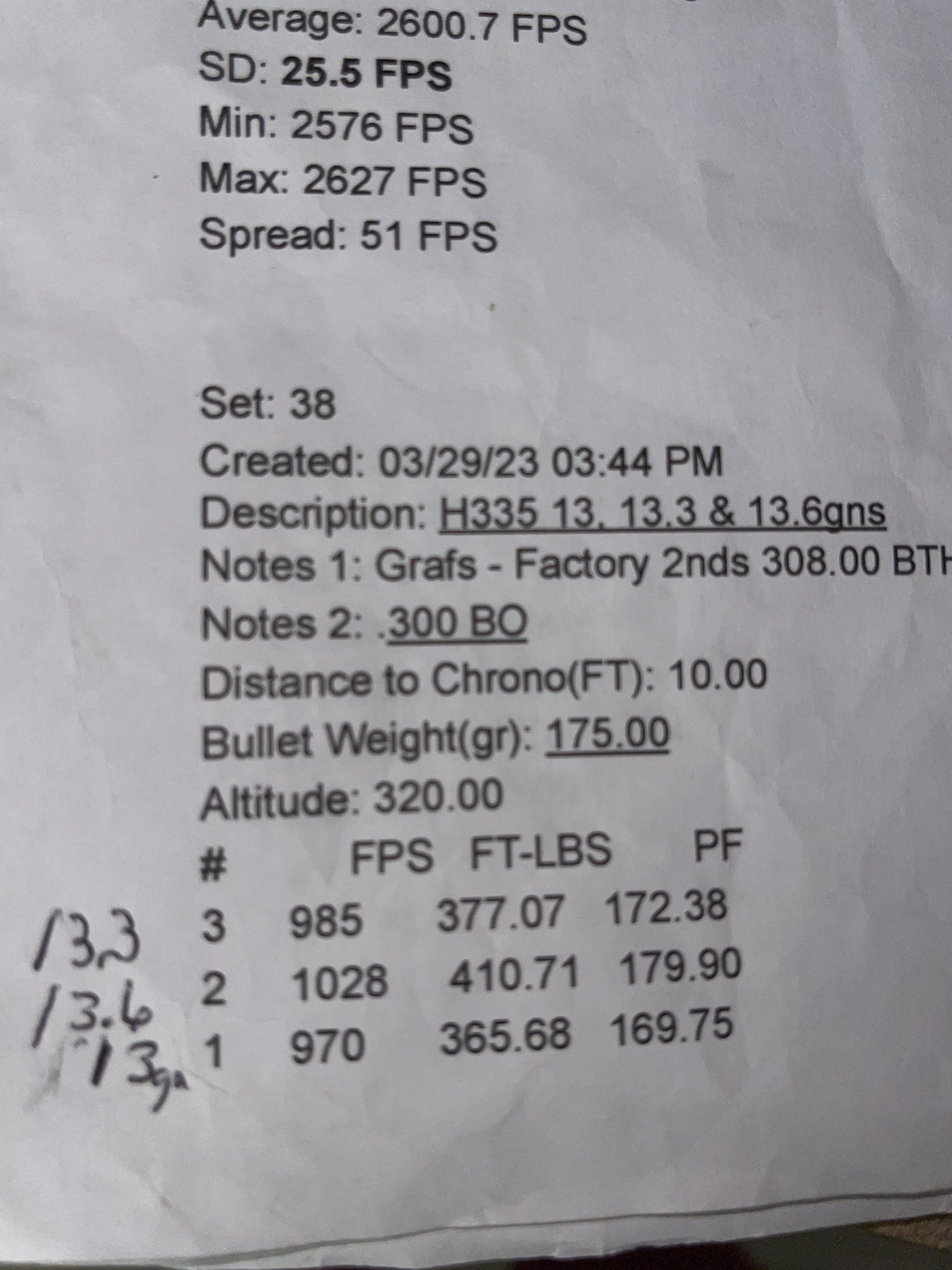

110 V-Max load
Notice this is 3 DIFFERENT CHARGE WEIGHTS, each with it’s own recorded shot velocity/energy data respectively. One shot for each weight, each corresponding weight noted to the left..
10.5” bbl
H335 (13, 13.3, 13.6 gns) - 175gn BTHP

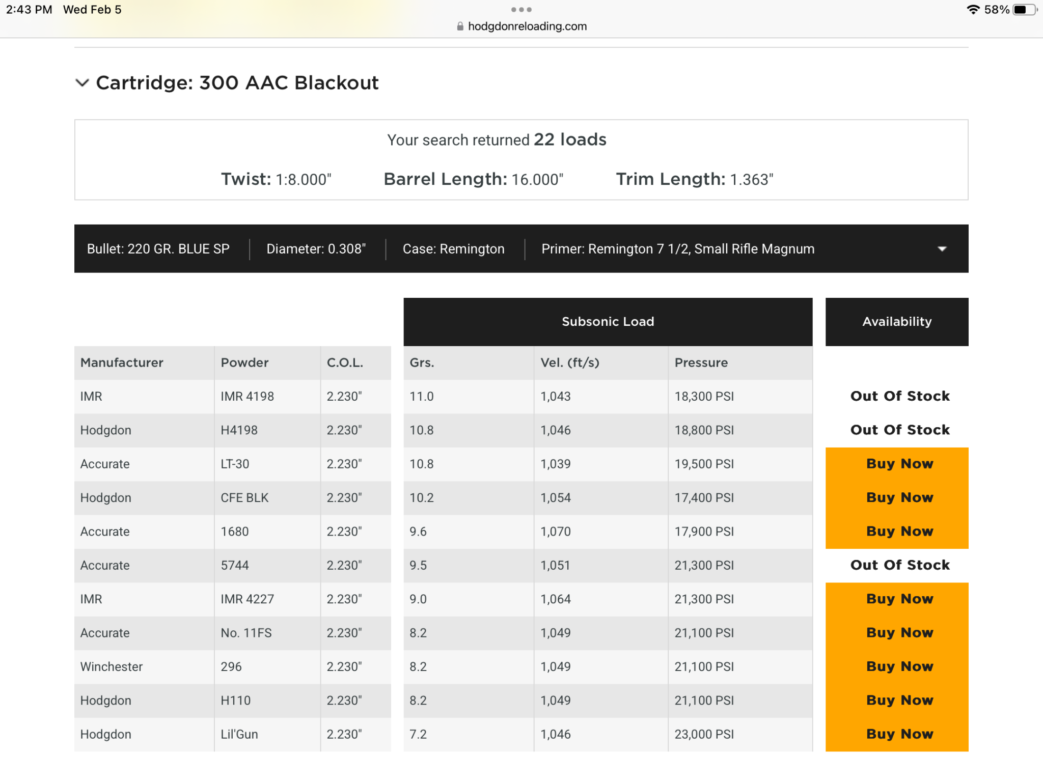

I'd like to get rolling with the components I have on hand but am not finding the exact load data to mate up with what I'm most interested in trying.

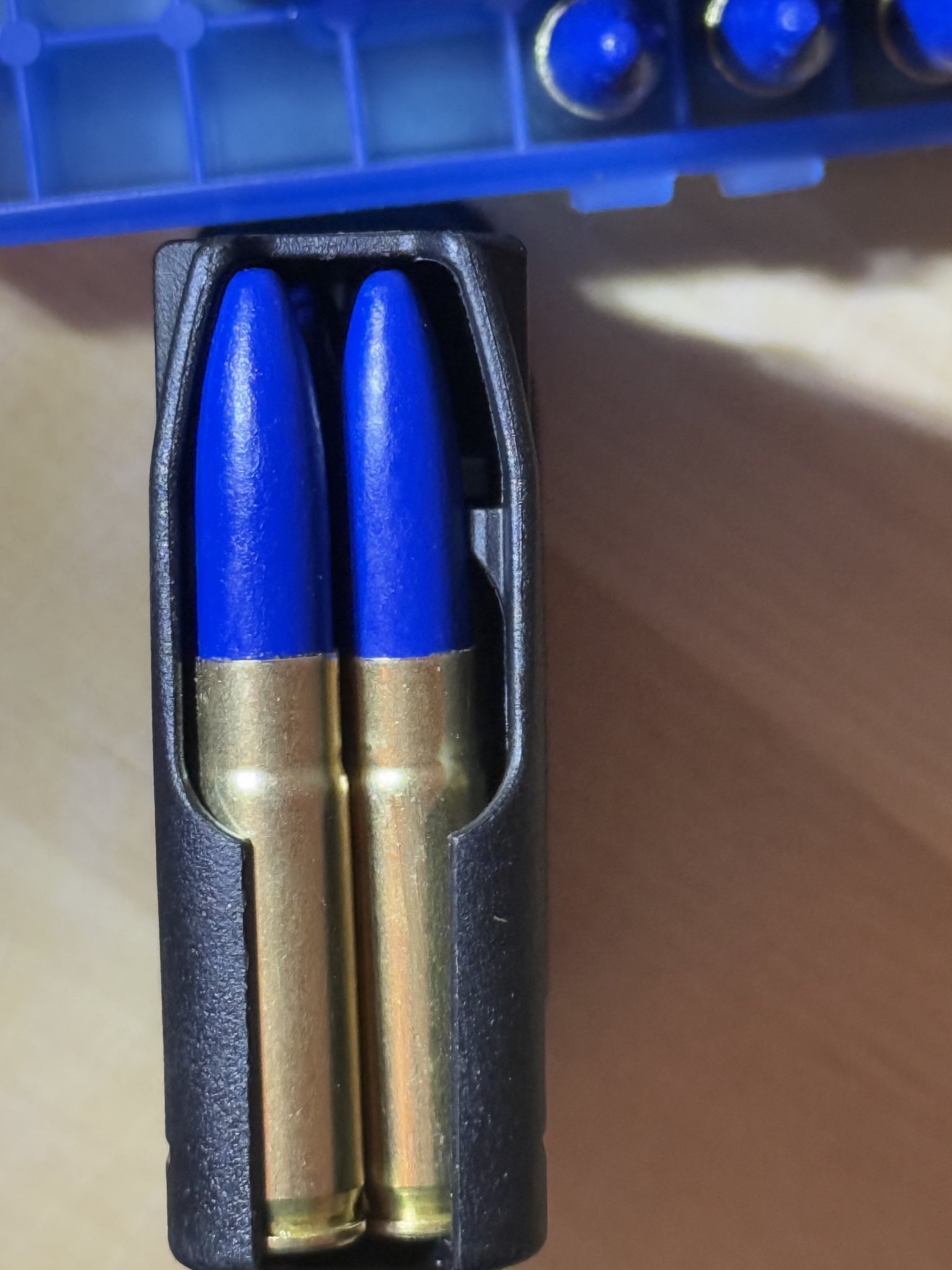

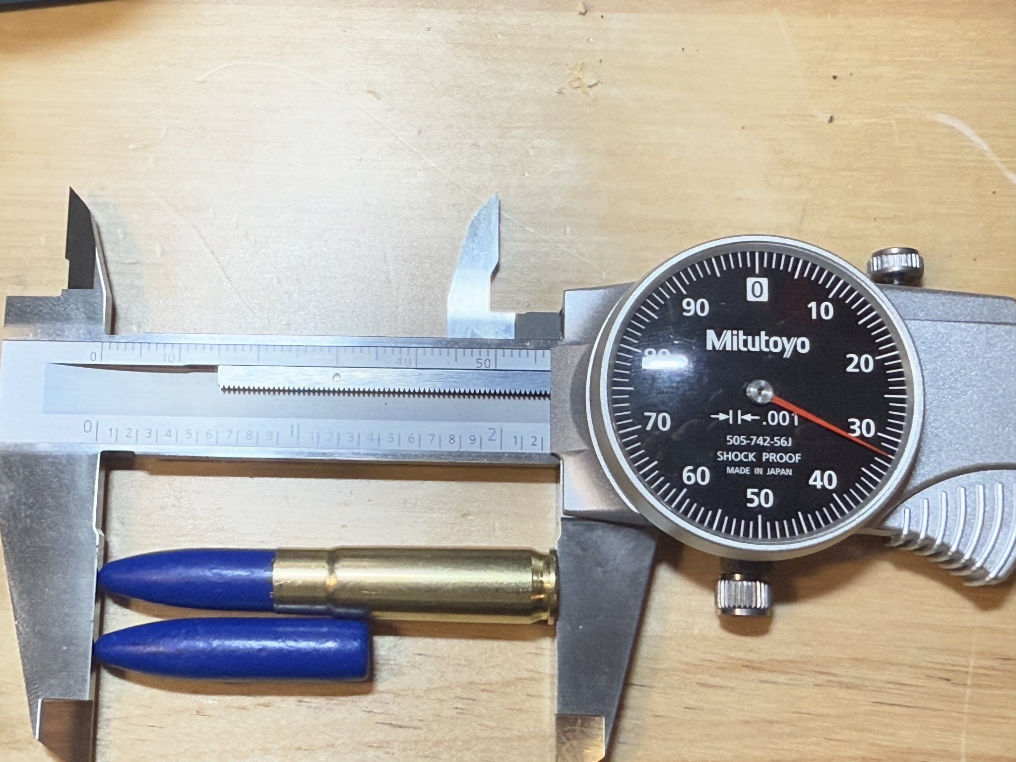

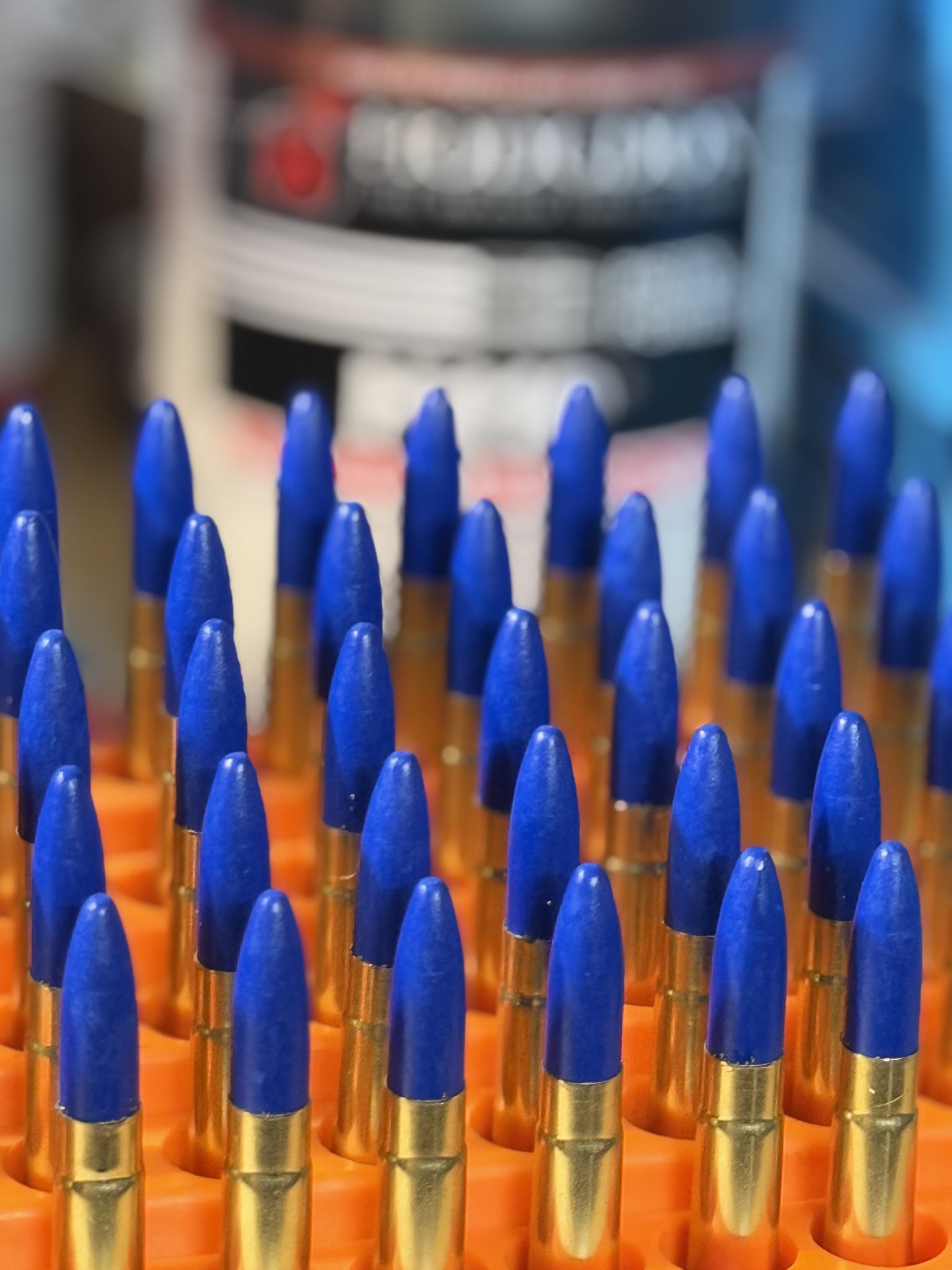

For example....I have a pile of 220gr Blue Bullets (coated cast ) and several pounds of Shooters World Blackout. Haven't found load data specific for these together.
I did, however, find data for those bullets & H110. I loaded a few yesterday, hopefully to try out this afternoon.
Figured if nothing else they'd be somewhat useful in getting optics zeroed.
Hopefully I can get onto some solid data using the SW Blackout powder.
I'm confident it will work well with subsonic loads. I've seen where it is compared with 1680.....but am without confirmation of a 1:1 charge weight relationship. Very apprehensive with reduced loads in the first place.
Have a few of these to trail as well.
May add some Berry's 220gr, too.

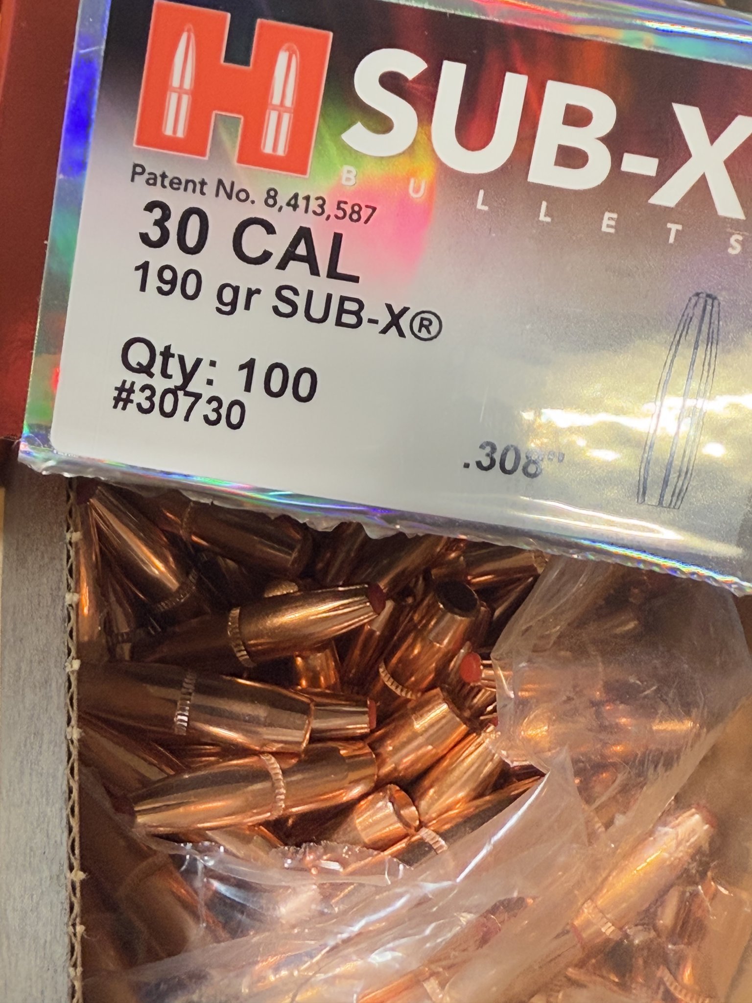

Sub load: Starline Brass, 190gr Hornady Sub-X over 8.2gr's of High Gun. MV of 1055fps per my Lab Radar.
