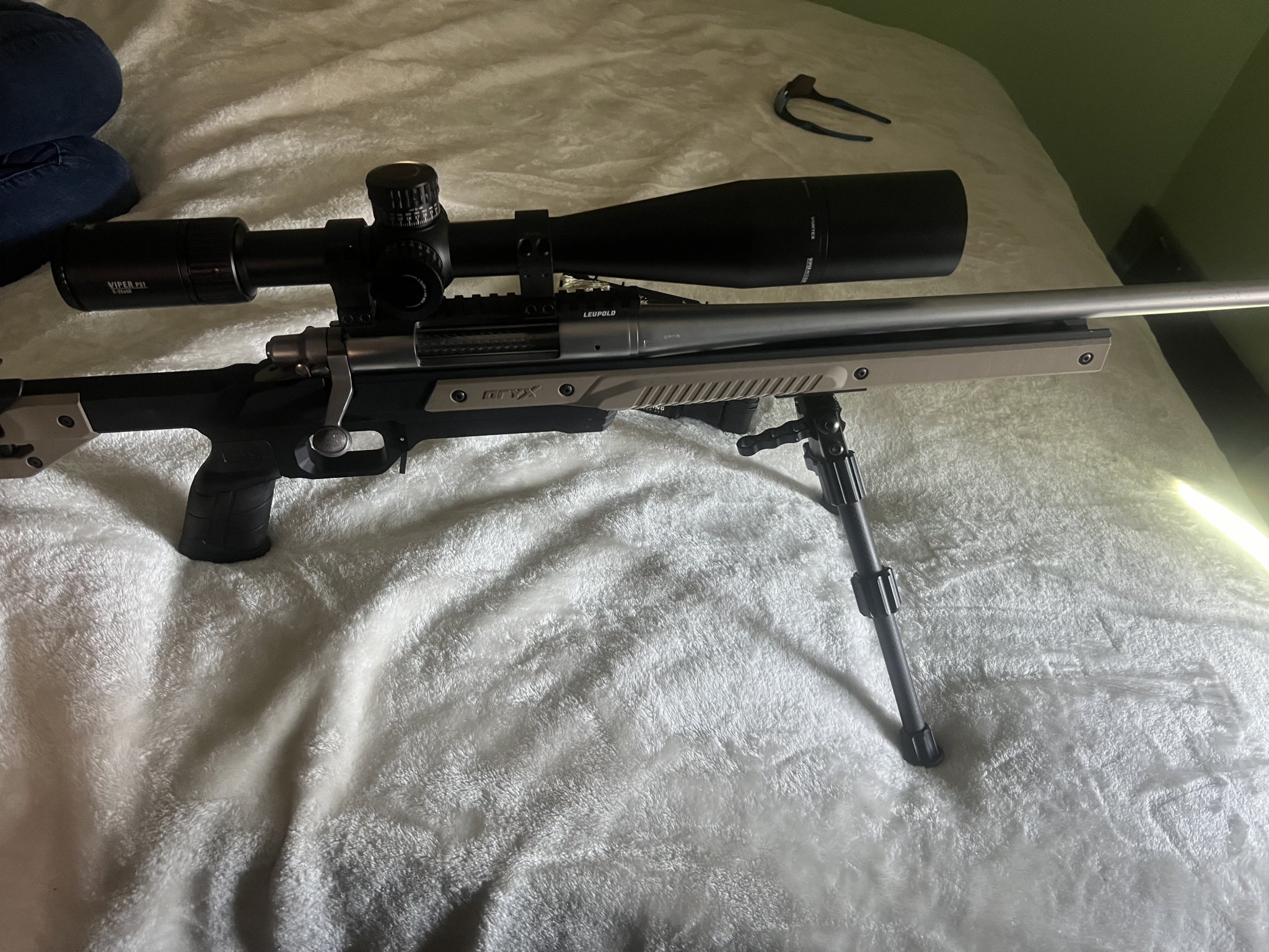

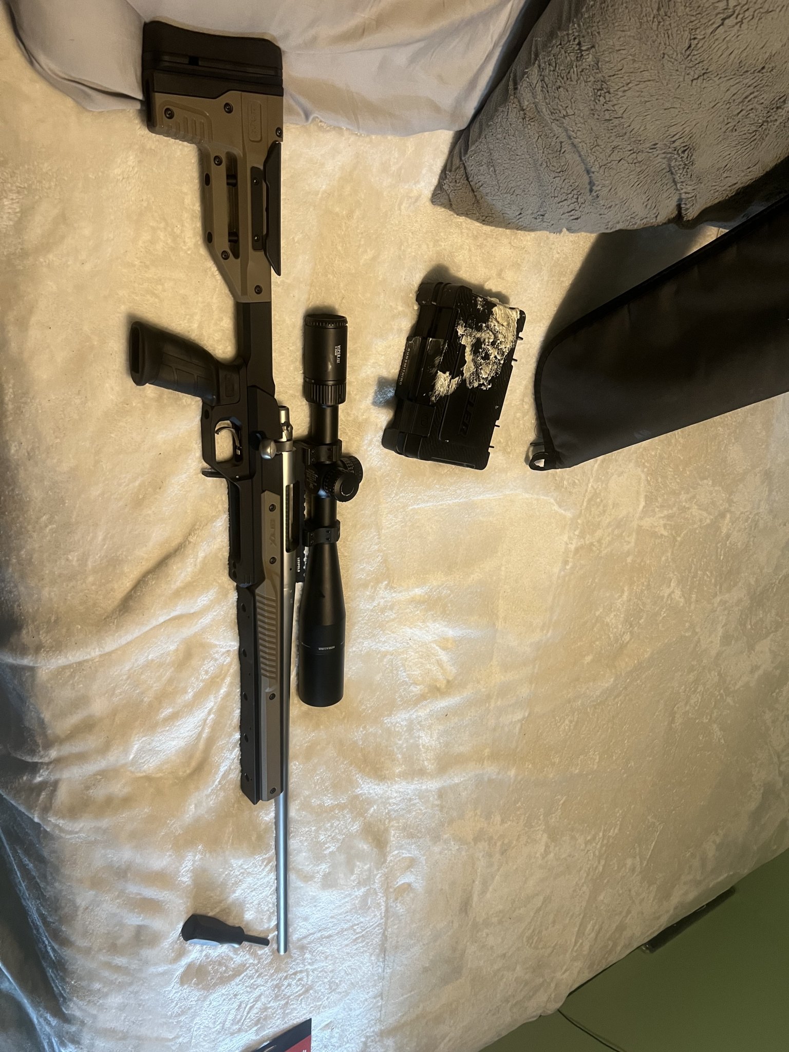

I’m currently doing the same build - 300 prc that is .
I’ll be going with a zermatt action as well as a criterion shouldered pre fit . I plan to run a brake on a 29” barrel .
The only reason I’m going with the zermatt action is I have the patience of a firefly , and can’t wait months for an action . If I spend my money I want to see the results rather quickly rather than a year down the road.
Currently I have a rem700 action and factory 300 win mag barrel , the action has been blueprinted and it’s all sitting in a mdt oryx chassis , with a vortex viper pst gen 2 ebr 4 25x optic .
I thought about sticking with the rem700 action , but I’ll probably buy a higher end chassis for the 300 and keep it in the oryx
This is how it looks atm . I do like the oryx for the money but there are better chassis out there for sure
