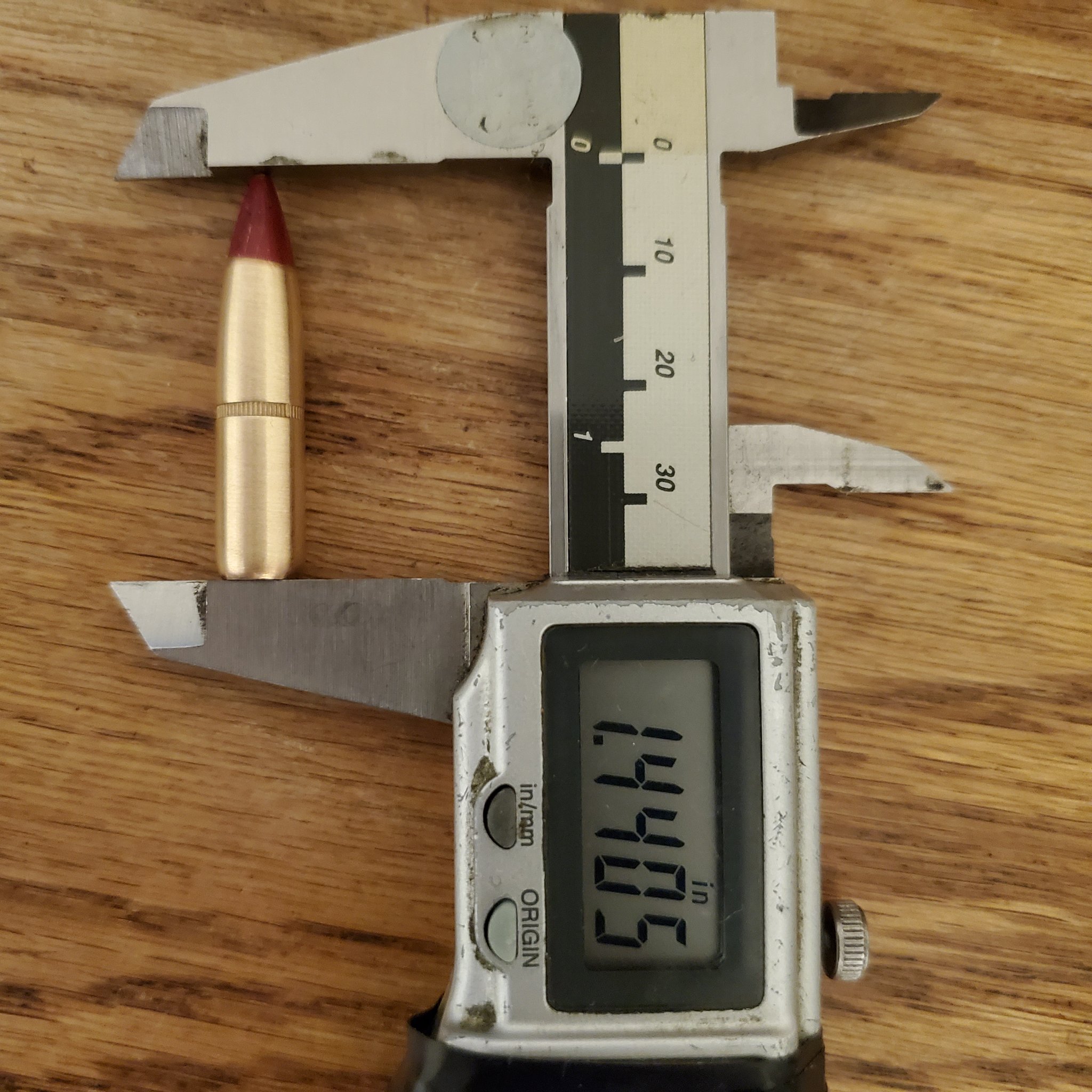

Im planning a trip to the high desert with my brothers and wanna load up some fun pills. On hand, ive got a mess of M25 tracers pull downs, some military once fired 308 cases converted to 300 savage, and primers.. but im not finding any info on what powder would fit the use or any load data at all for COAL or charge weights.

But max load data for the 149.7 gr 1.440" long M25 tracer COAL 2.600" is as follows:
IMR 4895 36.5 GR
IMR 3031 34.5 GR
W 748 37.0 GR
RL-15 37.0 GR
The bullet being longer than most 150 gr bullets, takes up a bunch more powder space for tracer material, so max loads will be down from normal max 150 gr loads, plus FMJ have a higher start pressure.
Work up to the above loads a few grains lower.
