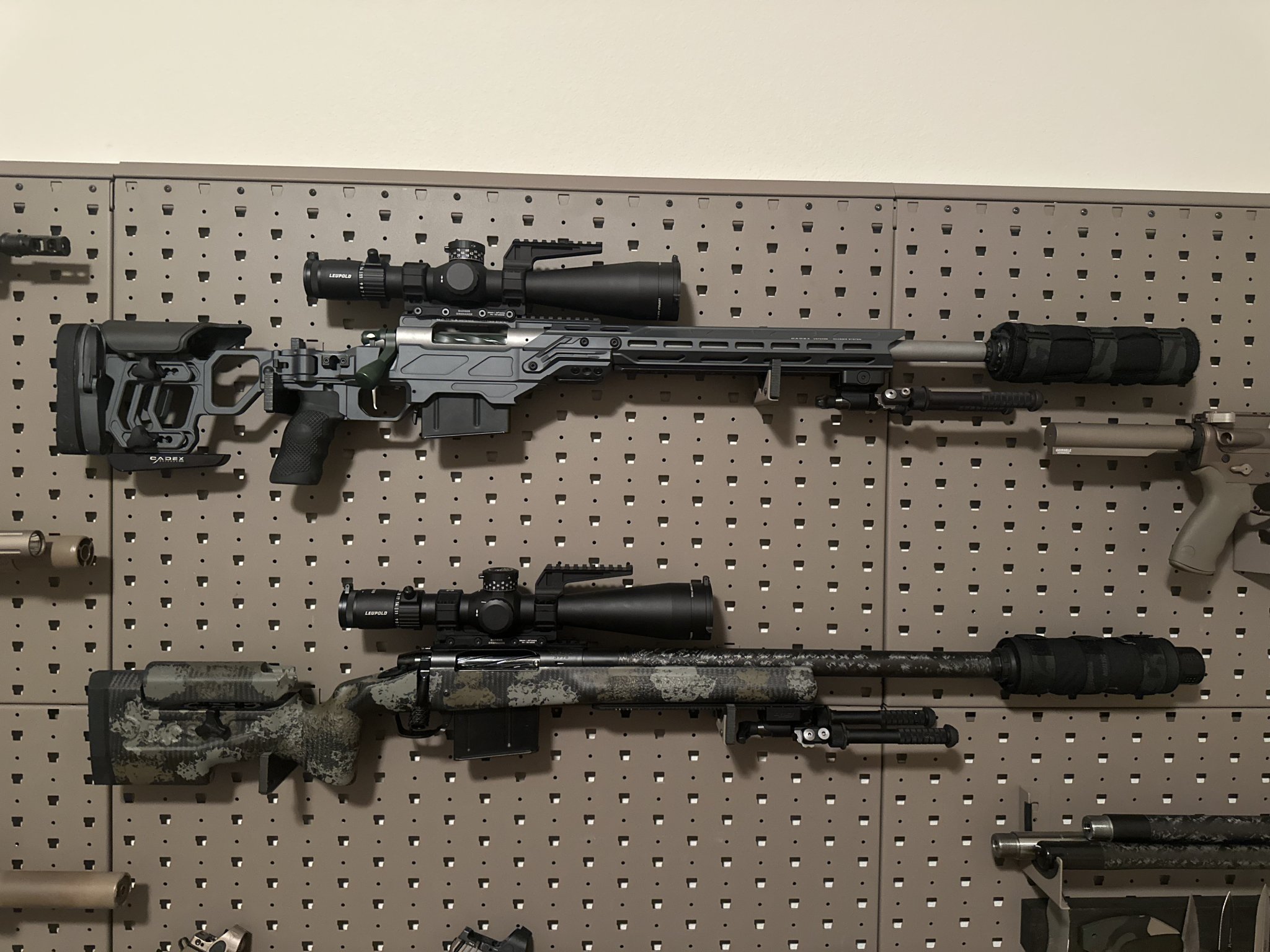

My 19” 300 win mag shoots under 7-8 sd. I’m around 2700
