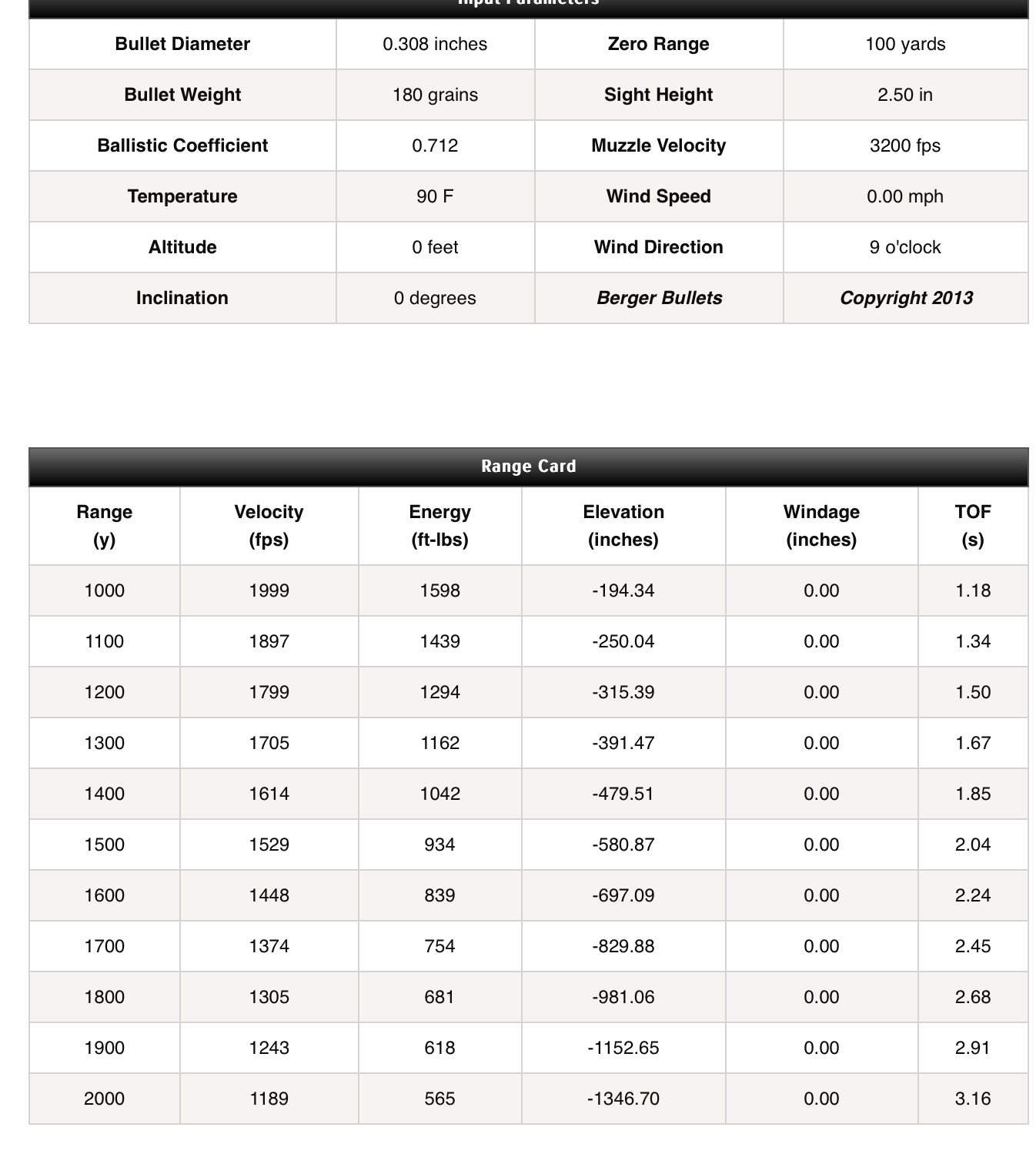

I'm using 180Gr Warren Tool Bullets - solid copper bullets. I'm starting out at 3200FPS, and I'm supersonic to ~1800 yards.
With a 1:7 twist I'm shocked that you can get jacketed bullets to hold up. That being said, solids would work ALOT better for your application. Not to mention, that with a 1:7 you can probably use some nice and heavy solids... with insane BCs.
For example:
Reactions: wildcats

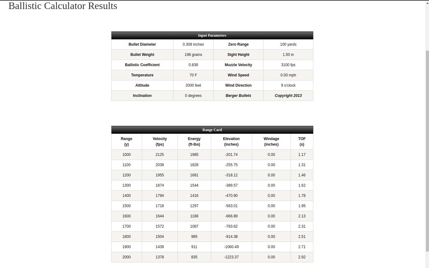

He /we haven't installed the pipe yet. his rig(setup) should allow him to spin the 230 AT at 2900MV and entertain the 212 Mono's to 2K with a nice jump.
Can you calculate at sea level in 90*F and 70%humidity for comparison? I'm curious.
