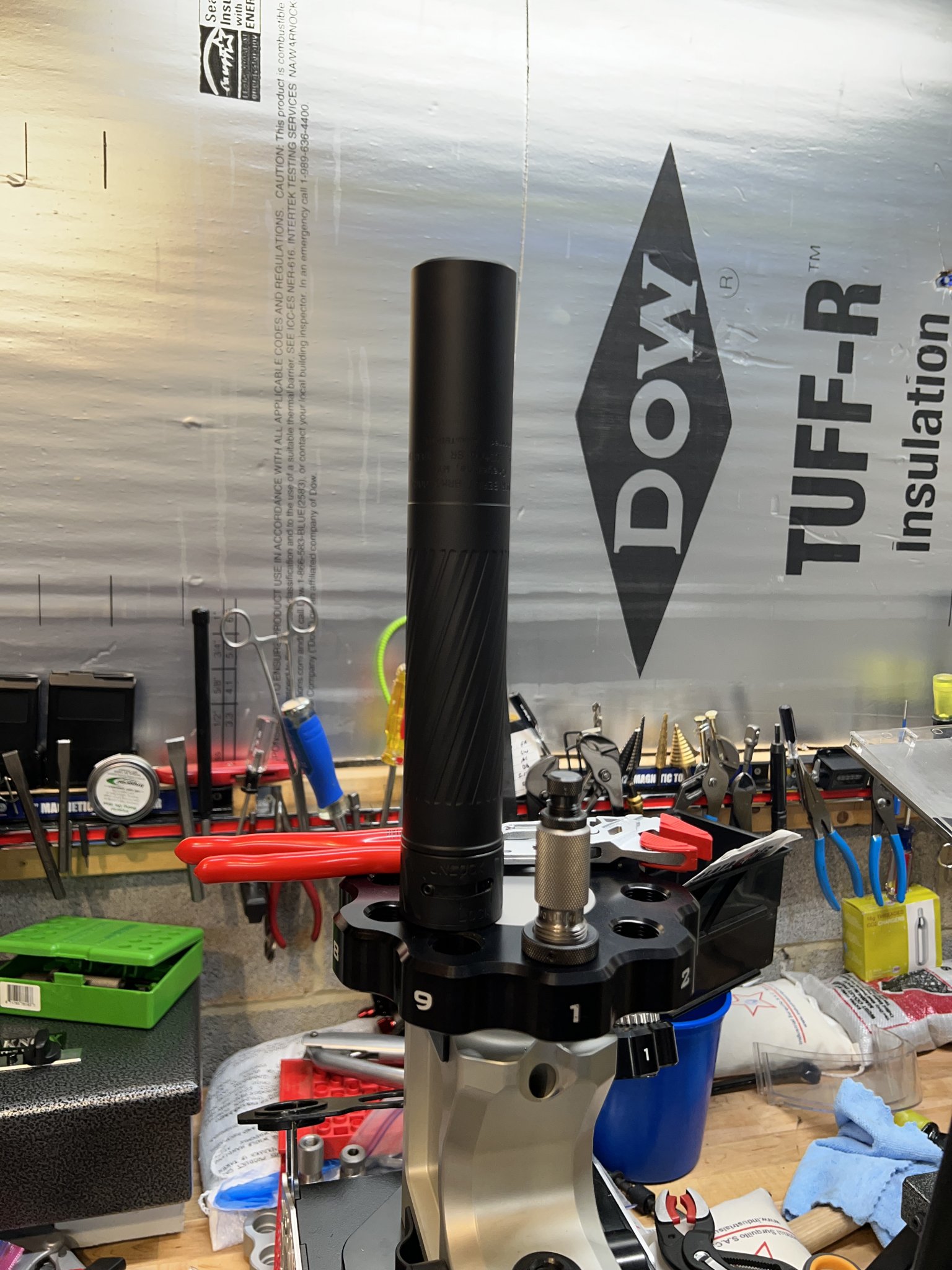

I ended up going with a 25” barrel. Dead Air flash hider and will marry it to a Sandman L. We’ll see how she performs. You can’t have everything in a weapon system and that’s a hard lesson Iv never learned. Im not concerned about the recoil given the overall weight of the system will be pretty heavy. We'll see how it plays out. Thanks for the response. I definitely am still curious about what barrel length is needed for max powder burn in a common round. Even if it is unrealistically long.
