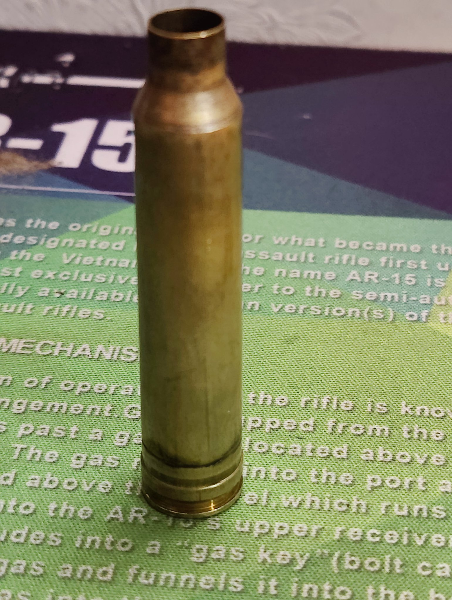

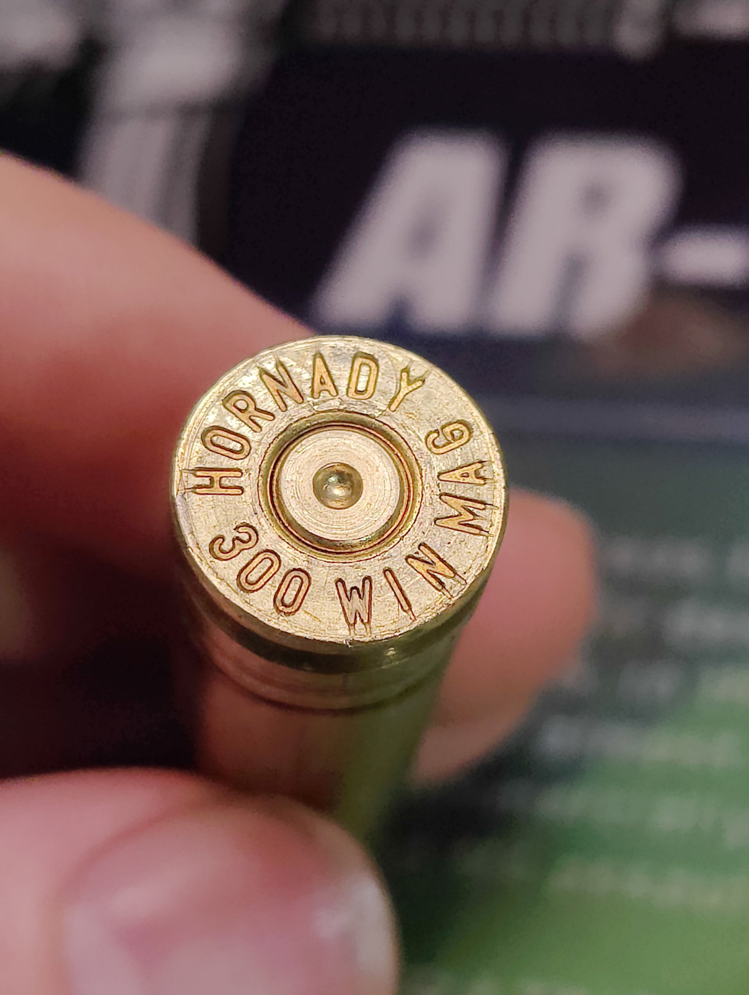

Hornady brass, 5 cycle with 79.4 grain StaBALL HD with 208 ELDM with speed 2940 fps.
Rem 700 LR SS 26" 1 - 10.
Around .030" from lands ( I think so )

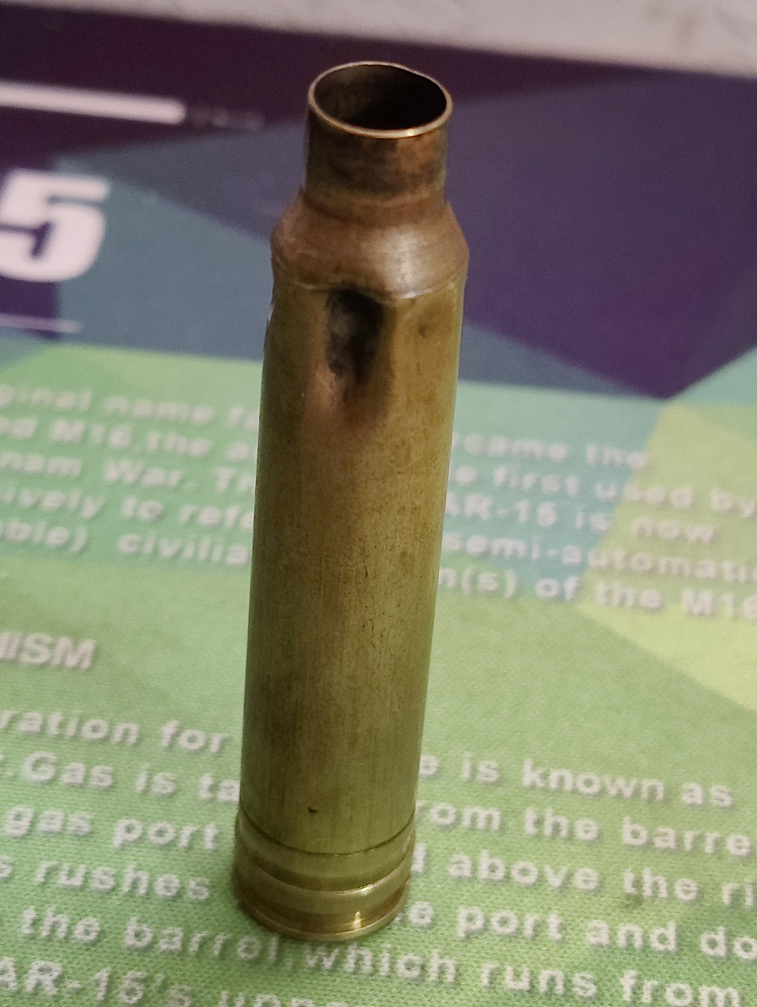

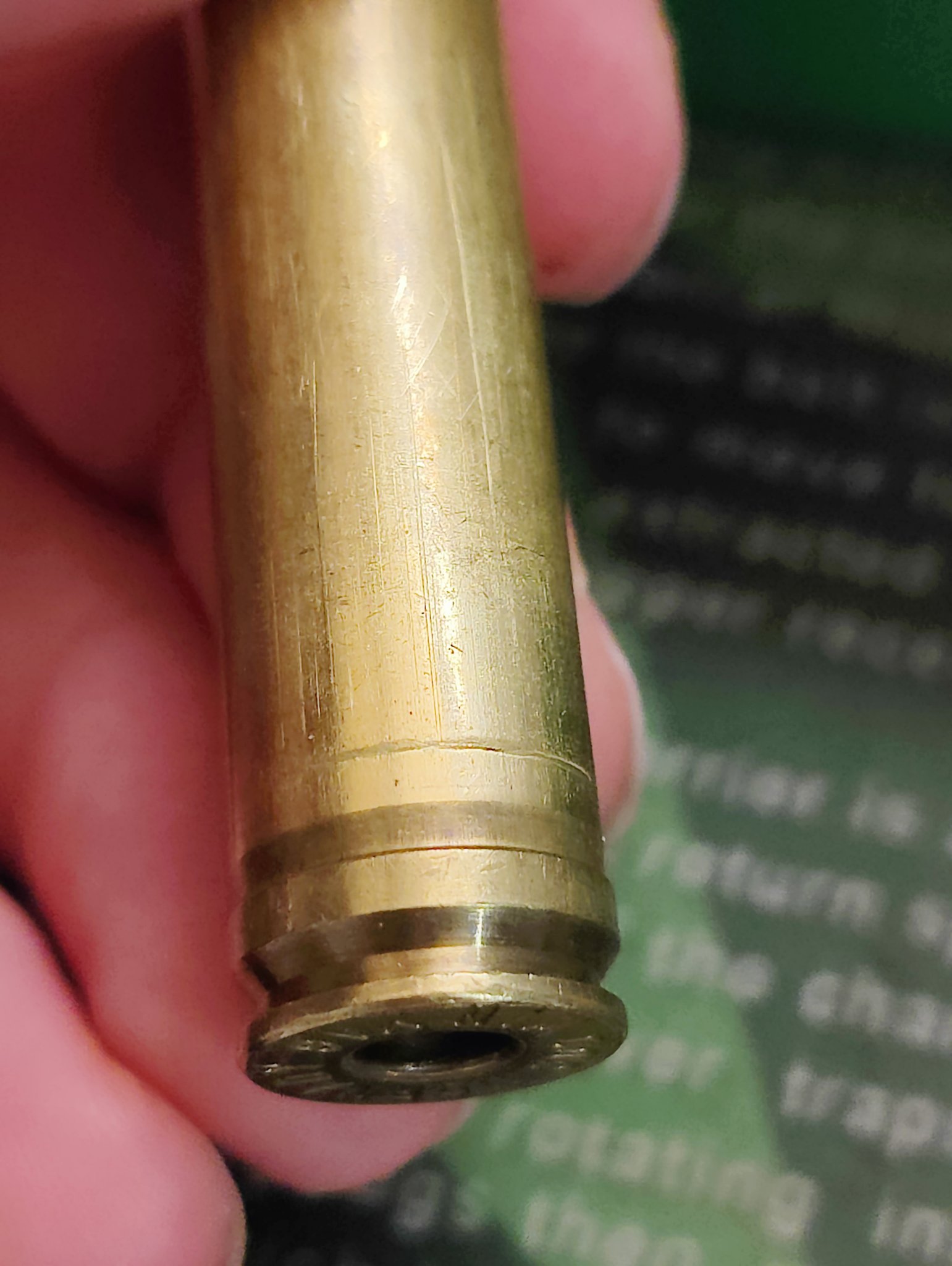

Brass deformed and crack formed near the belt.
No visible signs of pressure on primer. Should look on photo to understand what happens.
The difference in 5 cycle I switched to S&B magnum primer, before for 4 cycles used Ginex.
My question is what do you think went wrong? Or 5 cycle is the lifetime of the Hornady brass?
What you would suggest to not get it again?
Your load might be a bit warm. Especially with Hornady brass. Hodgdon load data uses Winchester brass. And based on your listed charge, I'm guessing you used Hodgdon data. I did too when I started testing StaBall HD. Not much choice.
I have two 300 WM rifles. One for hunting. One for target. I use Hornady brass in the hunting rig. I checked the Hornady case capacity against the Lapua brass I run in my target rifle... The Hornady brass holds more water so it should (in theory) be able to handle a bit more powder... But Hornady brass just doesn't seem to handle "hot rod" loads very well. That's also comparing brass used in 2 different rifles... Also a consideration.
In my target rifle, I'm getting 2950 from a 30" barrel with 208 Berger LRHT, Lapua brass, and the minimum 78.3 gr charge of StaBall HD. And I'm running a 3.64ish COAL (about .060 off my lands)
In my own experience, using Hodgdon load data in Hornady brass... Keep loads near the lower end of the scale.
Verify your shoulder bump isn't excessive. Check your surviving cases for signs of pending case head separation... And strongly consider backing off your load.
Tnx. Hornady is what I can get now for a good price, moment I can get Lapua gonna have it. Now there are some can sell for it for $3 piece :) switching to some other brass my first priority.
I seen pressure with. 80.8 grain of StaBALL HD load, so I took 1.4 grains off to 79.4. how much you would take off from the pressure?
I loaded now 78.8 gn as I seen good ES in between 78.0 to 80.4, I expect to get around 2900 fps, out of it and hope gonna see good results of ES and tune it for a good group.
I am building the load for match.
And now I know how to check pending case separation!

OK... When you started having issues and wrecking brass you had a round count of 200-300 on a new barrel?
Was this a pet load that had been doing good before the brass issues?
Mike
Yes
This is a new load development I was doing.
Never shot 300 wm or this gun before.
Just purchased the gun from reliable consignment shopю
1st brass cycle was fired from other gun
2nd I did 30 loads by OCW from
3rd also 30 to find where is the pressure and measure the speed on max loads 80+
4th 30 loads did already with load that felt good for me 79gn with 2950 speed, shot on range etc.
5th load of 30 with 79.4gn on first 5 shots each 2nd have outer signs of pending CHS and 6th one was the brass almost full CHS photos on the first mesagge in thread. De-bulleted rest 24 loads.
Decided to write here to ask what went wrong there, how it's called etc. as people on the range seen the dents for the first time.
Reactions: OkieMike
First issue brass fired in another rifle. That is a huge issue considering there are 2 different 300 wm chambers in circulation. From remington and winchester. A modified variant reamer was introduced by pacific tool and gage years ago and many rifles were chambered before it was caught.
2nd issue it's a belted round and belted rounds are prone to growing in the neck .010 on the first shot. So that can be a issue as well.
3rd issue if your chamber is oversized when sizing bumping shoulder more to chamber round causes issues of sepperation. If chamber is to deep it allows for a headspacing issue. Causing sepperation. And compound that with sizing aginst the belt and it causes issues as well. Can't properly size up aginst a expanded belt. Did I tell you I hate belted rounds
I say get new brass shoot it take measurements of datum with comparison gages before and after first firing. This will tell you if you have a issue with chamber. Reload bump shoulder .002 only check for chamber fit. Check over all case length after each shot you will need to trim after 2 reloads if not before. But before you do anything clean barrel very well make sure you have no carbon ring. And keep it clean clean at least every 50 rounds. If you can't chamber the once fired brass after sizing and bumping only .002 you eather have a bad chamber or bad dies. .
