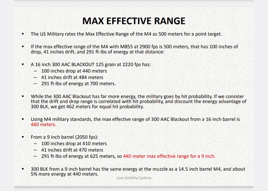

This document has some interesting comparisons. Not saying it's the end-all be all, and max effective range for any cartridge is always a debatable can of worms, but... might be a useful starting point for you:
Source: https://ndiastorage.blob.core.usgovcloudapi.net/ndia/2012/armaments/Wednesday13590Silvers.pdf

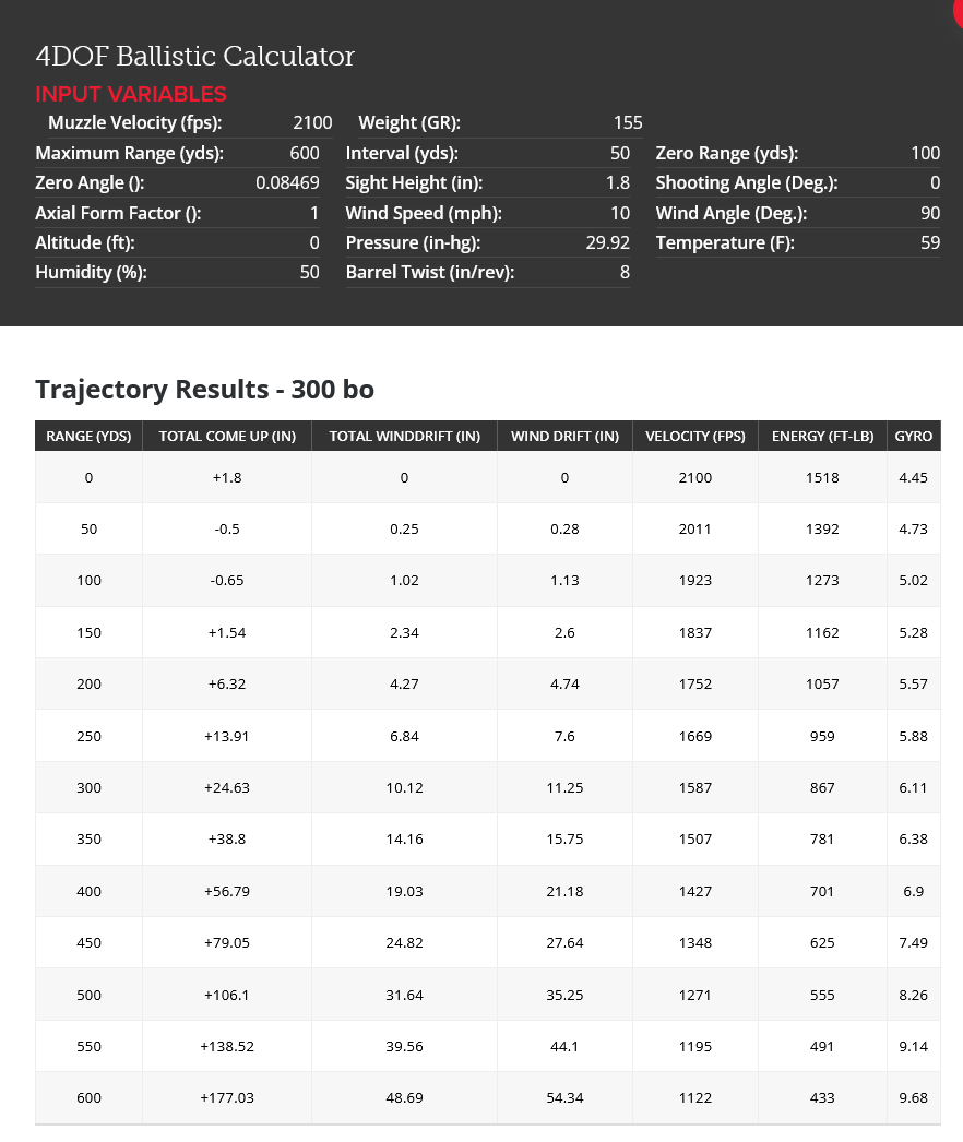

I'm basing the below assumption on what my 8.5" BO does. 1850fps with 155 eldm loaded 2.210 coal.
I shot the above next to my 350L 11.5" with Barnes 170 TSX @2150 & this 350L hits the 200y plate with a lot more authority.
If I were going to try it (I wouldn't)!
16" Barrel Carbine gas
155 eldm 2.210 oal ish
1st choice SBR So Com
2nd choice Lil Gun
2100fps I think 500y is about max for Supersonic and good hit probability if not much wind.
Also I don't shoot anything in moa but @ 500 per below that's 20.3 moa or 5.9 mil.

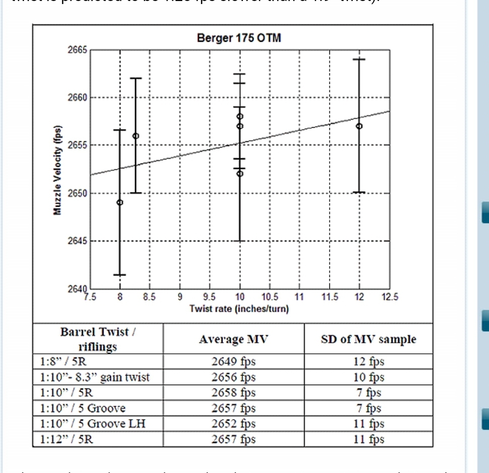

This article explored twist rate vs velocity with 308 and didn't find a large difference. Not sure if that can be applied to 300blk though with such a faster powder burn and smaller charge. Twist rate could have a bigger impact.

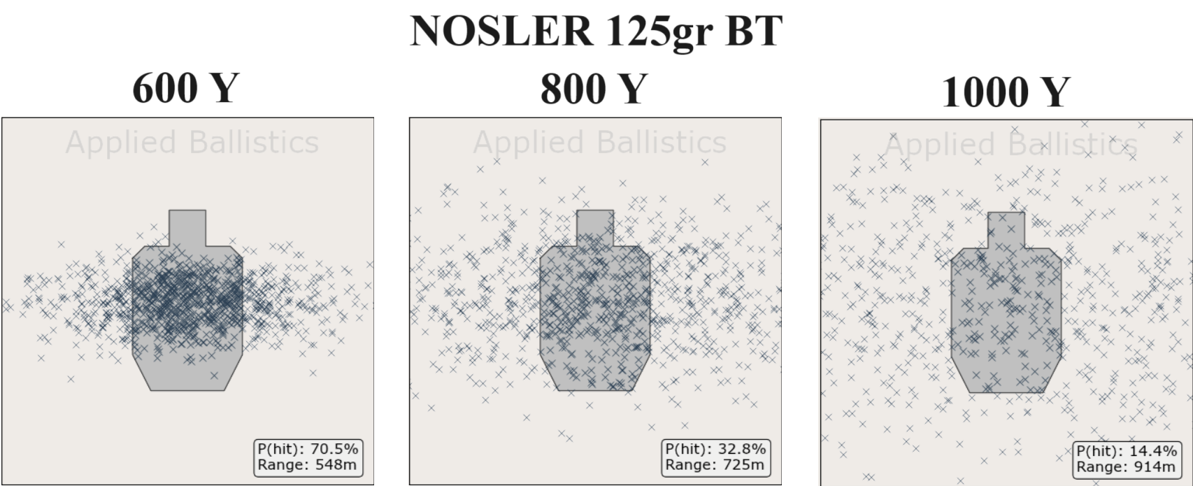

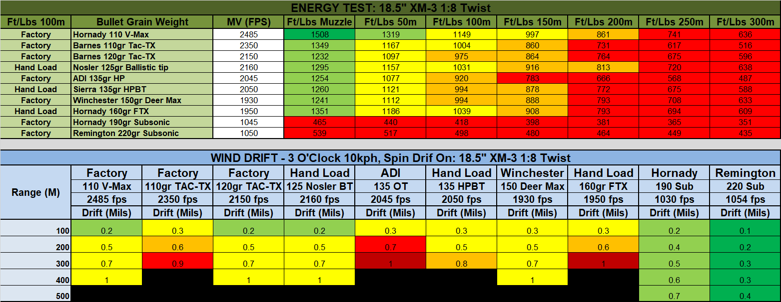

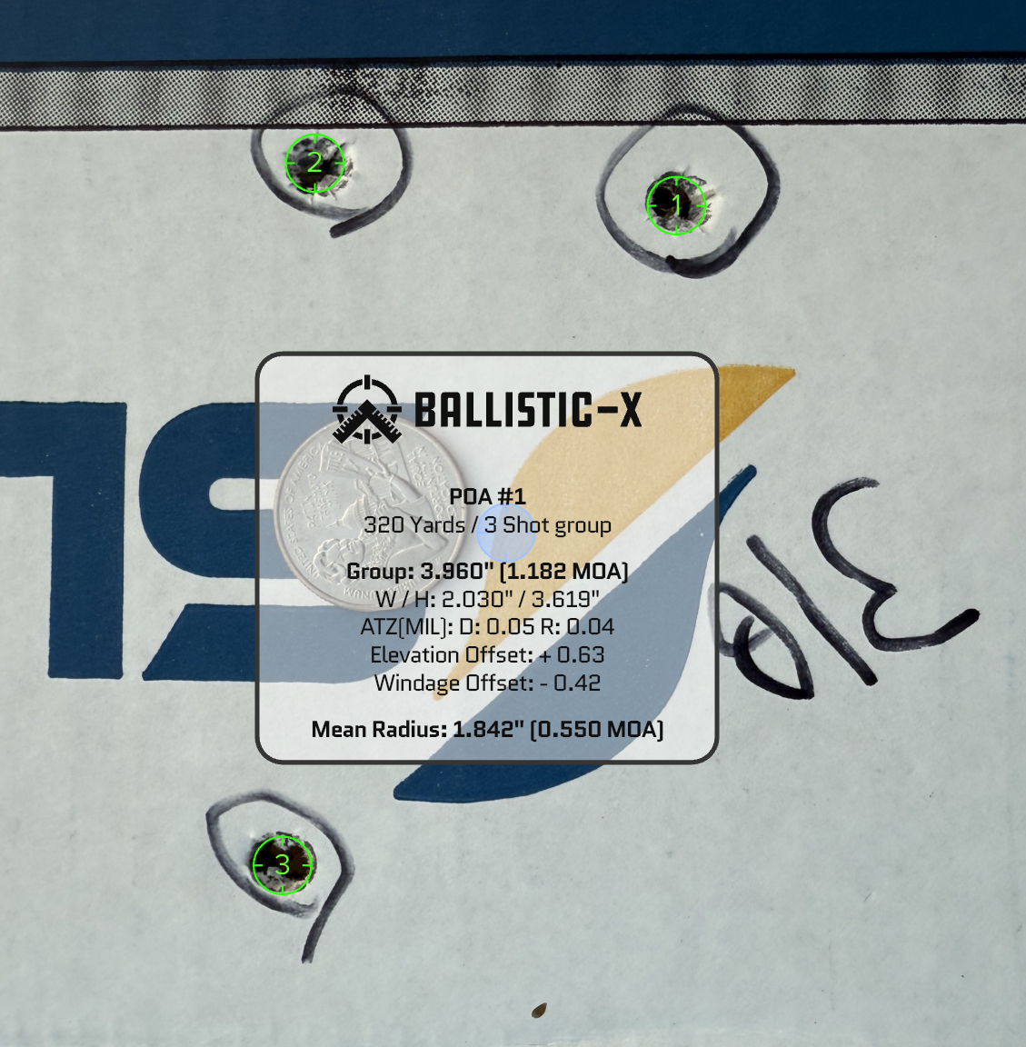

Not sure if this is going to help you, but we tested blackout out to distance (600y) and it was really consistent but you had to use good bullets. We were able to reliably, repeatedly and accurately engage a 12" steel plate to this distance. This was the max reliable range. After 600y, wind and all sorts of things really wreaked havoc. Some of the bullets were just insanely poor but the ones that stood out were the 125gr Nosler BTs, and 110gr V-Max. Absolute pick of the litter was unquestionably the 125gr Nosler. That bullet is exceptional. The really dissapointing ones were the 220gr SMK subs. In the wind drift chart, they have the highest BC so perform well against wind, but trying to keep them on the upper edge of subsonic.... man, the vertical spread was horrendous. The lowest mv was 720fps. Highest was 1200 something. No good at all.
We pushed these to 1000y.
Wind is what we use as a rough indicator of hit probability. This was through a bolt gun but for the shorter guns they were all Sigs or Warricks.
After testing, I ended up converting the 300blk bolt gun to an XM-3 build (had the right barrel length) and it's now a plinker for me.

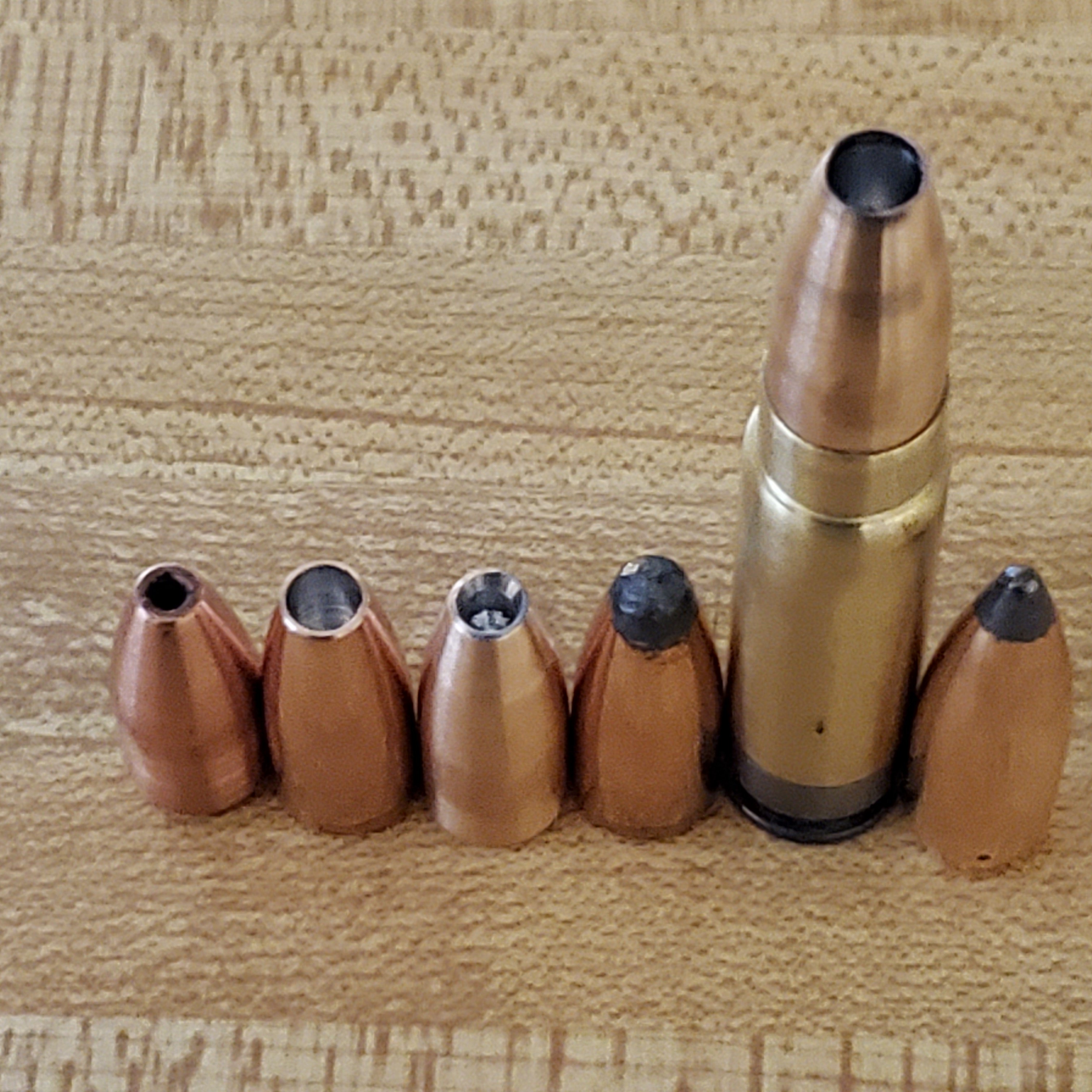

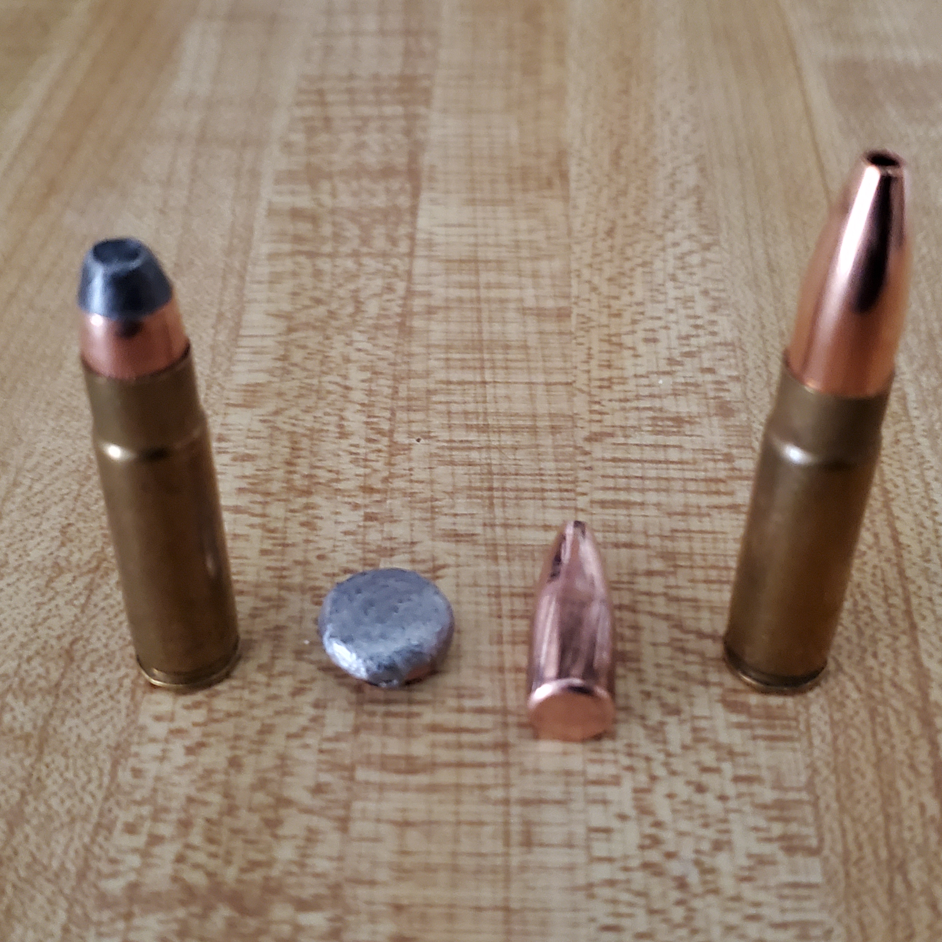

I don't believe you'll achieve what you want to in the 178gr class bullets. We didn't specifically test the 178s as we found we were just running out of MV to make the heavier bullets work.
The blackout case has a small capacity to begin with. When choosing bullets, you have to decide whether you want supers or subs.
The long high BC bullets are great in 308, because you have the case capacity to drive them to the speed they need to do their job. That's not the case with the Blackout. The long HBC bullets eat up a lot of your case capacity. Especially when loaded to SAAMI spec. They have a long boat tail that precedes the bearing surface, so the bullets have to be seated deep even when you aren't limited to SAAMI. This means you just don't get enough powder to build up that MV.
This is where we sat on the 125grs. High BC (for that class bullet), great design so it gets through trans, isn't super long so we get enough powder. It was 100% the sweet spot. Looking at the results here. We were going off mainly factory ammunition. The Winchester Deer max was very good as well. I'm wondering if a 155gr ELD-M might be worth a look.
We’ve taken them out to 385y and they still hit the steel pretty well. I wouldn’t wanna take one at that distance.
We used the 800ft lbs as min requirement (deer) because in Aus, guns are scary..... but seeing as this forum is in the land of the fuckin FREE! 350ftlbs is seen as the minimum amount of energy required to cause trauma on a human being. With the 155s, you're good to 750m and it's still 340ft lbs at 800m so just sneaking under.
With the 125s is about 625m, so in this case, the 155s are better.

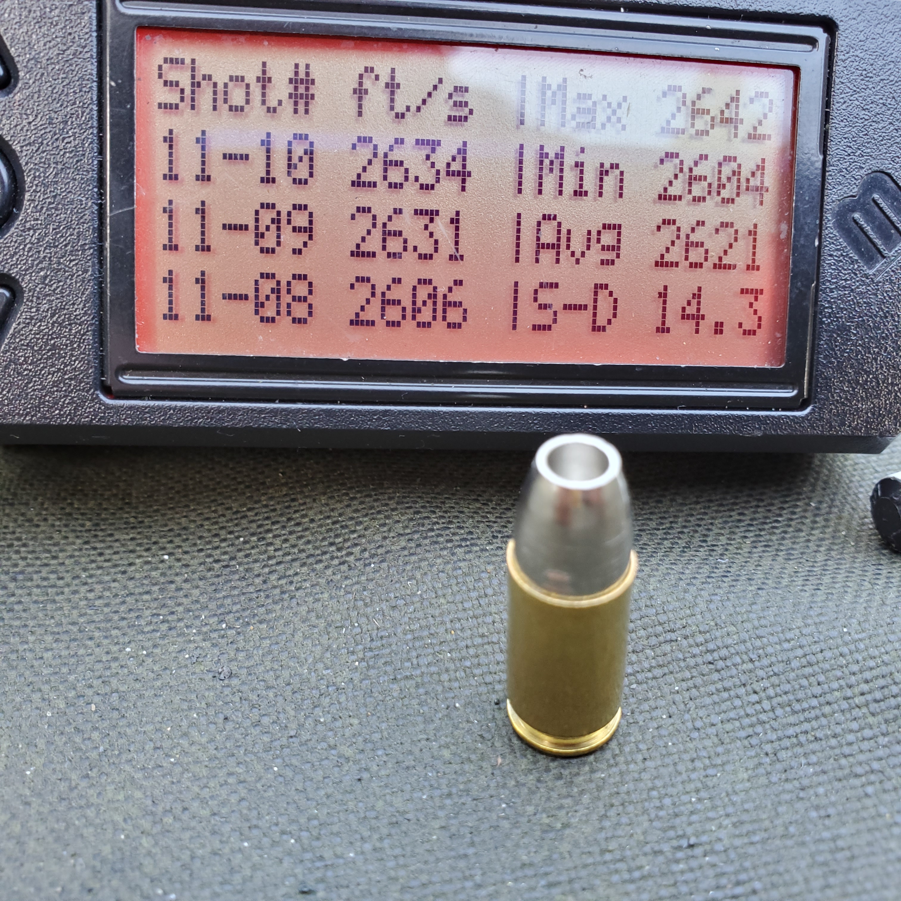

If your stuck on the 300 BO super and light bullets 110 to 120 gr the 300 Hamr is your ticket. Brass is slightly easier to form out of 5.56, uses the same components as the 308, or 300 BO.
But the 300 Hamr gets more velocity, my 18" gets 2766 fps with the 110 gr Barns, & AA 1680...
Or 125 Accubond to 2509 fps to 2589 fps depending on loading factors, it has a fair BC and more weight.
150 gr gold dot 2386 to 2400 fps
150 gr Speer BT hot cor 2303 to 2398 fps and produced a 5 shot .264" group at 100 yds.
Seems like the 300 Hamr would be your best tool for the job to meet your requirements. I have both, an 18" fluted Hamr would be the ticket.

The 300 Hamr is your ticket. I have load data.
