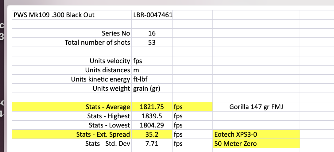

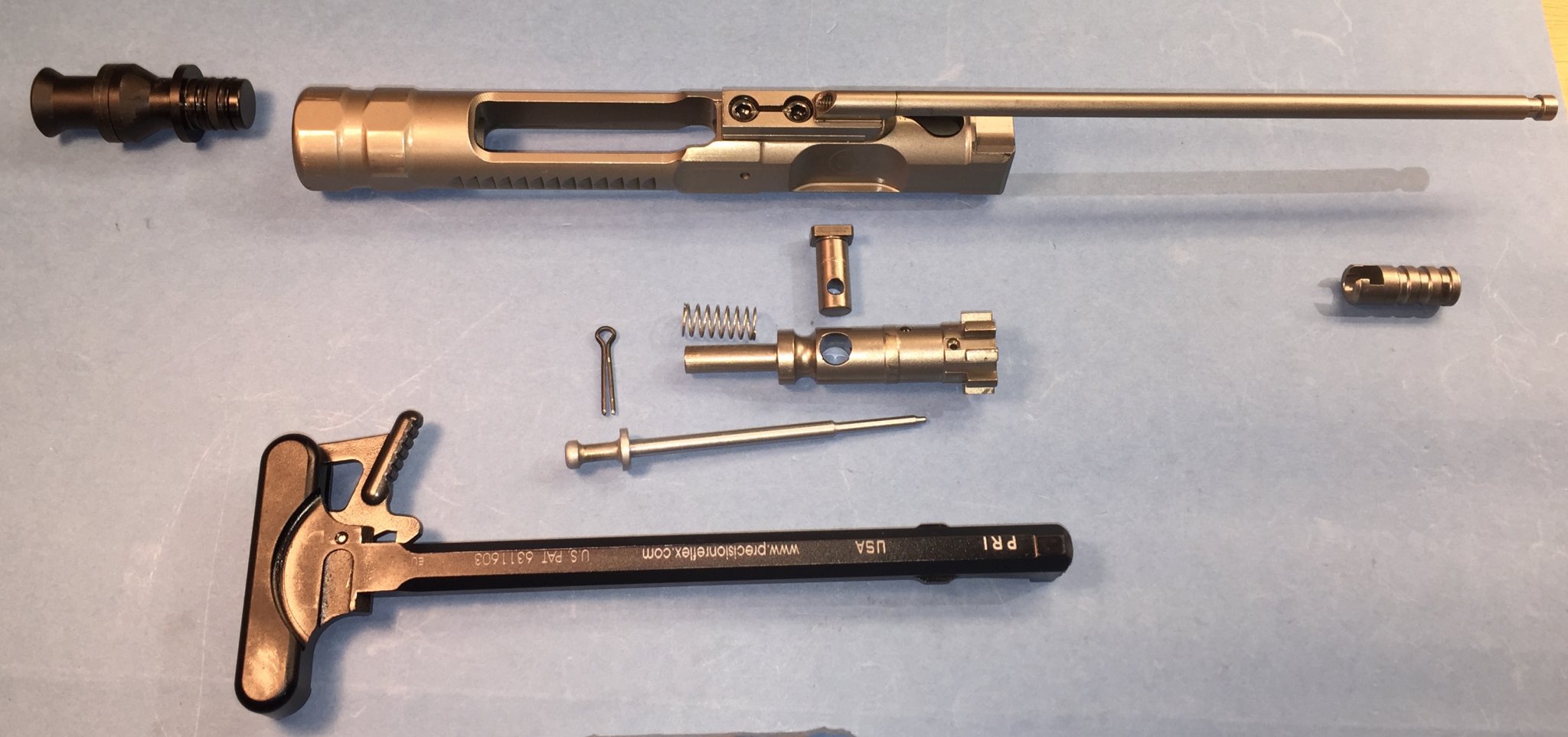

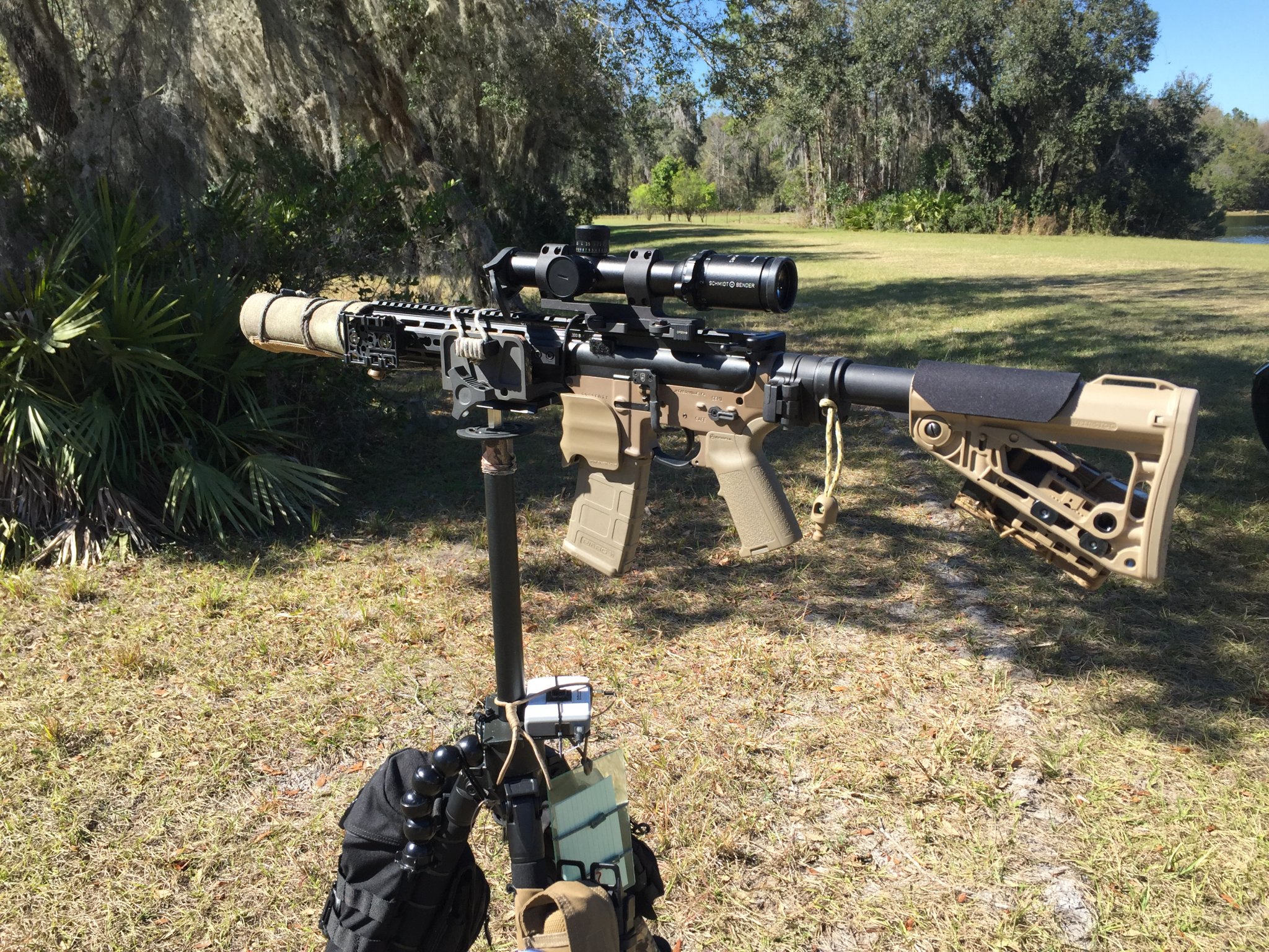

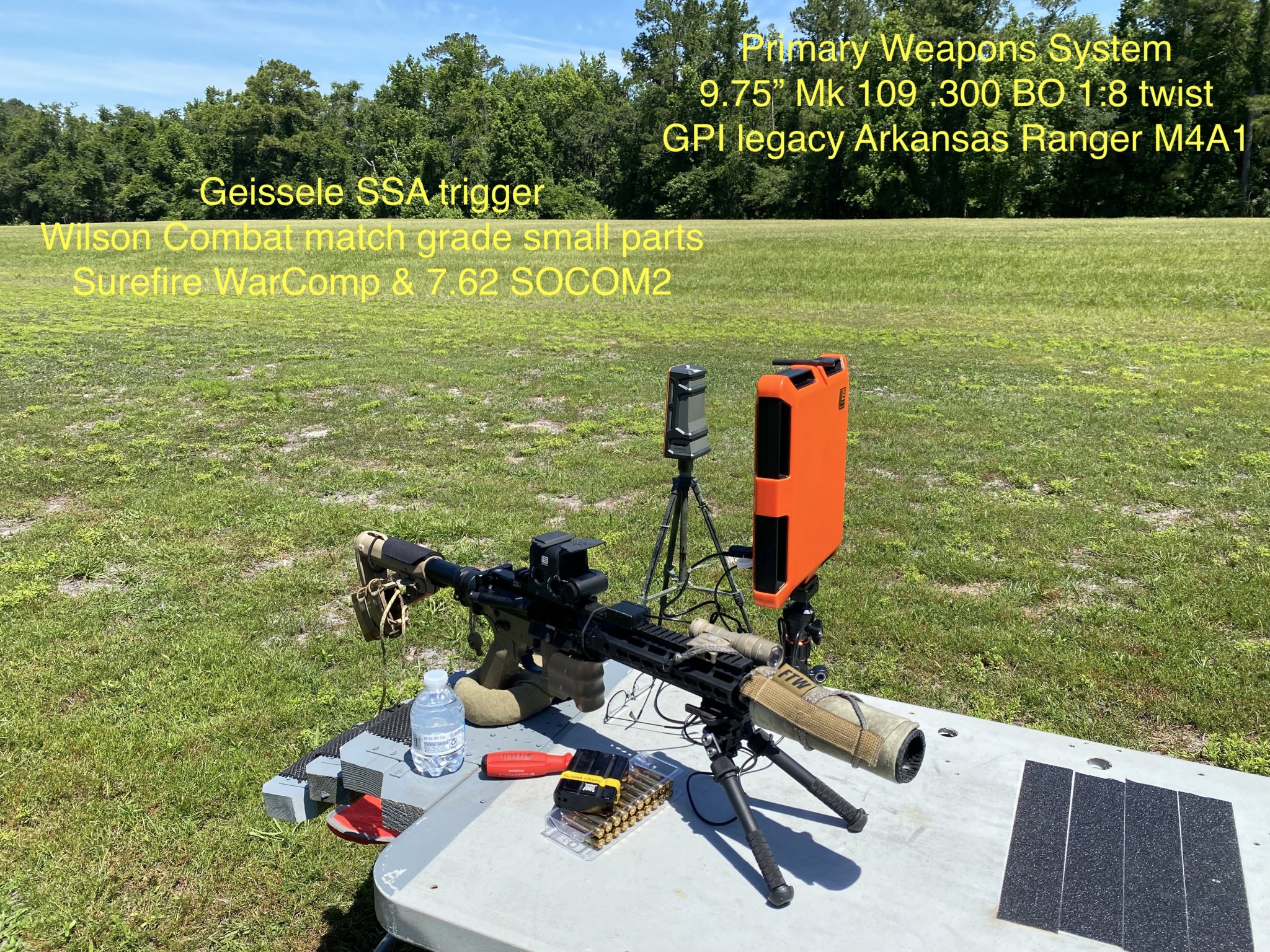

I have this long-stroke piston Primary Weapons System (PWS) Mk109 9.75" , NP3 bolt carrier system, with other modifications and a variety of optics.
IMG_7087PWS Mk109 .300 BLKO Eotech Zero 50 Meters Cracker Swamp 05.08.23 ANNOTATED  copy.jpg

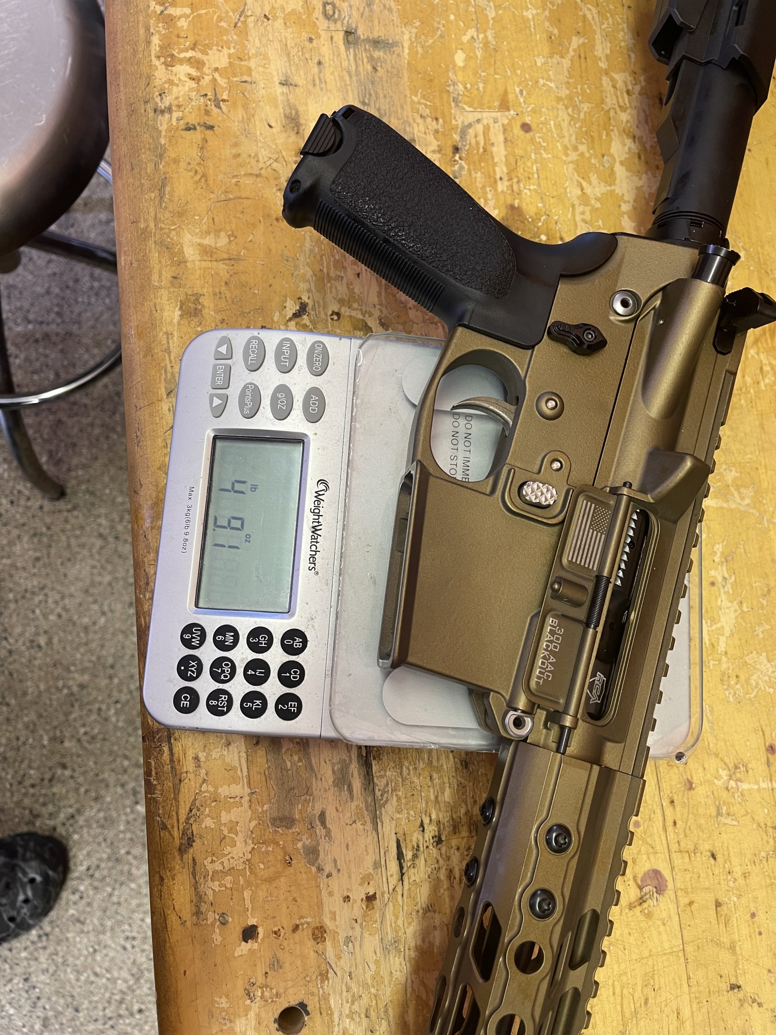

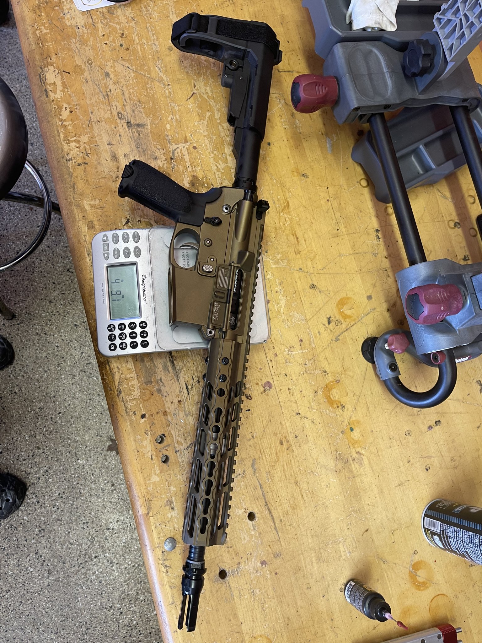

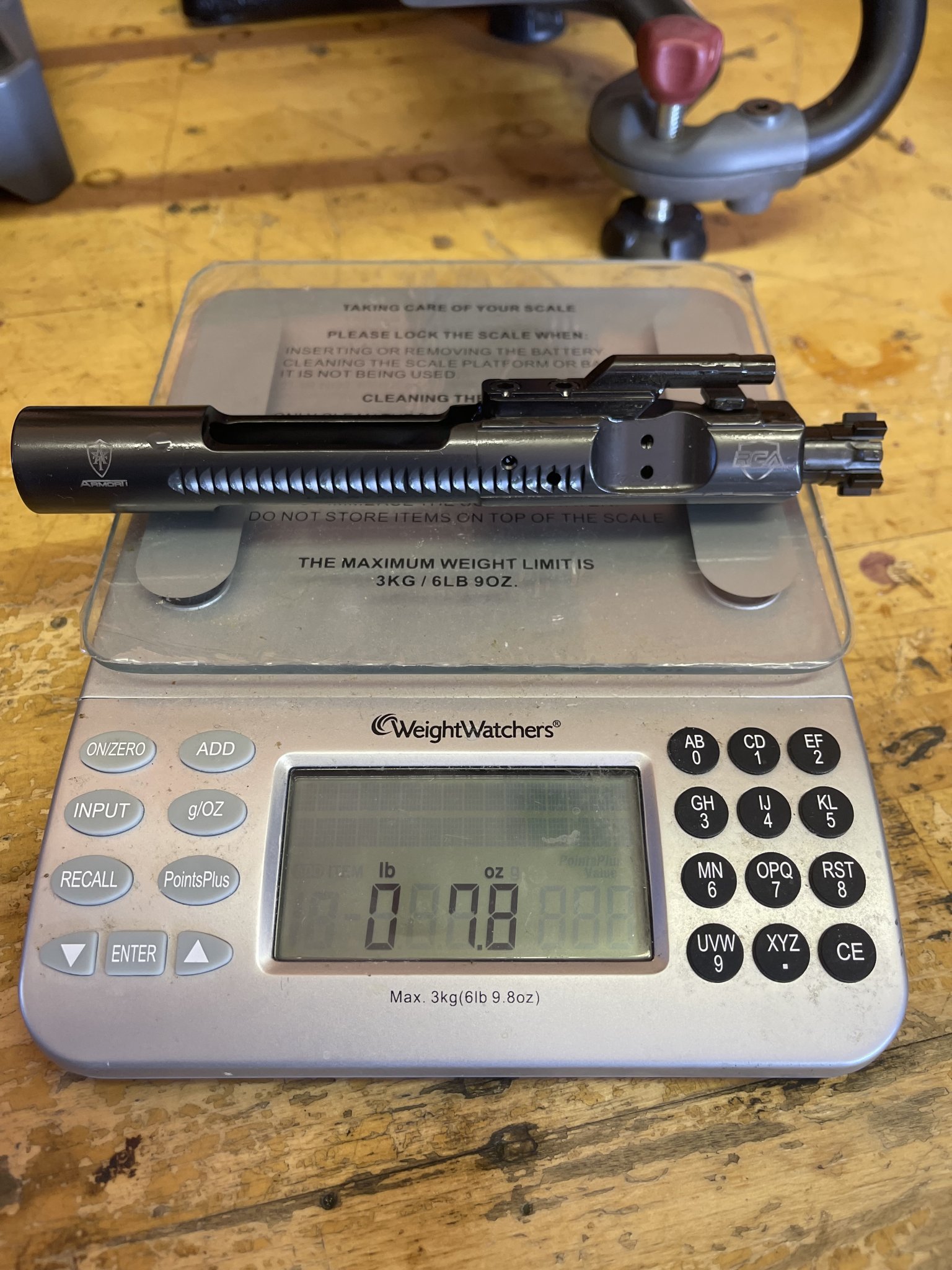

Take these as relative weights to one and other. It's a low budget, cheap scale that I think is about .3oz off (high).
First POF BCG. This is the same one that comes in the 300 Blk. upper. Take into account the actuation rod is not included in the weight of the reciprocating mass and on this one I'm using a JP silent capture SBR/Suppressed buffer setup. Add .5oz for carbon. I kid. Going to guess, with the operating rod, the entire system weighs about 20oz. for the 12.5" barrel. It'll weigh slightly less with the 10.5" barrel. The 12.5" is verified carbine length gas.
Here's the Sig, which like the POF, is NOT a pistol-length gas system so longer dwell time than pistol-length. This includes the actuation rod which is affixed to the BCG. Surprisingly, it's lighter. I've always felt mine was over gassed so likely why the recoil impulse/felt recoil is more severe by a good bit than my DI 300 blackout or any of my 5.56 rifles. I believe the military gets a titanium version of the BCG to save more weight. Would love to get my hands on one of those!
Lastly, the RCA titanium BCG in my 300 DI with the Unrivaled dead blow competition buffer. I've never had any issue with the piston guns cycling various ammo and the same can be said with the DI setup except for some factory ammo, particularly the Hornady 208 grain A-Max. I've tried a handful of different powders using this setup as well and it's not that finicky although I'd say Lil'Gun is the worst of what I've tried in terms of consistency. I do use an adjustable gas block (Riflespeed).
