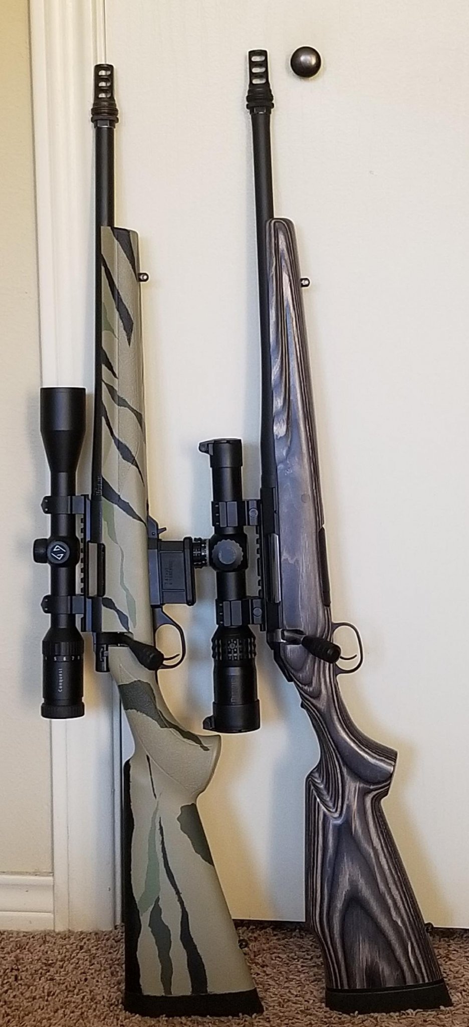

    I have a Ruger American Ranch in 300BLK, and a Howa mini in 7.62x39. Both are an absolute giggle to shoot, but I haven't had a chance to (successfully) hunt with either one; though I DID open up an armadillo like a can of Spam with the 300BLK from about 5 yards... :p
    The BLK is on the right:
    You mean like this?
    Its fun, but pretty useless. Sub MOA at 100, 18" vertical at 300yds
