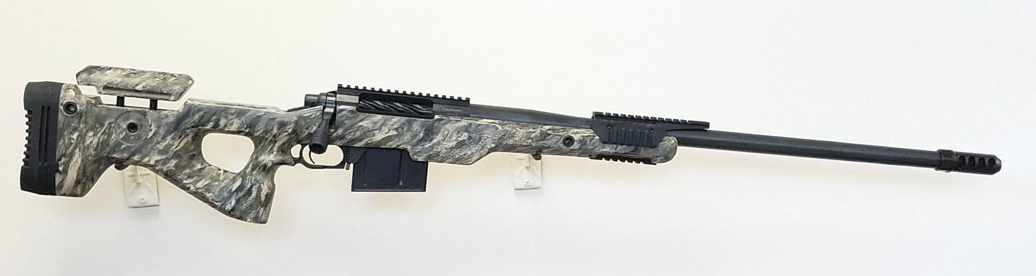

Properly spec'd Defiance runs excellent. Just have your builder do what is necessary to make sure your bolt body diameter is not too tight inside the receiver once complete.
I have built between 15 and 20 rifles in .300NM on them and all are running excellently. Krieger Extra Heavy Palma contour in 1-9" twist seems to be the shitz.
Short action Deviants will run just fine in PRS or other dirty conditions when same details are attended to.
./View attachment 6958635
Hi Terry, I think you told me before but I can't remember. What do you ask for when specing a Defiance properly and what do you tell your gunsmith. I'm going to be ordering my Defiance action soon. I got the stock on order a while ago but couldn't make up my mind with so many options on the Defiance
