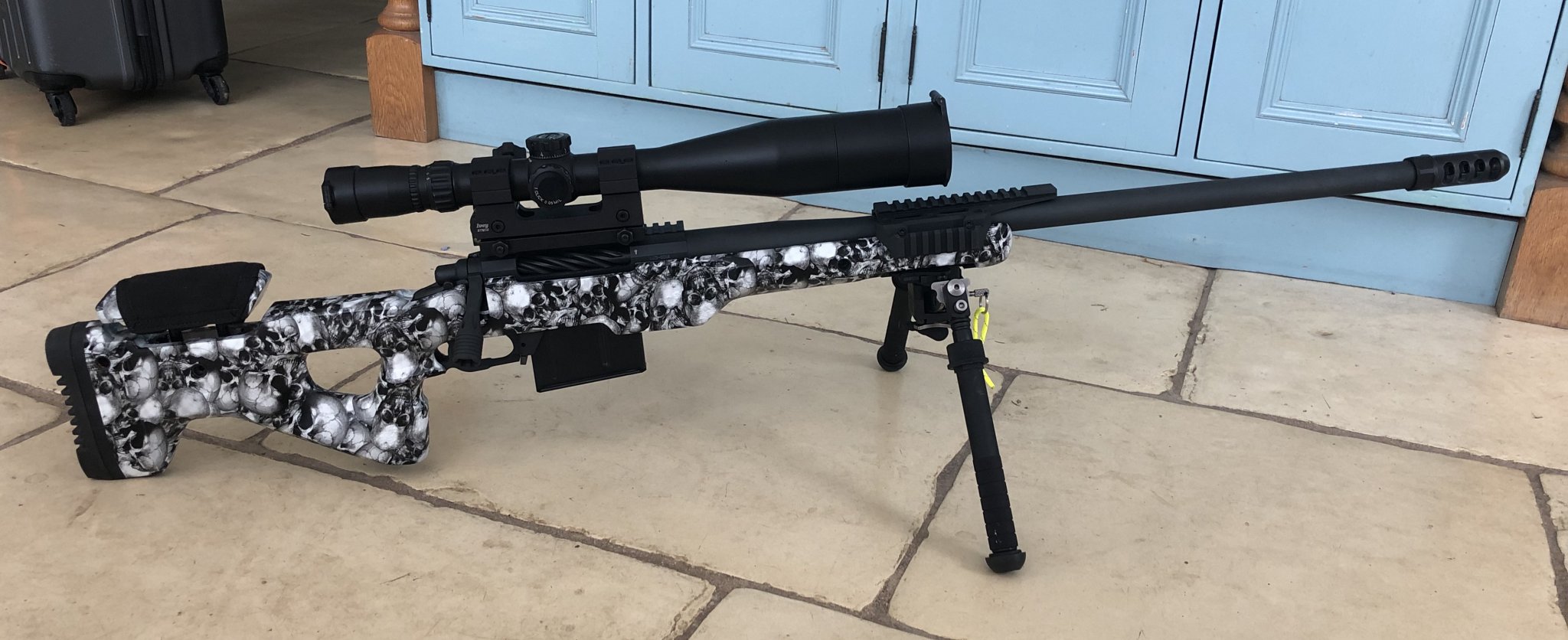

Just tidying up the rifle after dipping - KMW LongSword by the really nice chap Terry Cross.
ELR is starting to be of interest in the UK with some ranges now available so I thought I'd have something suitable to start with.
Terry made a tidy package based on his version of the Defiant action with a 1:9 Krieger barrel, Calvin Elite trigger. I added the trimming of Ivey mount with the March 5-40 x 56 .
Non camo dip as I'm neither ex-military and camo is so yesterday :)
loads are running quite nice in development, obtaining 2930-2970 using 230g OTM's over RS80 (aka RE33) but some tweaking to do yet.
TerryH what cheek pad is that?
