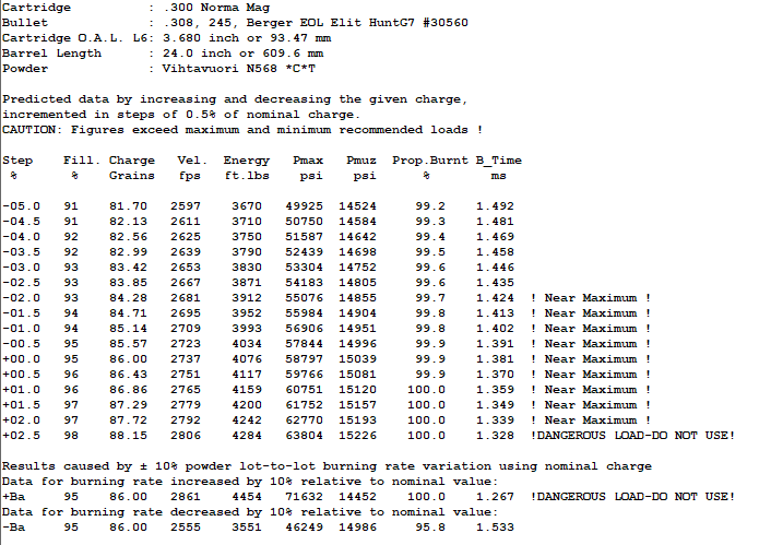

Here's some ballpark numbers for a hunting barrel - 24" with 245 EOLs
