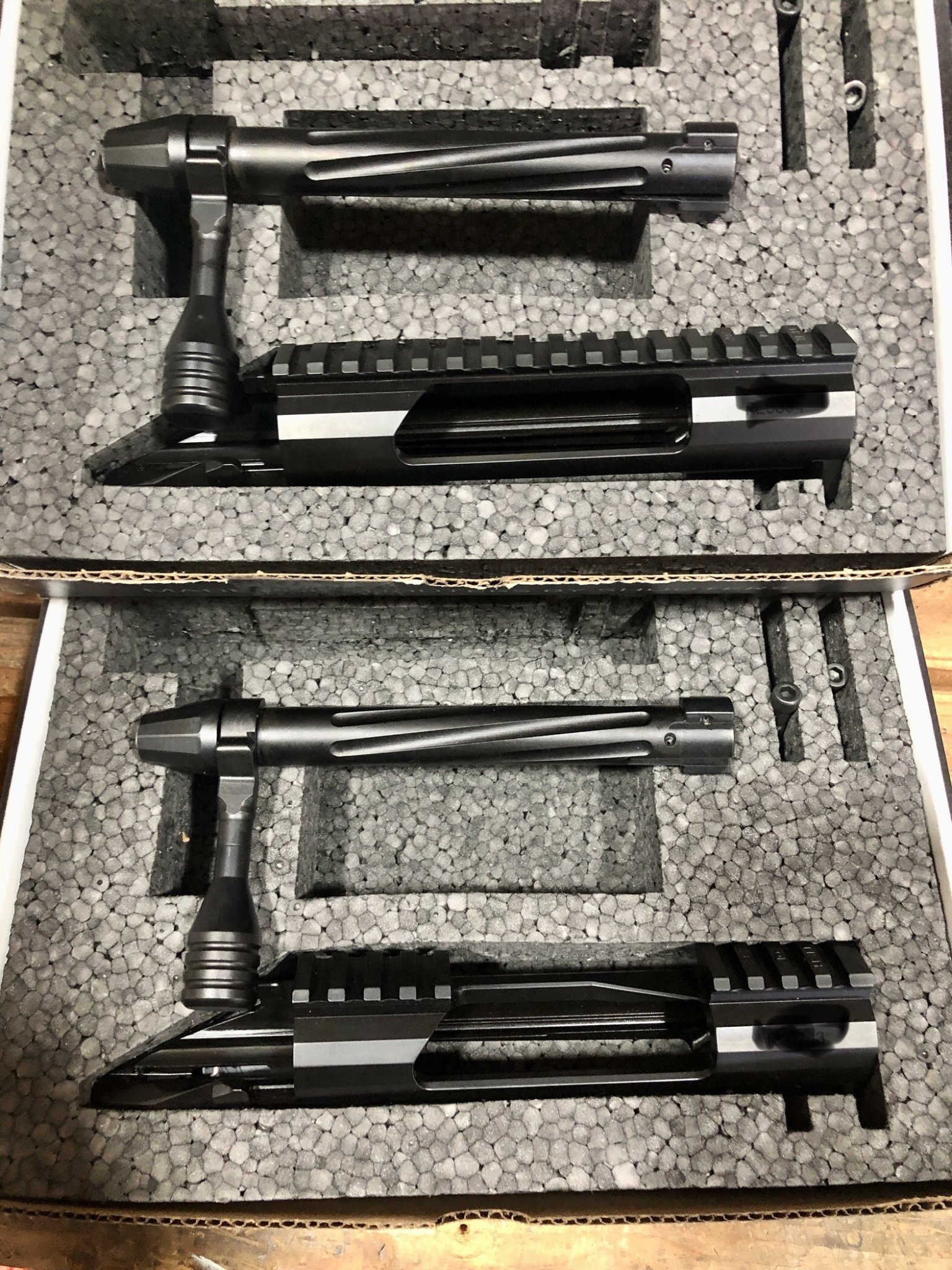

So I have two Long Action Impacts with magnum BF, and two additional bolts one standard and one Lapua. The Split rail is going going to be a 30-06 / 300 WM switch barrel. The full rail is going to be a 300PRC and some form of Norma Magnum.
