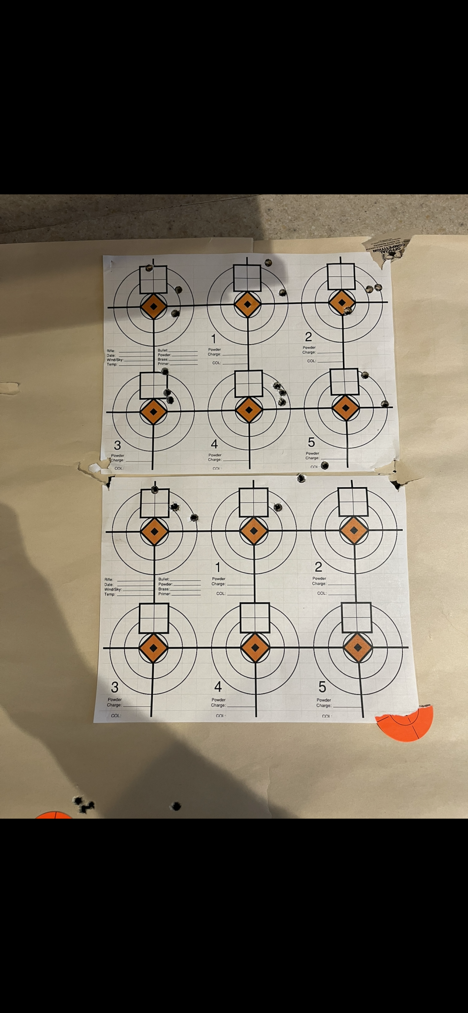

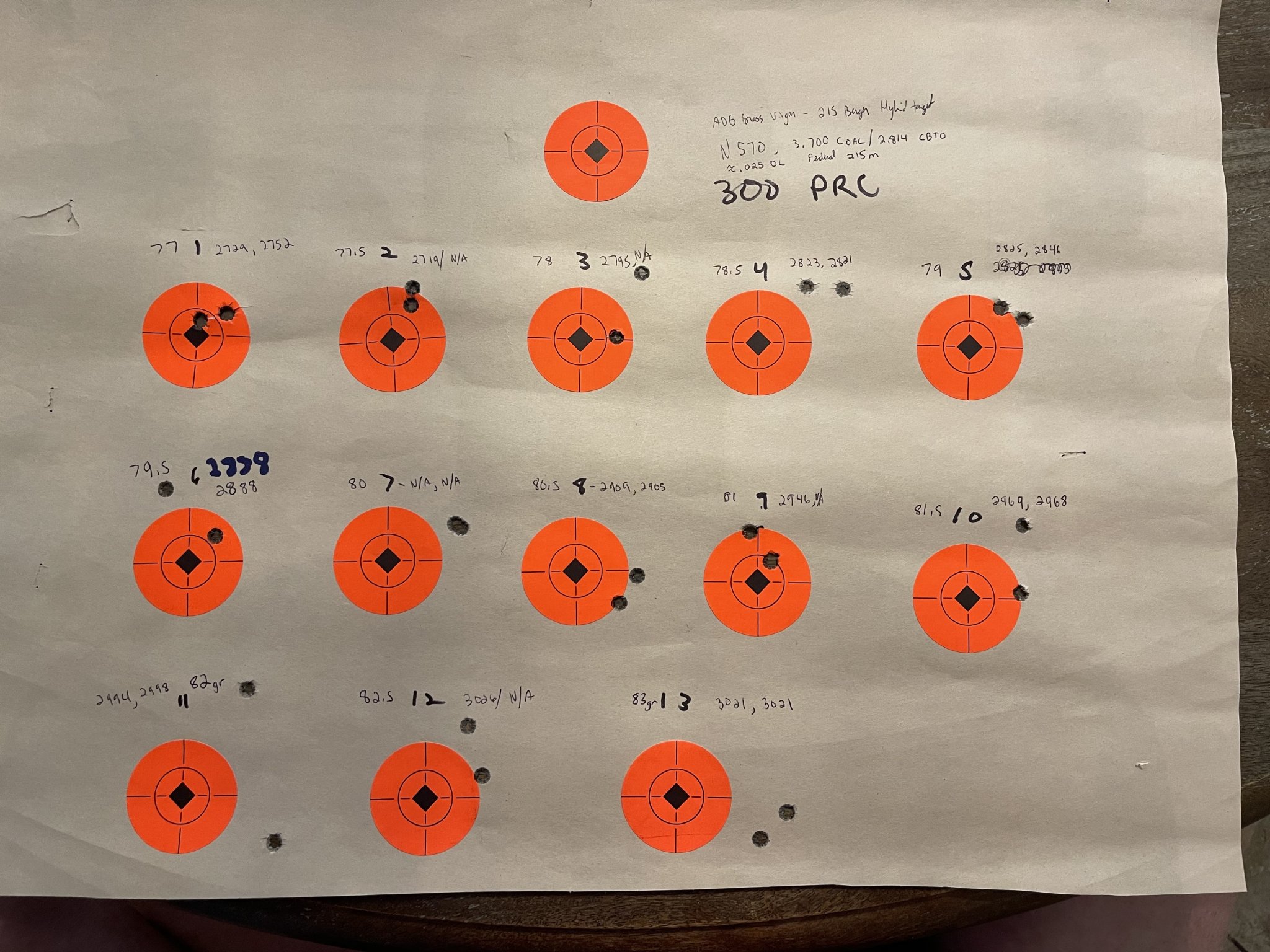

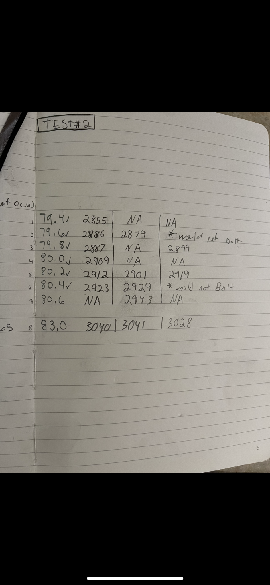

I'm struggling to get my 300prc to group with Berger 215s and N570. I've tried powder charges from 78-83.5 all .020 OL. I then found a good velocity node around 2920. Then ran seating debth ladder from .053- .069 as I've read they like to jump around .060. Still wildly inconsistent. Question is, what's next step? I have H1000 I can try or just move to Berger 230s. Would you change powder or bullet first?

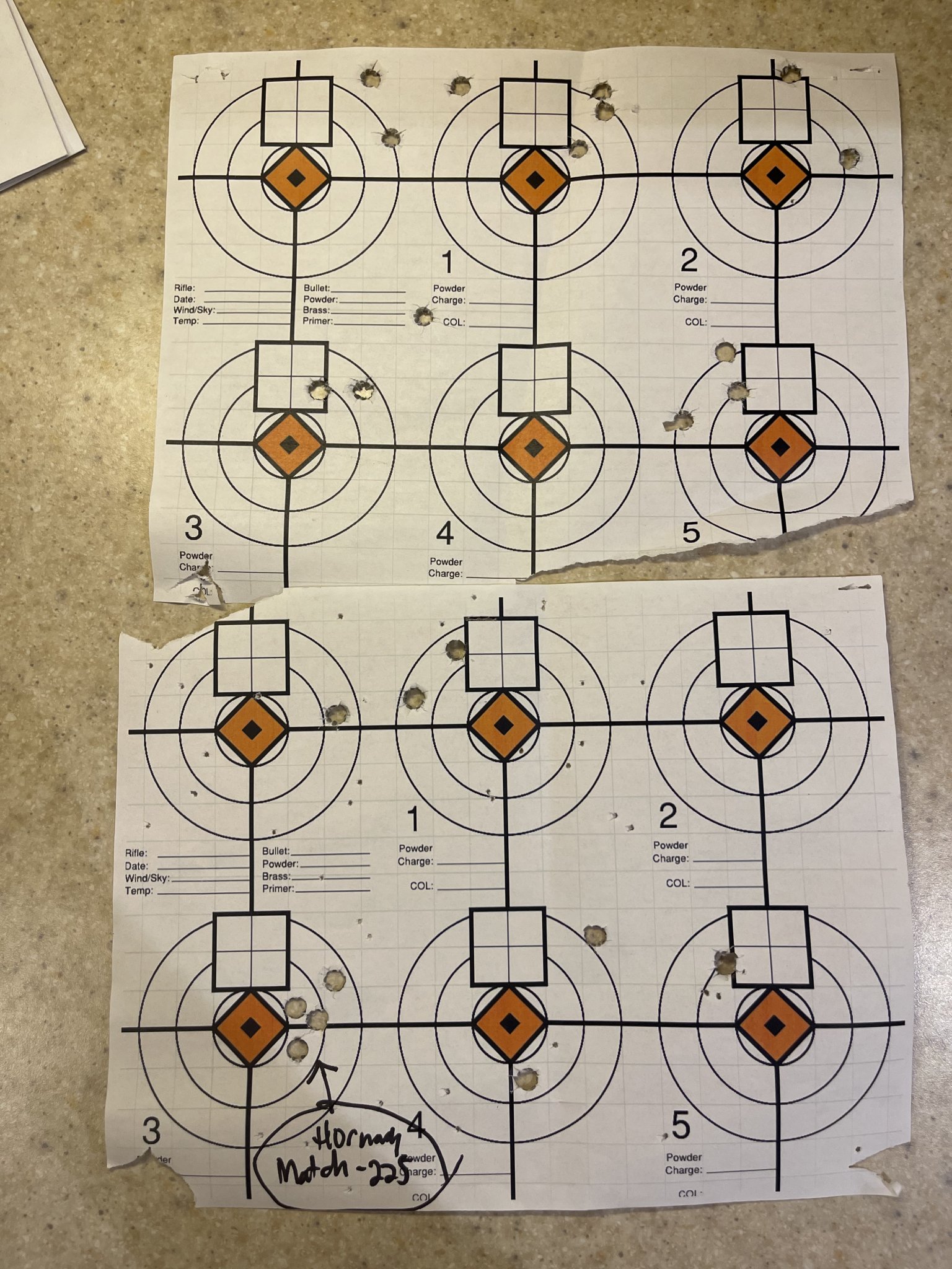

I shot a 5 shot group right at 1moa with hornady match 225s to make sure my scope wasn't moving.
Lone peak, carbon proof 26"...

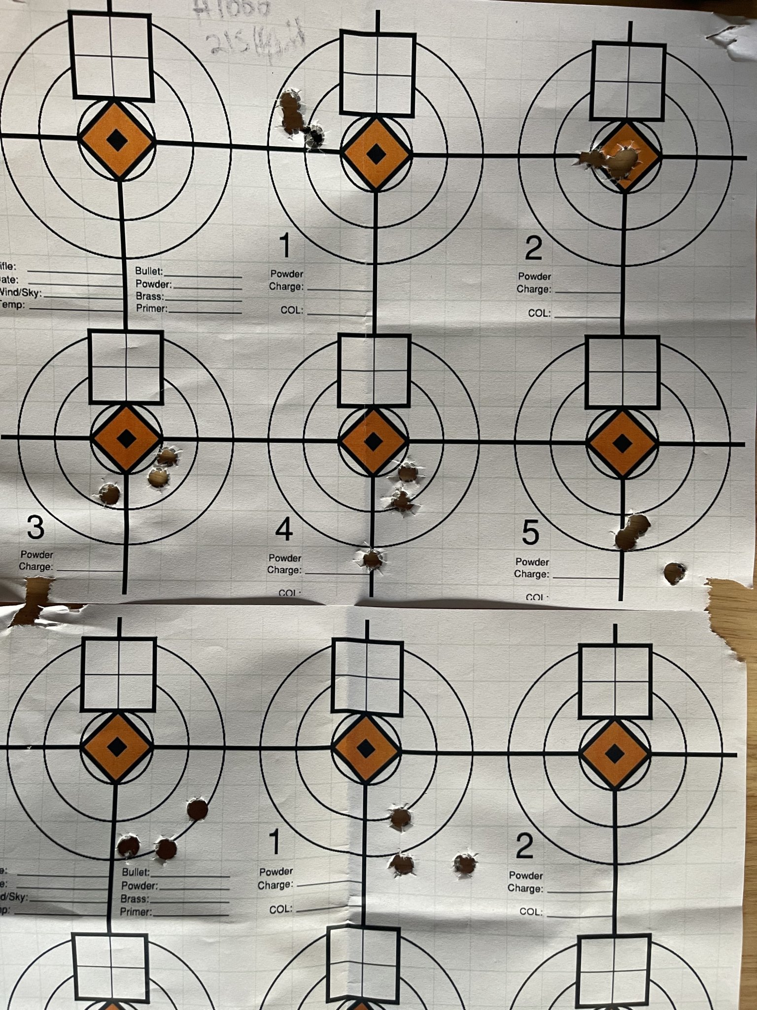

Try H1000. Ive jumped those thing’s anywhere from .030-.080 with good results in 300N w/H1000. Can’t speak to N570, never tried it.

This was my first test. POI all over the place.
Notes:
- I've never tried the 215s in my PRC, but have played a little with 220s - use 230s as my go-to. Unfortunately, 230s (the non OTM Tactical variety) are impossible to come by. I'm on my last ~200 and will be switching to the OTMs when out. I don't think that changing the bullet should be your first step - probably your last...
- I jump my 230s at .039. The Berger hybrids are very tolerant of jump changes, but you might want to try playing with seating depth first. I take my arbor press to the range with a bunch of rounds loaded long, then size down as I go, find a promising depth, finally run the rest through to validate (or not). The only hybrids I've run at > .040 are 155 Full Bores for my new 308, and only because of mag length issues. Every other Berger hybrid I've used (200.20, 205, 220, 230, 245, 105, 109) have performed better at lower depths.
- I think N570 is too slow, especially for the 215s. I haven't played with it in my PRC, but have messed around with similar slower speed powders like RL33 and it did not yield good results. H1000 is a better bet, RL 26 better yet (if you can find it). As @rustyinbend said, Retumbo can work, but sometimes it turns into unobtainium like RL26 is now (not just now, actually). H1000 tends to be more available across a longer period of time.
- Carbon barrels can get wonky :) A couple years ago, a now-friend of mine had a light weight 300 PRC hunting rifle made with a carbon barrel. He couldn't get it to shoot (remotely close to shoot, actually) with factory ammo - like 2-3" groups at 100. I met him because we both used the same smith, and said smith contacted me because of my experience loading for the PRC. Before I could help, my now-friend said he couldn't believe that tuning a load could bring it in that much, and asked the smith to rebarrel with a different manufacturer's barrel. The newly minted barrel/rifle came in and it shot perfectly... badly... again... same result. So, now we went through the exercise of load development, and at least we were able to (with minimal effort) bring the groups down to sub-moa. He subsequently got into reloading, worked more on the load, and is only now happy with the results. Long way of saying he's shooting Berger 205s at .040, ~2930 fps.
Lots of words - TLDR:
- Move to H1000 first. EDIT: was typing when you wrote that you scored some Retumbo - play with that.
- Play with seating depth second
- If you have changed powder, found a good node, and run a full depth test starting at like .015 off and moving up to ~.050, only then think about changing bullets (unless you want to for other reasons). There is no reason the 215s should be a problem.
This is great info thanks. New to reloading but getting good results with everything but this rifle. Frustrating. I'll change powders and see if they tighten up.

Test 1 prone w/ rear bag. Test 2 & 3 from bench with bipod and rear bag. I am a novice to intermediate shooter. Open to any and all suggestions.
Shoot everything prone and if possible video yourself from the rear and sides. Chances are you will spot things that aren’t obvious while on the gun…Have another experienced magnum shooter with you if you can. Also dry fire, achiving natural point of aim and watch the crosshairs closely as you break the shot. If you see movement off target, diagnose the cause and fix.
Im guessing this is your first magnum but you can confirm/deny.
Thanks. Yes, this is my first magnum.
YW…Focus on recoil mgmt…magnums will expose even the smallest fundimentals execution issues especially recoil mgt is often challenging to new magnum shooters until they get used to it (was for me w/the win mag at first)…im leaning towards that being your problem not so much the ammo you’re making.
Try those above things out and let us know how things go.
I will do this, thank you. I did forget to mention one thing that could potentially be an issue. My bipod (CYKE) was very loose where the rifle can rotate (the direction to level crosshairs). That's the only other variable I can think of.
I don't know. I've heard good things with n570 and 300prc's. I don't recall what bullet or other load factors were involved, but I'd believe the 215 was in some of them. To me that poi shift and spread looks like it could be something wrong with your gun. Have you checked things like your scope isn't malfunctioning, rings are good, stock is floated, bedding is solid, etc...?
Factory ammo is at least semi-grouping, so I would discount the issue being shooter newness vs. magnums, rifle issues, scope issues, etc.

Maybe N570 just isn’t accurate in your application?
This is what I'm starting to believe. the more I've read the last 24 hours, it seems that N570 excels with heavier projectiles and slightly longer barrels. I'm running a 24" carbon proof so I'm gonna adjust powders to H1000 and hope to get better results. I'm very new to reloading so it's good to struggle a bit so I can experiment and hopefully learn a lot from this rifle. A bit frustrating though considering my first test loads for my 6.5cm gas gun are shooting 1/2" with the 130 Bergers and H4350 with less superior brass (SIG).

I’m in the process of loading for 300 PRC also. Got to shoot some today and 79.4 gr of H1000 with a 215 0.050” off at 3.683” shot 5 into .325” and 4 into 0.200”.
If you can’t get 215 to shoot the 205 elite hunter shot under 1/2” across 6 gr of powder.
This is all in a proof prefit. Shoots 212 eldx hood also.
Reactions: Rh0dz

24” barrel. About 2810 with 215 and 2835 with 212 ELDX.
I also took 220 LRHTs to 2845 with 80.8 gr H1000. My barrel only has about 60 rounds on it so just getting an idea of what works and where pressure is. Haven’t found pressure yet.

H1000 was the ticket for me with the 215s. Only 2850 fps but 1/2" is nice. Opened up as velocity picked up at .010 OL. Undecided on if I should roll with lesser speed or play with seating depth on higher velocities as the ES was attractive. Obviously tiny data set but feel much better with H1000 over N570 with the 215s.
**Chrono died for last charge
Edit: adjusted zero after first group, so that POI isn't accurate.
