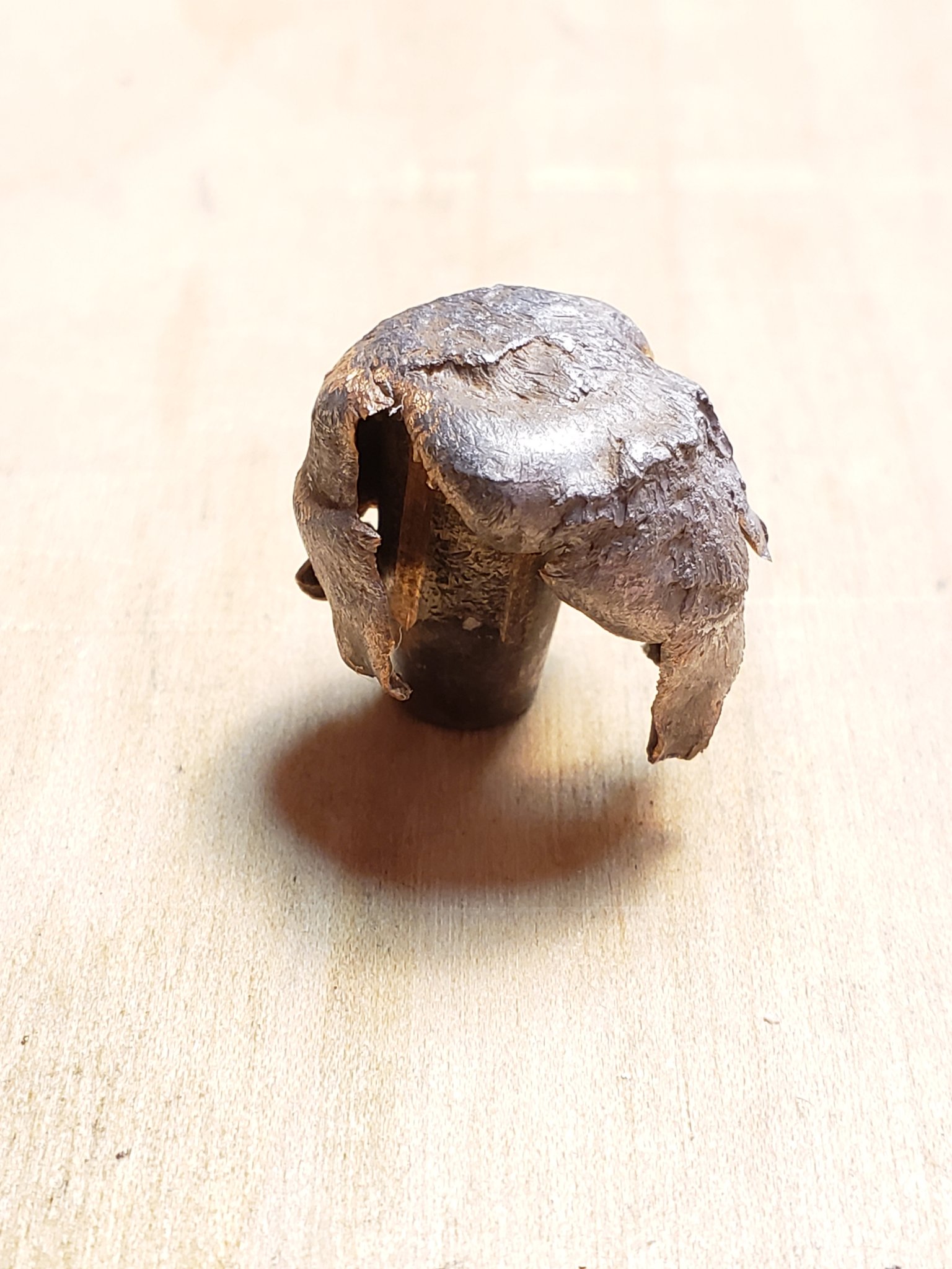

I shot a NM bull a few weeks back with my 300 PRC. 7828SSC under a 200 gr Federal TLR @ 2970 FPS.

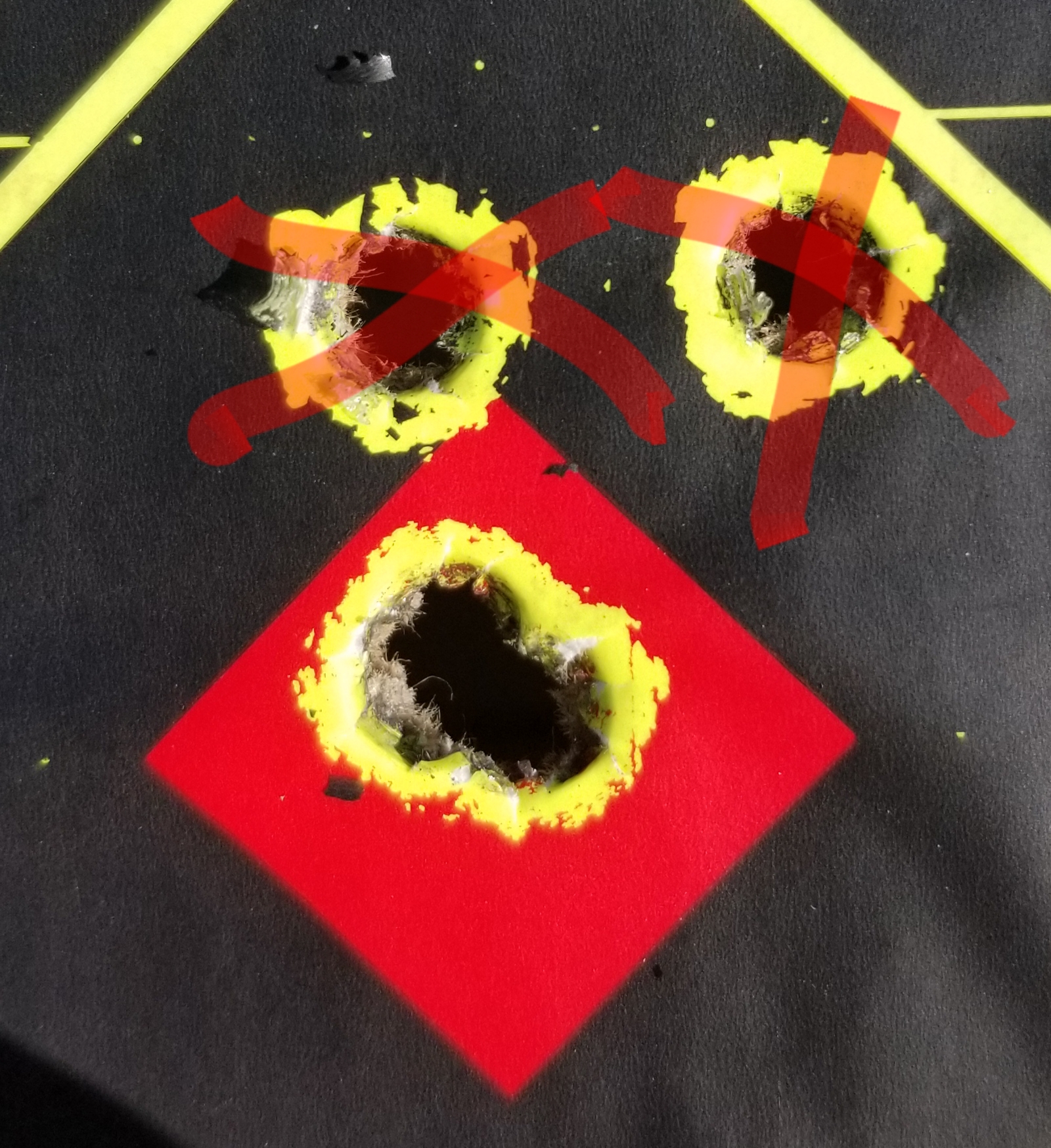

Short action Nucleus in Accurate 300WSM mags. 180 vld.
I have friends that run it in SA Origin, TL3, Nucleus and I think a Defiance. Pretty sure all have Proof CF barrels.
It is universally easy to load for. RL 26 is like magic. I ran it with H1000 and others have run it with VV and IMR powders. Still easy to load for and shoot small groups.
I have run the numbers, the 180 vld is the sweet spot. A buddy tried 175s, 190, 195, etc. Can't really beat the 180 vld in ballistic performance for hunting.
If you want to run the 195s step up to the 7 Sherman Max and go long action.
I bought a reamer for my smith, am gonna send him a couple barrels. Gonna turn one for ELR target and a shorter barrel for backpack hunts.
I love my rifle and what it does. That's my zero confirmation for my hunt. The other two were my buddy shooting his rifle.
