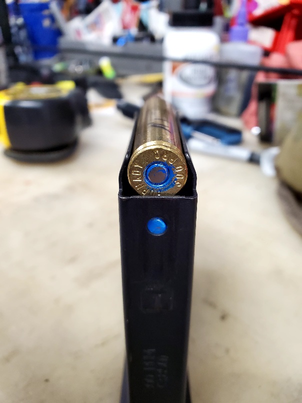

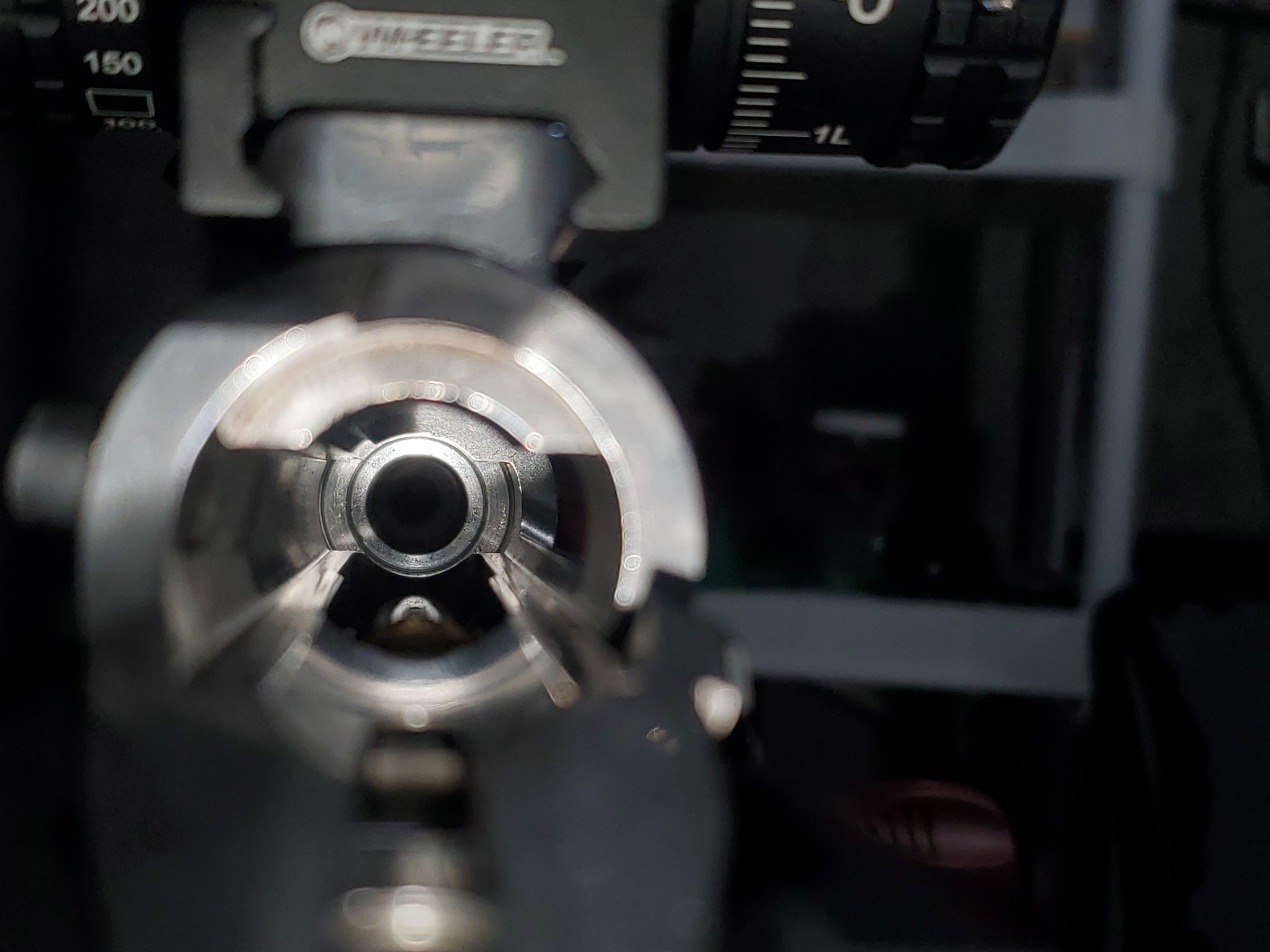

I have a 300wm mdt mag that was sold to me at 300prc mag. If I fill the mag with 5 rounds it'll work and load the first round but after that it doesn't strip them from the mag. I assume there is some modification that needs to be done to render this? Any information would be much appreciated!

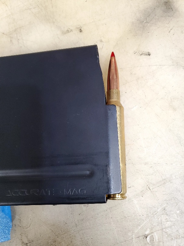

I'll grab that tomorrow as well I'm stuck at work for another 8. I did get this tho probably not much help since the mag is empty.

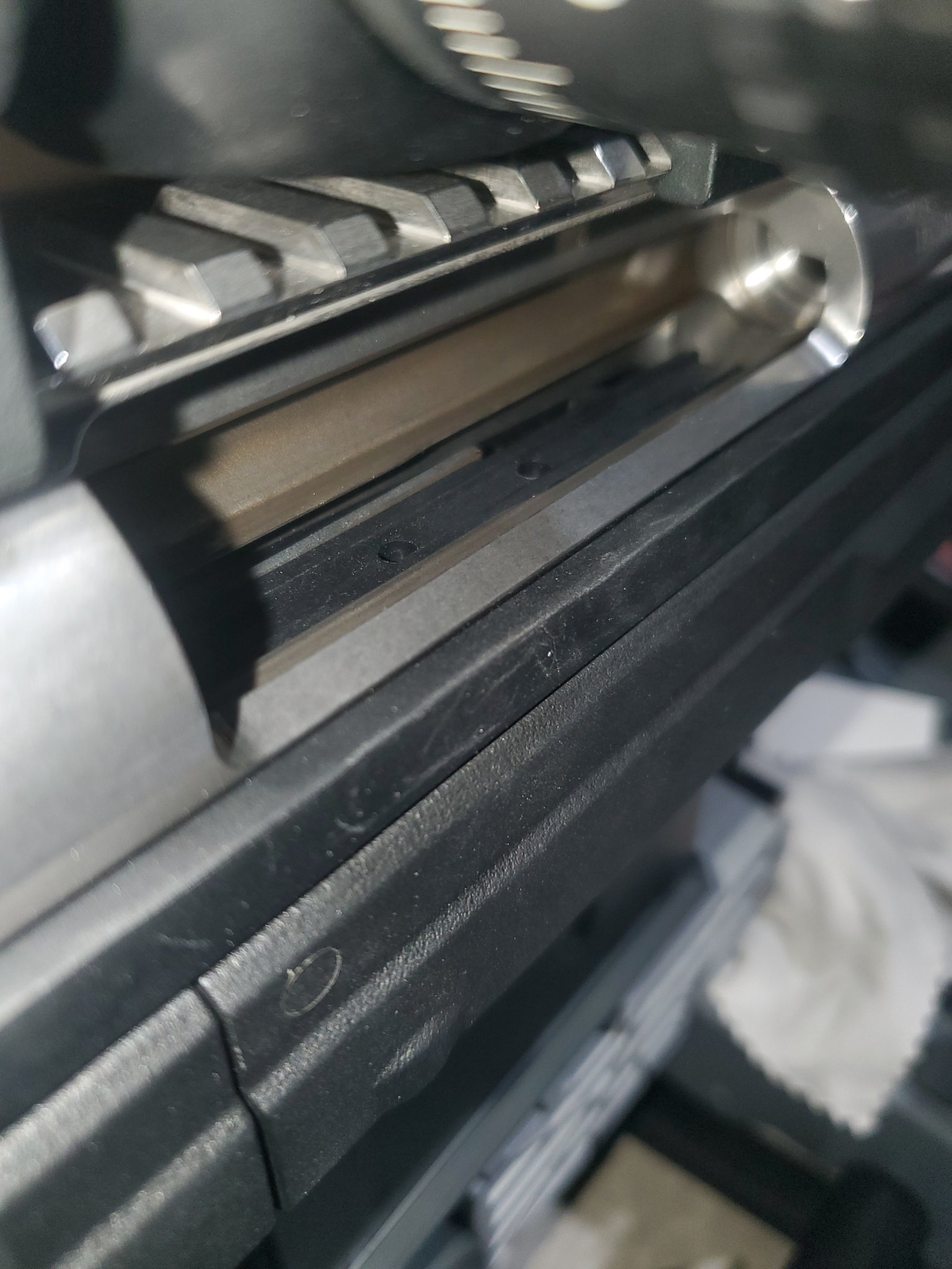

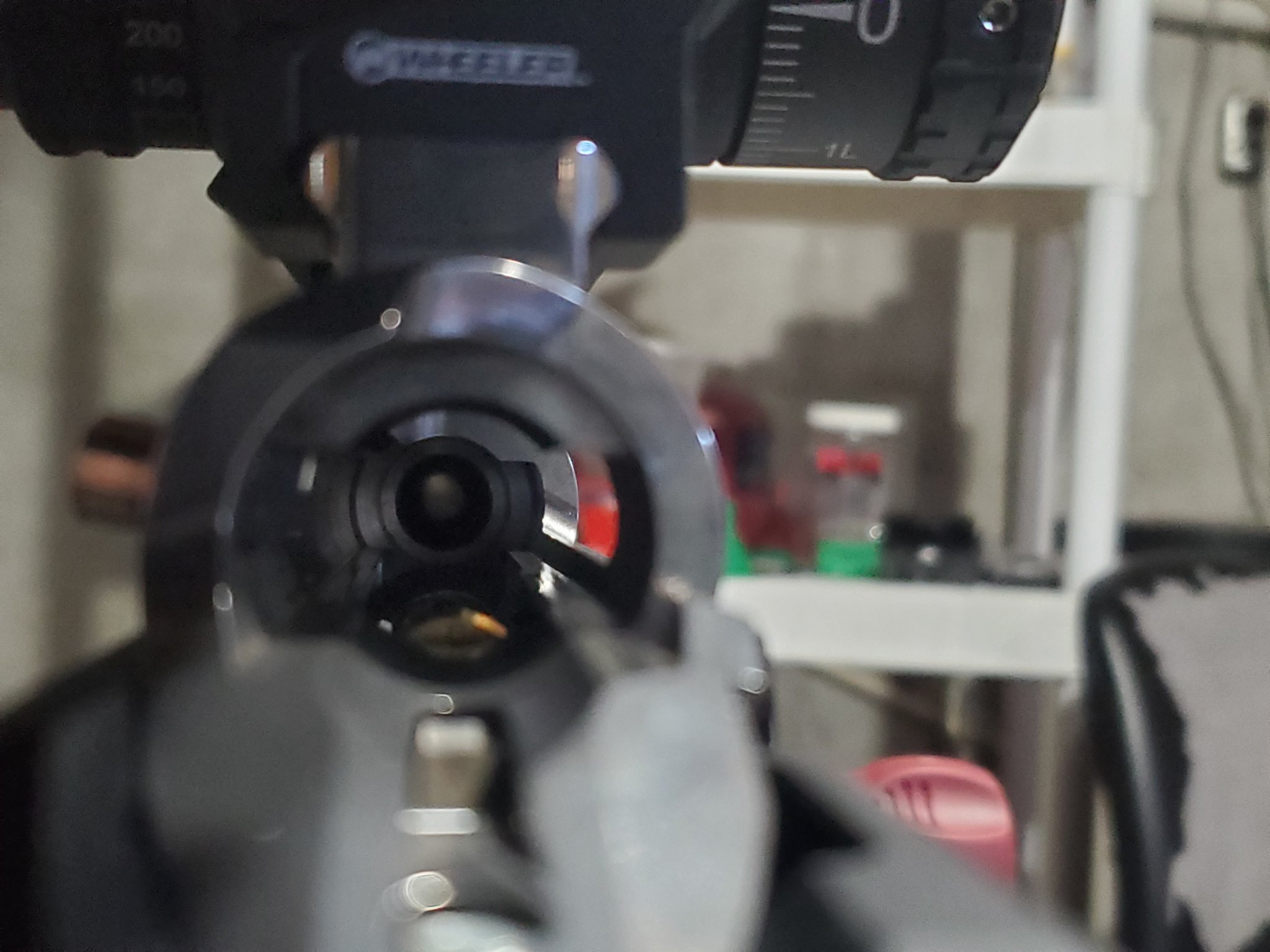

Best pics I could get from down the action. I haven't tried to tweak the mag depth on the chassis yet.
My guess on what's happening:
- First round is being pushed up a tiny amount higher because there's a tighter spring under 4 more rounds pushing it up.
- Subsequent rounds lose a little bit of push and are just slightly lower in the mag
I'm betting that opening up the mag lips to allow the case to sit a little higher will take care of the issue.
