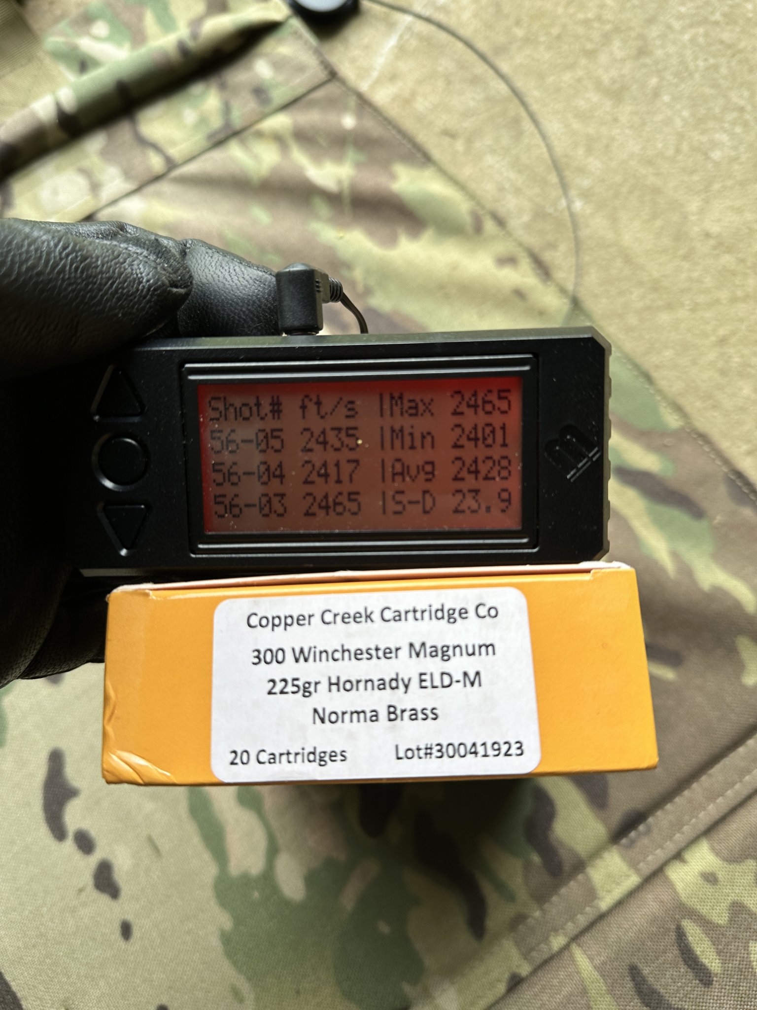

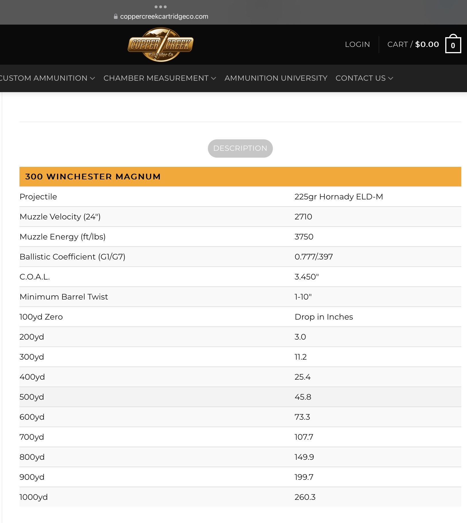

    So I decided I wasn’t gonna try to work up a 225 ELDM load on my own and looked to see what I could find on the Internet…
    I can honestly say the Dallas custom reloads we’re pretty darn good and what you would expect to see with a 300 win mag.
    The most confusing part of the day was when I went to chrono the Copper Creek ammunition… It was slower than most 308s. In fact, I’m pretty sure it’s slower than every 308 on the planet. I honestly can’t imagine why they would load 300 win mag that slow?
    And this is a 26 inch barrel were talking about on a TRG 42 A1….
    Granted, it’s a KRG BRUX 1:10 done up by short action customs (SAC)… as opposed to the original 1:11 barrel, but that is not gonna account for this:

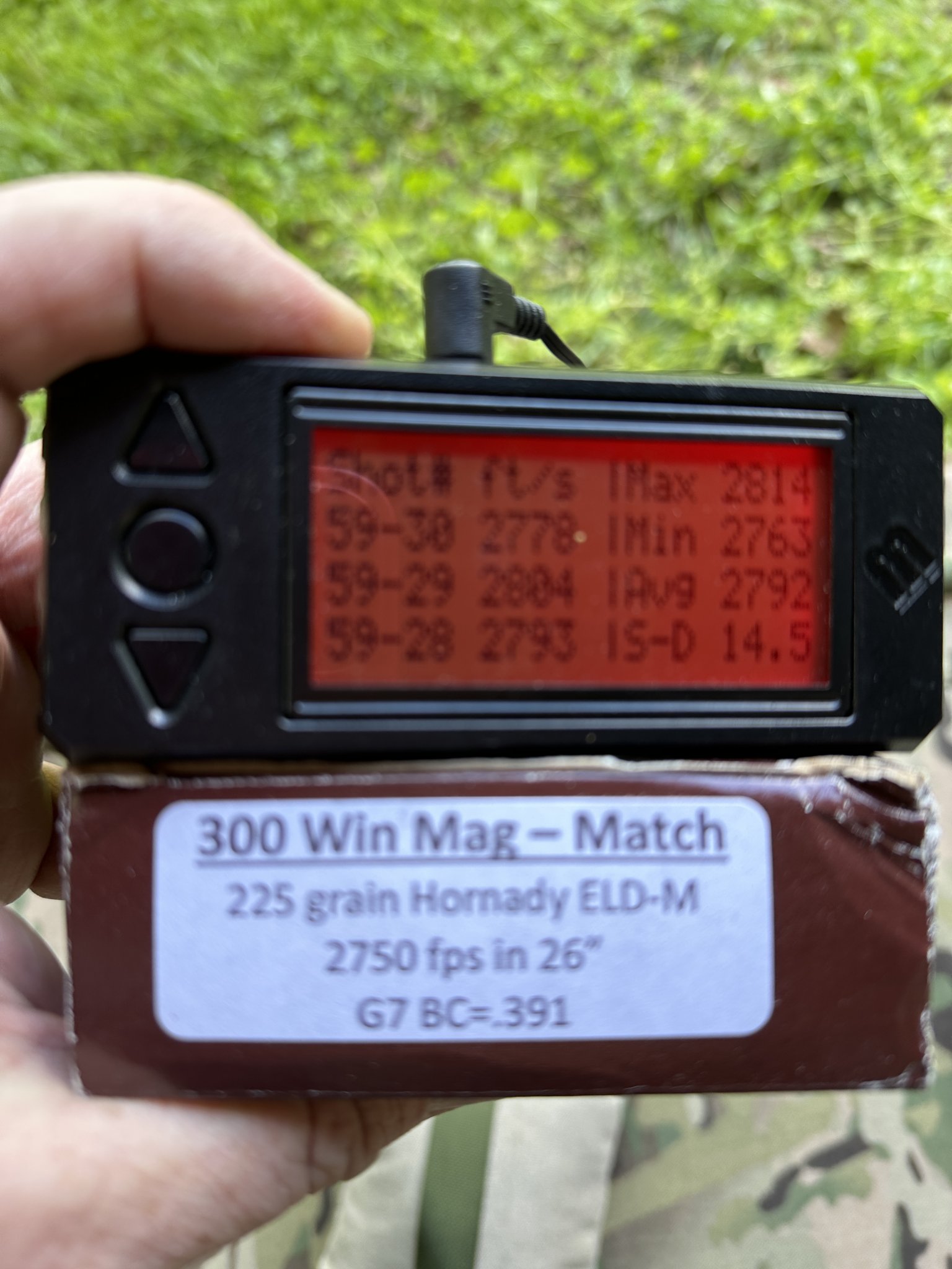

    VS
    The only thing I can say, for the Copper Creek rounds is… They shoot really easy.
    Bahahaahahaha
    I didn’t get the Internet memo that copper creek loads them unbelievably slow, but I guess now I know.
    Humph
    PS the reason there isn’t a larger string of shots with using the copper creek ammo. Is that why bother? I stopped the minute I realize they were at least 400 ft./s slower than they should be.
    Prolly got ruined riding next to the Bud Light in yer Tesla…..
    I would reach out to Copper Creek.
    He is a solid dude and that does seem quite slow.
    I wouldnt accept either one of those min/max numbers or SDs myself.
    Im poor and not cool but do make pretty darn good ammo.
    Any reason to not develop your own?
    Time primarily. Normally I would, especially given the costs savings. However, I simply figured I’d give it a try see if anybody had anything good that I could base my loads on.
    The one thing I did like about both brands is that they were using Norma brass.
    Well, interestingly… That ammo was absolutely made wrong…
    because there is no way that it’s supposed to be going that slow and that makes me wonder if they loaded it wrong or if they use the wrong powder…
    Makes more sense that they used too small a charge. Given the fact the weapon didn’t blow up in my face… But a small charge of the wrong powder would probably not blow that rifle up in my face..

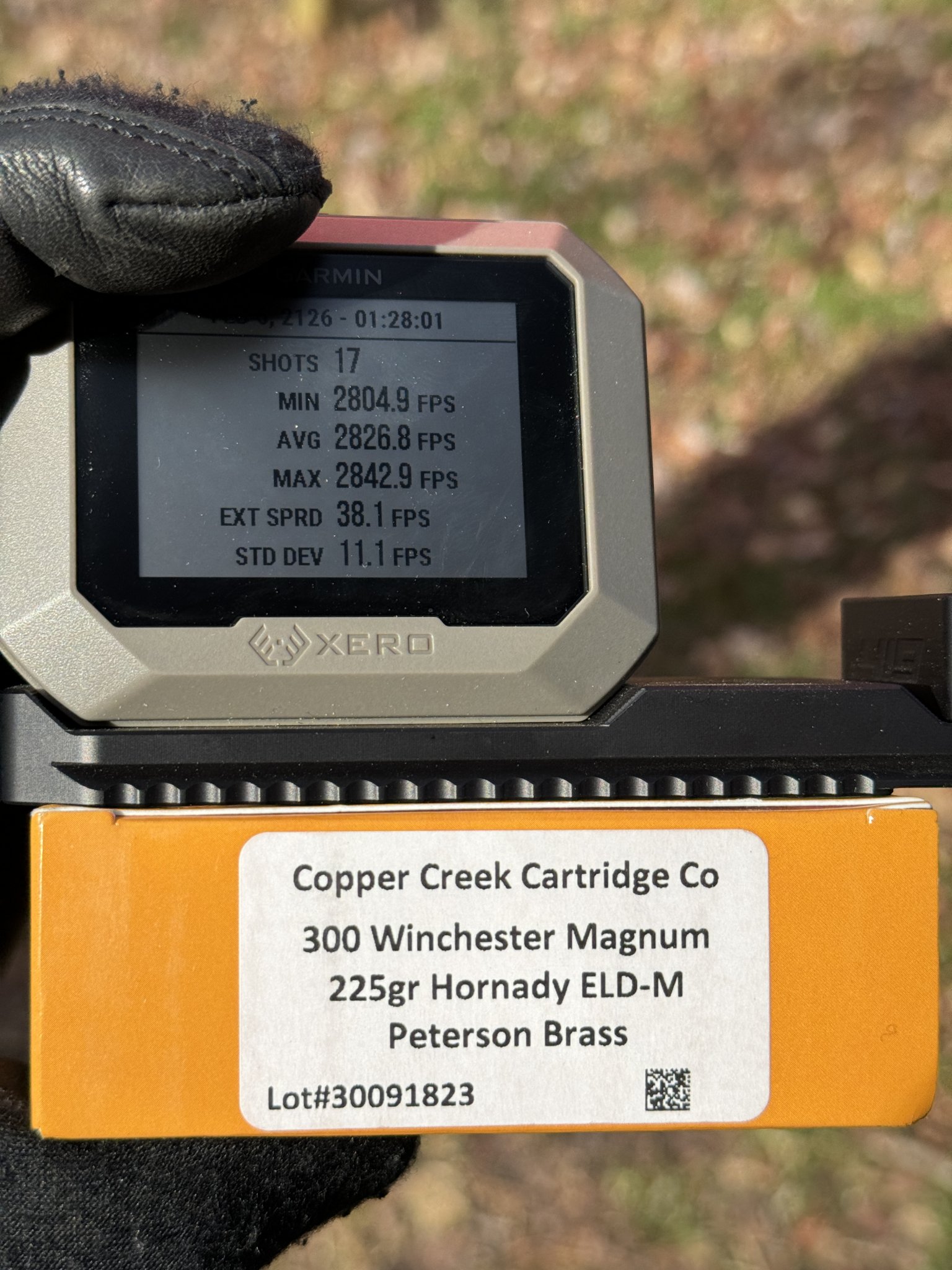

    Update to the whole Coppercreek, part of the saga:
    I was eventually contacted, and I returned the ammo (that was left).
    A complete and total turnaround with the replacement ammo.
    It’s Peterson brass and pretty much the same hole at 100 yards.
    …. and it’s 400 ft./s faster which is what a pretty much should be.
    Did they give you any indication of why this happened?
    Nope.
    What’s interesting to note is that at that velocity those bullets would stay supersonic past 2000 yards at sea level?
    With a 1:10 300WM 26” BBL w/ SAAMI chamber, that’s a hell of a round.
    It’s also a shit ton less expensive than copper solids….

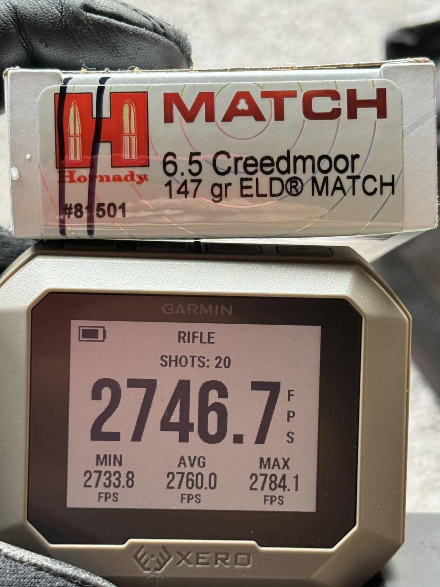

    I'd rather shoot my 338 LM. Much different recoil pulse and faster

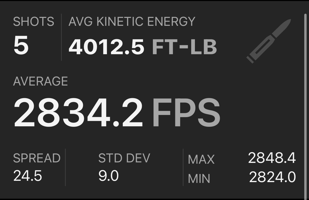

    Wonder what powder he is running as that’s pretty much what I’m getting with 74.7gr H1000 in my 26” Proof Barrel in Hornady Brass.

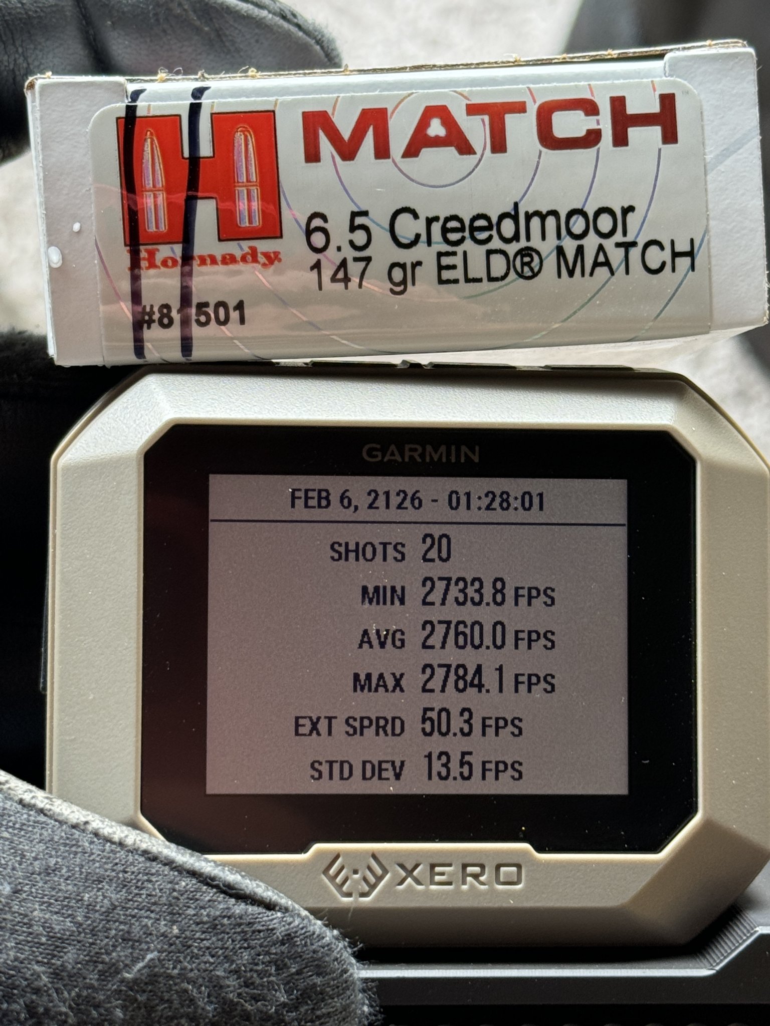

    CC 6.5 creedmoor ammo was 200 fps slow for me compared to my own hand loads. It was very consistent though. I pulled them, ditched the powder, and reused the components with my normal charge.
