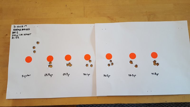

I shot this today and would like to know what way do you guy's think I should go. I'm thinking load a couple rounds on either side of the 69.7gr but what do you think of the 70.9gr group? I think I may have pulled that last shot. The two previous shots were one hole almost. I don't know enough about OCW to say one way or another if I might have a node at 70.9 and 69.7. Whats some other opinions? should I shoot the 70.9 again?
The specs are: 300WM with new Norma Brass, Berger 210gr LR-HPBT, Reloader 22, CCI BR2, CBTO .020" off the lands
I'd shoot the 70.9 again if you think you pulled. I've been doing 5 shot groups but I don't know if that's common practice. Were these shot at 100yds or 200? I've read where some folks say that the heavier bullets don't settle until 200yds. Not sure if there is any truth to that so hopefully someone here can expand on it. I'm new to 300wm.
I haven't been doing ocw all that long and not good at reading them... To me, it looks like you have a node around 69.5 and another starting around 71.3. If you're not seeing pressure, might want to see what 71.3 and up looks like.
