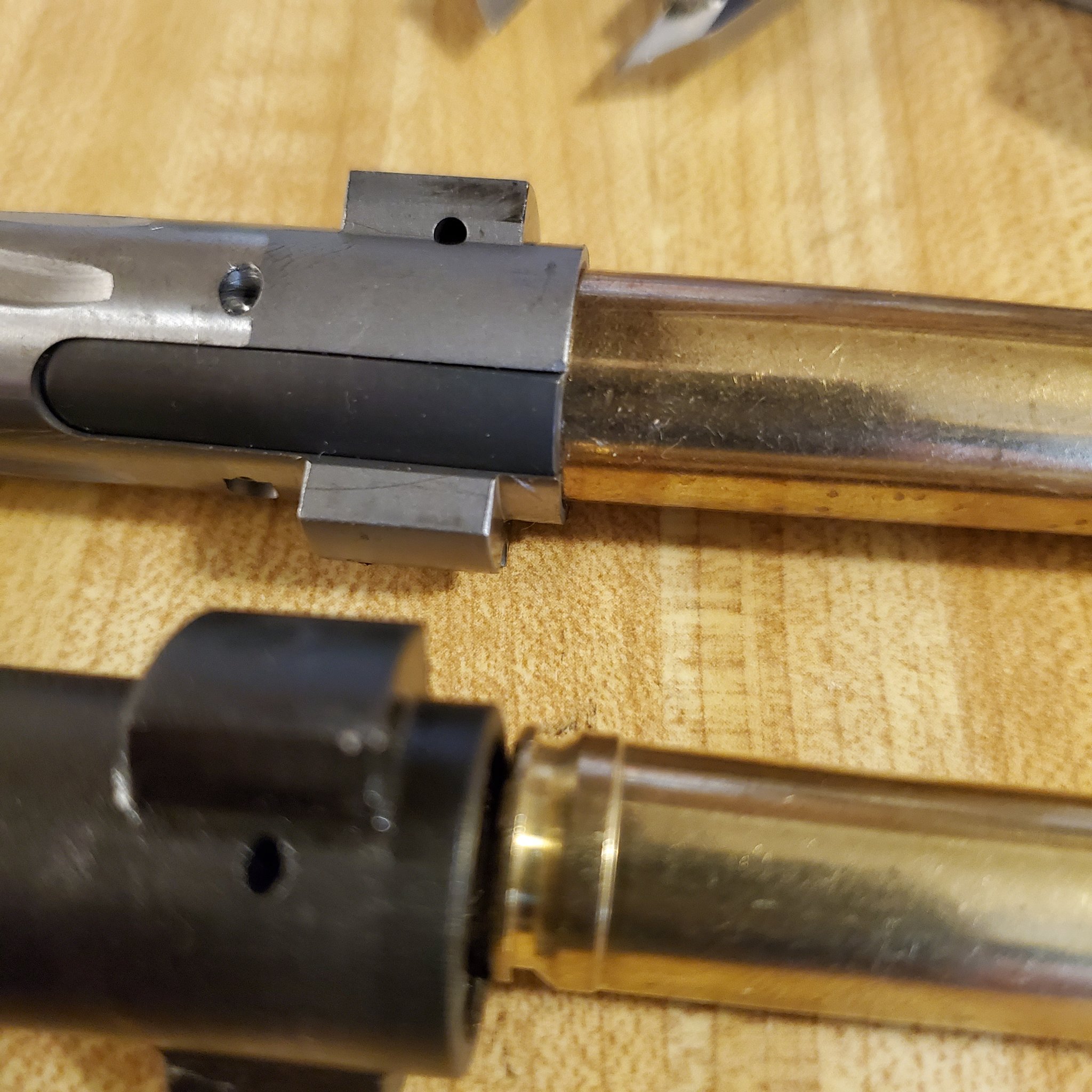

I used the same chassis for 300 WM & 338 Lapua. Just get the MDT 338 mag 3.715" OR the MDT300 WM 3.715"
Change bolts and barrels done...make it a switch barrel.
I run my 300 WM at 3.7" with match bullets, so 230grs can get to 2965 fps, or 200 SMK at 3150 fps in 26" barrel.
Some chassis will take the 3.85" MDT mags, so check those out if running long match bullets.
Flawless change out, or change back, 300 to 338...or in my case 510 whisper, based off the 338 Lapua.
Same reciever, different barrel, different bolt, different mag....cartridges the same length 3.715" mags.

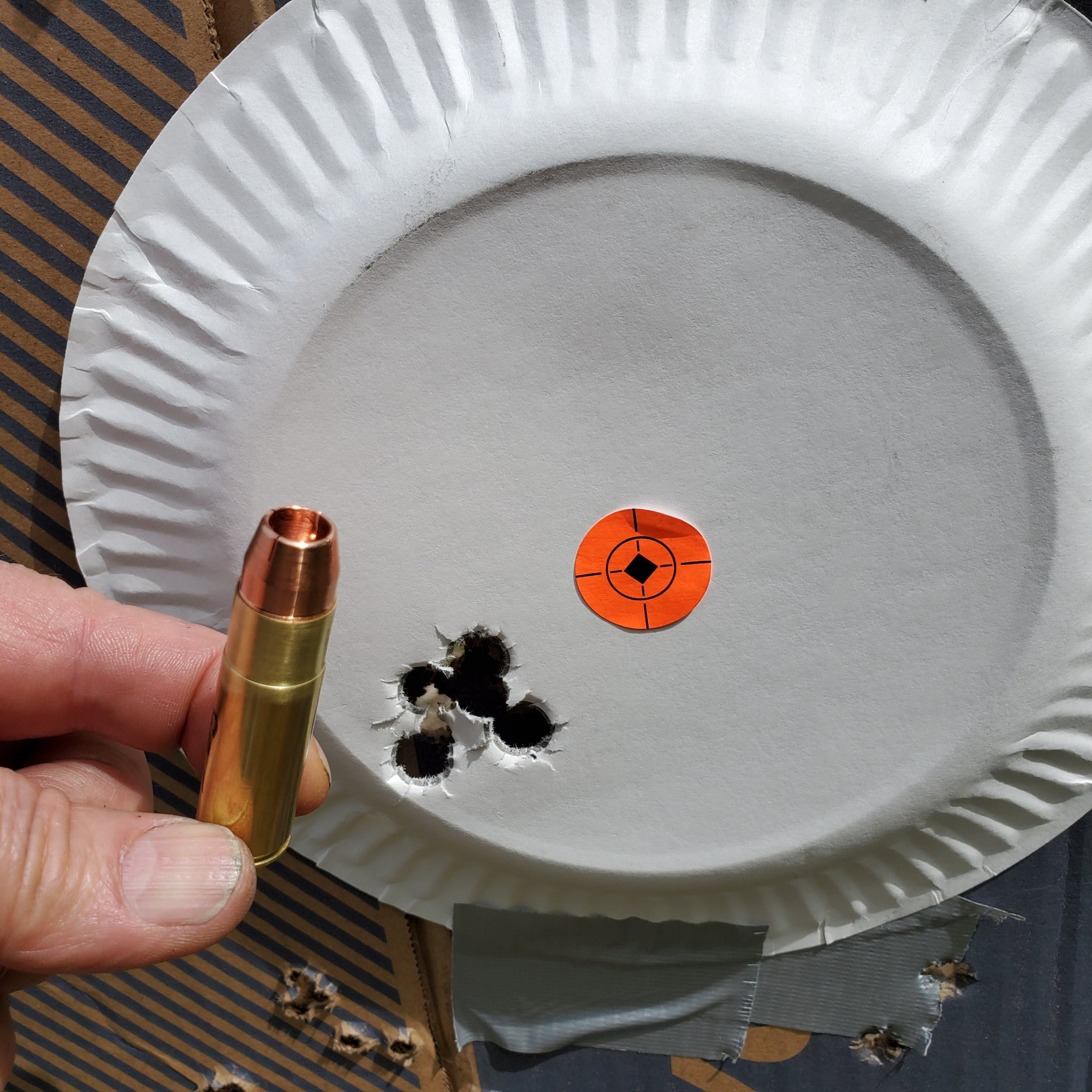

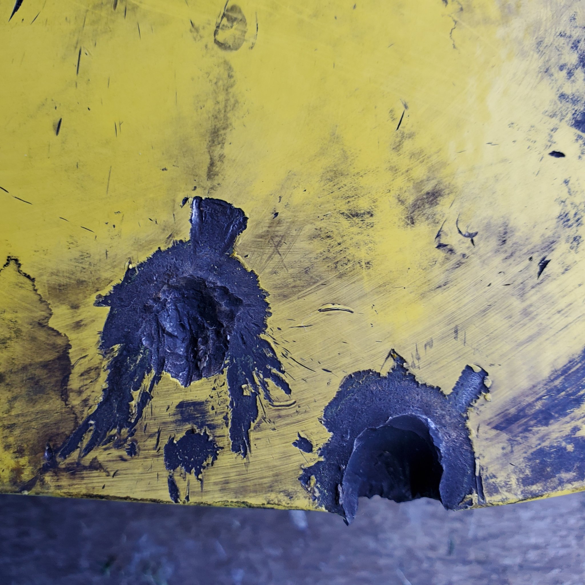

Some 510 Whisper pics.

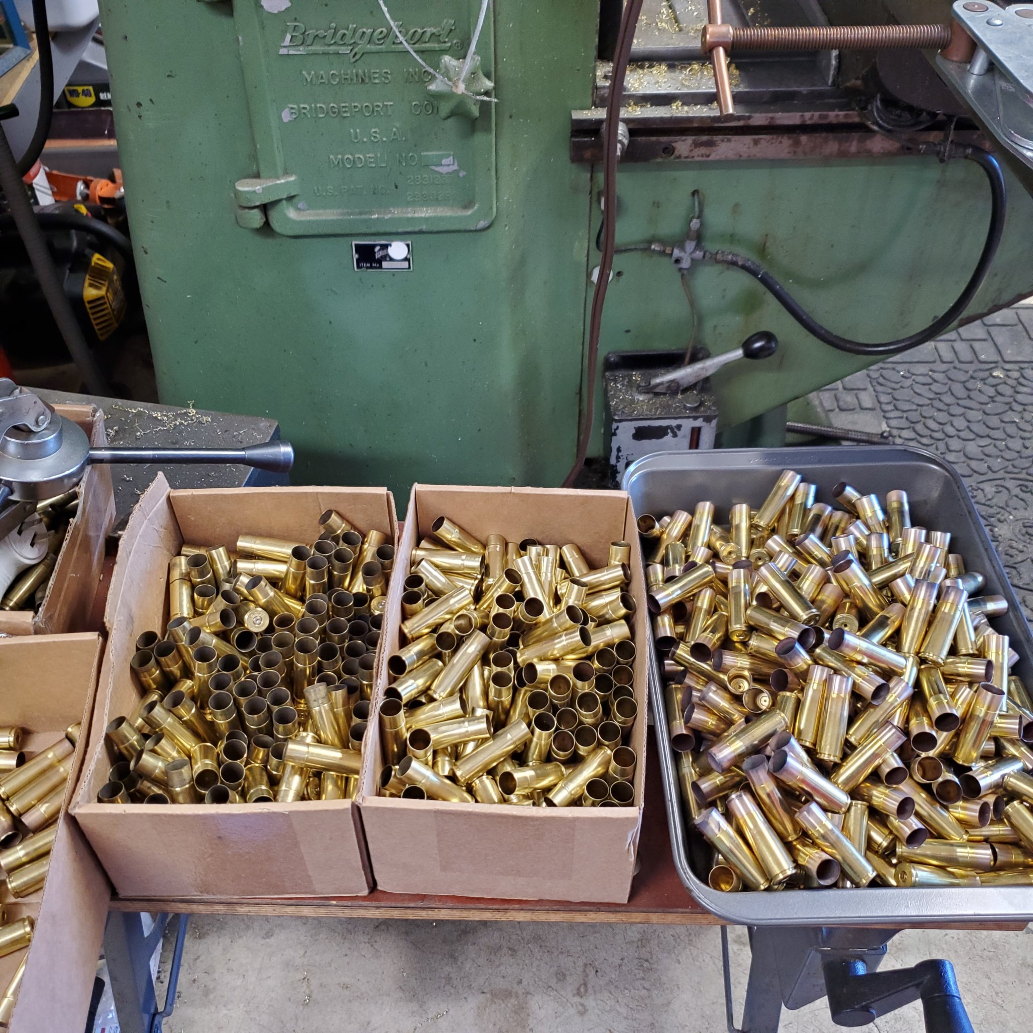

Just completed 700 cases.

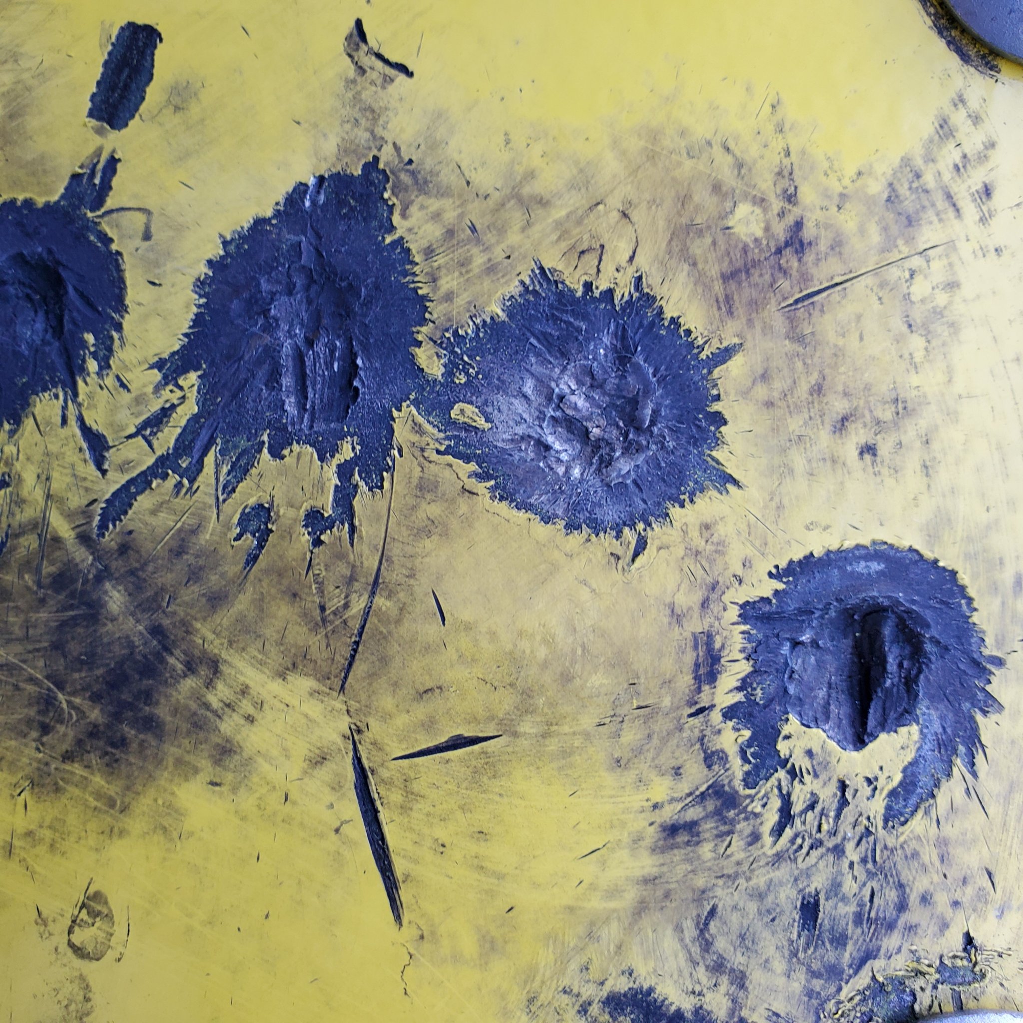

AR 500 taking a beating.
increase the velocity more penetration occurs at 100 yds.
Super 350 gr producing 4700 ft/lbs
750 Amax test loads.

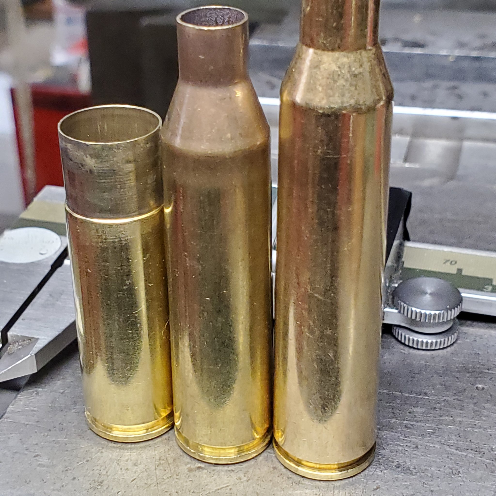

A couple of cases one can make .510 whisper out of...300 Norma mag 338 Lapua mag.
Anyone considering the .510 Whisper cartridge should build one...I have the 300 Blk, the 8.6 Blk, but they do not compare to tbe .510 Whisper, for down range energy.
With subs It only loses 180 fps from muzzle to 1000 yds and hits with 2000 ft/lbs at 1000 yds. With lathe turned 1002 gr bullets, wind drift and drop are doable...not like the other subs.
Get ya one...

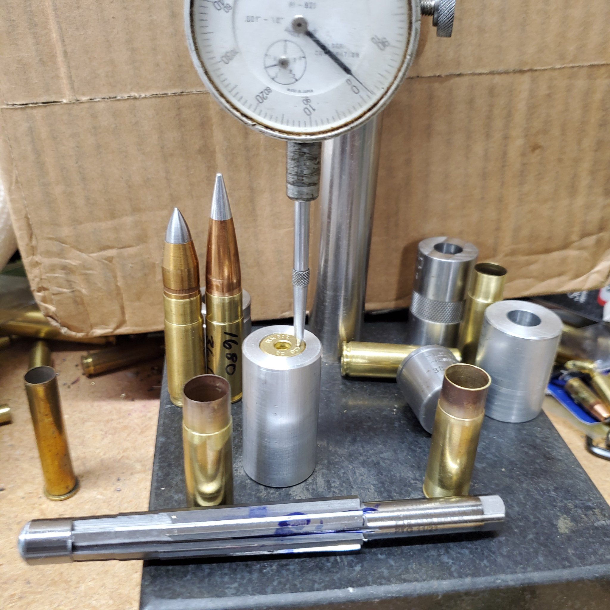

I ordered mine from PT&G and received it with in a week. Took longer for the 10 Twist .510 barrel special order a bit over 2 months, from McGowen, but I did order a 6.5 twist. 338 at the same time.
Here is the .510 Whisper reamer, used it to chamber the barrel, make a cartridge gauge, and headspace brass gauge.
You can have a 510 Whisper...fairy cheap if you can do the work, but any good gunsmith can chamber ya one.
