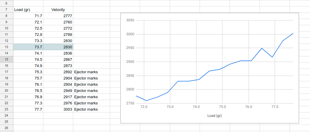

I'm loading H1000, Fed Magnum primers, Hornady ELD-M 208 -- not exact to yours but pretty close, should give you an idea of where you're at.
I run a 22" barrel.
I chose 73.7 as my node. It's not the highest velocity I could get out of it but I get sub .5 MOA accuracy and might help extend the life of my brass. Started seeing considerable ejector marks at 75.3 gr.
