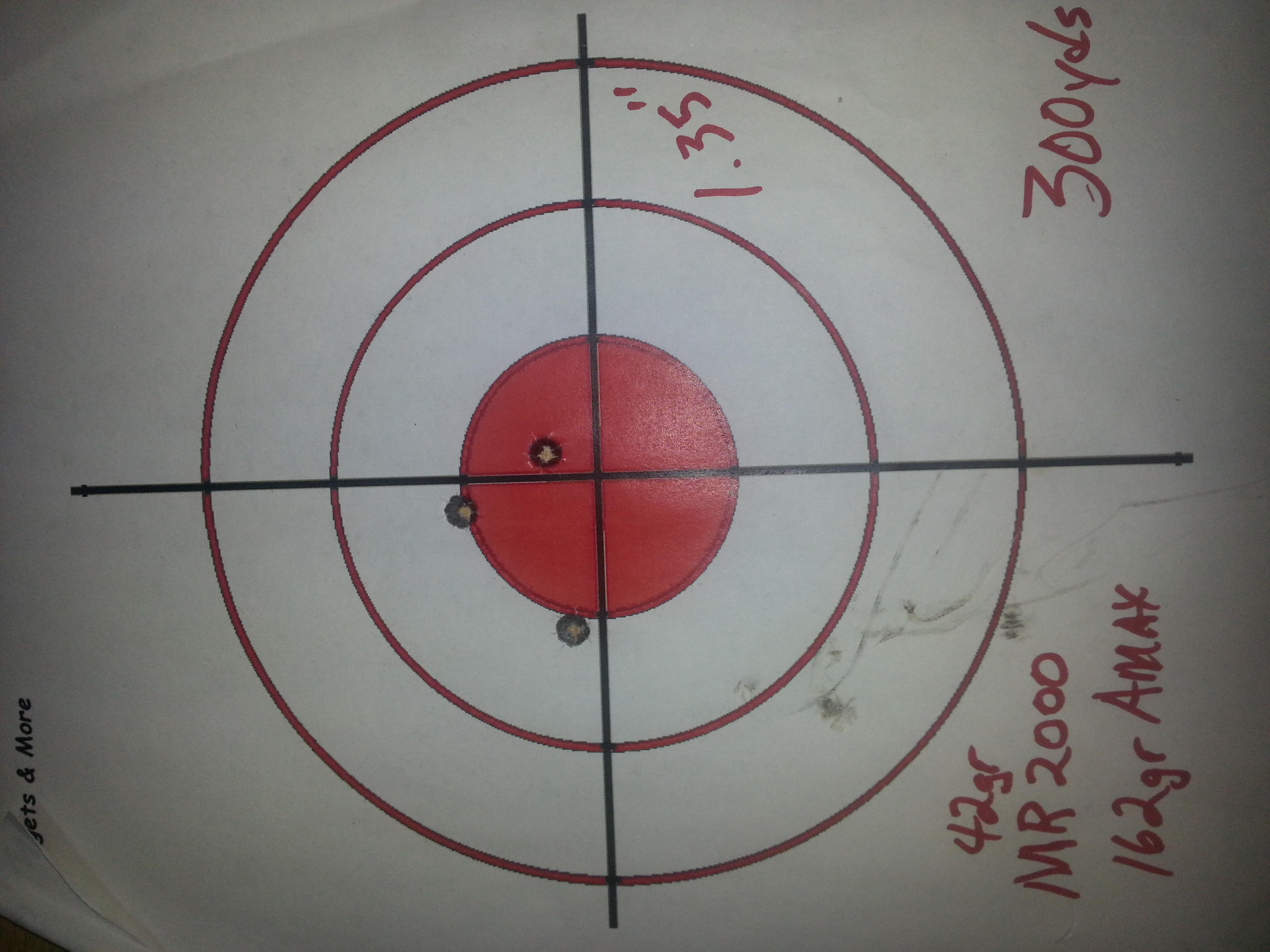

After many sessions of load development I shot this group the day. I am shooting my 7-08 with 24" Krieger barrel using 42gr of MR2000 under a 162gr Amax. Is this considered an average group or a good group for 300yd. I shot these off bench with a bipod. I'm just learning this long range game.
1.35 in. is not bad for 300. I predict you can close that group up with a little judicious critiquing of your platform and body positioning, npa, etc. Try more than 3 shots to arrive at a better average of what your barrel and load is capable of.
3 shots is a good starting point to narrow down loads, but its better like 40xs said to shot 5-10 shot groups to see the load and the rifles capabilities
That is a very good start to qualify your potential. As mentioned more shots tell the story. I was satisfied until I practiced to shoot my first Fclass match at 300yd, with three relays of 20 shots each; and I learned it is much more difficult to get good groups of 10-20 shots. Now instead of practicing with a number of 3-shot groups, I shoot a few 10-shot groups which develops you skills more quickly because it forces you to concentrate better and put together good habits as a consequence. It is easier to dismiss a bad 3-shot group and like the others, than it is to dismiss 1 bad shot out of a string of 10. At least that's how it has worked for me. Good luck and good shooting.
A little under .5 MOA would keep me happy. I understand stopping after 3 and calling it a day.
My problem is I show off and go for five rounds with the 5th shot blowing the whole thing up creating a two MOA result.
Edit - my assumption is 1.35" is the measurement of shot holes shown, you havent already divided by 3 for MOA. If you did already bring it down to MOA a little over 1.25 inch still makes you better than most shooters at my club.
Thanks for the responses guys. I will take your suggestions and build on that. I haven't even tried prone yet. I am hoping the load and bullet combination will hold up. My skill level at this point needs a lot of work. I was shooting with a SS 3-15x44 but I just changed to a Sightron 8-32 x 56. Hopefully that will help with more precise aiming.
