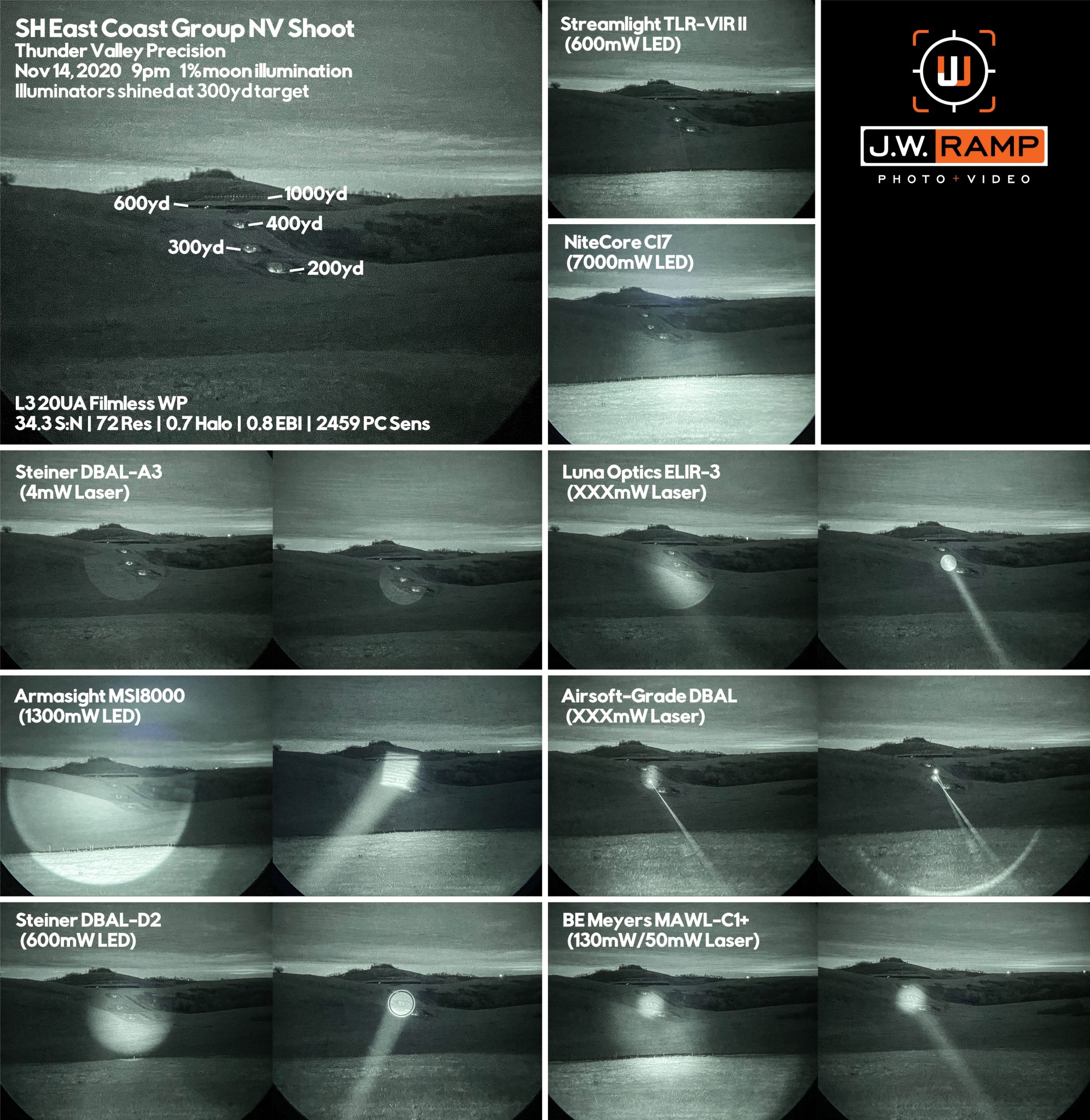

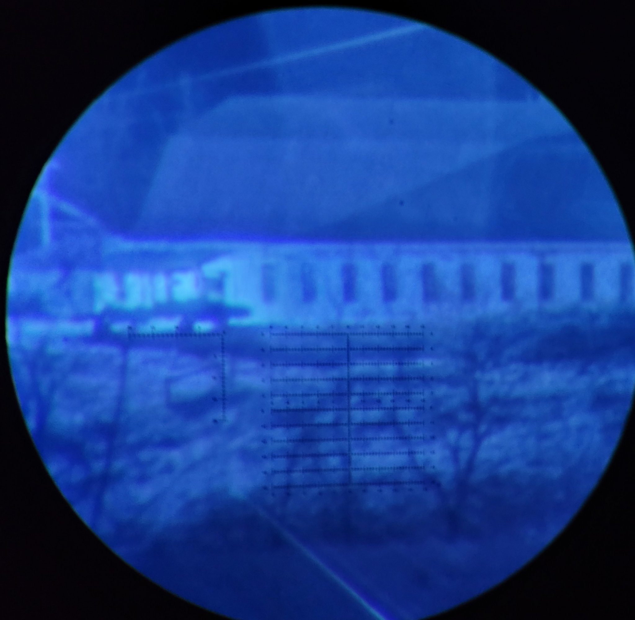

Thanks to everyone that came out for the night shoot last week - here's some shots we did while we had all the illuminators and clip-ons out on the line. Bob from @LibertyArms put together the nice testing racks and we used a Razor 4.5-27 that Vortex sent out to demo, along with a re-tubed clip-on from Jay at @Surgeon_Shooter that also had one of his SNB filters tossed on the backside. I did a similar exercise earlier this year, but just out to 50yd. You can see that with the comparisons of downrange signatures here.

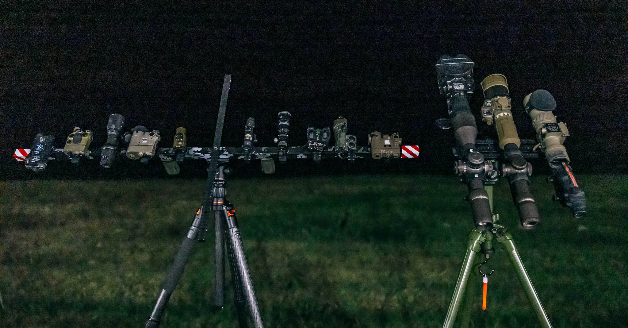

We started by running through all the illuminators on-hand (that made sense to light up at distance), and aimed them at the 300yd berm. Here's the units shown below:
Steiner DBAL-A3 (4mW Laser)
Armasight MSI8000 (1300mW LED)
Steiner DBAL-D2 (600mW LED)
Streamlight TLR-VIR II (600 mW LED)
NiteCore CI7 (7000mW LED 940nm)
Luna Optics ELIR-3 (Unknown output, Laser)
Airsoft DBAL (Unknown output, Laser)
BE Meyers MAWL-C1+ (130mW combined in Med, 50mW in Long, Laser)

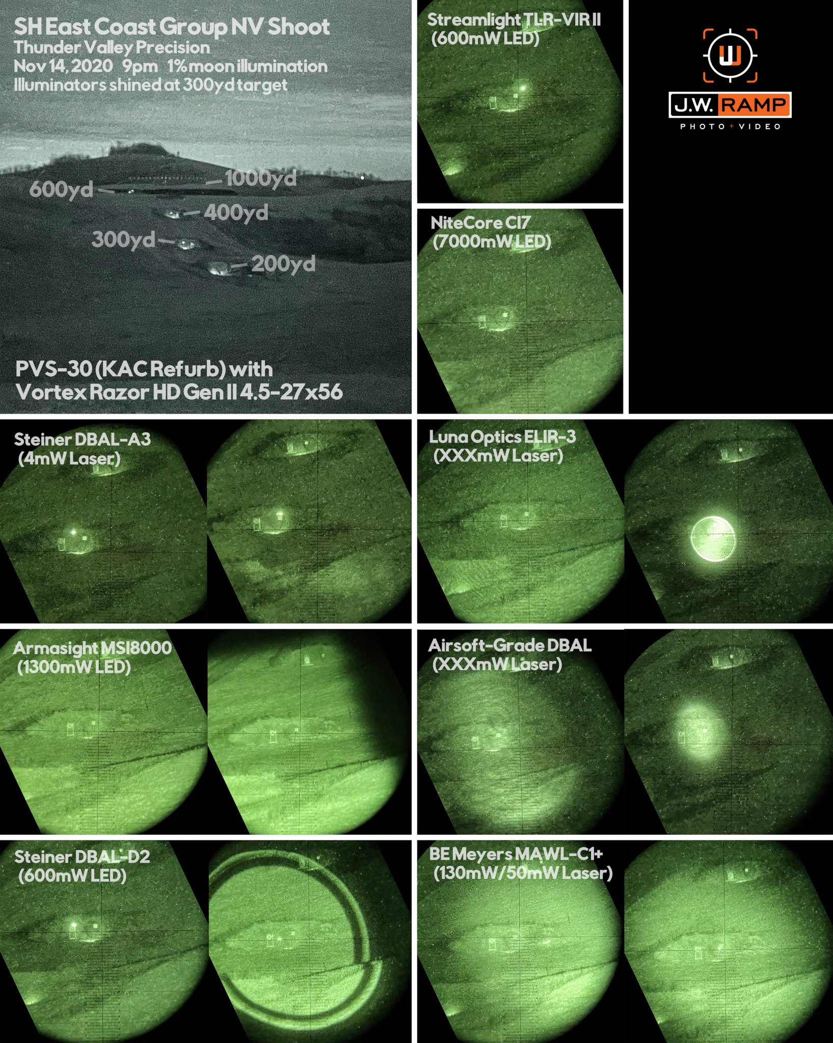

Next up we did the same illuminators in their wide and narrow beams through the refurb PVS-30 and 4.5-27 at 4.5x. Figured that was one of the most common clip-on units guys run into lately. For this one we also shined at 300yd.

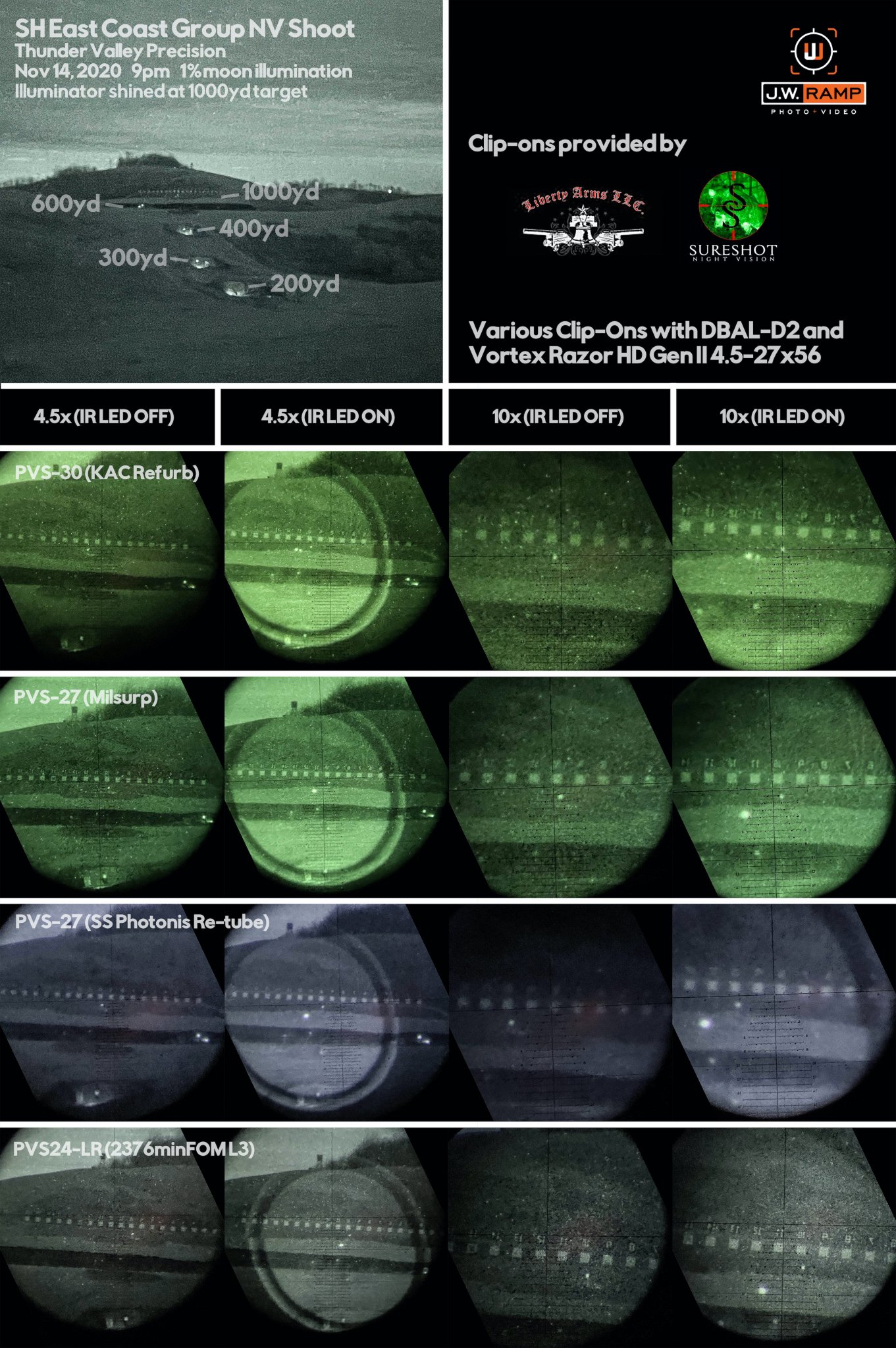

Lastly we stuck with the D2 and rotated through the clip-ons at 4.5x and 10x scope magnification out at the 1000yd target.
Figured most of the 'results' speak for themselves, but happy to chat below if anything was unclear. All shots were taken with iPhone 12Pro with 1x comparisons through a pod of my MOD-3s and the others with a PhoneSkope "Skoped Vision Rifle Scope Adapter" that kicks the image off to the side with a prism. Exposure was locked between shots on the clip-ons to maintain accurate brightness level comparisons.
EDIT - also cross-posted on my blog if for some reason you can't see the big images here - https://www.jwramp.com/news/long-range-nv-ir-illuminator-demo-clip-ons
Just a small correction. MIN FOM on L3 kit is 2376, not 2476 (looking at your labeled photo on the 24LR WP).
Funny, I thought the same thing when I copied that from the L3 page. Must have just been a little loopy after having a few 4am wrap-up nights this week and misread it. Gotta love the fall for staying busy with NV activities.

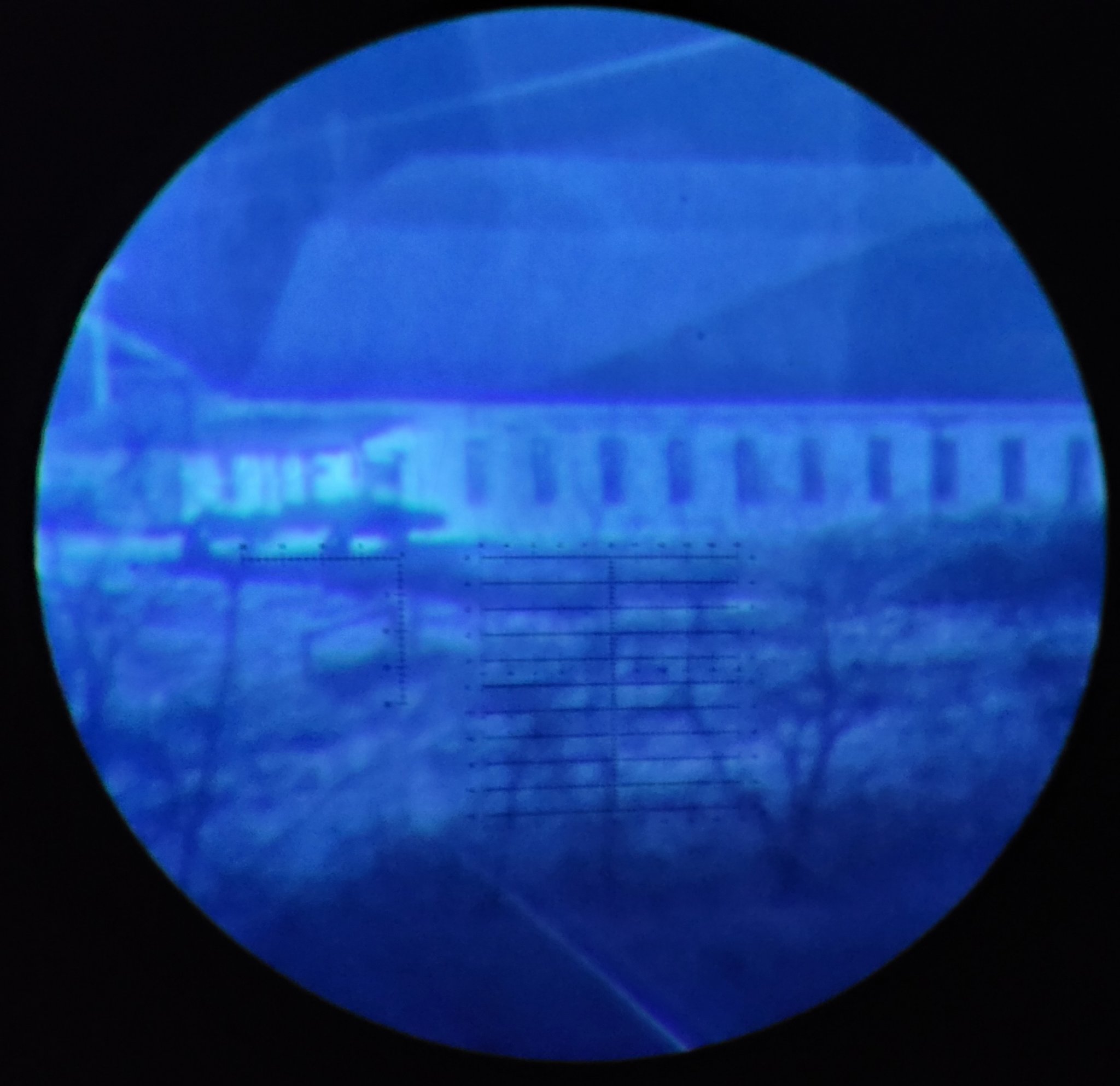

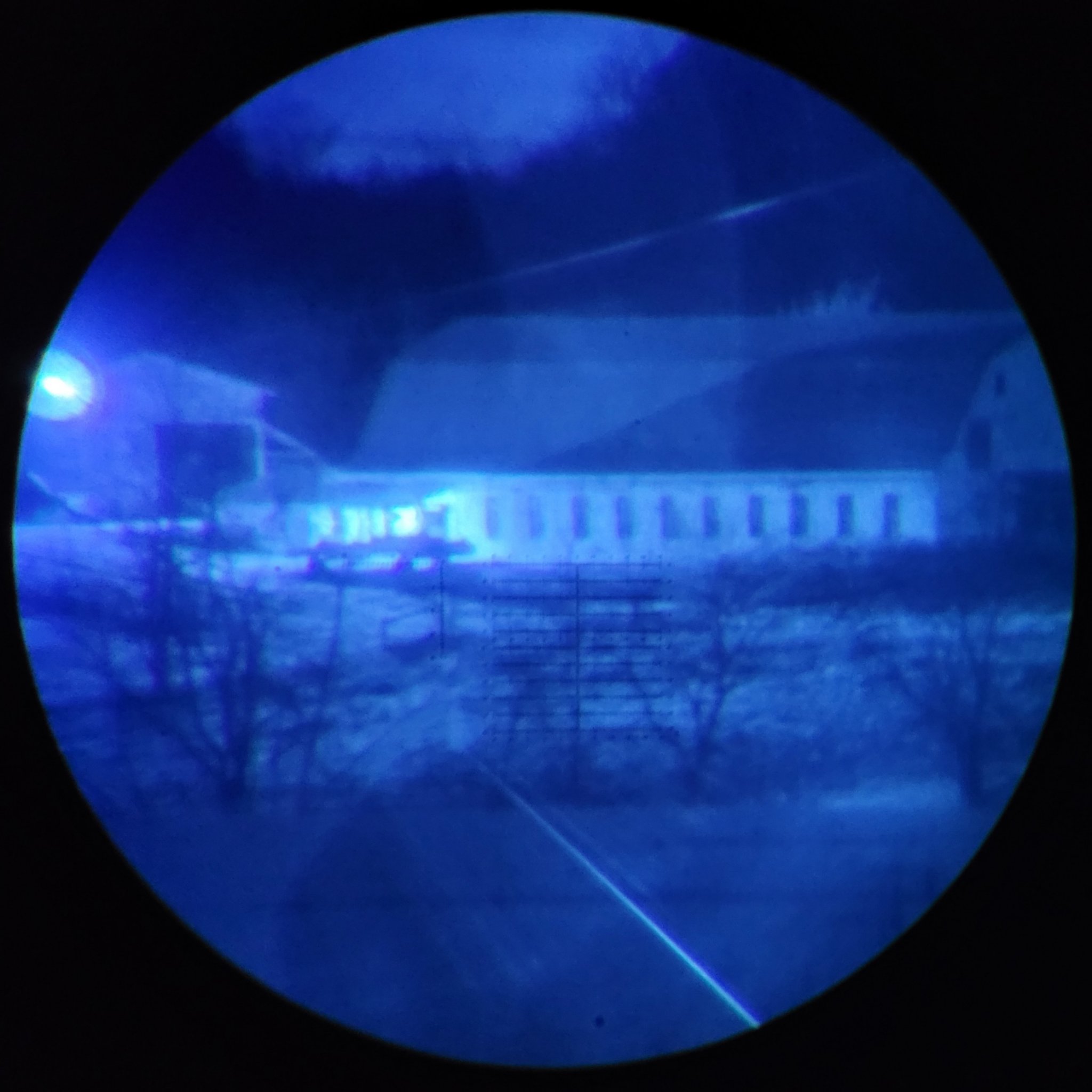

Hey- the last civ MAWL I acquired (propeller cap, good clicks) seems to have a more squarish illuminator on the long and medium settings.
Your photos seems to show a more circular pattern. I had a couple of the older gen civ MAWL lasers and I think I recall the pattern being more circular.
No big deal either way, I’ve seems some comments suggesting that the earlier versions weren’t round, just wondering what some of the guys that were at this event and/or have seen in person would describe illuminating pattern

Hey there,
Really appreciate this. Would it be possible for you to give a synopsis of what you think was the best overall performer, best wide beam, best focused beam, etc having seen the competition with your own eyes?
Just double checking, jay put the tube in the 27 yes? And all the pics are with the snb installed?
Yes. Jay put the tube in. Yes all of his 27 pics have filter on. Here's other i took with it. But the barn light was giving some glare.barn is 660 osh away its on another post
