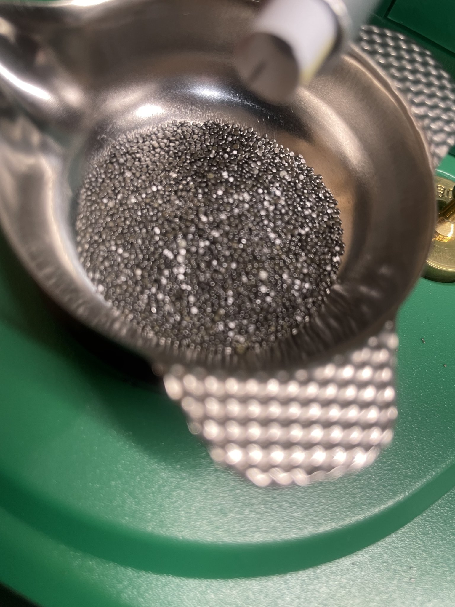

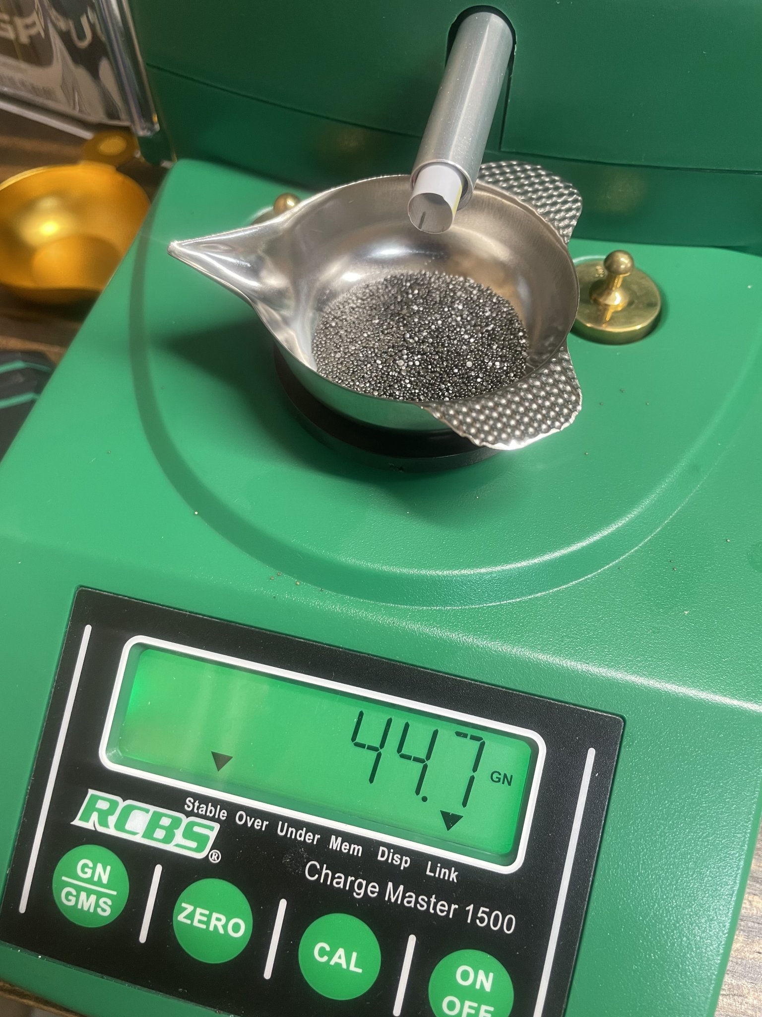

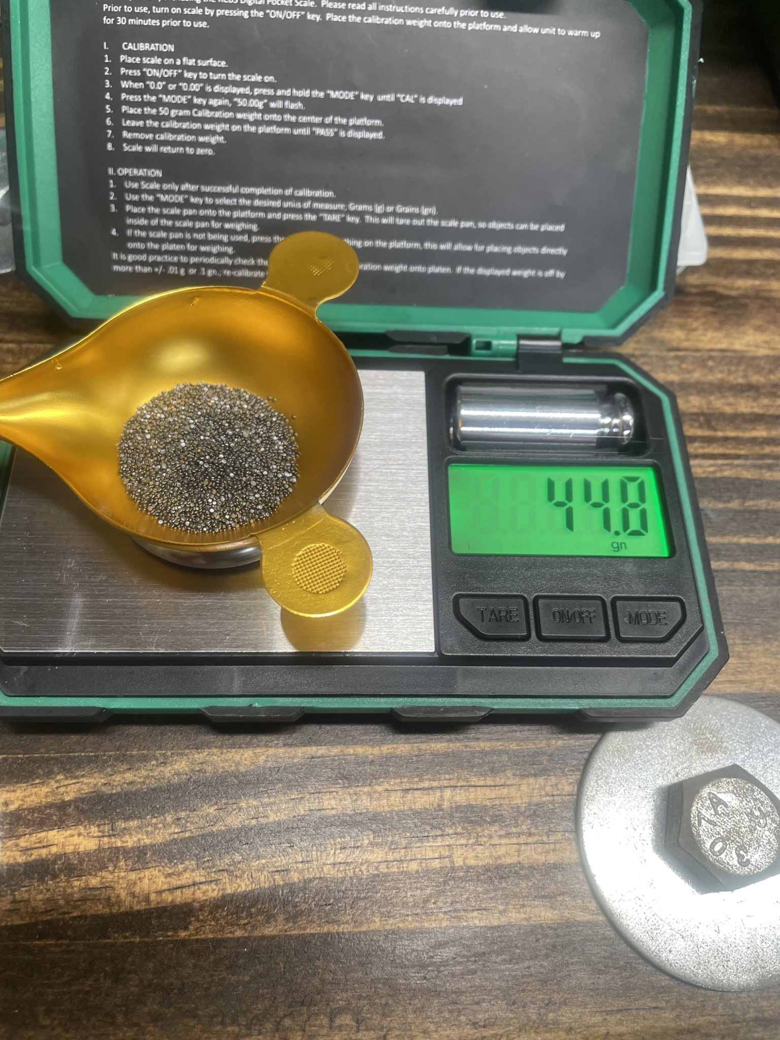

I just recently discovered I had an old box of .308 FGMM 185g Berger Juggernaut factory ammo. I pulled one down and discovered a charge weight of 44.7g on my RCBS Chargemaster 1500 and a charge weight of 44.8g on my RCBS pocket scale. (Same charge, no kernels lost, both scales calibrated) which leads me to believe it is a charge weighed to the hundredths. Maybe 44.75g?

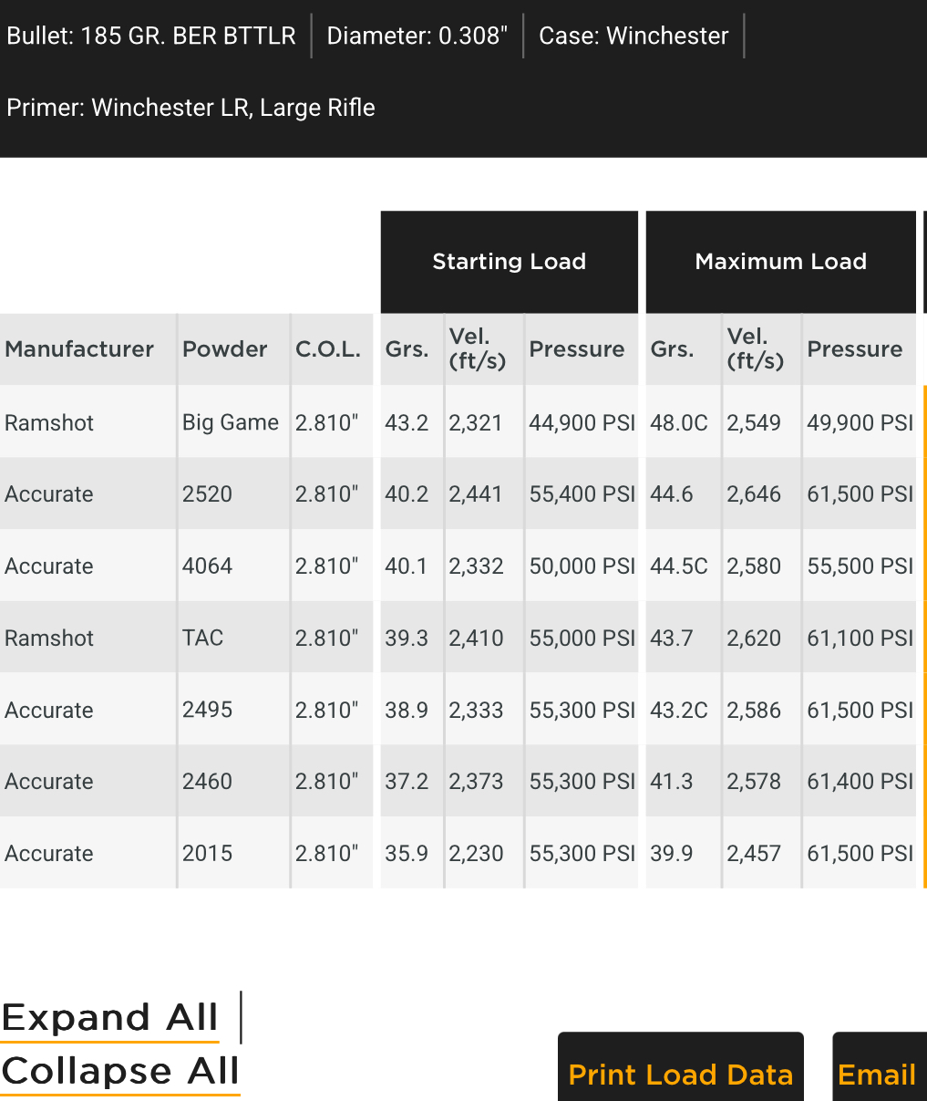

Reviewing hodgon load data, this appears to be a slightly above max load of Accurate 2520 (Hodgon max is 44.6). Powder appears to me to match as a double base flattened/slightly ball powder of two distinct kernel sizes.

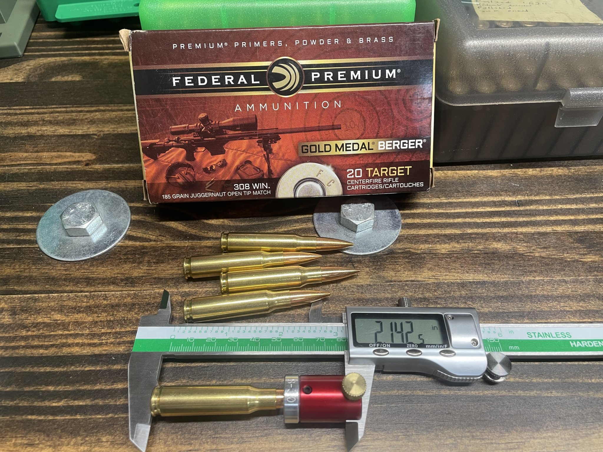

I have found COAL to vary from 2.803 to 2.808
CBTO was 2.136 to 2.143.
I do not have groups available, however I recall this factory load shot sub MOA in a factory R700 5R.
I do not have Accurate 2520 on hand for direct comparison, nor have I worked with it yet. Open for suggestions and input from yall on positive powder ID.

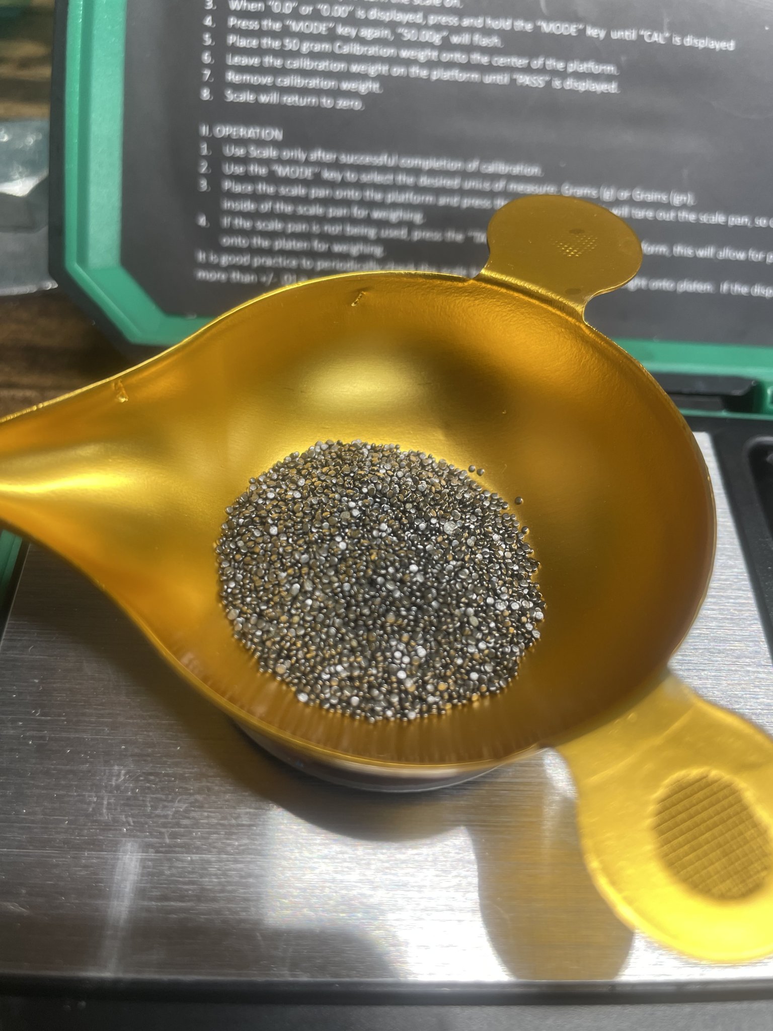

It's been a while but that powder looks more like MR2000 to me than A2520. It's more flattened, and 2520 is spherical balls.
That’s very possible! I have not worked with either of those powders so your experience vastly beats mine.
I was trying to deduce from what data I could find on the 185g Berger.
Back in 2020 I used 44.9 to 45.1 grs of 2000-MR behind 185 Jugs and through a 20" factory barrel I was getting 2620 fps. I didn't get very good results when I tried the Jugs and went back to 175 SMK's that did well with that powder.
I have both powders on hand. Under a 10X loupe they both do appear similar in shape but the 2520 is significantly smaller in kernal size. So if you consider the kernals very fine then that is probably 2520, if not it could be MR2000.
