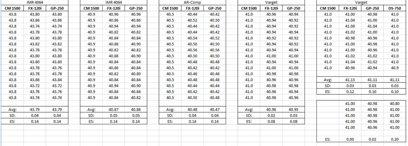

There's defiantly a difference between a more expensive digital scale like the FX-120i and a cheaper Frankford Arsenal DS-750. Just out of curiosity recently, I ran a comparison between these two using my best loads and components. The cartridges loaded with the DS-750 gave me a SD of 15.8 with an ES of 60 fps. My 120i, loaded at the same time with the same components, game me an SD of 6.5 and and ES of 60 30 fps.
Here's a comparison of some scales that I have in terms of how they compare to the 120i:

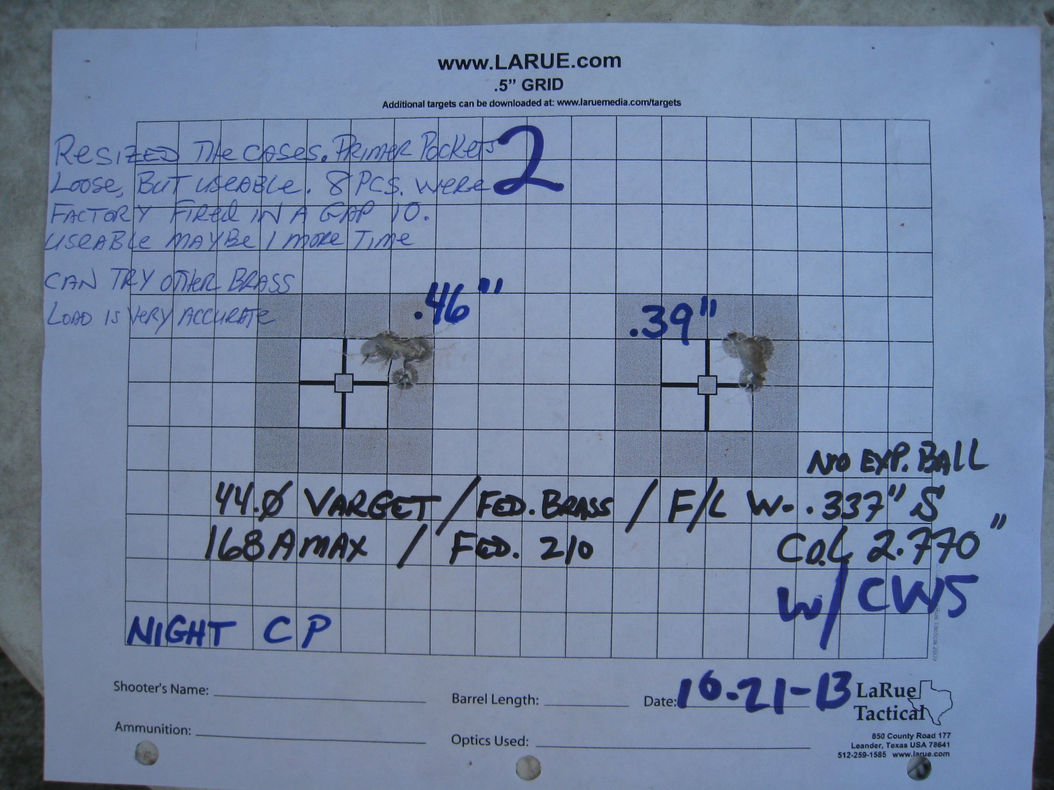

Here's an example of a 308 Win I've been developing a load for. It has taken me 100+ rounds to get to this point. My next trip out to the range will be to see if I can repeat anywhere close to this. (the picture is a 3-shot group at 100 yards)
The cartridges loaded with the DS-750 gave me a SD of 15.8 with an ES of 60 fps. My 120i, loaded at the same time with the same components, game me an SD of 6.5 and and ES of 60 fps.
Was the latter ES a misprint? An SD of 15.8 matches up pretty well with an ES of 60. But, I don't see any way you're ever going to get an SD of 6.5 with an ES of 60.
Load was shot in Federal GMM brass. Not weighed, Federal 210 primer, 44.0 grains of Varget hand thrown on a Dillon electronic scale, The old Hornady 168 A MAX, not weight sorted or ogive sorted. Shot at night @ 100 yards from a 2012 built GAP 10 off of a bench W/ Bipod and a rear bag. Redding F/L "S" bushing dies. No mandrel / no expanding ball.
Two 5- shot groups. Sometimes, Rifles like what they like.
I have to ask a question based on your scale comparison and the SD data you posted. The difference between the 120i and the DS-750 is essentially nothing yet you seem to be implying the difference in the SD is due to the scale. If I am correct how did you come to that conclusion?
Am just going by my chrono numbers I've recorded.
The weighing for that spreadsheet was never loaded and fired to see any velocity difference. I did notice that incongruity and don't know why it would be so. There could be other factors at play too??? Guess I'll have to try an experiment and record the details together to better see any correlation. :giggle:
On a couple different occasions, I've fired cartridges loaded with the DS-750 and the numbers were right there in the middle teens for SD's. And of course, I've fired a great many more cartridges loaded with the 120i getting typical SD's from 4.5 to 6.5.

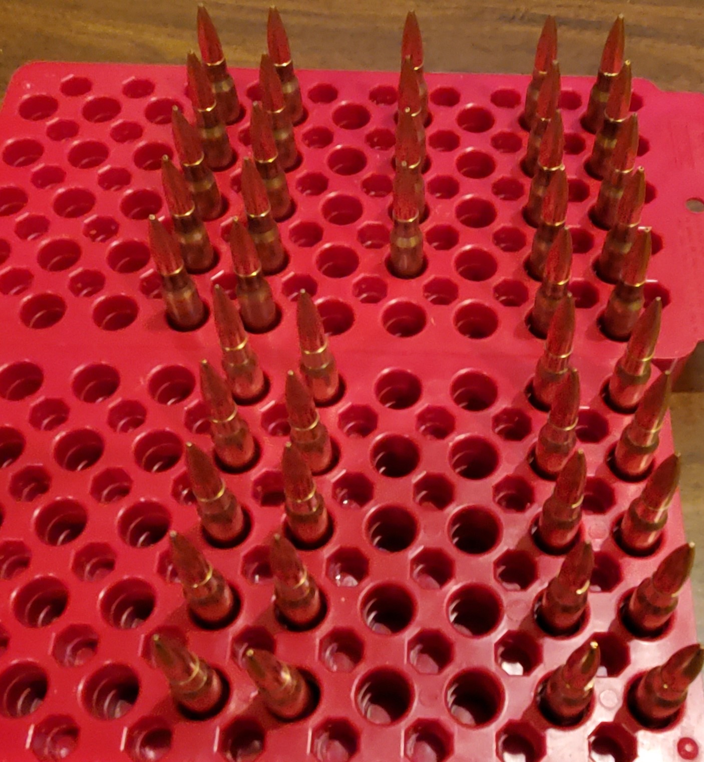

Well, I've loaded up some test cartridges to compare chrono data. I'll be shooting two different bullets with two different charges, different cases and primers. Like I've got 10 loaded using the 120i and ten loaded using the using the DS-750 for one set that's in Lapua LRP's cases that have been sorted for the most consistent case weight and using primers that's also been sorted for uniformity. One set with 168 SMK's and the other with 169 SMK's. Bullets and primers are all seated to within .0005". This effort is to try and remove as much variances in the cartridges as I am able.
We'll see what the chrono numbers say when I get these fired :giggle: :

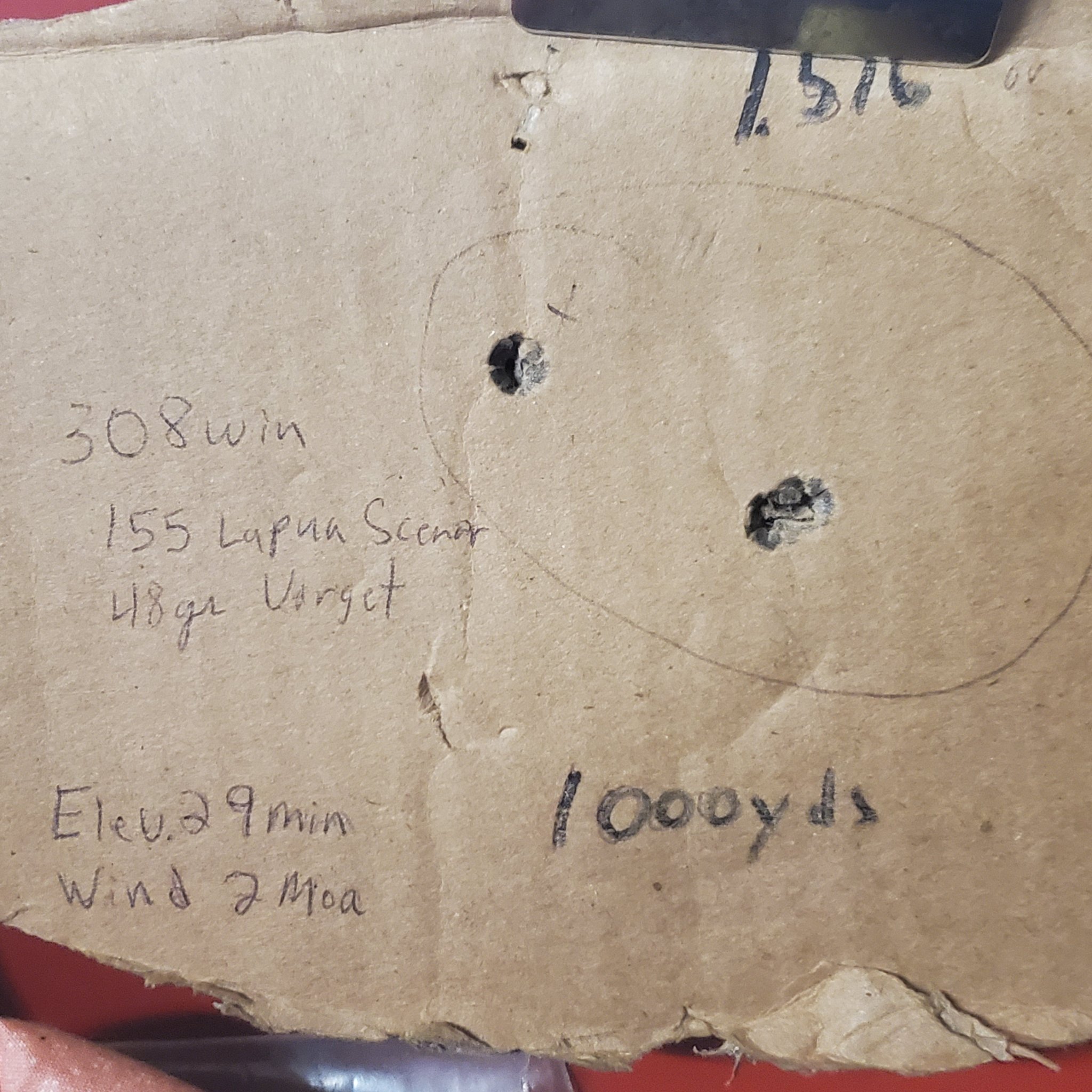

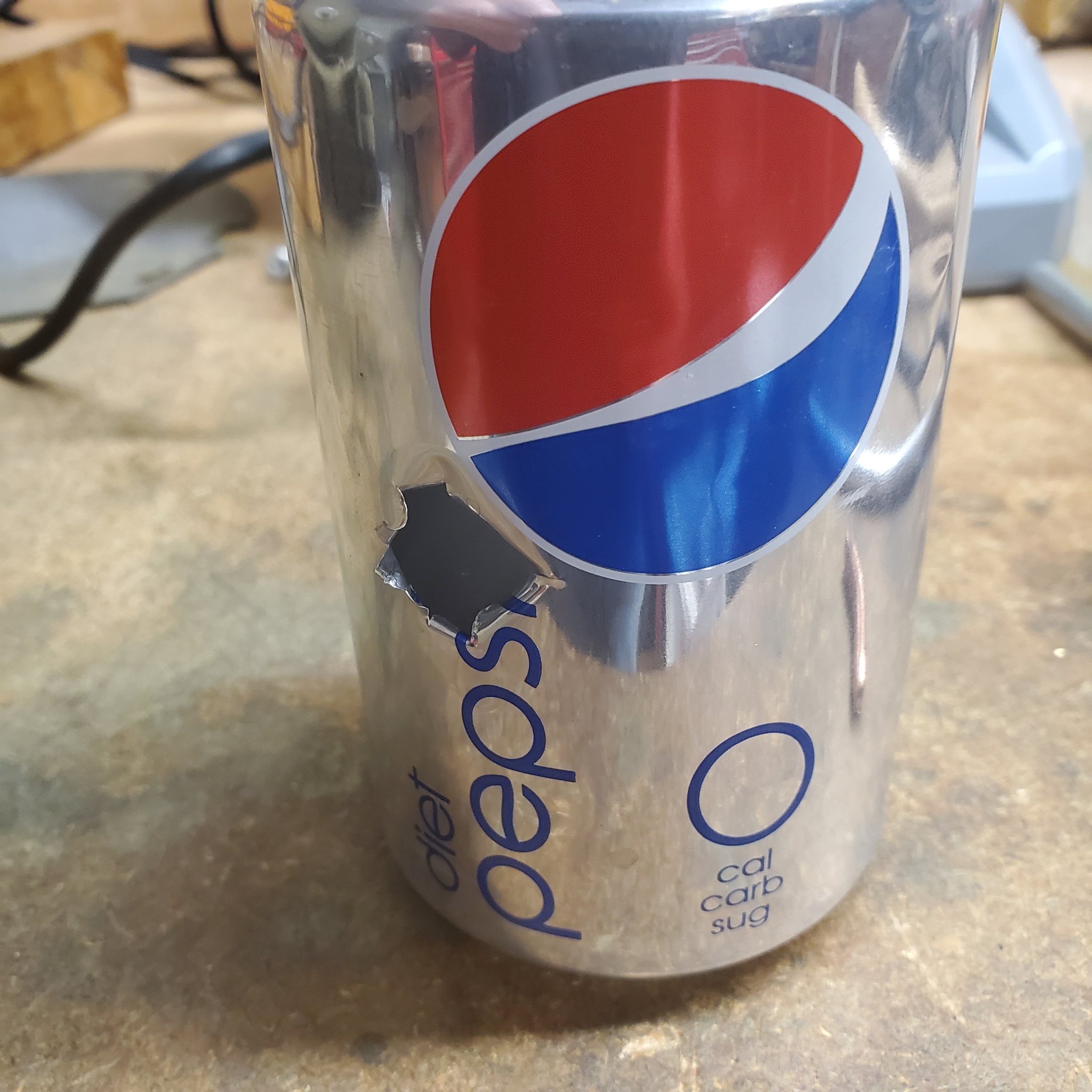

The 308 Win held a lot of accuracy records for many yrs it was a go to cartridge in alot of areas.
I used it as a 1000 yd varmint cartridge and my long range rifle cartridge out to 1400 yds, about 25 years ago when Varget was $112 for 8 lbs, & buy 3000 Lapua 155 Scenars at a time for a discount. The 1-12 twist barrels at the time loved these bullets.
Shooting eggs at 1000yds.
Kept my first pop can at 1000yds...notice the bullet coming in at a fairly steep downward angle from one side of the pop can to the other....it's really drastic at 1400 yds.
And you must take that into account on long rang kill shots, to give the bullet a chance to stay in the kill zone all the way through, that's why I stuck with varmints they are thin.
Here's a 1000yd 3 shot group about 1.5"
And a good 5 shot 1400 yd group about 7 3/4" 4 showing in in the gap in the cardboard.
These were all loaded on a Dillon RL 550 B progressive, with a rotary drum attachment, powder checked every 20 rds... or less. Keeping a rhythm and following your powder dumping protocol.
Lapua LR brass, no weighing or sorting.
Fed Match primers, 47.5 to 48 gr Varget depending on barrel newly installed barrel.
Lapua 155 Scenar bullets all 17,000.
Every 500 or 1000 rds the Ammo chronographed and shot at 100 to test 100 yd accuracy and see if the ammo is still running single digit S/Ds.
Nothing was ever changed, just adjust powder with new barrel...barrels were 26" and 27" all during the early yrs...struggled with a 20" for awhile...but for me the longer barrels were the ticket.
The newest electronic gaget was the lazer range finder...very helpful.
If ya shoot 17,000 rds at 1000yds, you'll likely learn something.

I think a lot depends on just how accurate the a scale like the DS-750 really is. That scale comparison was mainly to compare scales the ChargeMaster. Though it was interesting that the numbers when weight on the 120i was that close.
Speaking of Rabbits and where they might lead. I'm going to comment on the planning and testing and what @staightshooter1 can expect from the results. This is kind of where the issue of statistical significance comes into play. This how a test engineer would look at the the data and what conclusions might been drawn from it. There is nothing wrong with the plan per se. Where the rub can come in is what the test results show and how they are interpreted. When testing the idea is to determine what the test results are (past history) and use that to predict the future (probabilily of future outcome), The ten shot test is going to yield different mean and standard deviation results for the two different groups. In the design of experiments it is desirable that only one thing be changed in a test (the test variable) but in our shooting world case everything is different on each shot, case, bullet, charge weight, neck tension, chamber and barrel condition, etc. Even the powder itself can very in energy density content in a minor amount. Each of these and other variables conspire to combine in different ways on each shot to create differences in the velocity of each shot that we are trying to assign solely to the different scales. Even though we try to minimize those differences they still exist. Once you have the results, mean and standard deviation, you have to determine if there is a statistical difference between between the standard deviations. Just because one is lower than the other does not mean that they meet a criteria that means something.
Without getting into a long treatise on statistical probability suffice it to say that small sample sizes under estimate the standard deviation and that it is not a normal distribution like the mean is. Small sample sizes severely underestimate the standard deviation. Let's say that one scale produces a SD of 15 fps and the other produces a SD of 10. So does our test result mean that the 10SD scale is actually better than the 15 SD scale? To compare the two results we would use something called an F Test for differences in standard deviation. In this case it would tell us that there is an ~87% probability (chance) that the 10 is statistically better than the 15. But it does not mean the difference is 5fps. Normally when testing we would not consider a result to be statistically significant unless the probability is 95% or greater. It is also important to look at the Confidence Interval (CI) for each standard deviation. Typically a 95% confidence interval is used, meaning that if we ran an infinite number of 10 round samples 95% of the standard deviations would fall between the upper and lower limits. This CI for the 15 SD is 10.32 to 27.38 fps and for the 10 SD is 6.88 to 18.26 fps. You can see that there is a significant overlap in the confidence intervals.
So for this example test we can infer that the SD of 10 appears to be better than the 15SD but statistically there is too little data to be certain of that fact. Even if the SD were to be different on this test it doesn't mean that would always be the case. We would need to run more tests before we could increase our confidence of the results.
It is also important in developing a test protocol to have a feel for what effect the intended variable can have on the results, in this case powder weight (only). This is actually something that is done prior to testing. This kind of estimate is what is typically done to prioritize what needs to be controlled and the type of equipment needed to perform a test. Taking a look at a 308 a 0.1gn change in powder can have about a 6 fps change in velocity if thet is the only thing that were to change. This is equivalent to a 6 fps ES and we can estimate its standard deviation by dividing that number by 6 (true ES is ~6xTrue SD). So our SD for 0.1gn is 1 ft/sec. If our test SD were 15 and the powder weight for the test varied by 0.1 gn (ES) we would expect the SD to go to Sqrt(15^2-1^2) or 14.97 fps. If the Test SD were 10 then the resulting estimate would be Sqrt(10^2-1^2) or 9.95 fps for a zero (0.0) powder weight change. The implication here is that if the SD isn't very low due to all of the factors involved to begin with it is going to be difficult to detect the difference in weight from the velocity because the other variables are influencing the results much more that the variation in weight would. If the standard deviation for the weight of the powder equated to 2 fps SD the reductions would be to 14.86 and 9.79. Still a small change in velocity SD.
Anyway, this how any test results should be analyzed. A similar method applies to the mean for average. Fortunately the mean requires much less data to be significant because it fits a normal distribution. The PrecisionRifleBlog has a great series on statistics applied to shooting and I would recommend it if anyone is interested.

We'll see how the results line up with previous data I've recorded. Like when you continually get SD's of 5 - 7's and 12 -17's. One of the reasons I did two different cartridges was to see if, as I suspect, it'll still show a meaningful difference between the two scales use.
One of the big differences what the amount of time it took to weight the powder charges. As we know, the FX-120i is fast. The DS-750 took substantially longer to get a consistent reading (like removing the pan and putting it back on to be sure the reading was right). Often the reading wasn't consistent until I had the right amount of powder in the pan. 😵‍💫

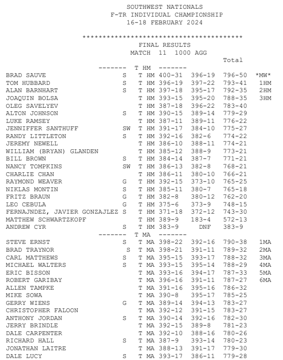

If you like, you can get a pretty good idea of what goes on with the 308 WIN during the South West Nationals.

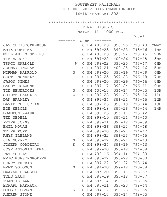

No password or membership required to see last year's results of the F-T/R class (or the F-Open for that matter.)
Occasionally, someone will campaign a 223 in the match, but the majority are running 308 WIN.
In any case, feel free to take a look at the scores these folks can shoot in F-T/R class.
Since I know some of you won't look at the link, I'll snapshot the aggs from the 1000 yard matches.
I'll put the F-Open right below, so you can see what someone can do at the same matches while shooting a 308 to compare against the F-Open folks.
Brad's first relay he shot 400 with 31X. The best F-Open relay was 400-23X. If you don't know what these scores mean, then I can't help you.
https://www.desertsharpshooters.com/2024-southwest-nationals
Merry Christmas and Happy New Year!!!
Yep. Good load with h4895 or n150 will do that with 200’s. Take that load to 1000.
