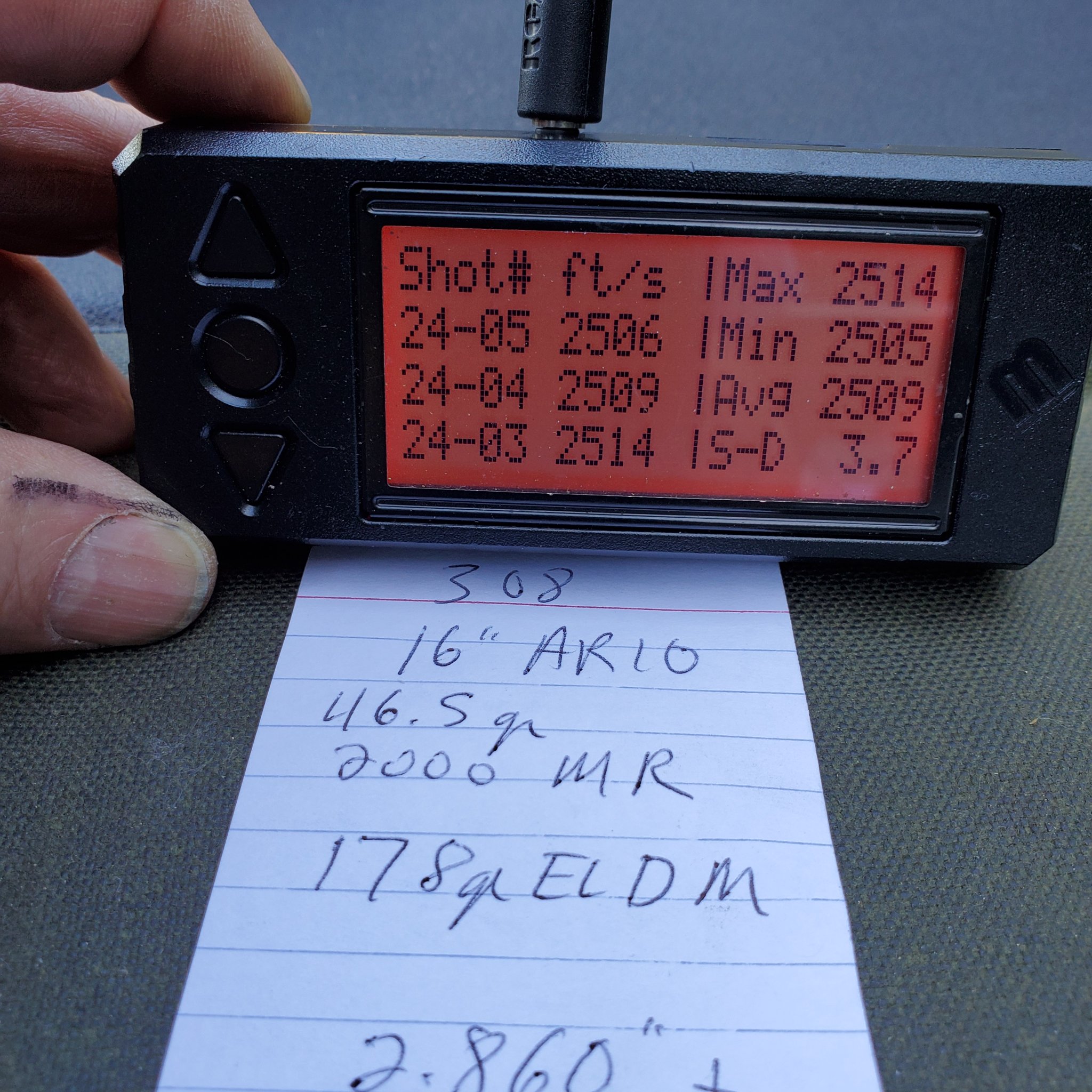

Here's a good load for 16" AR 10 308, with 178 eldm, that could be adopted to a bolt gun.
