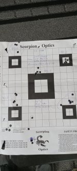

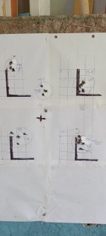

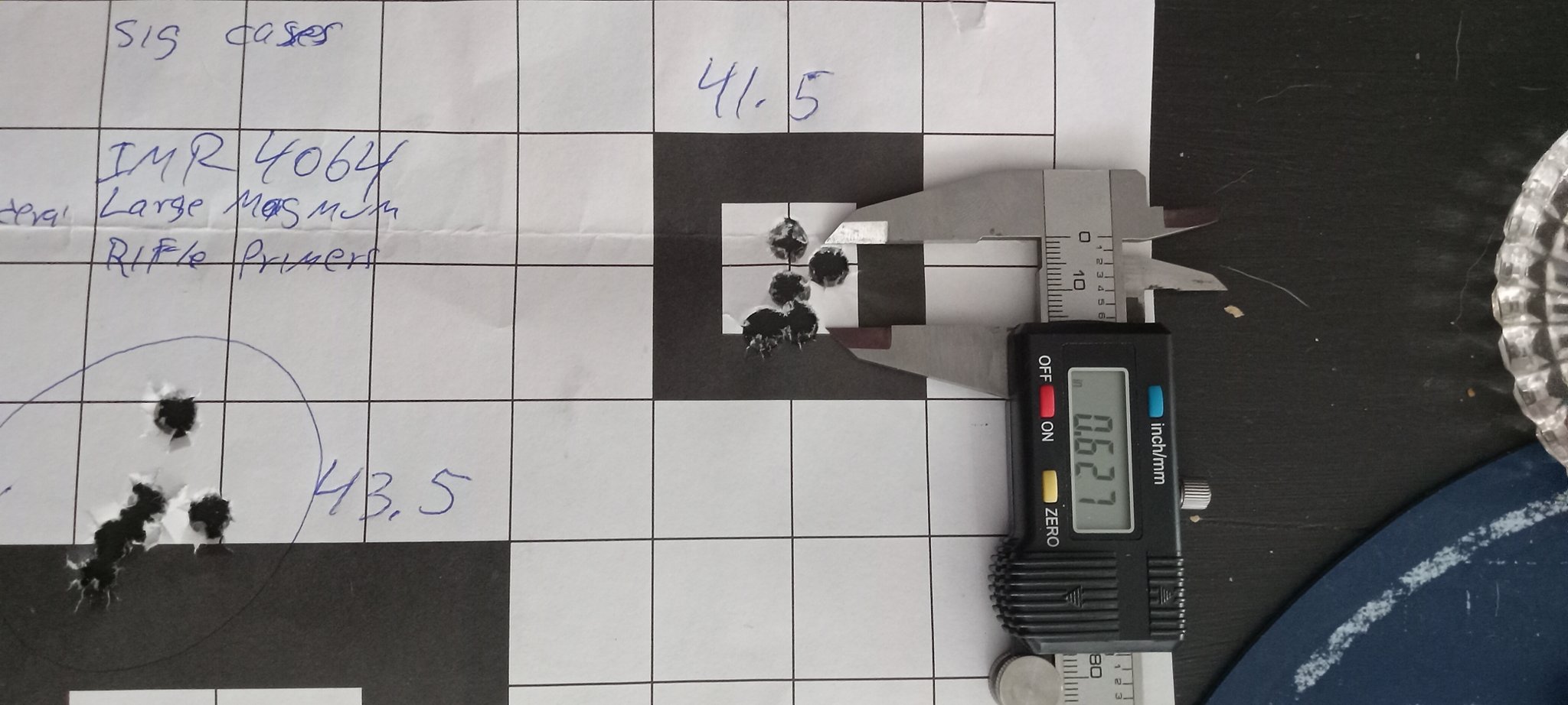

Hi. Getting back into 308 after 20 plus years. I've noticed most shooters using 155 or 178 gr bullets for 1,000 yards. I've been given 400 bullets from friend who stooped shooting. Hornady 168gr ELD-M. These are better ballisticaly than other 168 brands. Presently shooting these in Sig cases, IMR4064, Federal mag215 primers. Rifle is a Savage 12fv ( 26" heavy barrel) 1 in 10 twist, in Oryx chassis. Using 41.5 gr plus COAL is 2.80. Two groups are o.61" and 0.84" 5 shot groups at 100 yards. Dont have chronograph yet. Going by Hornady manual, I figure around 2,600 fps. Should there be a higher node for more velocity? Need for 1,000 yards. Have heard some shooters using 168 reaching 1,000. 43.5 looks promising. Suggestions Thanks

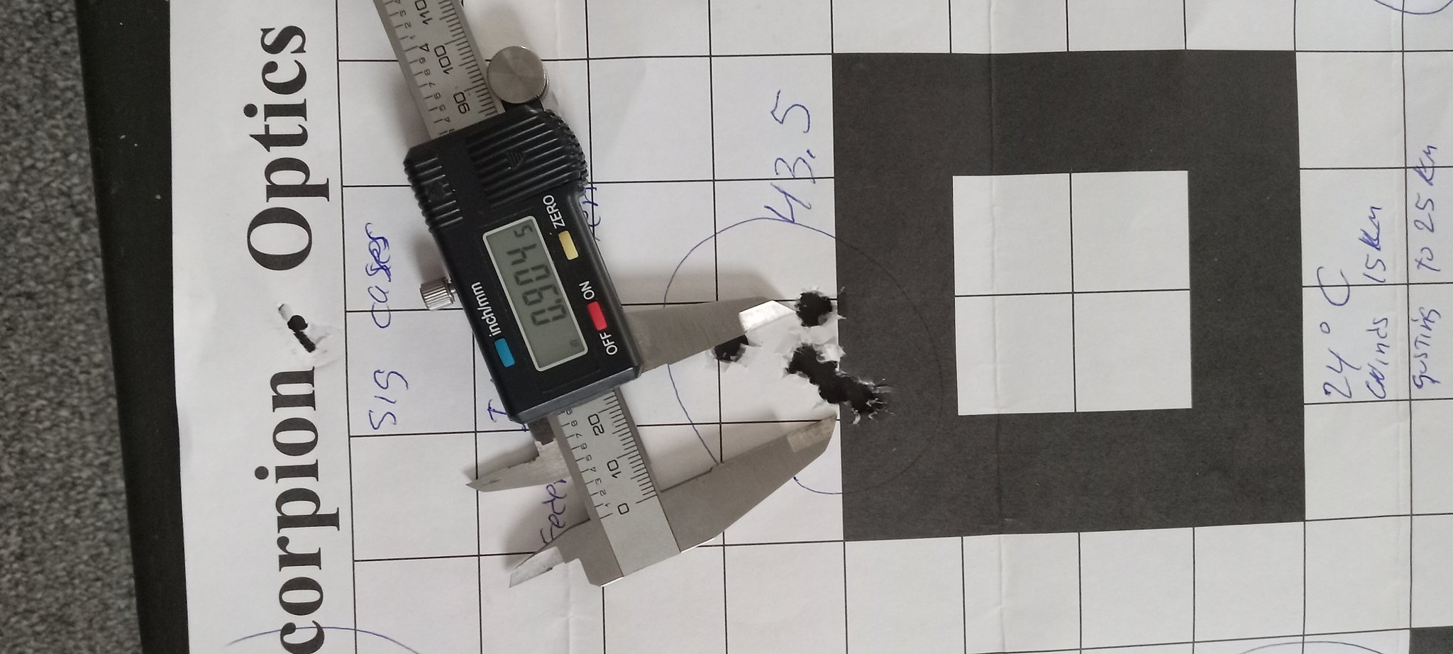

Have loaded 43.5. Slight cratering. No extraction problems. Have Oryx chassis and Asis mag. Will try adding length with 43.5. Hornady manual test rifle is 22". Mine is 26, so slight increase in fps. Hornady also seems on low side compared to others. Suggestions as to which charge to try?
Have you tried adjusting your seating depth yet? Those ELDs can really tighten up if you play with that just a little (or it can go to shit if you lucked out and landed on the ideal depth for your barrel right off the bat).
Not tried depth yet. This was from Hornady Manuel. Was hoping for little more speed though. Thanks

The old Federal Gold Medal Match load was 41.75gr of IMR-4064 for the 175gr SMK, and 42.8 for the 168gr SMK.
That 168gr FGMM load wasn't supersonic to 1K, but with the ELD-M and 43.5 I think you have a pretty good chance of keeping it above the speed of sound to that distance. All you need to do now (really) is mess with your seating depth a bit. You are jumping that bullet a ton in a factory Salvage chamber with a 2.800 COL... Just be careful not to jam because that may have an adverse effect on your pressure.
