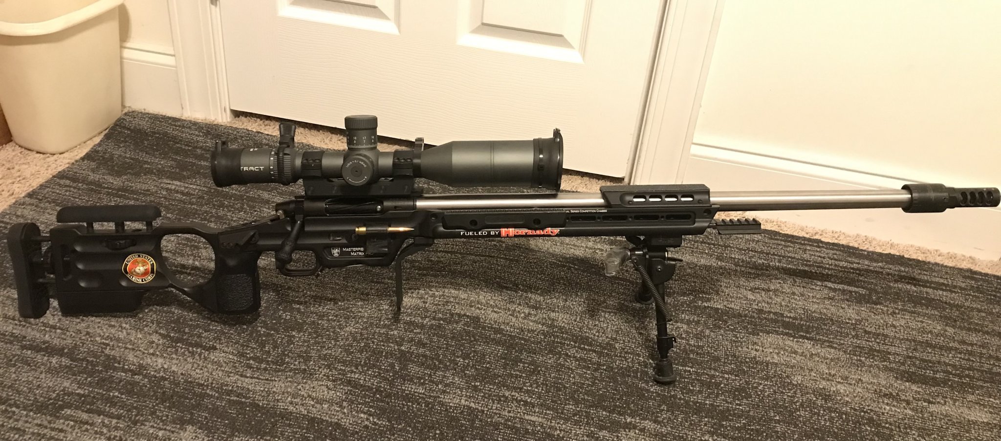

It should be if you are running the rifle right and have it set up correctly. I have a 28” M24 on my .308 and 6.5 Creedmoor now. The MTU will be heavier though. Either is better than a factory barrel.
This is my Creedmoor but my .308 looks just like it but a different scope.

Did you notice a big difference in the contour or how it looked? I’m guessing you had an m24 cut stock so the fact an mtu fit in it is a good sign I guess haha
Which company makes that barrel? Looks almost like a straight taper haha looks good though
Through circumstance I never had them side by side till months later, so I couldn't compare them. When I was finally able was when I realized one or both barrels couldn't be that far off spec. Someone must have screwed up. That someone was me.
It's in a metal chassis so there's still lots of room.
Reactions: Caseycole
Definitely not a straight. Lol That’s a Bartlein barrel. I have some PVA Osprey proof Comp Contour barrels that are heavier than that. They are a little heavier than the MTU which is a little heavier than the M24.
