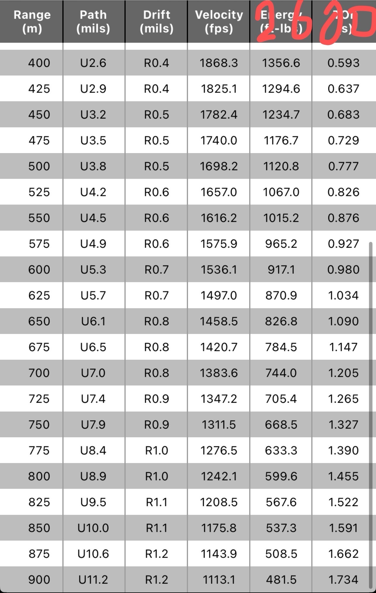

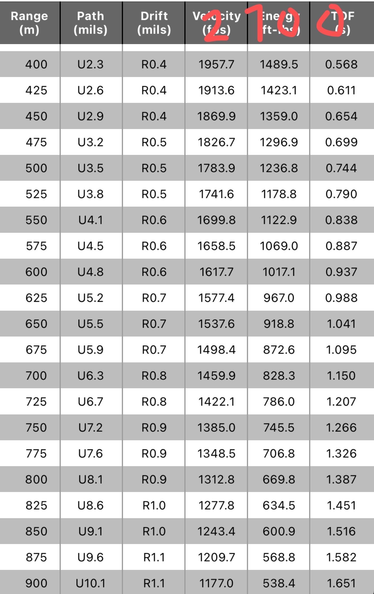

I'm going to shoot PRS tactical using 308 with 175gr SMK. (24",1:10,planned to shoot 178ELM but found super good deal of SMK)
I searched online and found most people are running it at around 2600fps instead of 2700.
Is there a particular reason for that? I'm not a fun of less than 95% fill ratio
Are they just trying to replicate MK316 or that spot actually works very well?
Thank you
Thank you
View attachment 8255263 vs View attachment 8255265

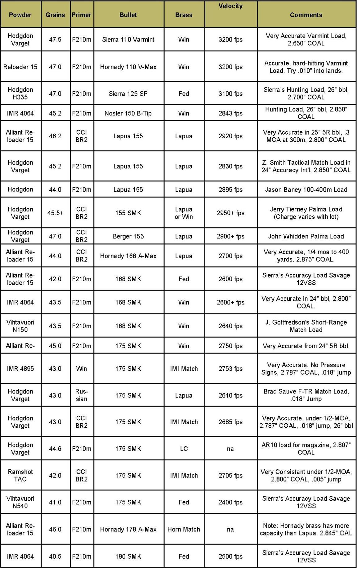

Maybe this chart will give you some ideas:
