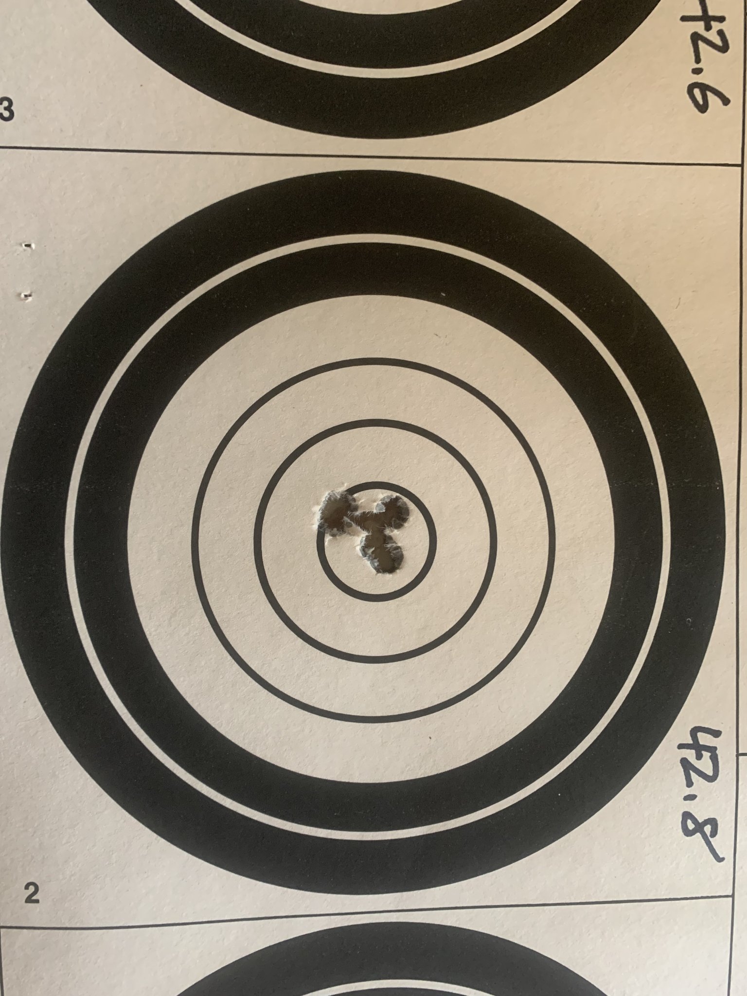

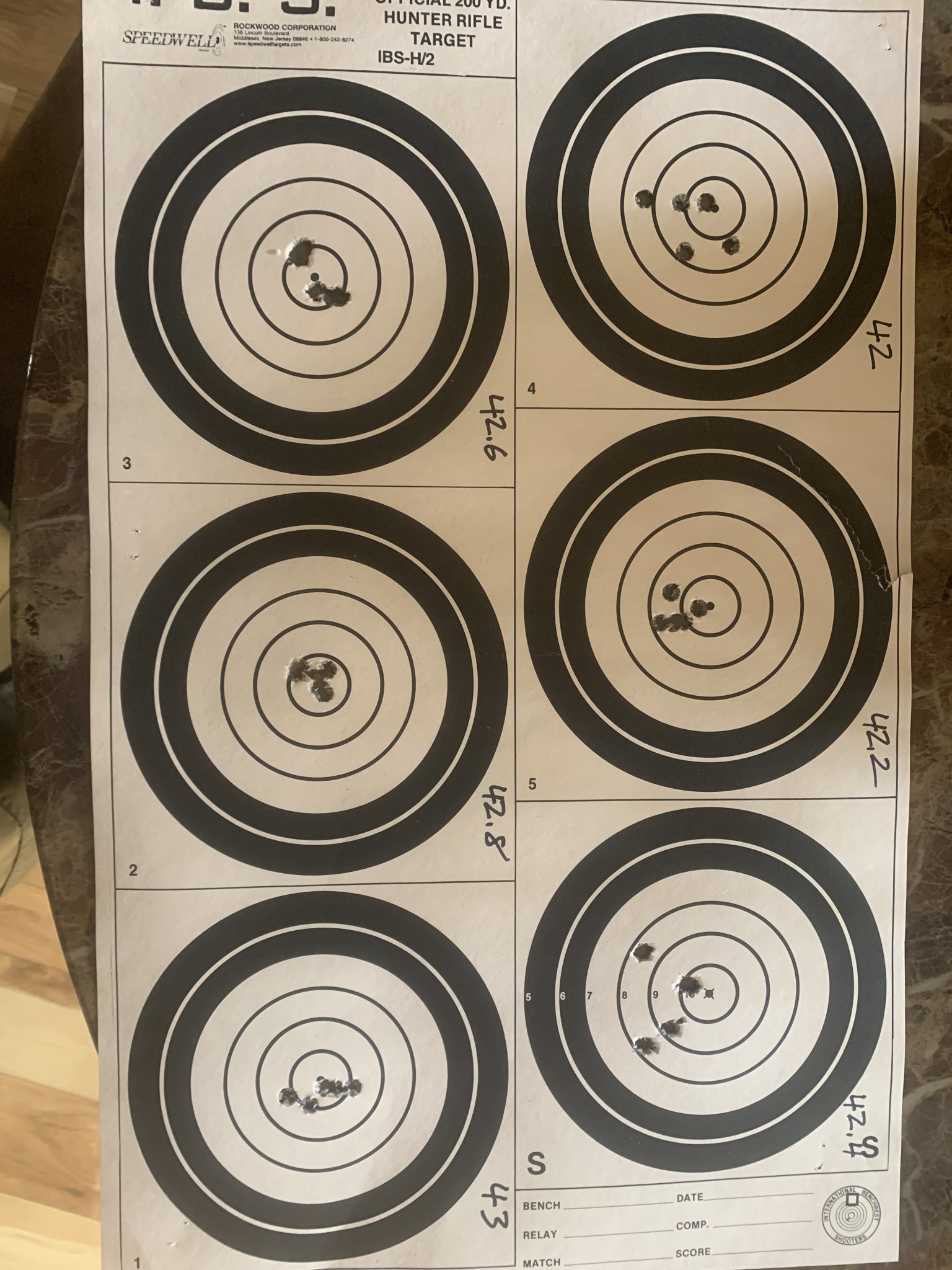

Used the lo loctite method to find the lands and seated .020” off. We’ll see how that works.
43 gr. Varget was still too much.

Even 42.8gr is on the edge of too much pressure. 2660 fps.
Had to change primers and groups opened up a bit. Bolt closed hard. Need to readjust sizing die I guess.
Gonna work around the next lower node, 41.5gr.
