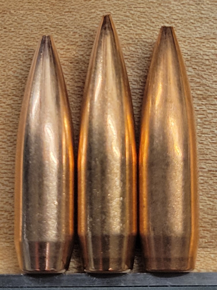

Here's a direct comparison I did between them a while back:
I no longer shoot the 175s, have switched over to the 169s.

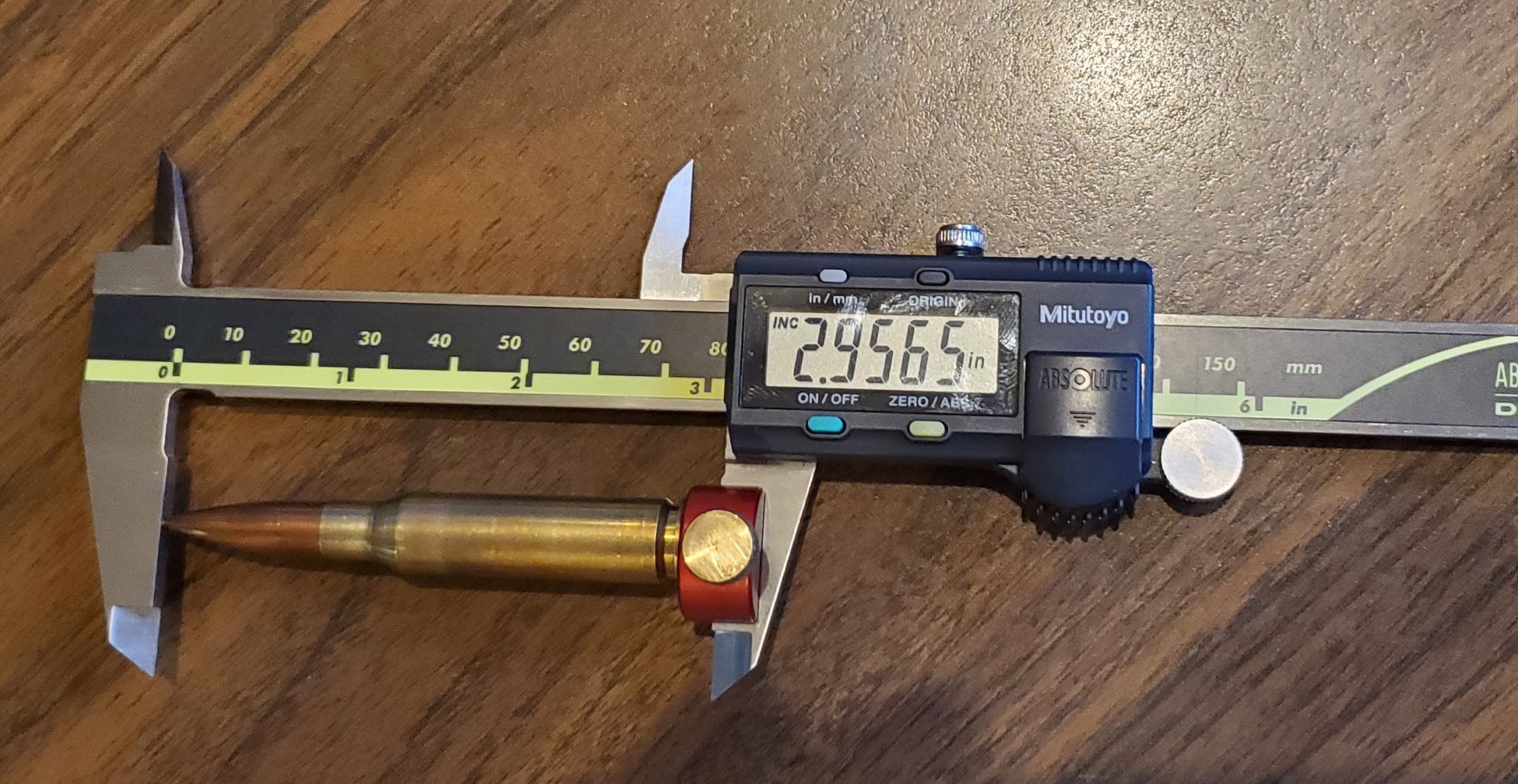

With that in mind, I load my 169 SMK's to a COAL of 2.964, which is currently .021" off my lands (the throat erosion has been .027" after 2200 rounds fired). I haven't changed my seating depth over that time even though the bullet's BTO's have differed from one lot to another. That particular seating depth has been working real well for me and I won't change it until I start to see issues with it on target. Though I originally had my load .010 off the lands with a COAL of 2.964, there's been a little difference is the bullet's BTO's, which is why those numbers (the erosion and current off the lands) don't seem to add up.
I load 41.1 grs of AR-Comp into Lapua Palma cases with .0015 neck tension and necks are annealed after every firing. Primers are CCI400's and CCI450's, which give me velocities ~ 2710 fps with SD's ~6 fps and ES's in the low 20's with 20-30 chronoed shots in a series. On paper, groups are in the .2 to low .4. . . MOA's mostly the latter. Oh . . . this is out of an Gen 2 RPR with a 26" Krieger heavy barrel.
So you see, when I was .010 off my lands, my COAL was 2.964 . . . a .039" difference from yours. That a huge difference in seating depth. Seating depth is much, much more important the how far you are off the lands

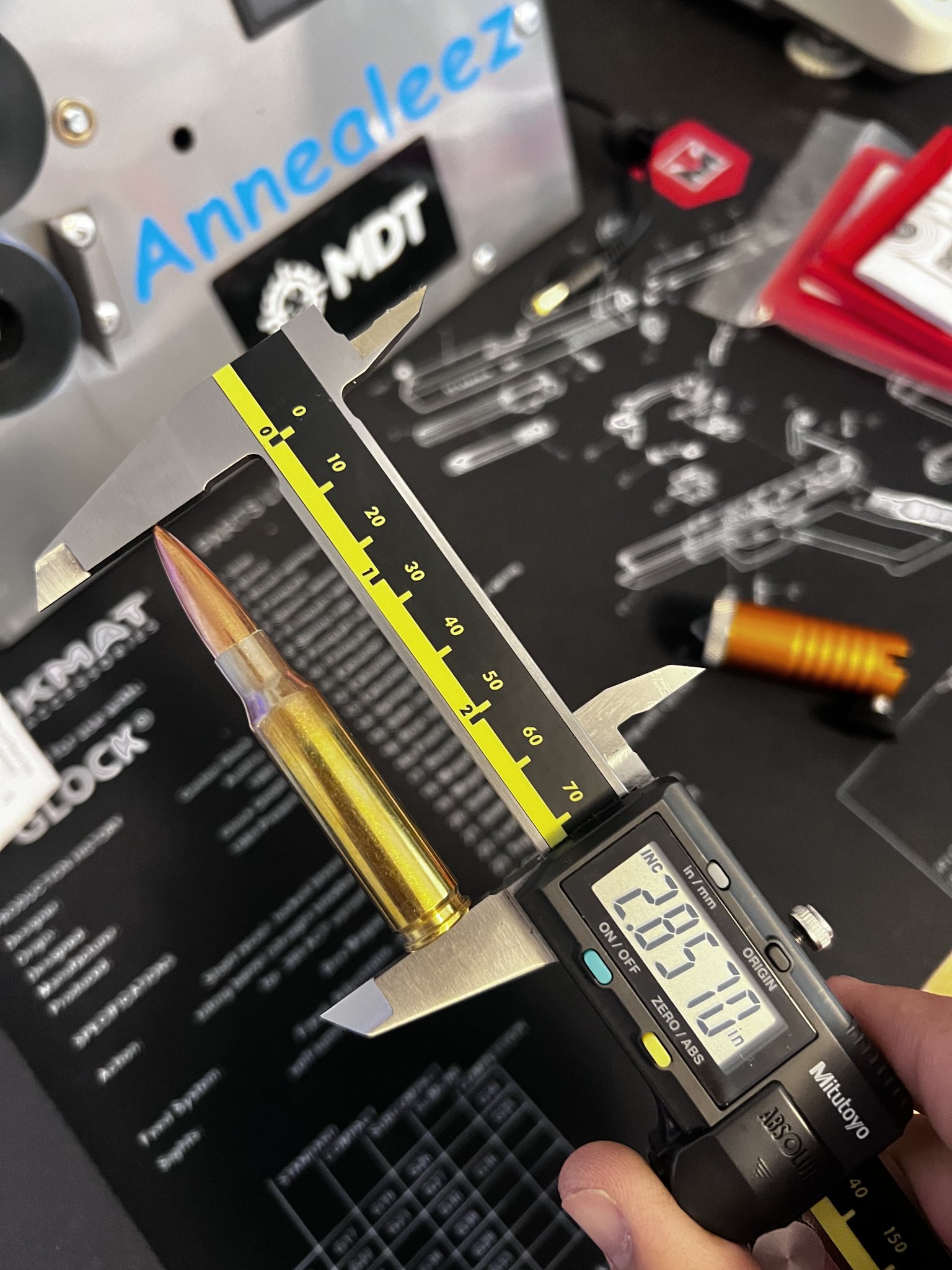

I have shot several boxes of the 169’s in two different rifles and have found .050 or further just works. Even going through load development on a new barrel with varying charge weight that depth just shoots. I’m running alpha brass federal 210M primers with Varget. Barrel is a 26” proof.
Thank you. I have some loads from .010 to .050 waiting to shoot but my range is flooded. Now we have TS Milton doe on Thursday.
What COAL does that .050 represent?
I would have to double check but I believe 2.860 and a 2.110 BTO

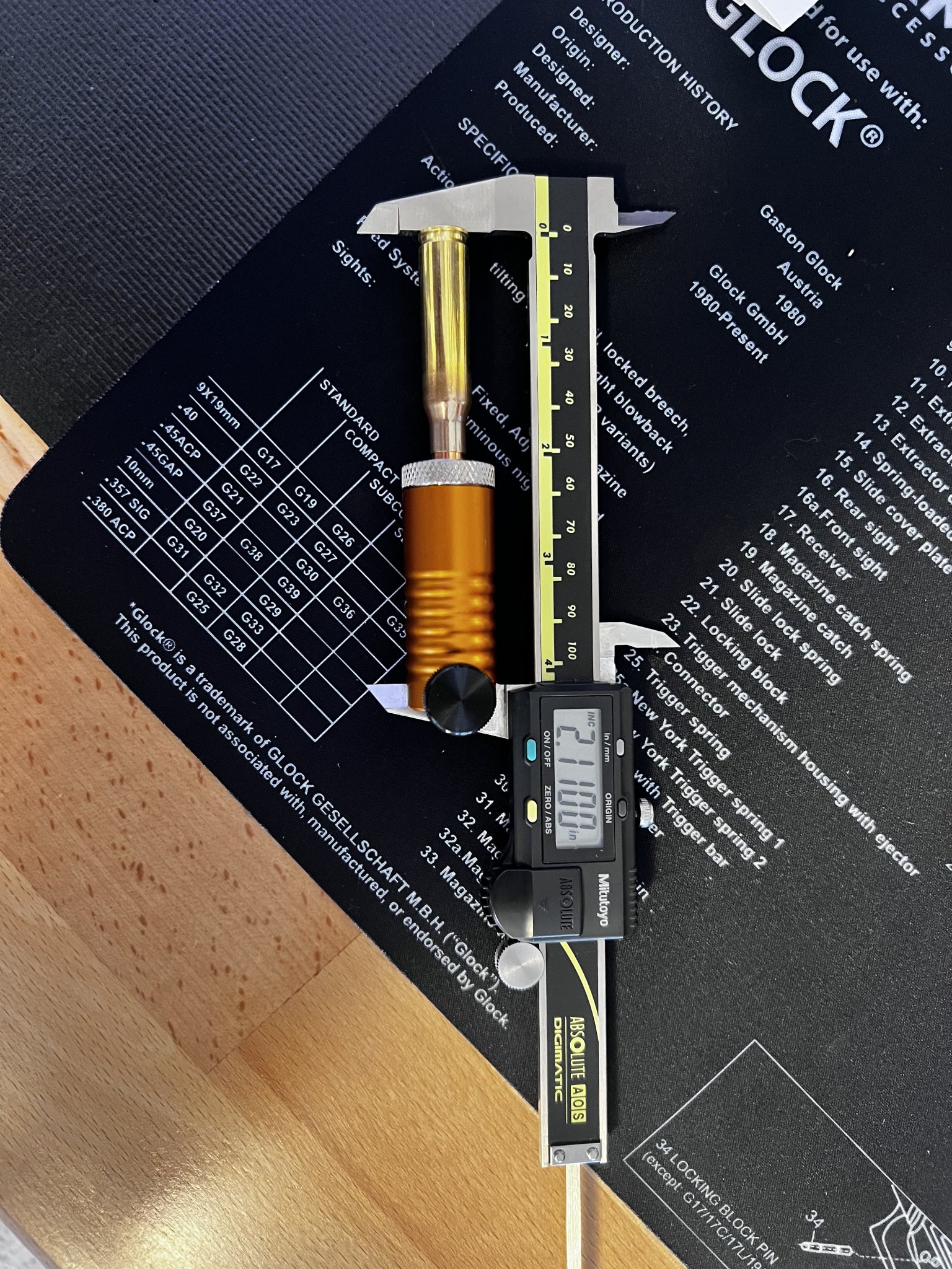

For my Krieger barrel's chamber, that .050 off the lands would translate to a very different COAL for me. I load my 169 SMK cartridges to a COAL of 2.957" which is .035" off my lands, using my Sinclair comparator, that's a CBTO of 2.235". If I load to .050 off my lands, my COAL would be 2.942". . . an .082" difference in seating depth.
Apparently, you're chamber's freebore is much shorter than mine. ;)
Apparently, your chamber's freebore is much shorter than mine. ;)
I thought so too when I first started measuring my chamber. I used a Hornady OAL gauge which probably isn’t the best but I know I’m close enough.
That Hornady comparator of yours is just fine as differences between comparators really doesn't matter as long as you're using the same one when comparing measurements for your own cartridges and chambers. I also have a Hornaday comparator, but I just don't use is any longer as I just like the Sinclair better (not that it's really "better" in any significant way). The difference between these two comparators of mine is .067" in BTO measurements. :eek: :)

That is a crazy difference. The Hornady has worked for me so I just have stayed with it. I couldn’t find much online about proofs prefit chamber dimensions. Seems to be almost identical to my other gun which is a bartlein chambered by southern precision rifles. Guess I’m just into short chambers 😁 The 169’s have behaved almost the same in both rifles. Seating depth doesn’t seem to have a major impact from what little testing on seating depth I have done. I have tested from .010 back and didn’t see anything significant.
Those differences in comparators and chamber sizes is why I tend to be a little "preachy" about not stating how far one is off the lands, but what the cartridge COAL is. Though there's very often a difference in a bullet's OAL within a lot and from lot to lot, the COAL gives me a better way of determining just how someone else's cartridge configuration might fit into my chamber. . . or not (as in my post #23 above). :rolleyes: Like, I load my to . 035 off the lands for my gun now and that's a COAL of 2.957" where you wouldn't be able to even close the bolt of your gun on my 2.957" cartridge. :eek:
