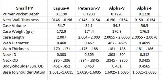

Either one is really good brass. I like the Alpha brass over the Peterson brass, just because I found the Alpha brass to be more consistent with regards to case dimensions. But be aware that if you use CCI-400's in the Alpha brass, you likely will have some pierced primers due to the 400's thin cup's. Going to CCI-450's takes care of that issue.
Here's a comparason of some brass that I have you might find of interest:

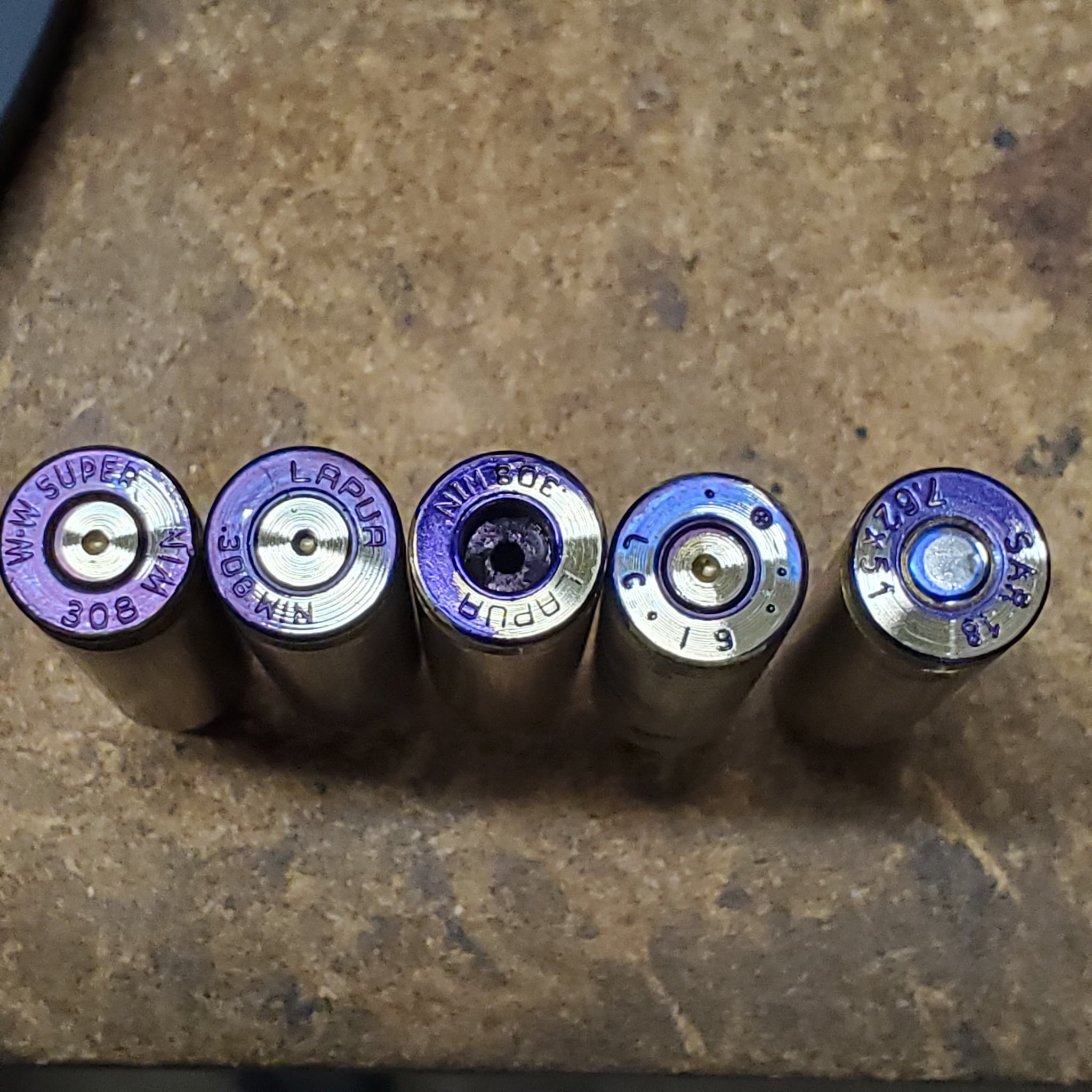

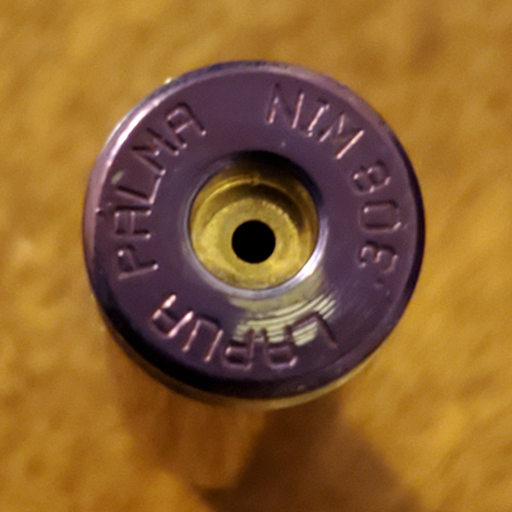

Another thought if you want to continue to use some cases with looser primer pockets that aren't otherwise completely trashed - some primers fit tighter than others.
For example Ginex LRM primers are VERY tight in new brass, and a touch larger in diameter than the standard primer brands (CCI, Rem, etc). They may allow your Win brass to be salvaged for a few more loads. On a side note I have used them with good results in terms of accuracy as well as ES/SD when other primers weren't available.
I think the root issue is hot loads. They are WAY too hot if your primer pockets are loose after one firing.
I have used Alpha with good results. No direct experience with Peterson yet, but my friend uses it and rates it highly (normally a Lapua only guy).
