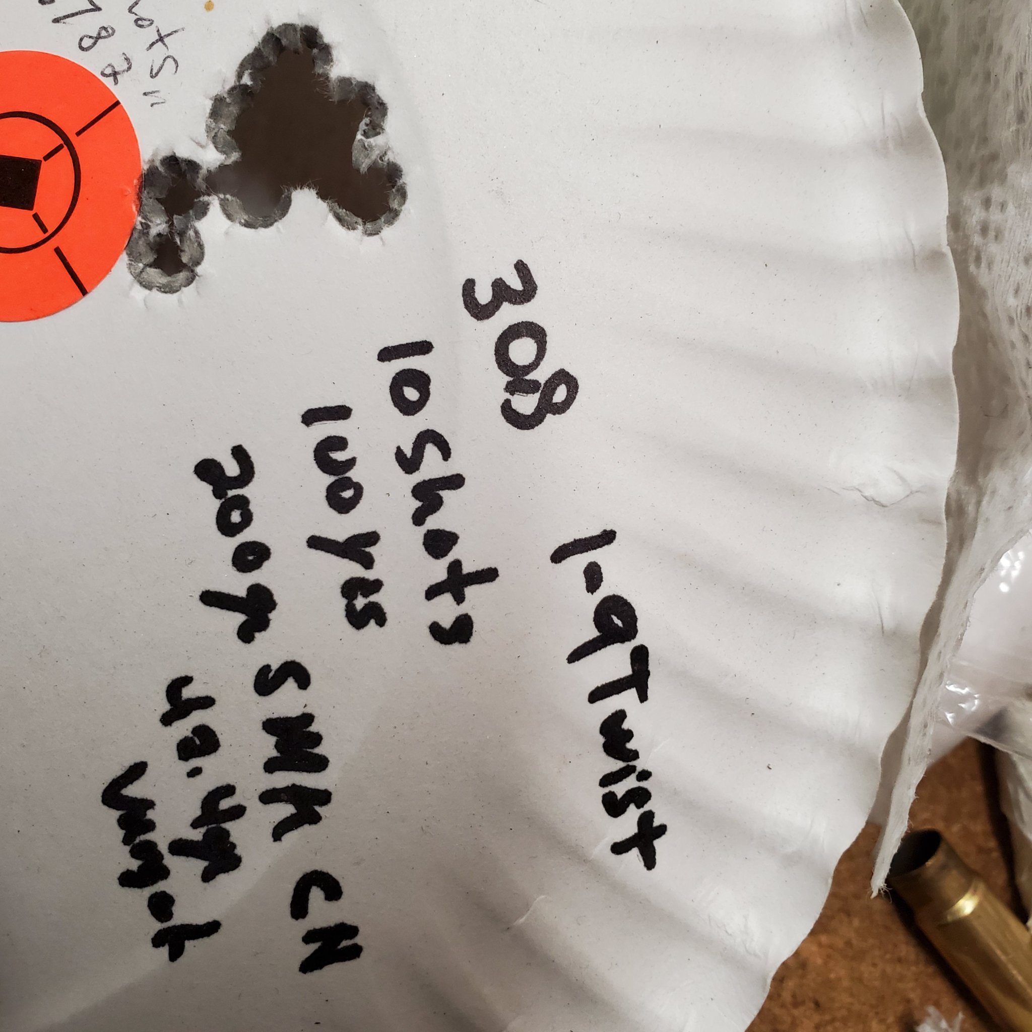

Don't forget the 200 gr SMK .715 G1 BC...single load in short action, this bullet will reach 2740 fps in a 22" 9 twist Bartlen 5 R barrel with Lapua LR brass and MR 2000 in case ya want to shoot way past 1000yds yds with your 308.

I prefer 9 and 8 twists with 200 gr to 230 gr bullets for shooting LR 1000yds and beyond in 308.

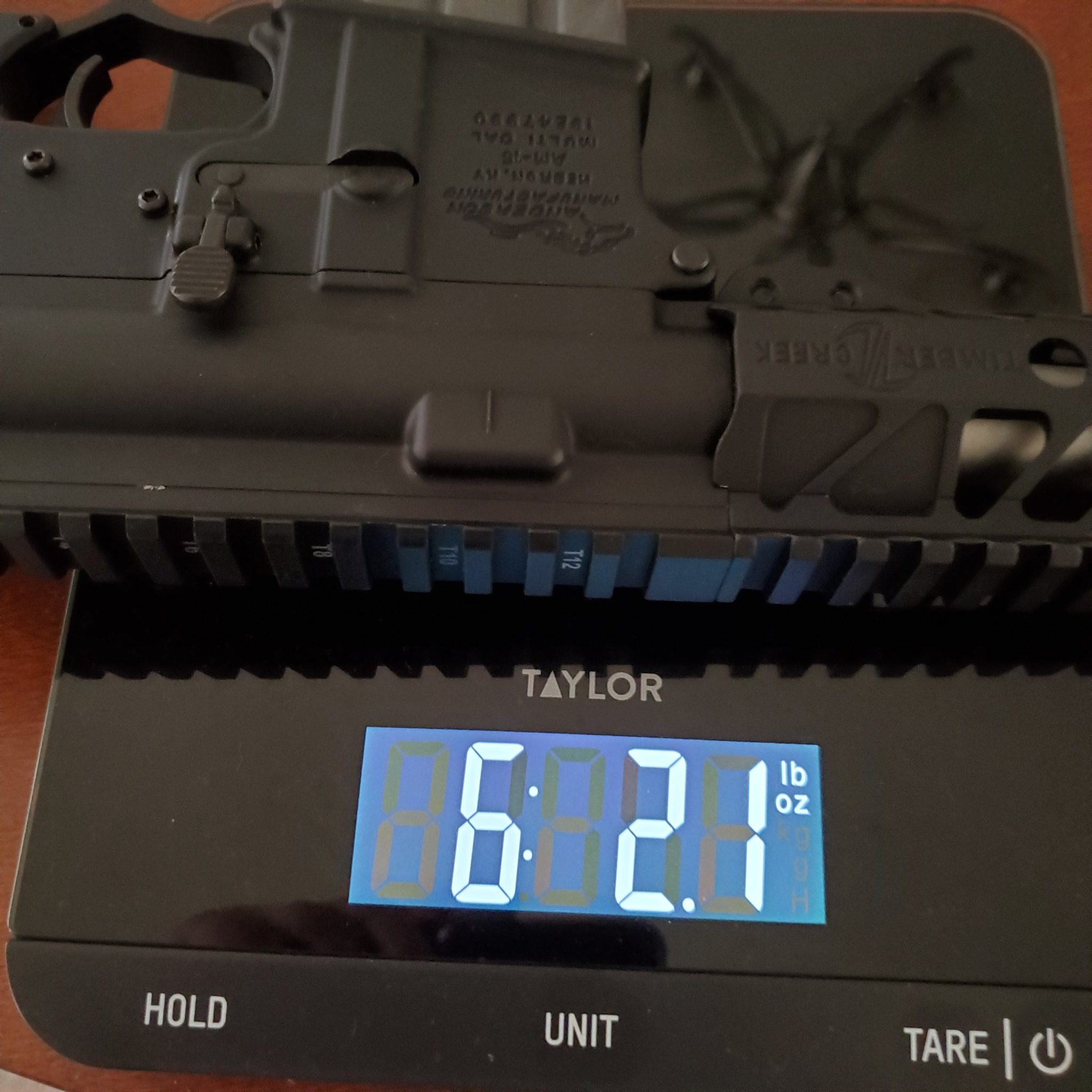

For the 16" fluted barrel AR 10 titanium bolt carrier carbon fiber handguard, and magnesium upper for a 6 lb 2oz AR 10 it shoots 5 shots 1/2 moa with 168 ELDM at 2756 fps, with Lake City brass...as an example. It now has a 10X Mark 5 M3 set up for 1200 yds on the turrent...to be confirmed.
