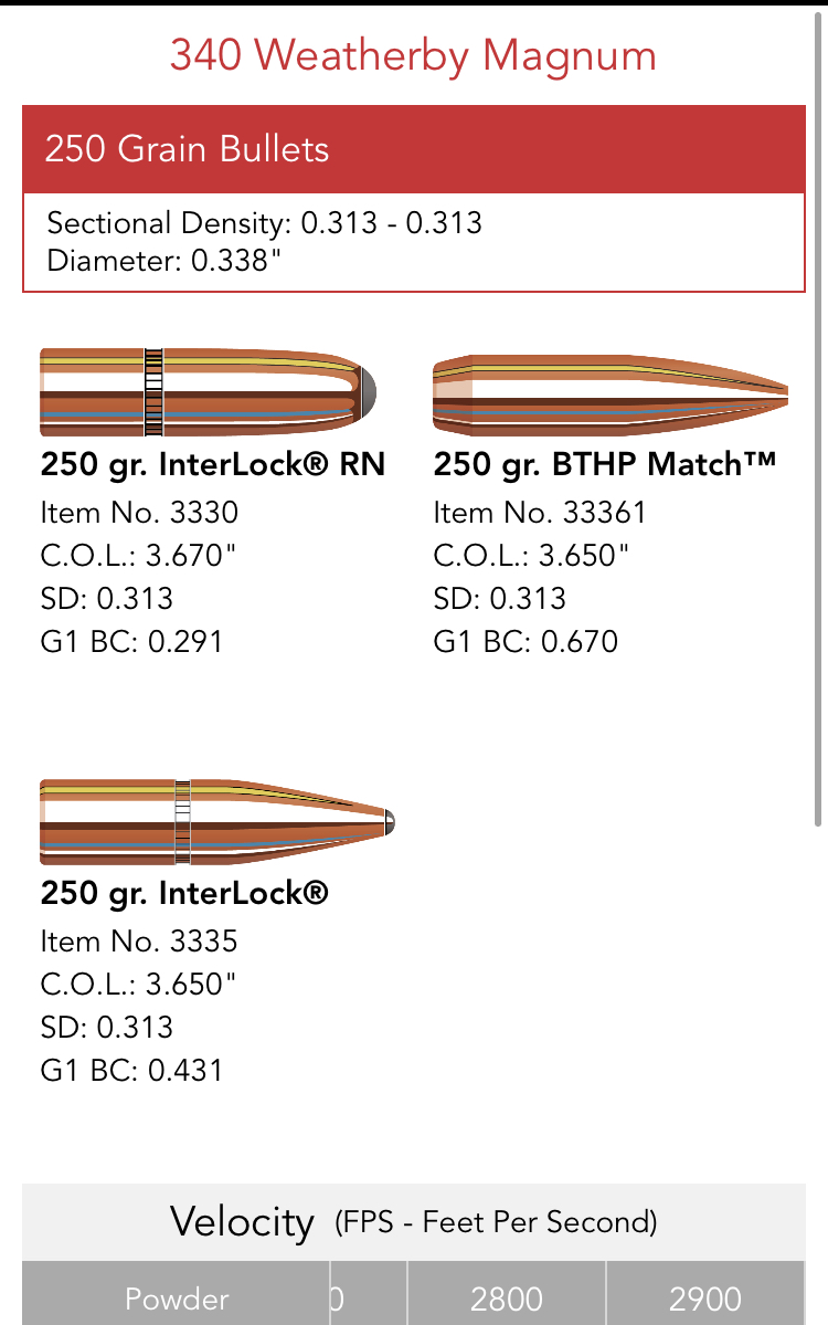

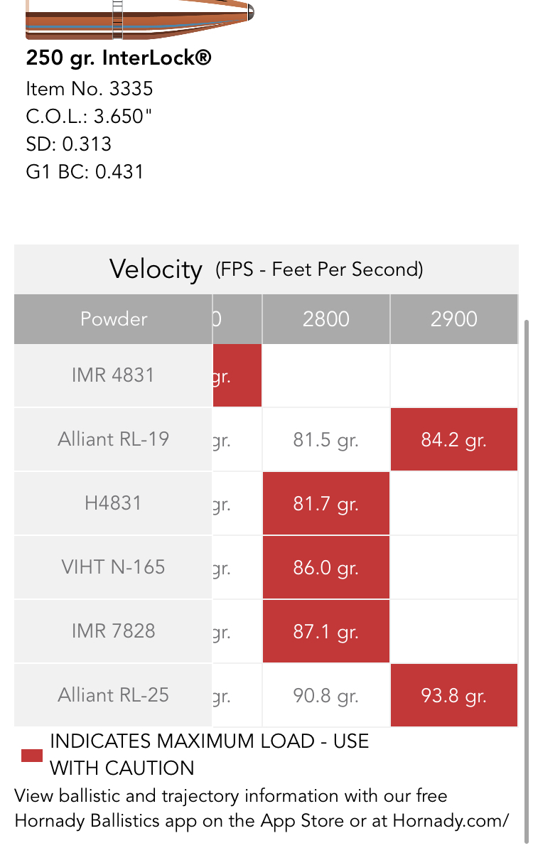

I believe it would be akin to a modern .340 Weatherby.
Hornady’s reloading manual calls for the Weatherby pushing the 250s to around 2900fps.
I surmise the 265-270s would be around 2800-2825.
~85 grains of powder. Seems like a logical offering to me.
